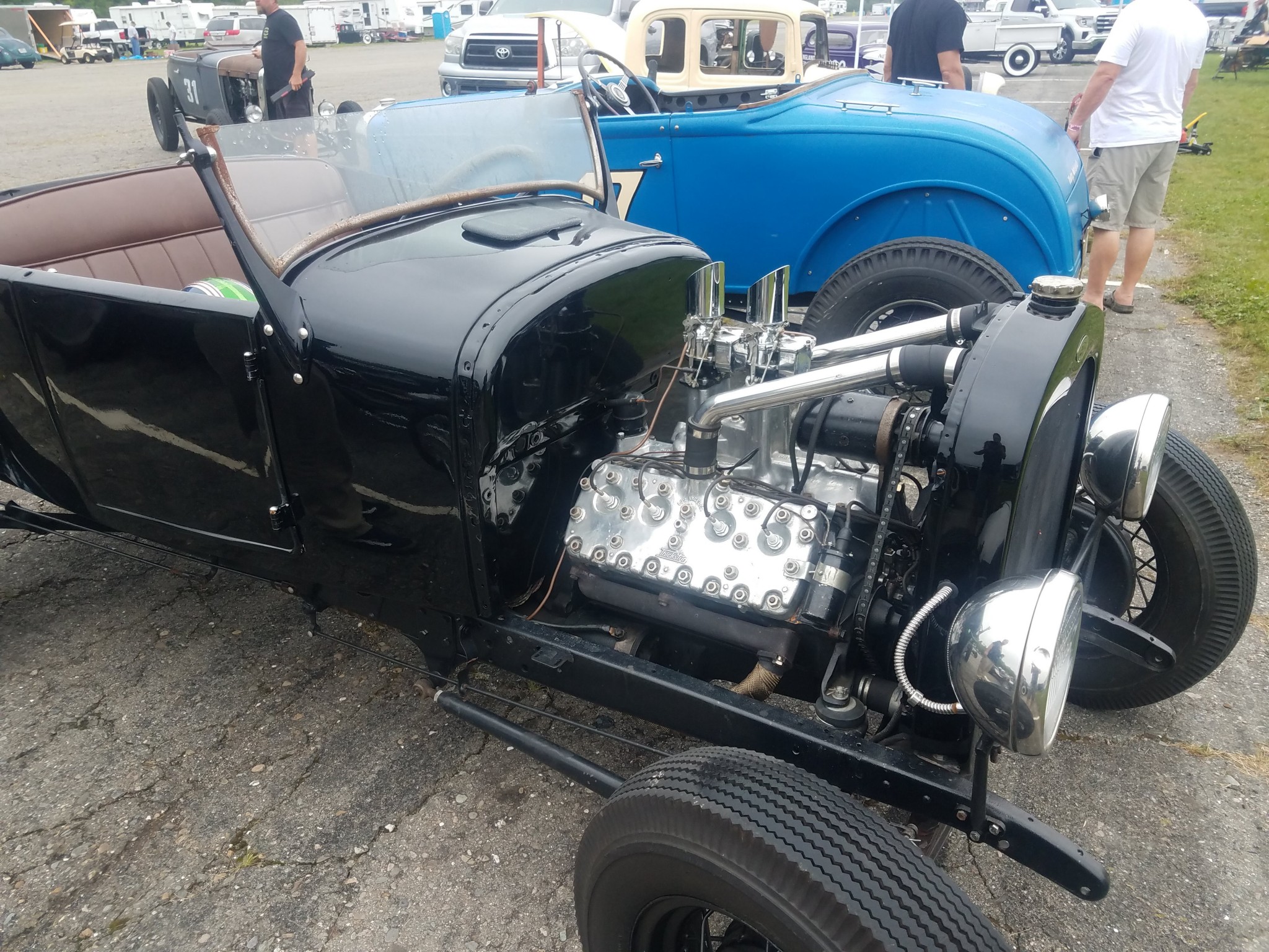

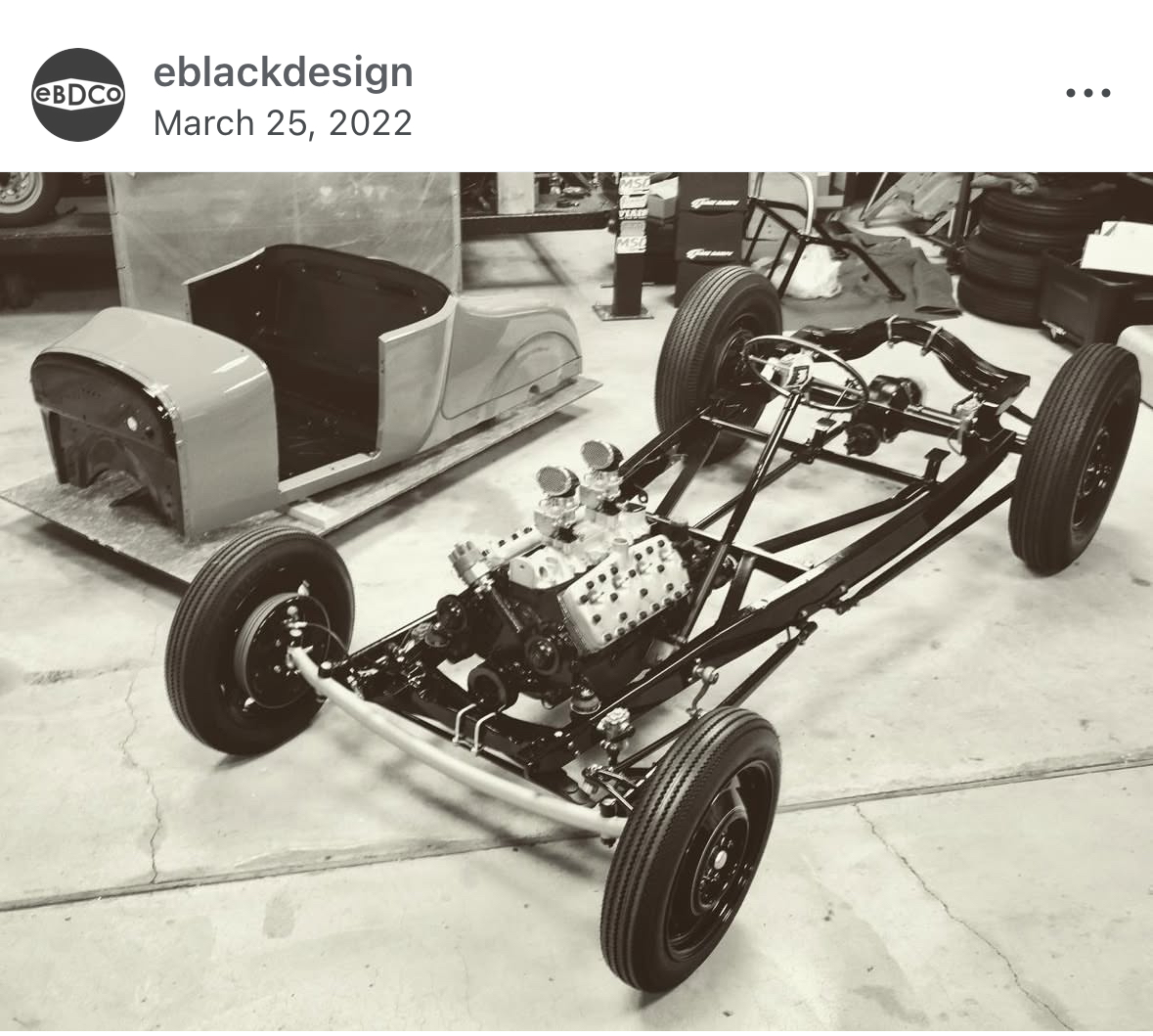

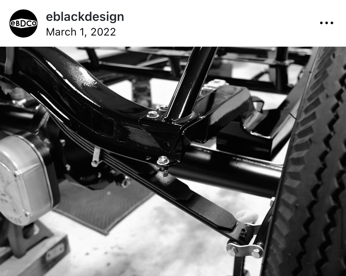

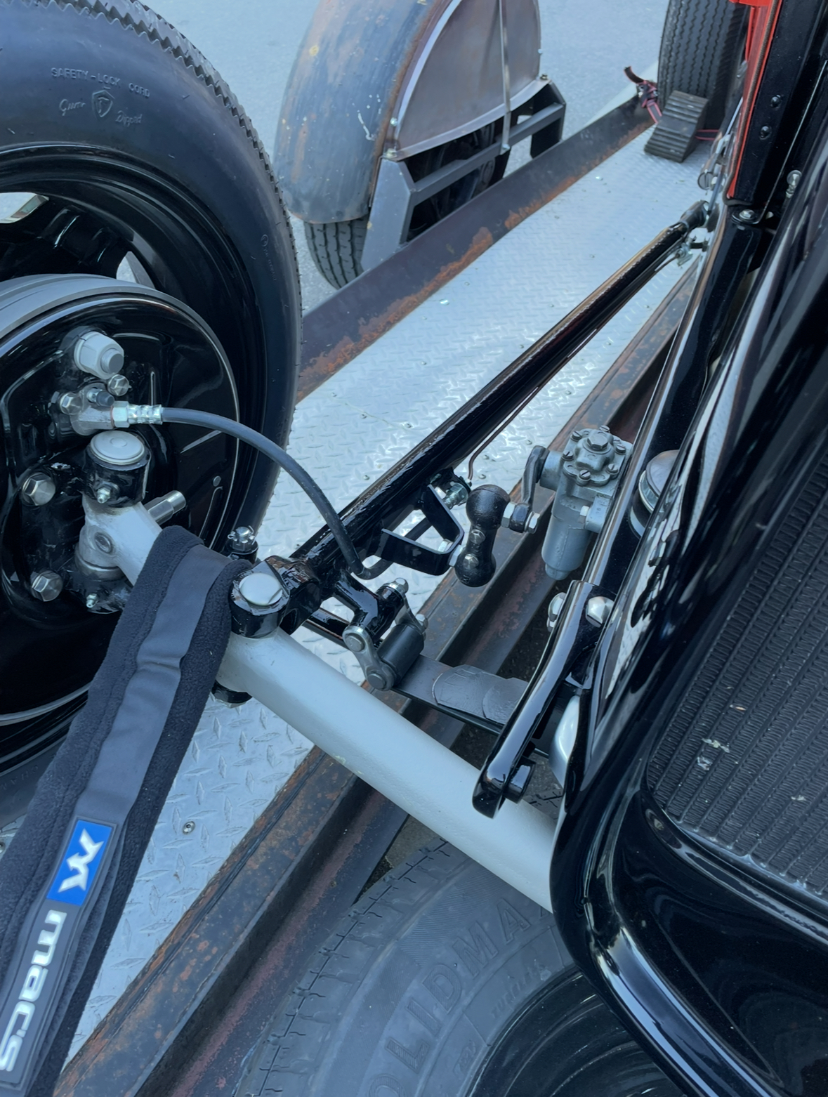

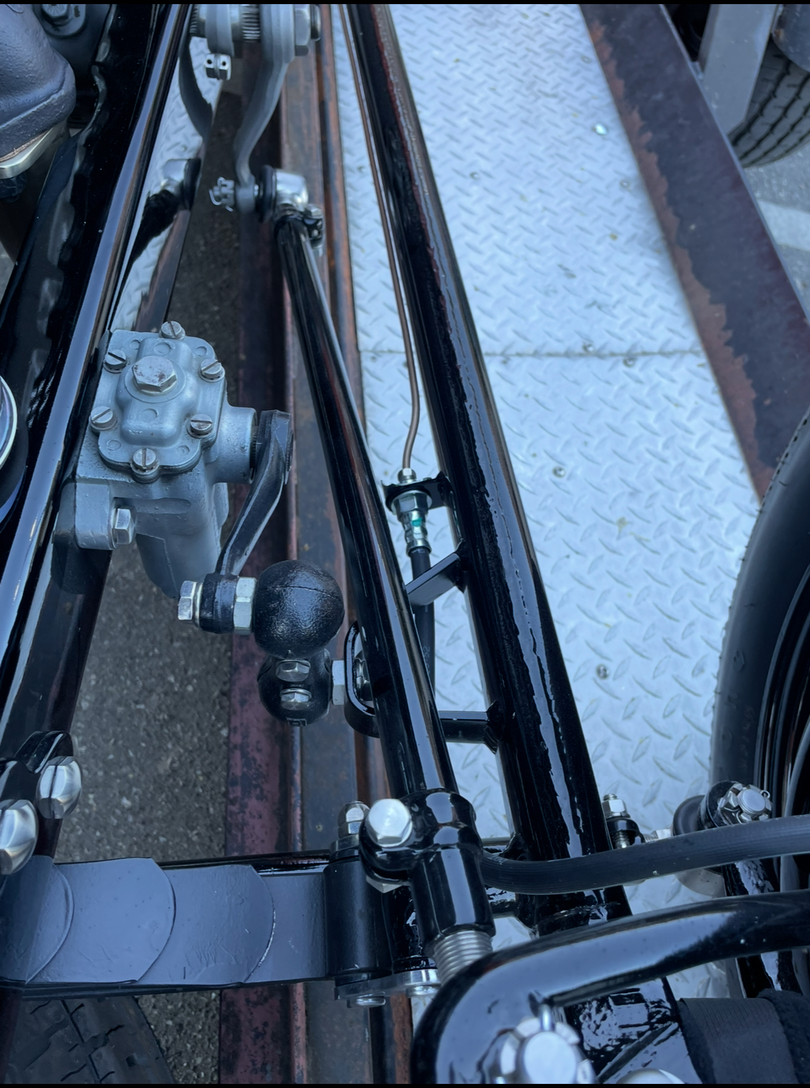

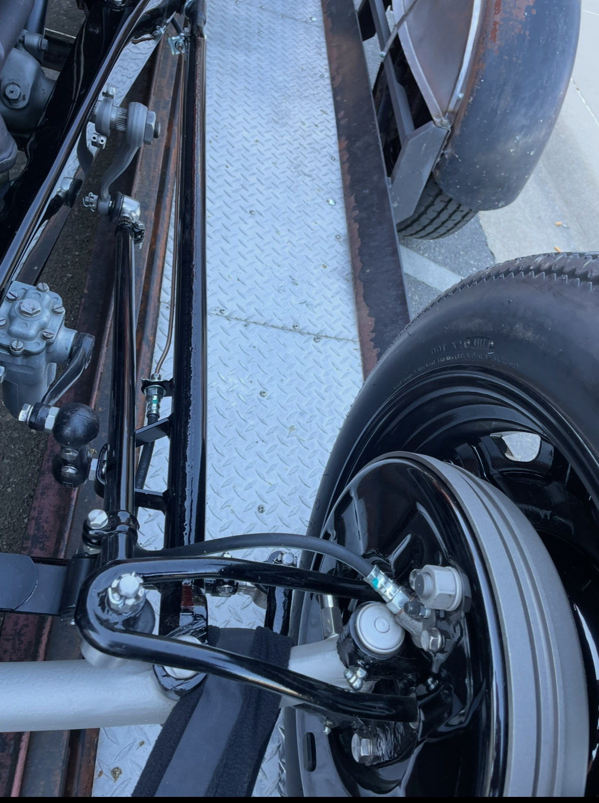

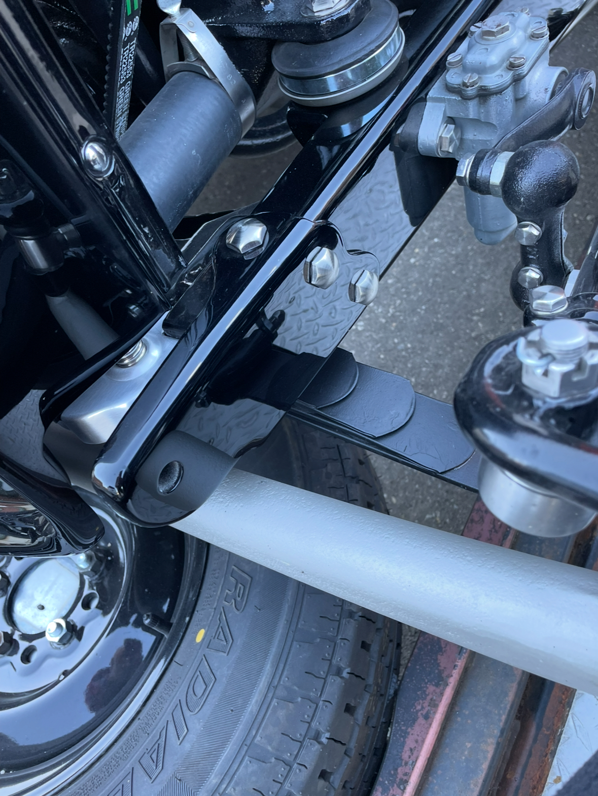

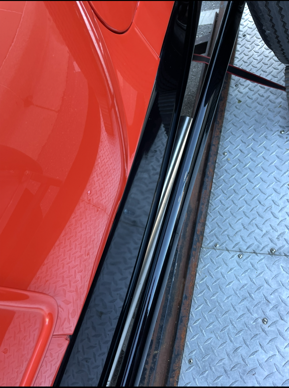

    Few chassis shots of Eric’s roadster since we are on the topic.
    His is sitting on ford TT rails but the height is very similar to a 32. I was curious how he tucked the rear cross member into the car and had to go snooping. IMG_9888.jpeg Wether I channel the car like the weiand roadster or leave it on top - possibly dropping the floor some like @BigJoeArt did- that half of the frame has got to fit inside the quarters one way or another.
    @flyin flattie built one of my favorite T’s and has one heck of a build thread as well. I’ll be revisiting how he approached it all as I come up on that part of the build as well

    Skip channel…and drop floor…”T” Hot Rods need all the interior you can get!

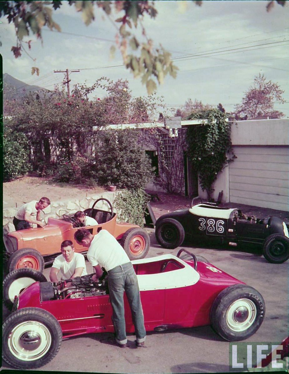

    IMG_9890.jpeg That being said here is one of my favorite roadster shots that’s been hanging on my walls for over a decade. It came from Life or Time magazine I believe? I think there were more angles from this photo shoot but I’ll be danged if I can find even this photo again online lol.
    Anyone have knowledge of these? Maybe @Marty Strode knows?

    Life magazine! I wonder if it had any text? IMG_9902.jpeg IMG_9903.jpeg IMG_9904.jpeg

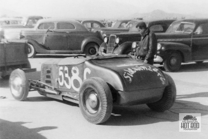

    Thanks for those pics @Tim ! 1st time Ive see those armstrong lever shocks used inboard on a rear like that.
    winduptoy and Tim like this.
  18. Wow ! Really looking forward to watch this build unfold. What a great explanation & back story how you got to where you now are ready to start building, many I am sure can relate to the evolving concept of what you want. Thank you for the support in purchasing my books, inspiration for peoples build, this is why I put them together, glad they have provided inspiration for you.
    This here I can relate to I have the '27 T RPU, 2nd '25 Chev roadster and building bucks for a '25 T. There are times I just run over ideas thinking best way forward drinking beer waiting on parts and sometimes that is a long wait, so many beers in between:D
    This right here is going to be great! I really look forward to how you go about the process of building bucks and fabricating the panels. watching with interest.
    That is a great T-V8
    Someone ask for Phil Weiand T pics?? ;)
    ImageUploadedByH.A.M.B.1414168755.099741.jpg Phil-Weiand.jpg weiand.jpg bmc_031_phil-weiands-48.jpg

  19. panhead_pete
    Joined: Feb 22, 2006
    Posts: 3,716
    panhead_pete
    Any ideas the purpose of those bumperettes?? on the rear bones of the Weiand car?

    That shot of the rear is great! Do you know if the street racing accident happened between the two versions of the car or if this happened independently of the wreck?

    nerf bars! I’m guessing like many roadsters of the era it saw circle track duty along with other motor sports activities.

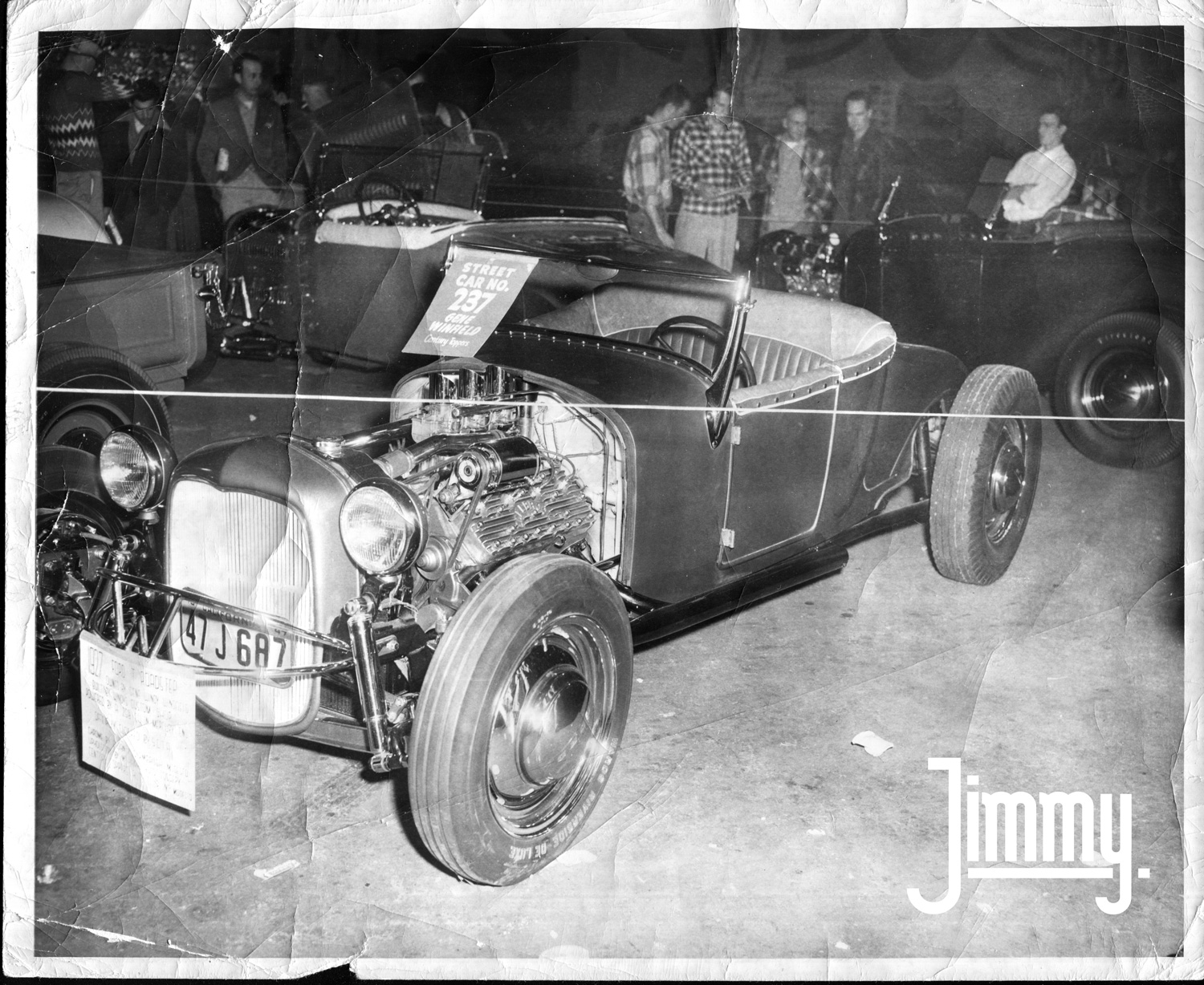

    @Jimmy B man Genes roadster was the cats meow! What a great hot rod. Looks like he’s using a spring in front wishbone, but with the spring mounted on top the spring in front hangers have been twisted around into shock mount duty!

  24. Another of Gene's T (pg54 Authentic Hot Rods)
