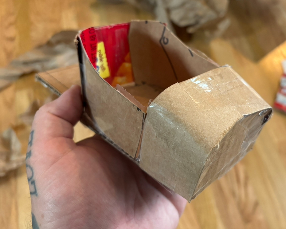

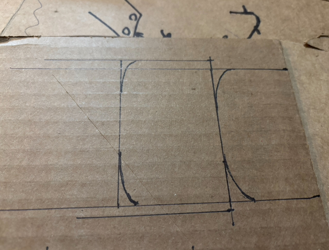

  9. Tim
    Joined: Mar 2, 2001
    Posts: 20,263
    Tim
    from KCMO

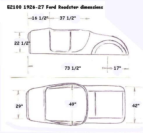

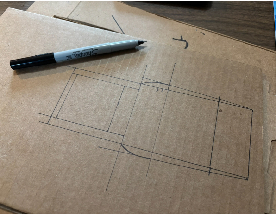

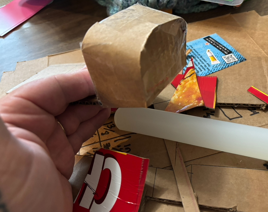

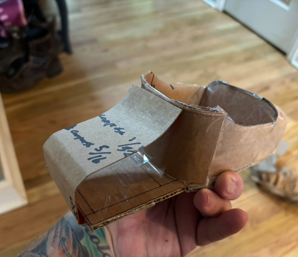

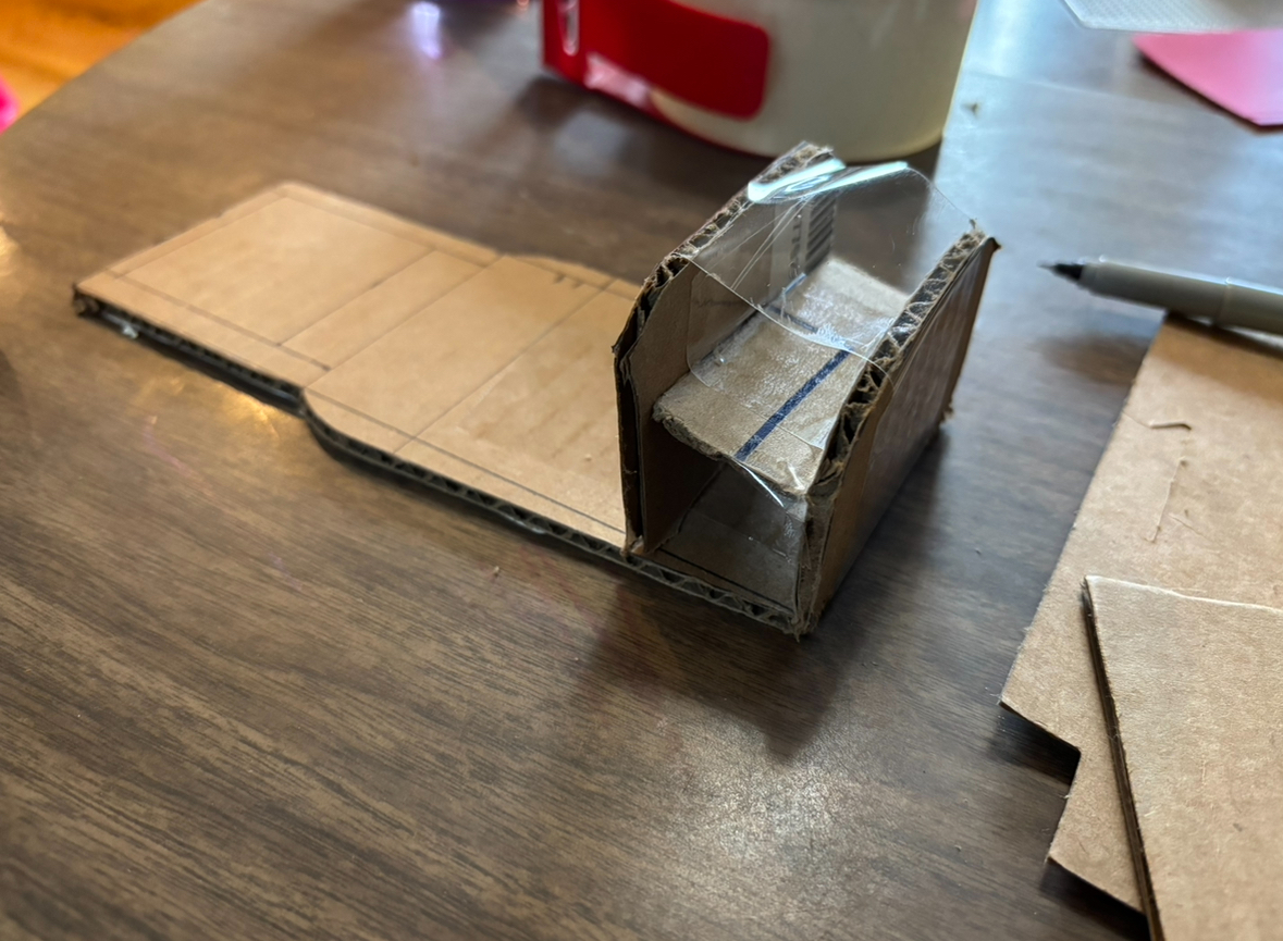

    Alright so after breaking down the shapes kiddo and I decided to make cardboard hotrods this morning.
    IMG_9913.jpeg I used this sketch I found, which I have no idea if it’s even sorta accurate measurement wise but I figured the proportions are close enough for a cheese its box mock up. I think the top of the “bucket” and the tulip panel seem wrong to me so I change mine a bit. IMG_9978.jpeg IMG_9979.jpeg so first on normal box thickness cardboard I cut out a floor pan, fire wall and dash. IMG_9980.jpeg some packaging tape and a little gusset to get it to hold in place. IMG_9981.jpeg skinned the cowl and cowl sides in one piece. IMG_9982.jpeg the sides/ bucket I did in three pieces but you could do it in one or two. At full size it would come down to how big of sheet you can get and how big you can handle working with. IMG_9983.jpeg then I made the tulip panel/ deck lid/ bottom panel in one piece. I had the furthest back curve pretty on the money but tape and cardboard doesn’t always want to stay put and it changed a little when I let it go
    Over all a good fact finding mission to see if my line of thinking holds true.
    what I’ve done today could be done with a slip roll or even a good telephone pole. I basically used all the methods you would use to bend yourself a one piece hood top for an early ford hotrod.
    Now the “missing shapes”
    The round bun panel at the bottom back of the bucket after exploring some options I think the easiest would be making it separate and welding it in. This came after seeing people weld in that patch and it making the shape seem a lot less complicated. I’m thinking I’ll make a hammer form and make them like you would a speed blister and then ether spend a lot of time with a hammer and dolly smoothing them out or visiting a friend with a planishing hammer set up.
    The second is obviously the quarters. I’m going to make a hammer form for those also after seeing @Jimmy B hammer his chevy quarters out it again really simplified the process in my mind. Maybe he’ll share some photos of that.
    I will hammer form the wheel wells separately and add them in.
    Those are the two big shapped areas I’ve left out of my model even though I could have pie cut the cardboard for the bun panel and taped it, and probably could make quarters bending around a pencil but I had already figured out what I needed to so I didn’t do that.
    As far as the various beads and body lines I’m still kinda weighing options. You could do them a million different ways, you could make a hammer form and do it by hand or planishing hammer, I could use a bead roller, really whatever your brain likes and what ever you have on hand.
    I plan on making this with pretty minimal tooling, it’s boardline a wheel barrow in shape.
    I’m also not making an exact clone to the ford body. I would say I’m going to be as close or closer than a good gl*** body, in that it measures the same but maybe the beads have a different crown/profile , they are placed slightly different, and the firewall isn’t stock.
    It’s a fun hot rod project. No reason to make it any more difficult than it really needs to be.
    anyhow there’s an update for today.

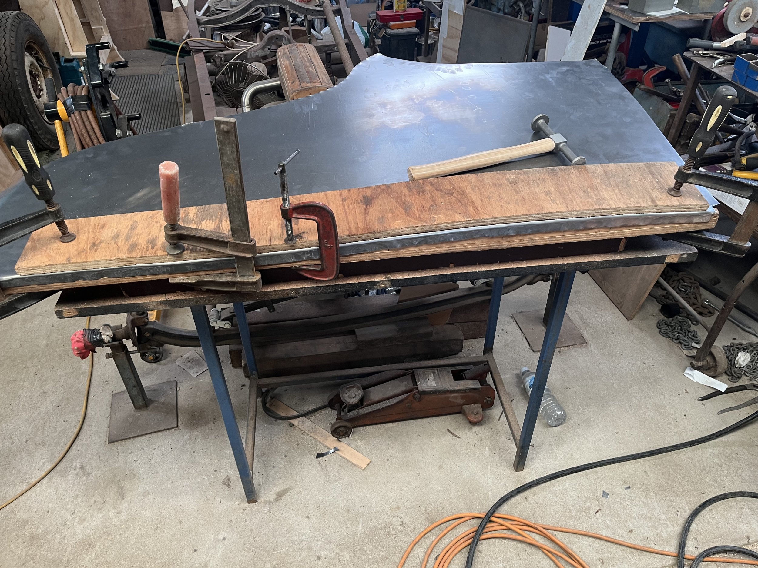

    For those bottom corner pieces of the body you could always hammer them into a bag rather than carving a hammer form. I watched Gene Winfield do a hood blister on one with a hammer made from a piece of pipe and a welding tank cap. Took him approximately 3.75 minutes. Piece of cake. Nothing to it. You should be able to knock those out in 15 or less. LOL

    @drdave yup I can think of lots of ways to do it but I am on the hunt for a stray welding tank cap for a hammer. Been “casually” looking for about 6 months lol someone’s gotta have one they are tired of stubbing a toe on ;)
    My next step is taking measurements and templates followed by building another more complete model from metal in a little bigger scale. Like maybe a “big deuce” model size

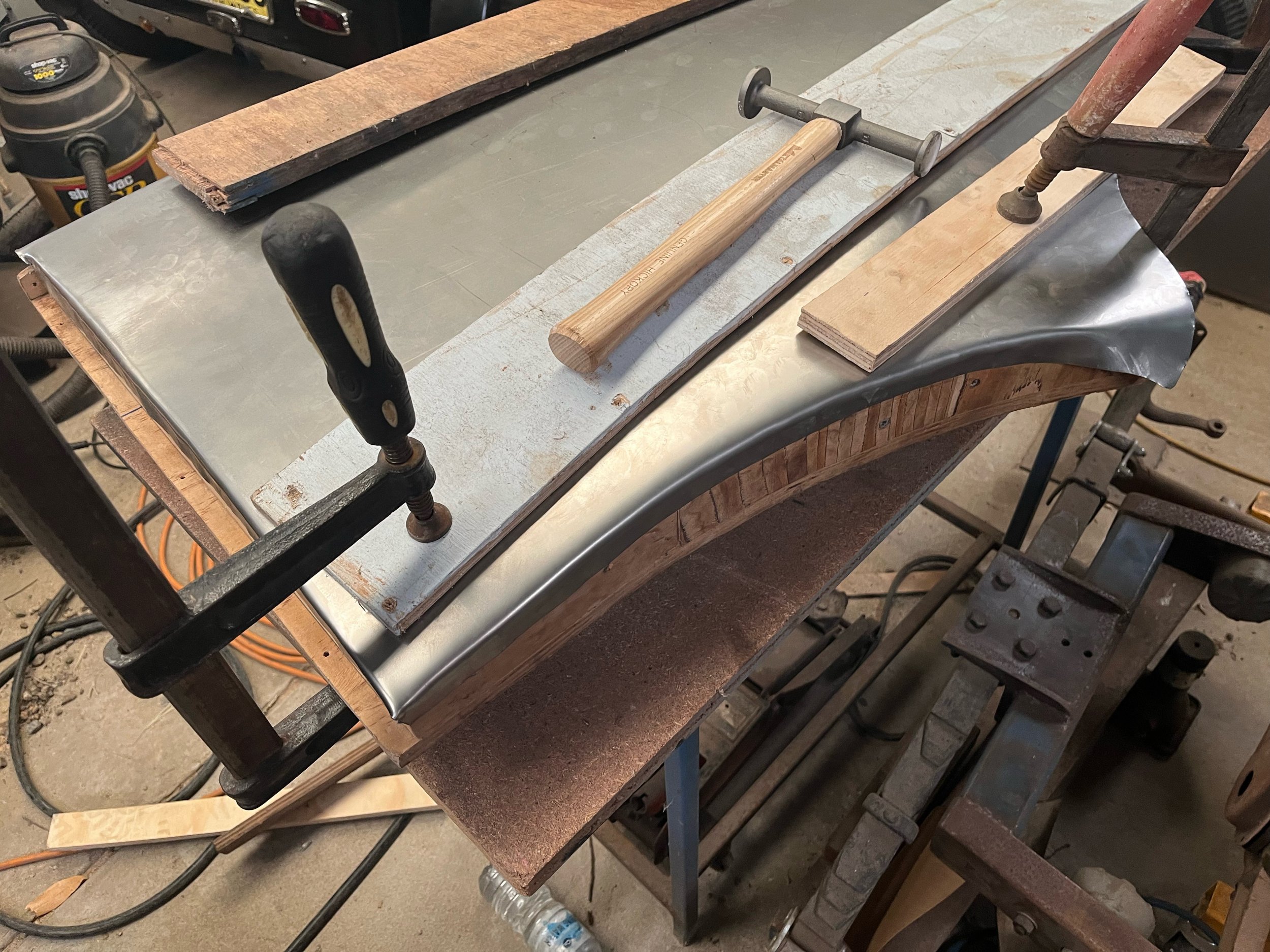

  17. winduptoy
    Joined: Feb 19, 2013
    Posts: 4,153
    winduptoy
    @atch beat me to it...and he is a lot closer. There is a fellow here that uses old welding tanks that he has polished up, turned horizontal, for panel and hood forming...just another thought
    ....and like my stuff...on a dark, rainy night at 60 mph, it all looks good as it p***es by... credit: Eddie Corbin

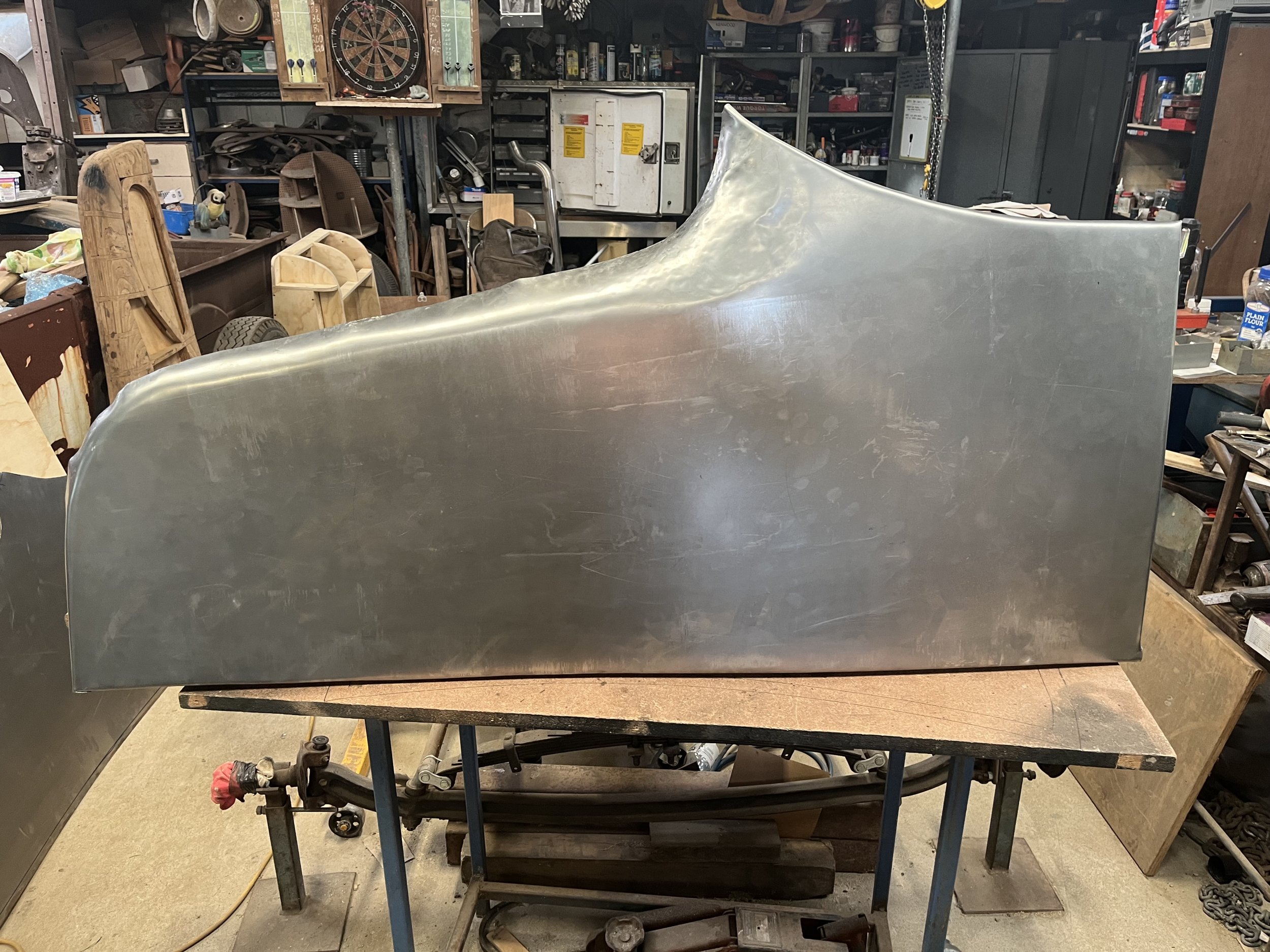

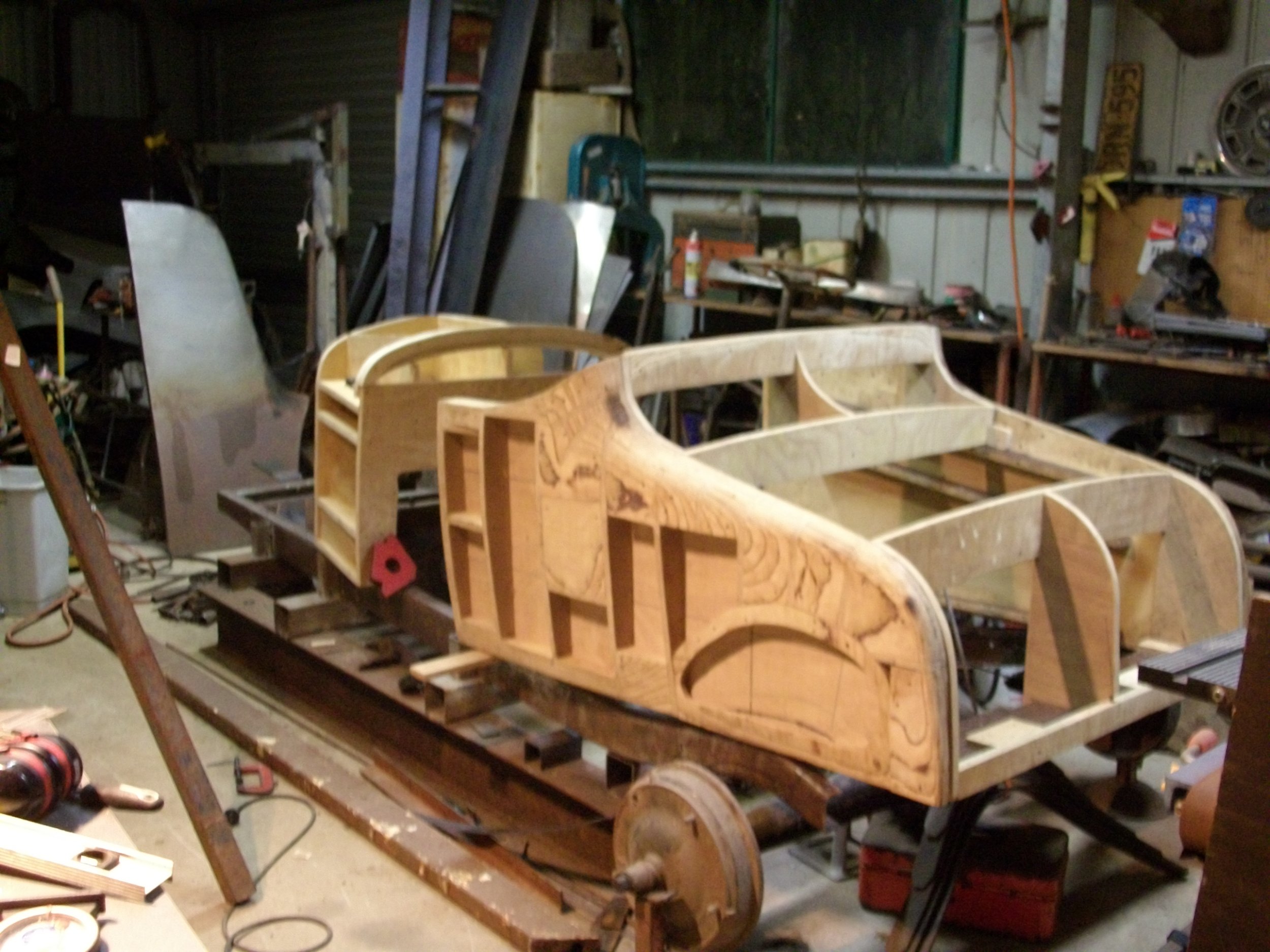

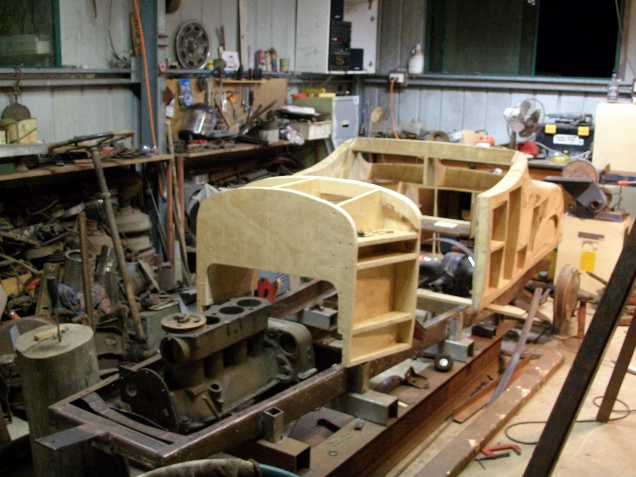

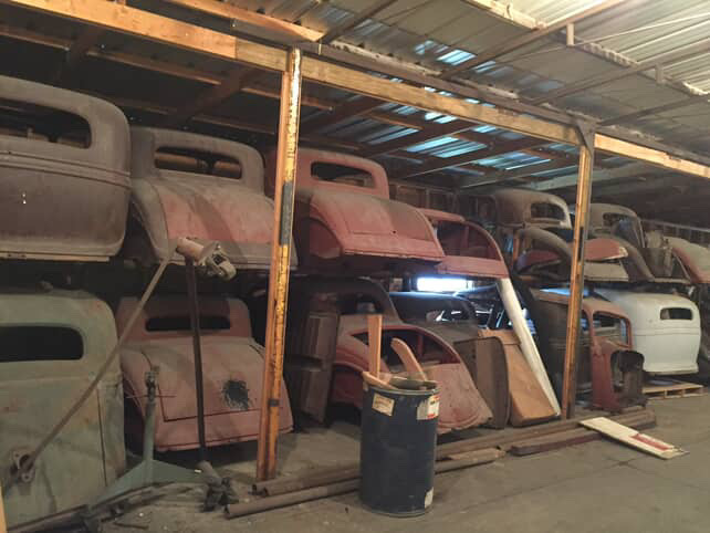

  18. If you need measurements or need photos of T body let me know
    You mentioned my body bucks so will post a few photos of the ones started in recent months
    IMG_3300.jpeg IMG_3302.jpeg 15ECC8A4-3D73-40D8-837C-45D23166CED9.jpeg IMG_3293.jpeg
    I built the bucks in 2011
    brEad, charleyw, 69fury and 12 others like this.

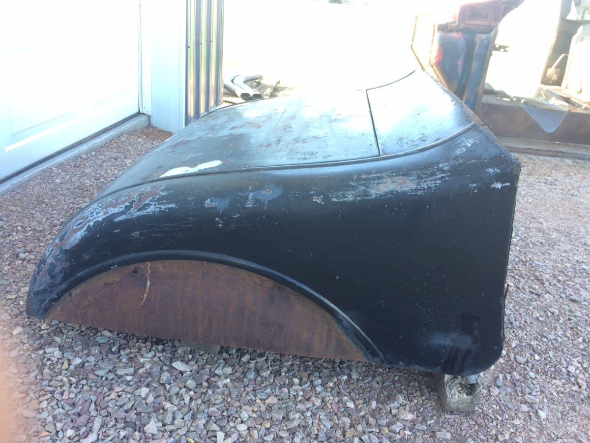

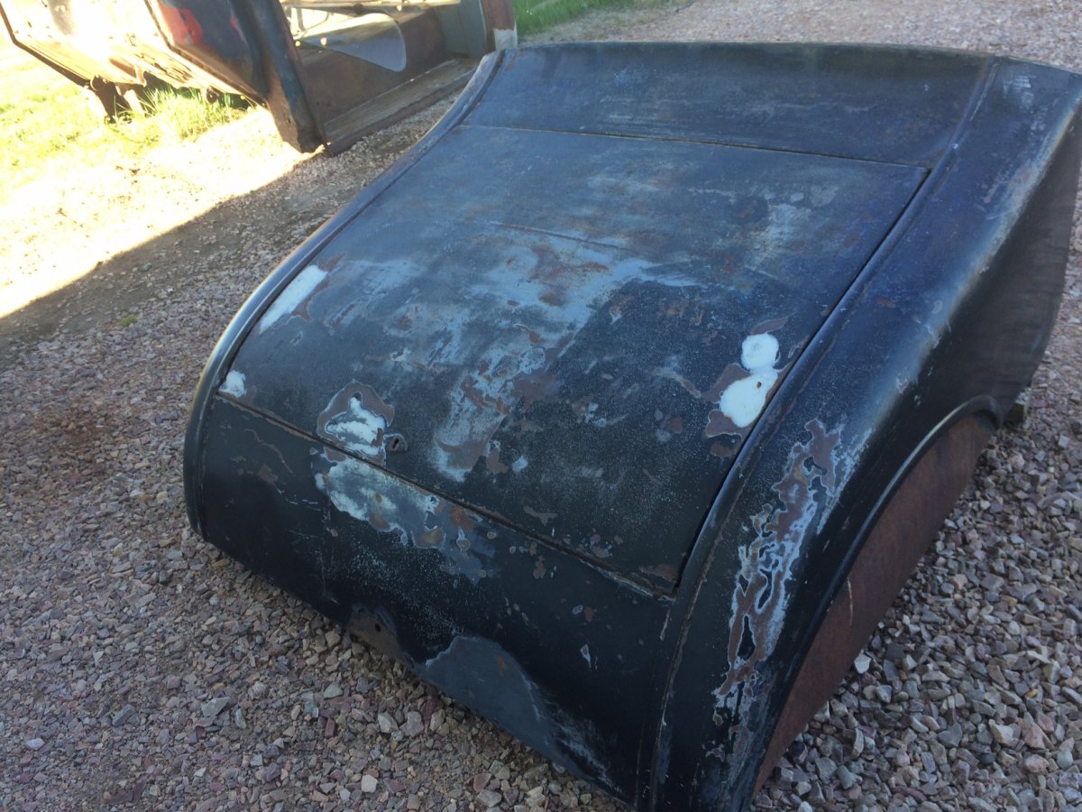

    Really looking forward to some hands on time with a real roadster. It’s really hard to tell in photos if the top of the deck / tulip panel has a little reverse curve going on or not. I may have to find some photos of a deck off the car but even placing your hand on it will tell you what it’s doing.
    I’m also noticing that some of the cars have a thick bead between the quarters and the trunk lid/ center panels.
    im wondering if this isn’t a T strip like on the back of a model A Tudor thst fits in the seam and not in the panels themselves. It would explain the some times it’s there sometimes it’s not.

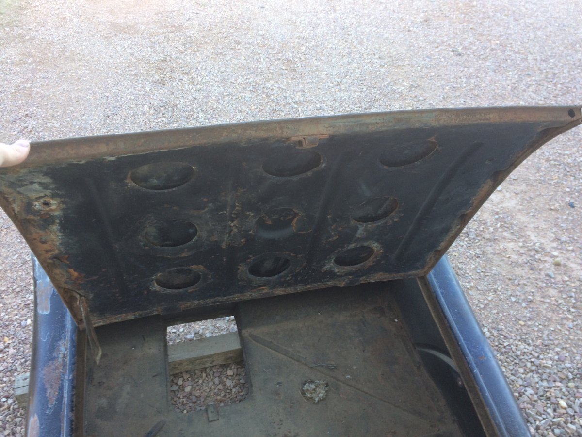

  24. Tim
    Joined: Mar 2, 2001
    Posts: 20,263
    Tim
    from KCMO

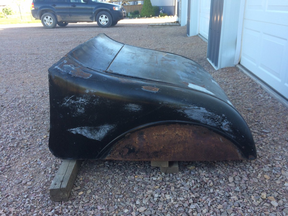

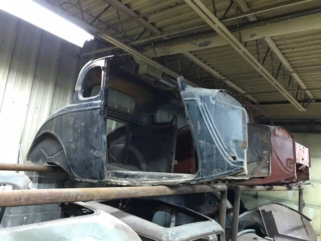

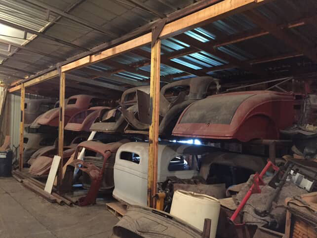

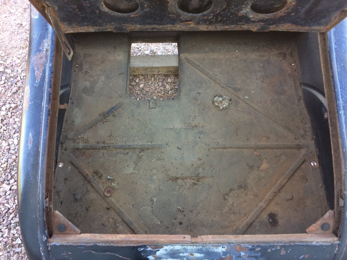

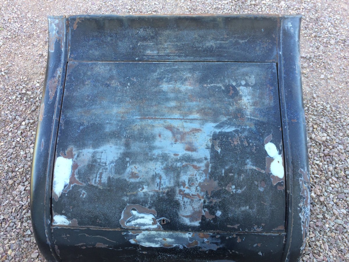

    Found some photos I saved for reference of a deck that was for sale a while ago.
    From behind it looks like the tulip panel - I’m meaning the panel above the trunk lid, some times people call it a cat walk also- looks like it does not have a reverse curve and that it may be an optical illusion from the way the quarters are shaped where they meet that panel. IMG_9992.jpeg IMG_9993.jpeg IMG_9994.jpeg IMG_9995.jpeg IMG_9996.jpeg IMG_9997.jpeg
    Just something to chew on.

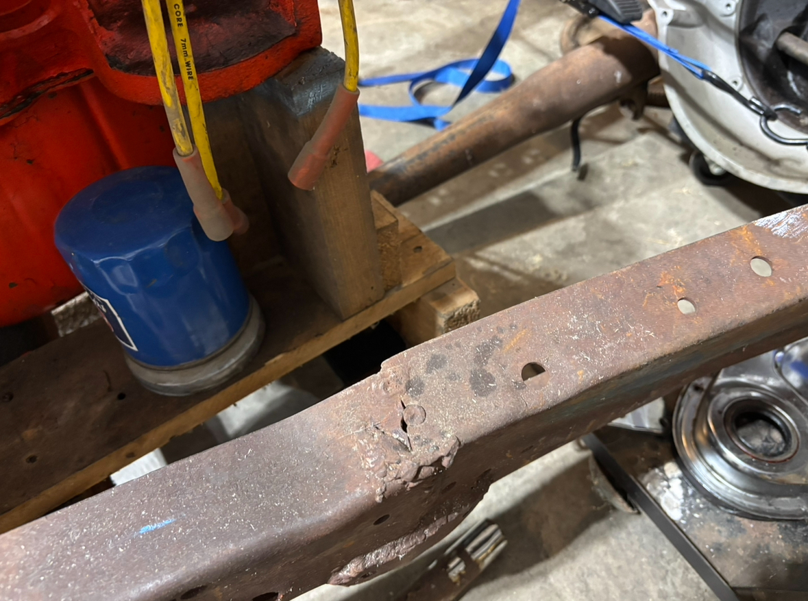

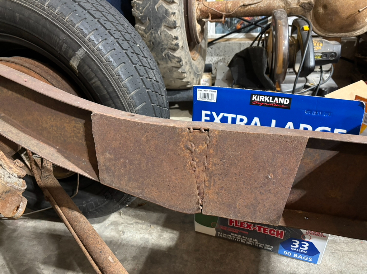

  25. Tim
    Joined: Mar 2, 2001
    Posts: 20,263
    Tim
    from KCMO
    Hey @Ryan glad you dig it :)

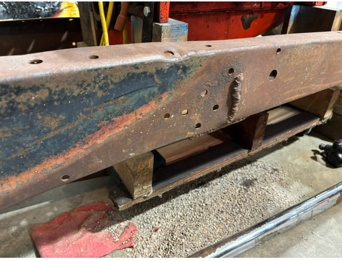

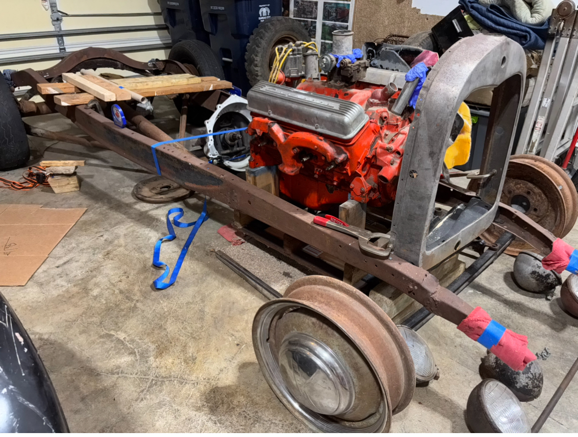

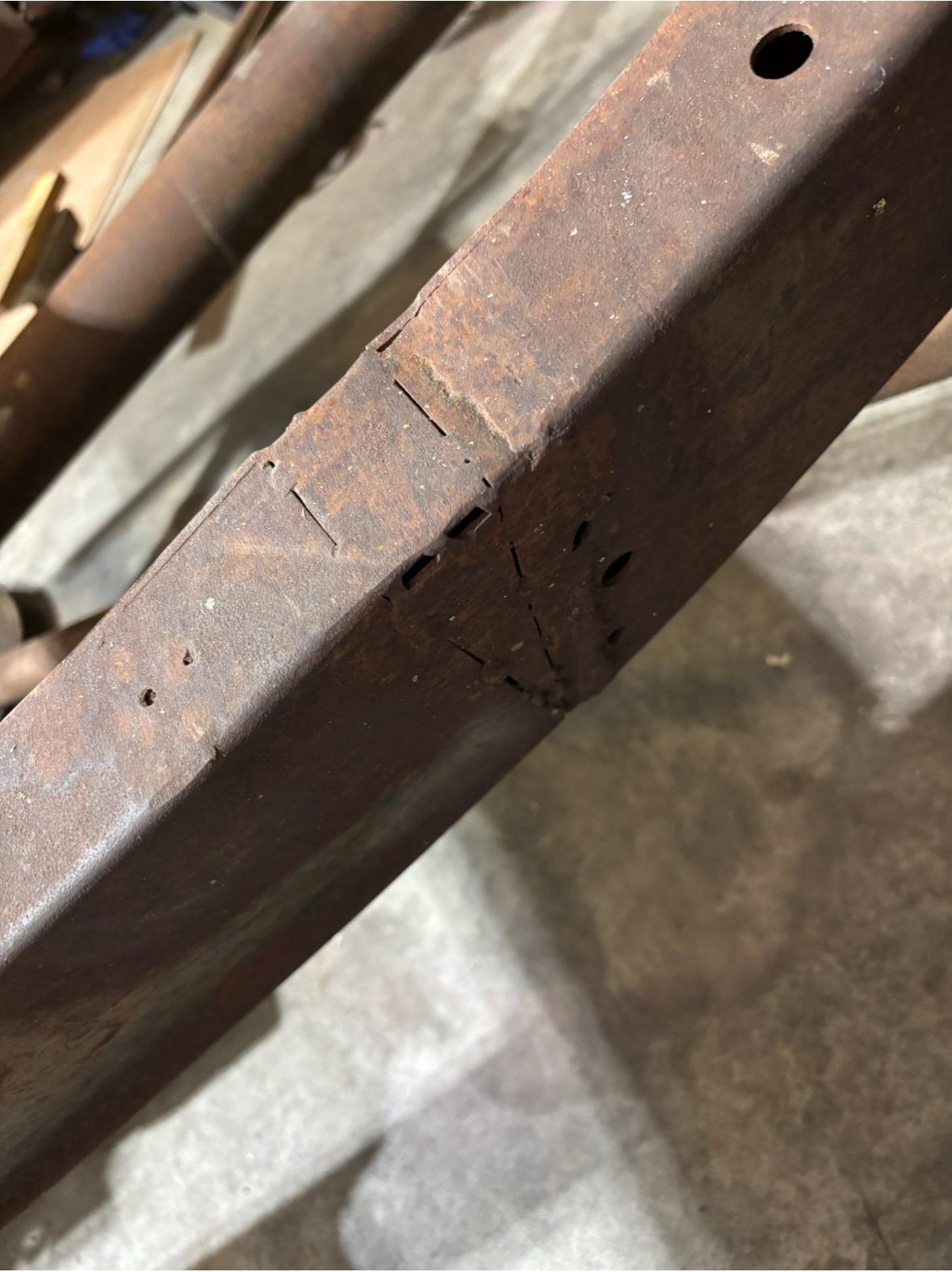

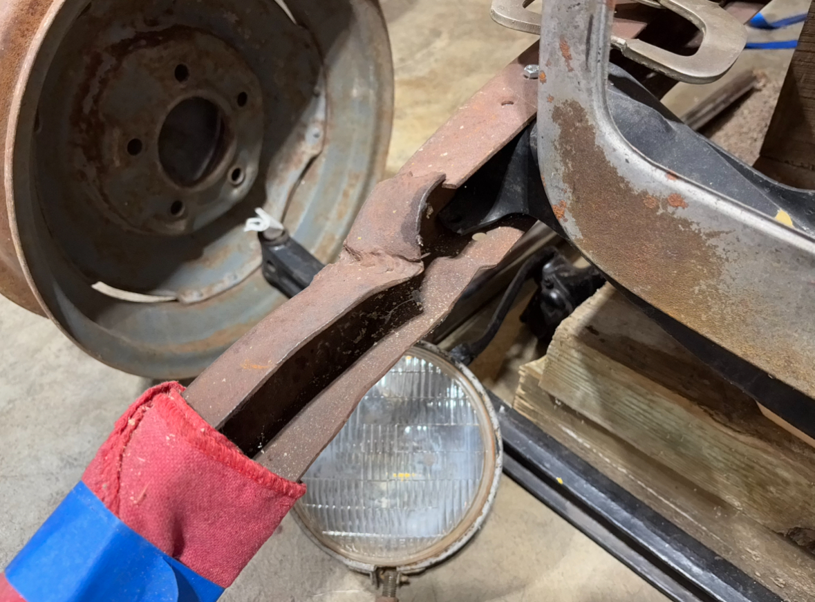

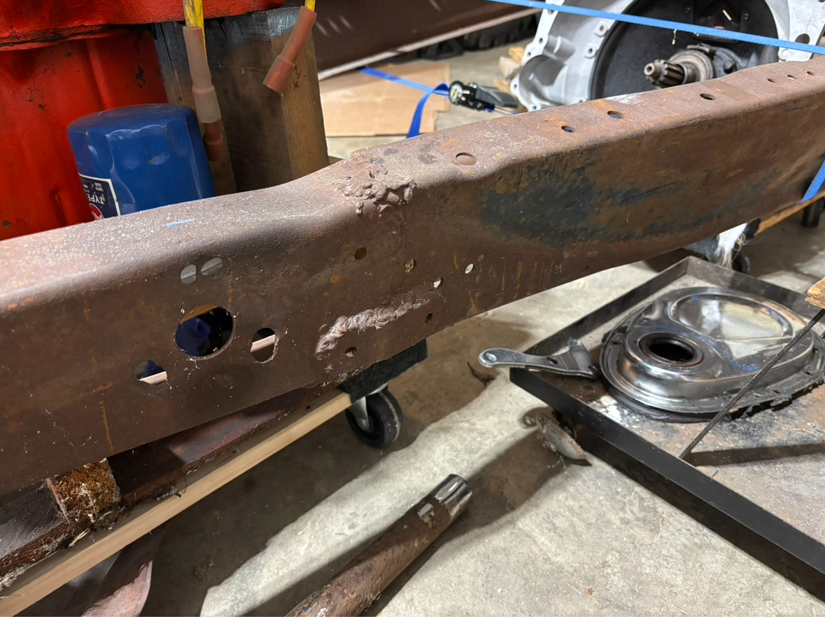

    Here’s a parts story for the day. I ended up with these frame rails as mentioned before and thought I’d share some detail photos and a little more back story.
    IMG_0011.jpeg So looking front to back we have stock length but really mangled frame horns IMG_0012.jpeg then we see a fat weld that was holding something to the frame, from the inside there is no IMG_0013.jpeg damage. So let’s move to the drivers side IMG_0014.jpeg bingo! I’m gonna say this little tab and the other side were mostly likely holding the ends of a split wishbone. IMG_0015.jpeg the damage to the top of the frame roughly where the steering box would be makes me think the front ran into something hard enough to mangle the horns and push the steering/ steering box all at the same time IMG_0016.jpeg IMG_0017.jpeg in the back we can see the frame was pie cut and leaned up to “Z” the frame I figure. Someone was un doing that a long time ago obviously. IMG_0018.jpeg it also has the rear horns lopped off which makes since with the pie cut rails. Im sure they would protrude any sheet metal around it.
    I traded into the rails but I know he got them from a mutal acquaintance so I asked if he knew any back ground. He said he pulled them from a horde in Kansas around June 2018-2020 this isn’t even touching what he found but you get the jist, it’s one of those urban legends kind of finds. 18E507D6-DF87-40B8-AEBA-EE0FF2872431.jpeg 2B301A06-55F5-4589-9762-89387F490BC8.jpeg 8A771C8A-C2A6-44F8-ACB3-0703269F6681.jpeg Several of these bodies have already been turned into some really cool hotrods you have probably seen online.
    So there’s today’s little parts story :) hopefully the next updates will be about measuring and making templates
