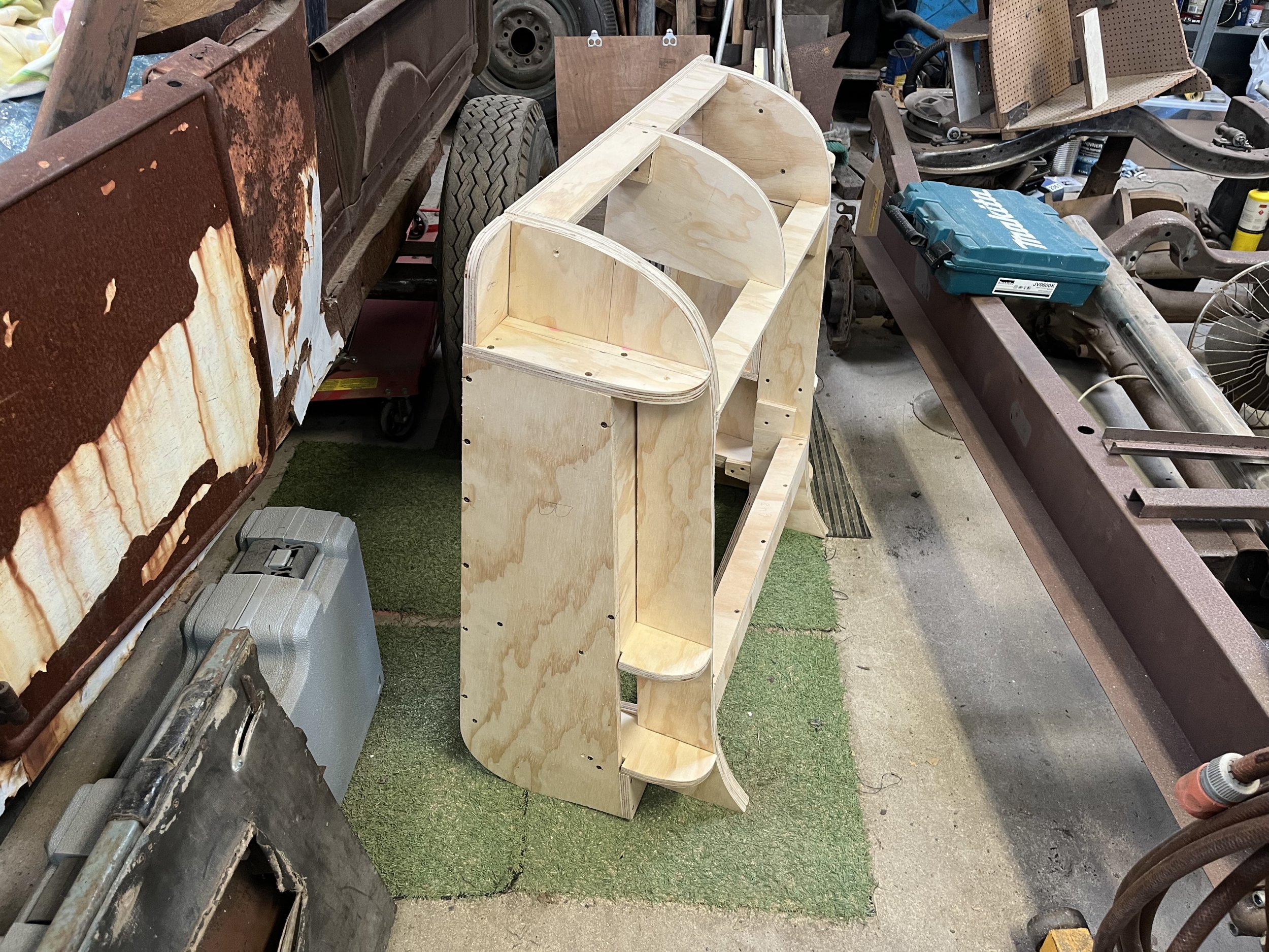

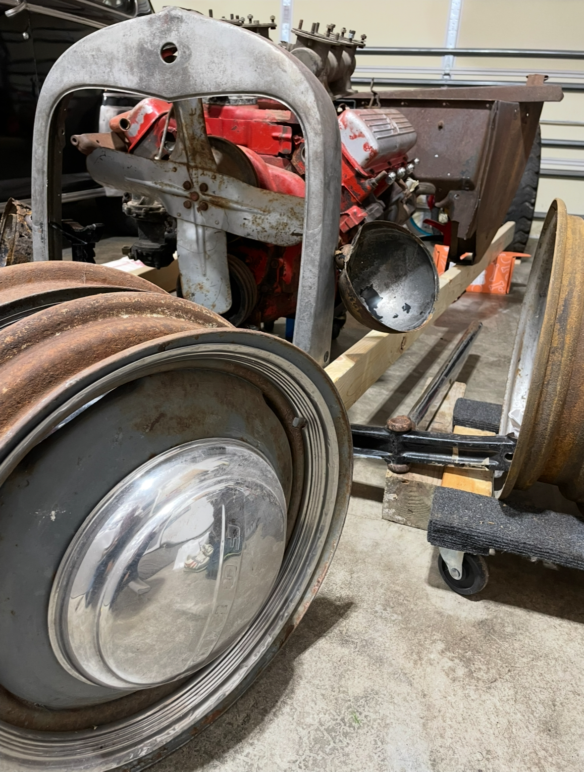

    IMG_0067.jpeg I’m going to try to post an update this evening but here’s a teaser until then :)

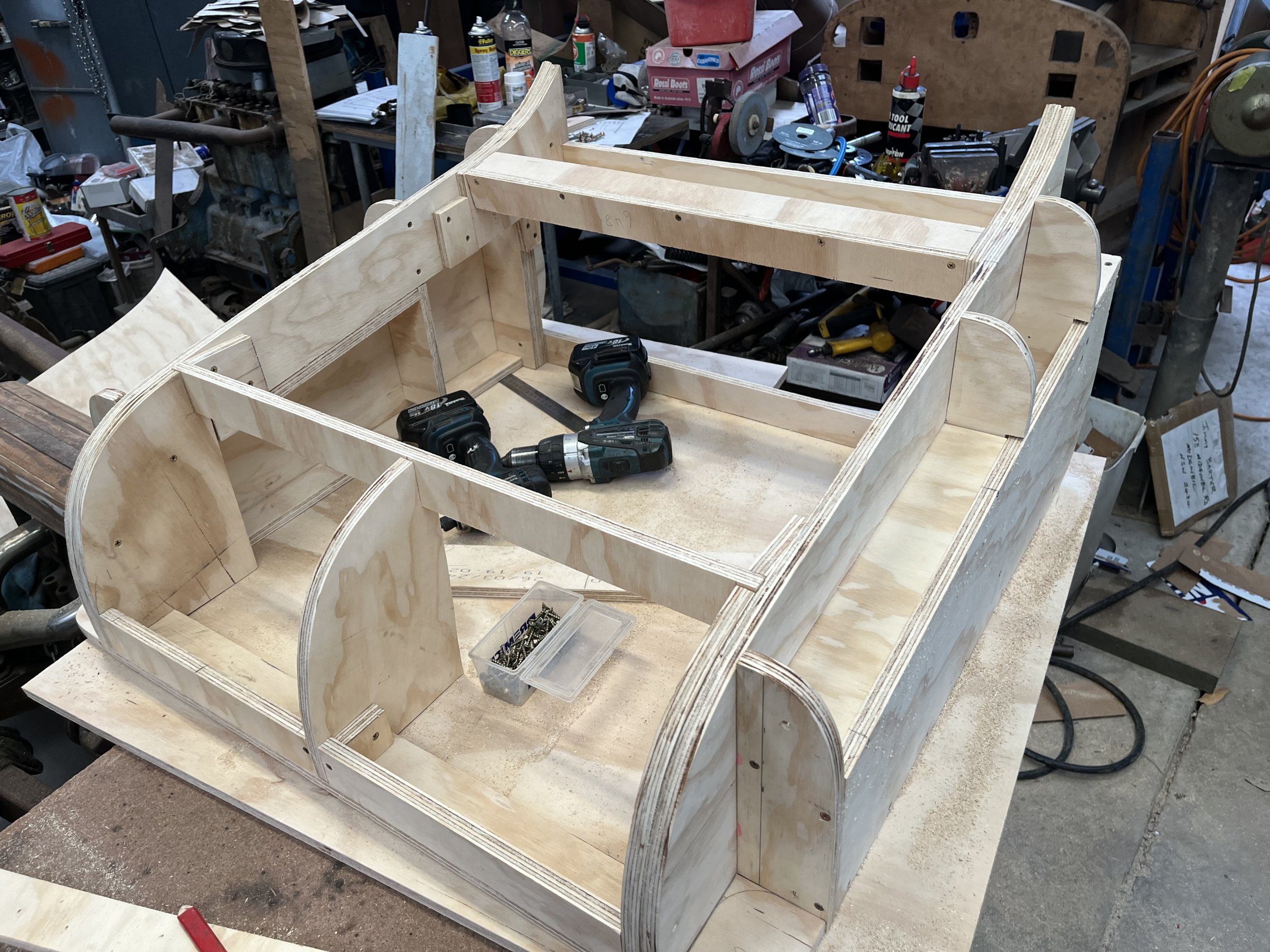

    Alright not quite Ukrop O’clock but late enough so let’s get an update.

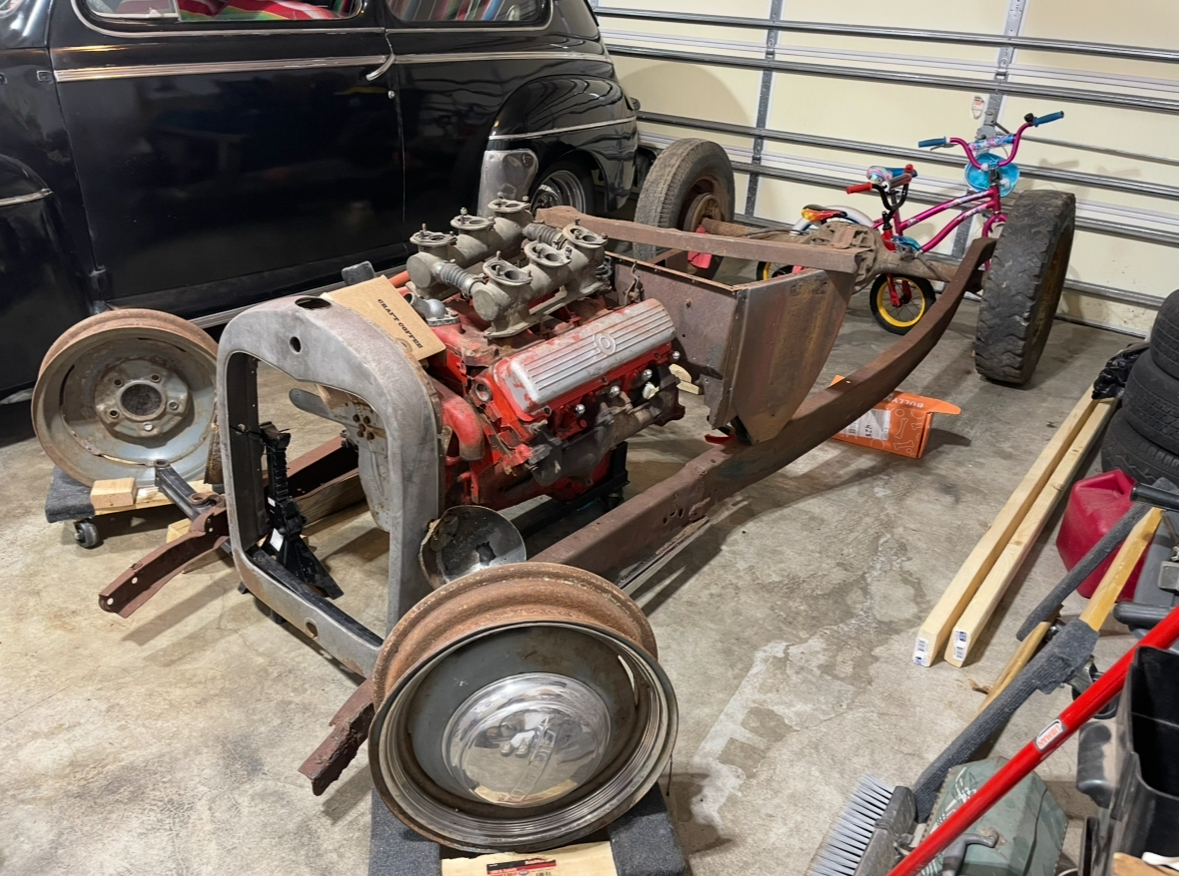

    This afternoon I went to my buddy’s house to measure and template his roadster and two and a half hours later I had run out of time and had measured… most things. I’ll have to go back in a few weeks when I have some time to make a lot of templates and measure some more.
    That being said I answered a LOT of questions just by putting my hands on the car, holding up a straight edge and measuring. A lot of measuring.
    Since we like stories here’s a little bit about this roadster I’m measuring. It was brought back to Kansas City from North Carolina after being discharged from the Marines on the top of his olds j2 powered 37 ford! Dropped axle and Louvered hood equipped as well.
    Lots of great story’s. Including opening day of Kansas City’s first drag strip in 1956 that’s his 7” channeled 34 ford sedan on the far left. Did it with a hammer and a chisel! Said the neighbors were happy when he was done banging on that thing haha.
    I’ve also begun reviewing a favorite metal shapping book. It’s a good one if you are looking to add to your library. IMG_0073.jpeg

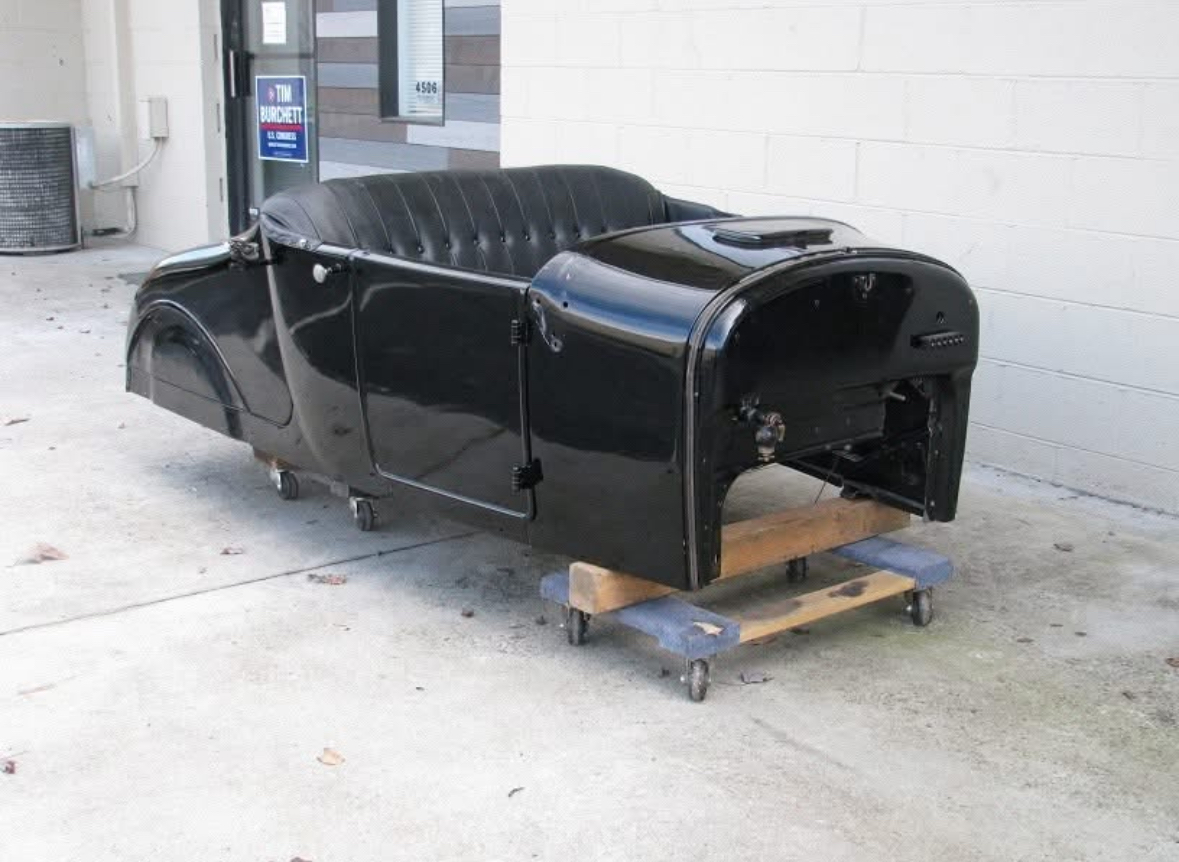

    @rjgideon every time I talk about this project I echo a similar sentiment.

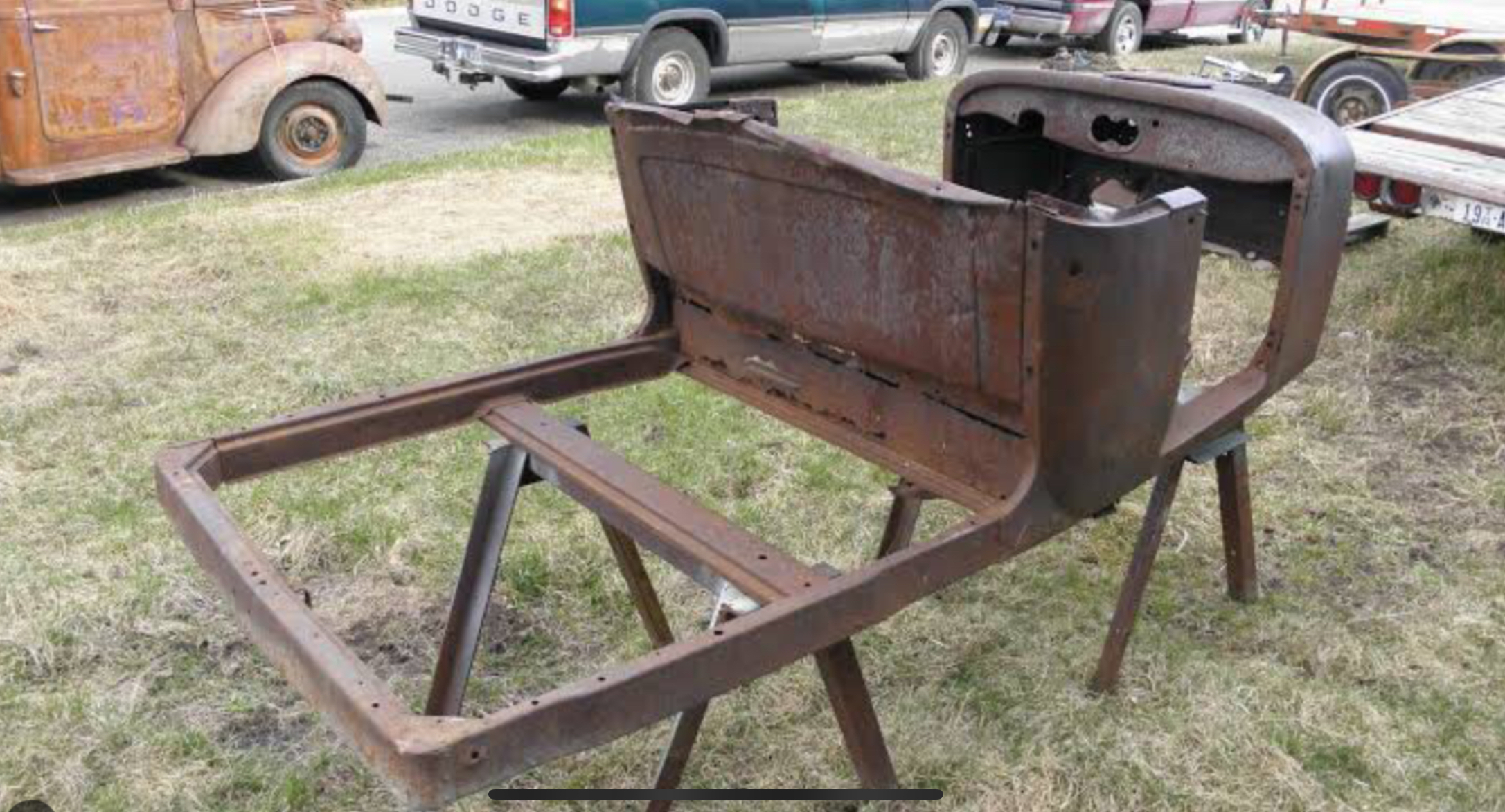

    Even the bodies that are out of my price range have been knocked around for very near 100 actual years. They’ve been “fixed” and banged up and fixed again a dozen times before most of us were born.
    Looking to the other side the gl*** bodies really aren’t that much better. They might be the same side to side but I’ve yet to find one that is 100% accurate. The beads are the wrong profile, the wheel wells are gone, some crown is missing from the panel. On and on.
    I saved these photos just to have some sort of reference of how a good one looks and how it looks partially apart IMG_0029.jpeg IMG_0028.jpeg this VERY nice black example actually shows very well a section I will not be copying.
    Looking at the inner wheel well there is an arched shape that crests out the further up you go. Down below the shapes are continued onto the subrail.
    I WILL be keeping the wheel wells as I don’t really care for the deleted but I’m leaning towards putting a more model A-32 type crows foot bead in the panel, and the subrail will be straight /flat.
    The car I am referencing has a top on it so I’m running into a few road blocks measuring for certain the top back, some of the upholstery also gets in the way but I can get 90% of the way and then go pay another friend a visit to get the last 10% off his. IMG_0076.jpeg

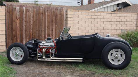

    @duecesteve thanks! It’s VERY nose down, looks really good from the rear 3/4 but it’s hard to get a “good” photo of how it really looks.

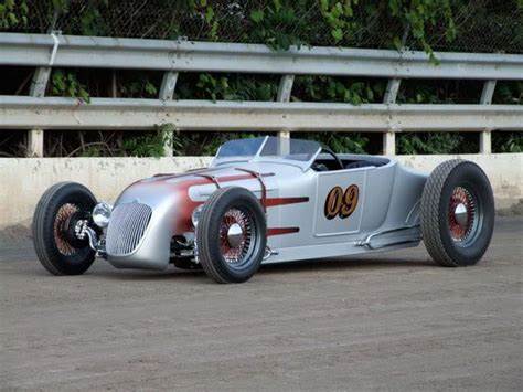

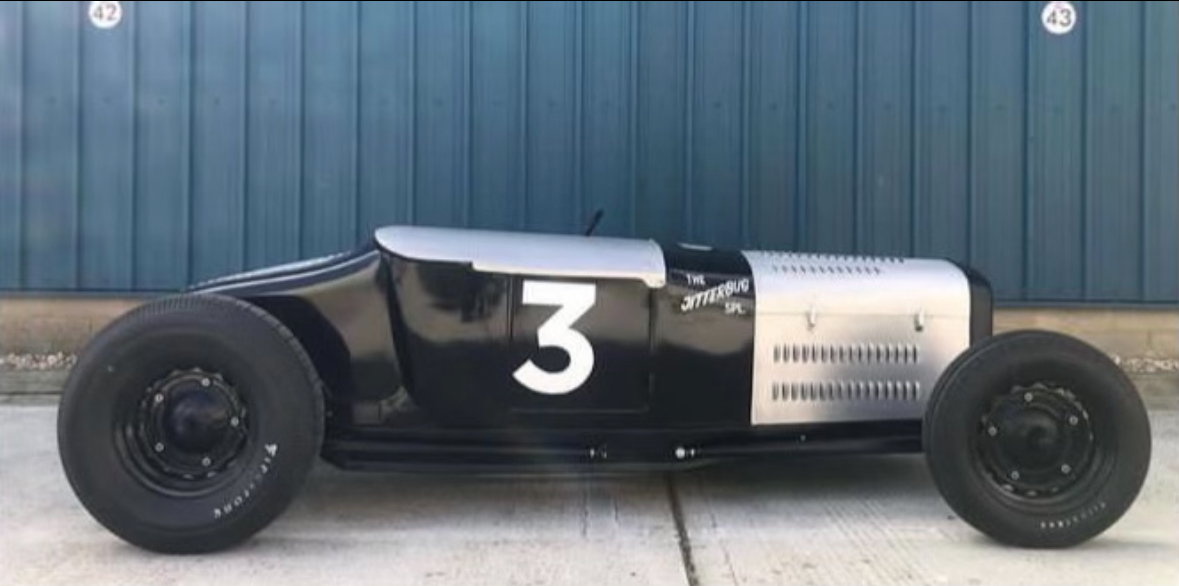

    One of tonight’s T related thoughts is windshields.
    @Jimmy B got any good examples of track roadsters in street garb ?
    winduptoy and duecesteve like this.
  9. duecesteve
    Joined: Nov 3, 2010
    Posts: 1,208
    duecesteve
    I don't have any toys since I sold my '35 Ford truck but one of my neighbors stopped by the other day and says his dad has a Total Performance "T" sitting in his garage for a bout 5 years he's gonna find out about it :)
    Six Ball and Tim like this.

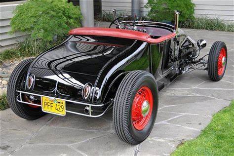

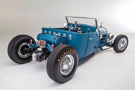

  10. duecesteve
    Joined: Nov 3, 2010
    Posts: 1,208
    duecesteve
    Heres a few :) I like the bottom one best! But the blue one is pretty slick too! Some good inspiration keep on building!

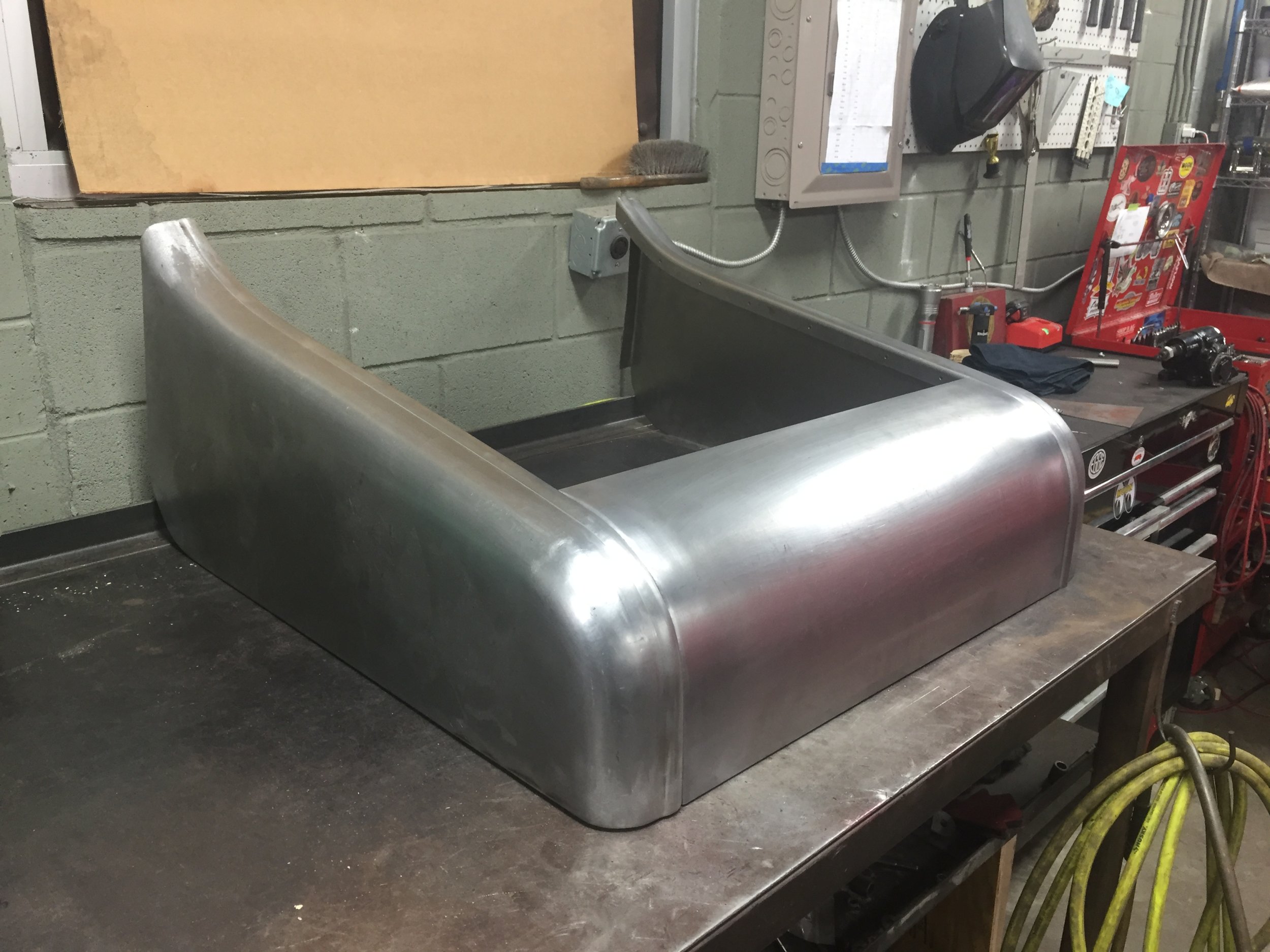

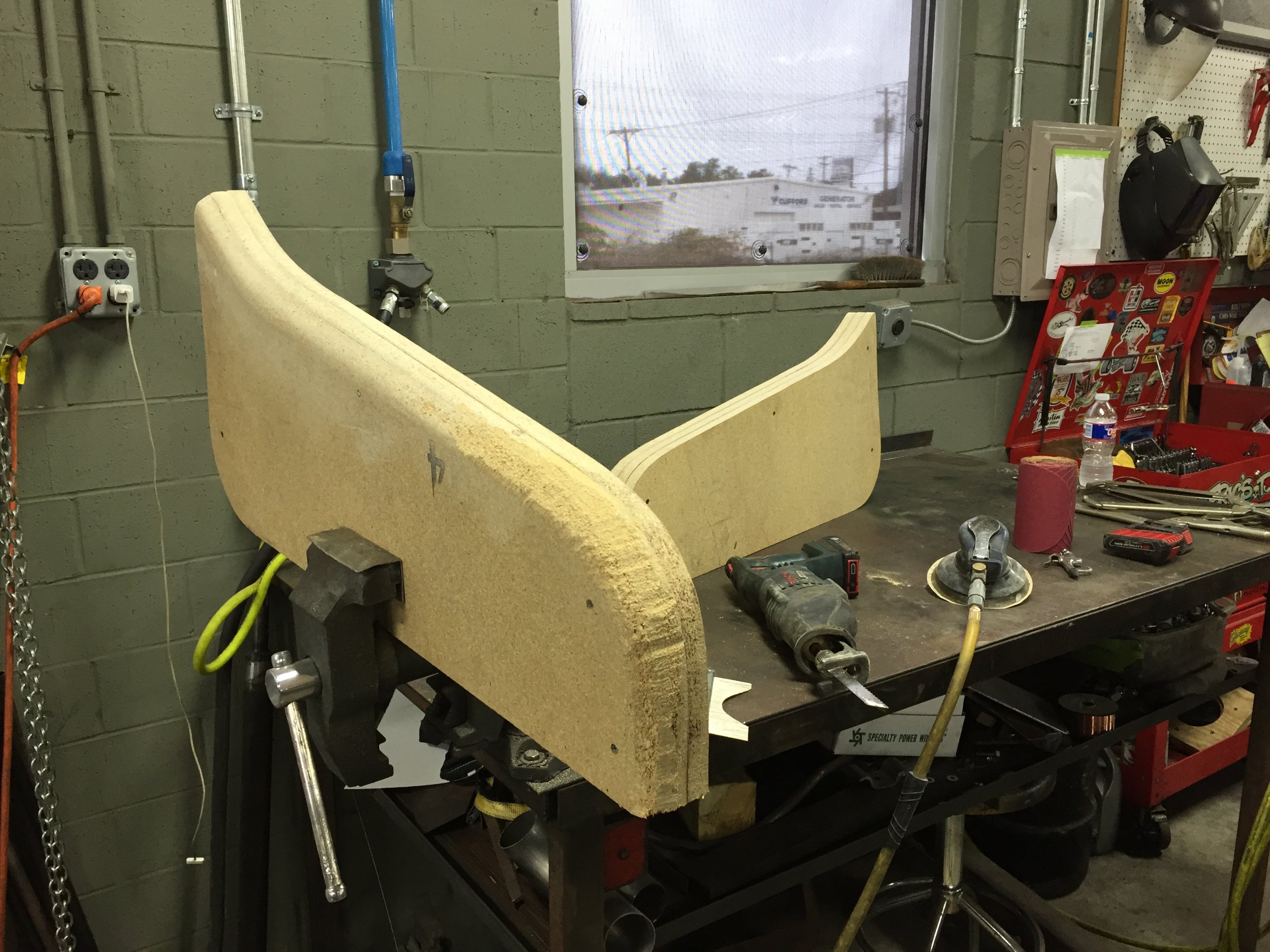

    he posted this early T deck buck recently and it’s just a great example. Thought I’d share, a little for you but also to kind of “book mark” the information for myself. IMG_0087.jpeg IMG_0086.jpeg IMG_0085.jpeg

    So is he going to shape sheet metal over that like a jig and make a M***aratti? Lol Very cool that looks like a fun project.

    Click the link and find out/ follow along

    I've been following Jimmy B's early Chevy roadster builds for years. He is a great source of inspiration for my '26 Chevy build. I am very much looking forward to see him tackle the structural wood part of one of these because that is where I am stalled. Maybe it will also attract Grumpy Gabby 2 back and we can see what he has accomplished on the wood for his roadsters. He may have one done by now.

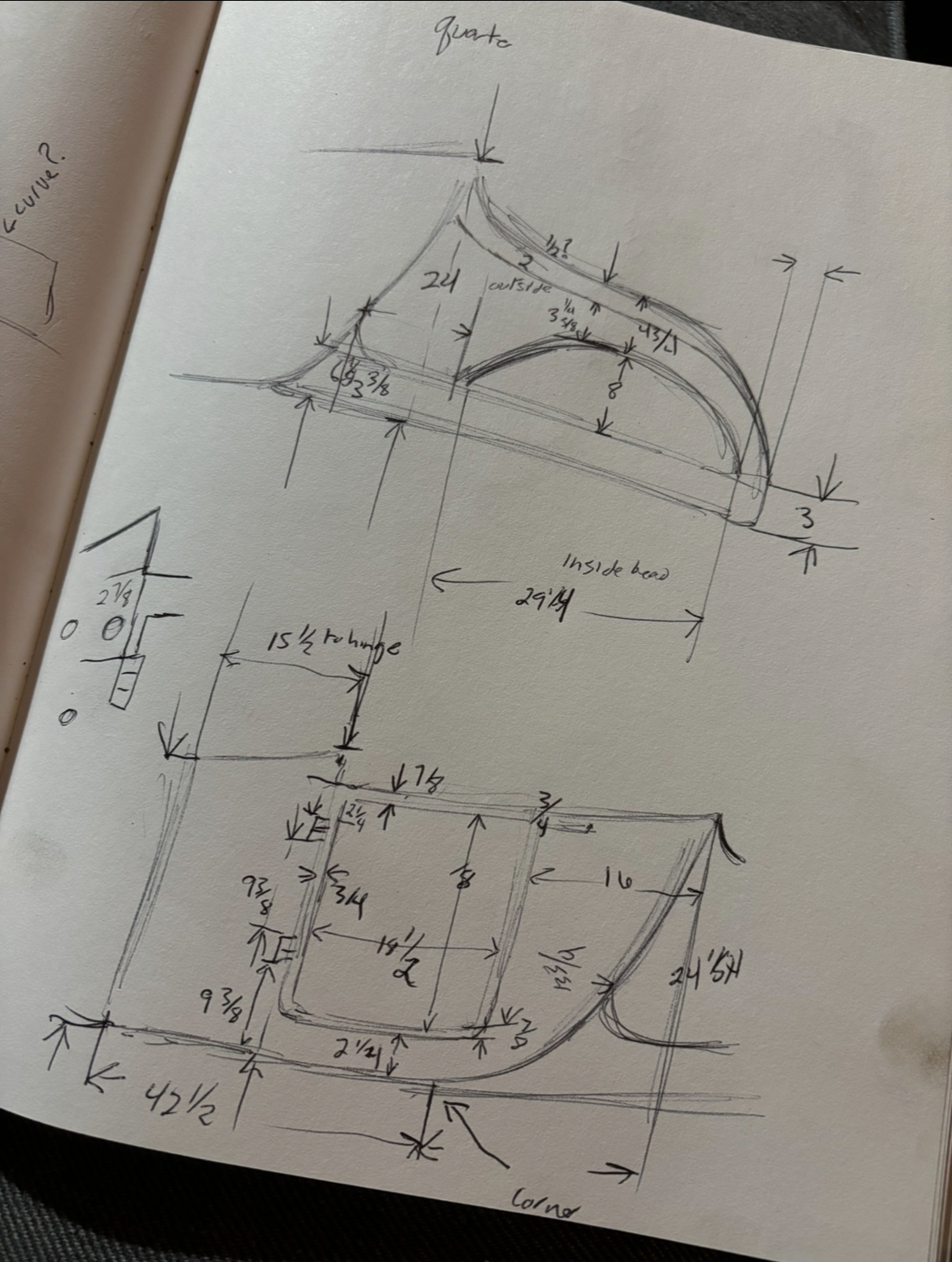

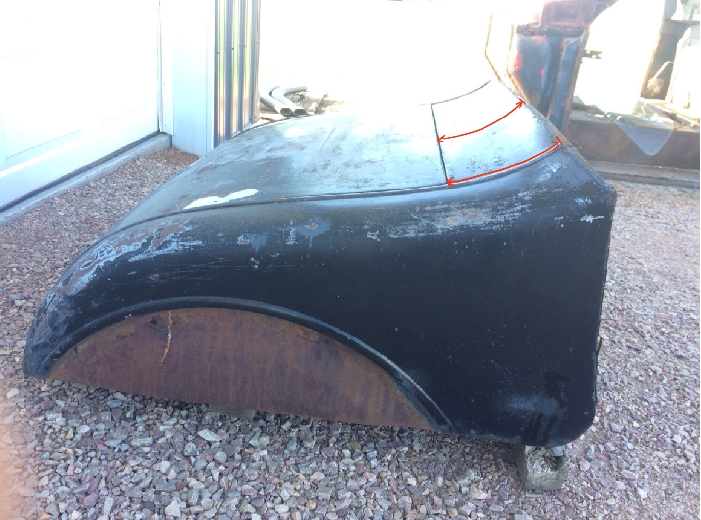

    So tonight I’m working on turning my hand sketched measurement notes into a cleaner more legible image and thought of @Rynothealbino
    I have a measurement that I need that you could easily get for me. The panel above the trunk lid. I need to know how “tall” it is. My buddies roadster has a top that over laps the back of the bucket and the top of the deck as they sorta share space.
    I pressed a tape measure flat in the curve and added a guestimate and ended up with 7” at the ends. I’m needing the measurement at the ends and in the center as I believe the top may be arched a little. I don’t have another deck to measure at present.

    Untitled_Artwork.jpeg Those two spots. Hopefully that makes it easier to understand what I’m looking for.
    Also for anyone reading I’m needing various width and height dimensions of where the cowl and firewall meet. It’s a little hard to get some of these with an engine in place. A friend I plan on visiting later has a flathead in his so a little easier to work around but if someone has one that doesn’t have an engine setting in front of it I imagine it would be a little more accurate.
    I don’t need measurements of the firewall itself, depth etc, because I won’t be running a stock style fire wall so I just need the opening so to speak
    If a Google search turns one up I’ll share it here and then add it to my rendering. I’ll post that when it’s done as well. Got a hand full of things that need added yet.

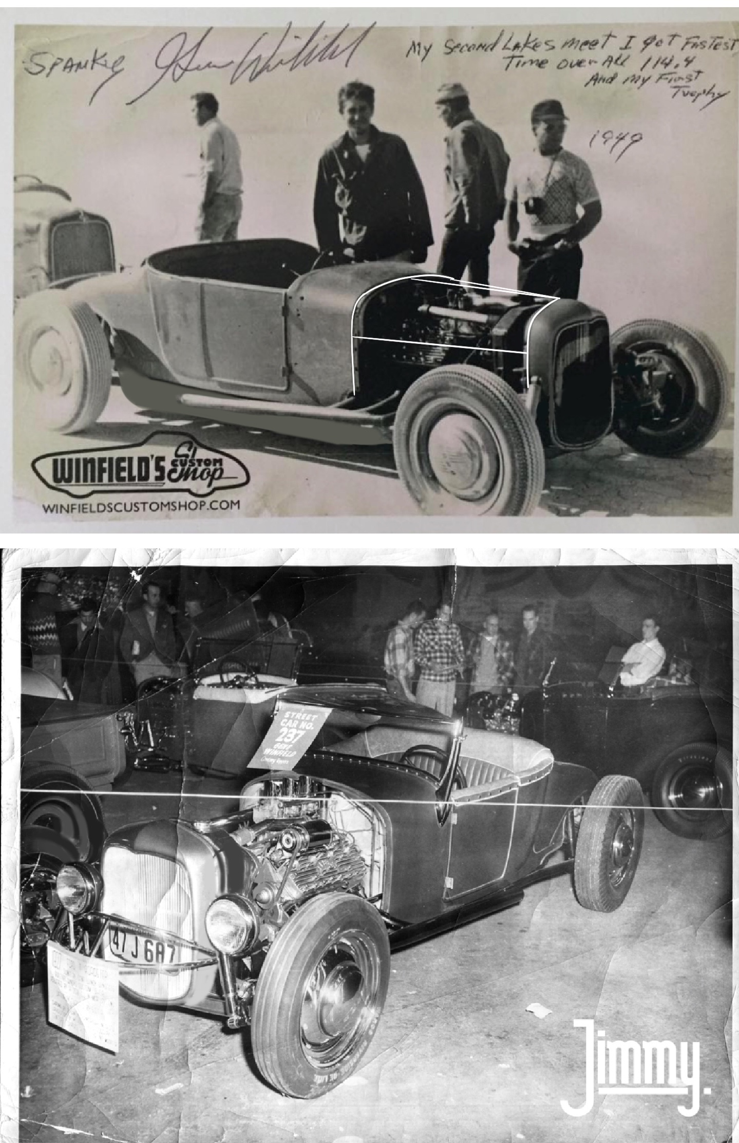

    @Jimmy B I tweaked some of your supplied Winfield photos. In the lower I dropped the headlights, in the upper I got rid of the front nerf bar, drew in an hood line and roughed a 32 frame in.
    I really love that car and though the radiator placement is less than lovely it sure does allow for a more room and you can’t see it with the hood on.
    I’m imaging the Weiand car would look similar to my alterations if it was on the street with a windshield etc
  24. Have you checked out @Mindover thread on his T? I believe I added pics and measurements of that panel over there.

    for more accurate readings of a curved or compound surface, think about using a fabric tape measure and we can think of you as a taylor-of-T's.....

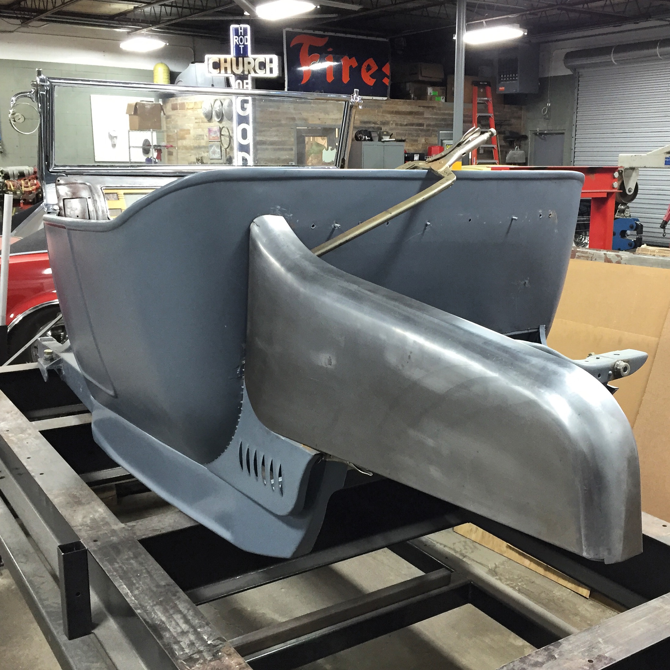

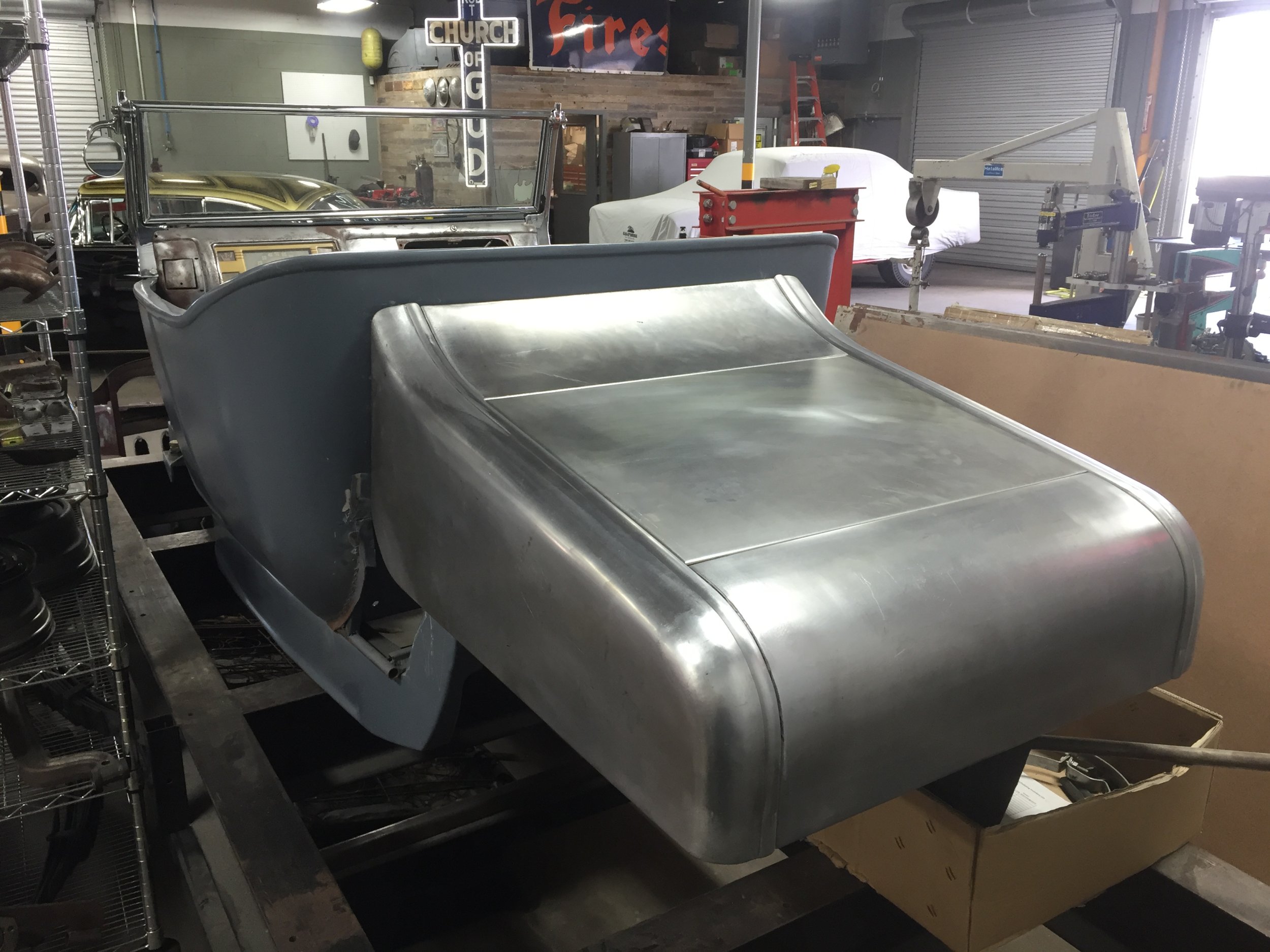

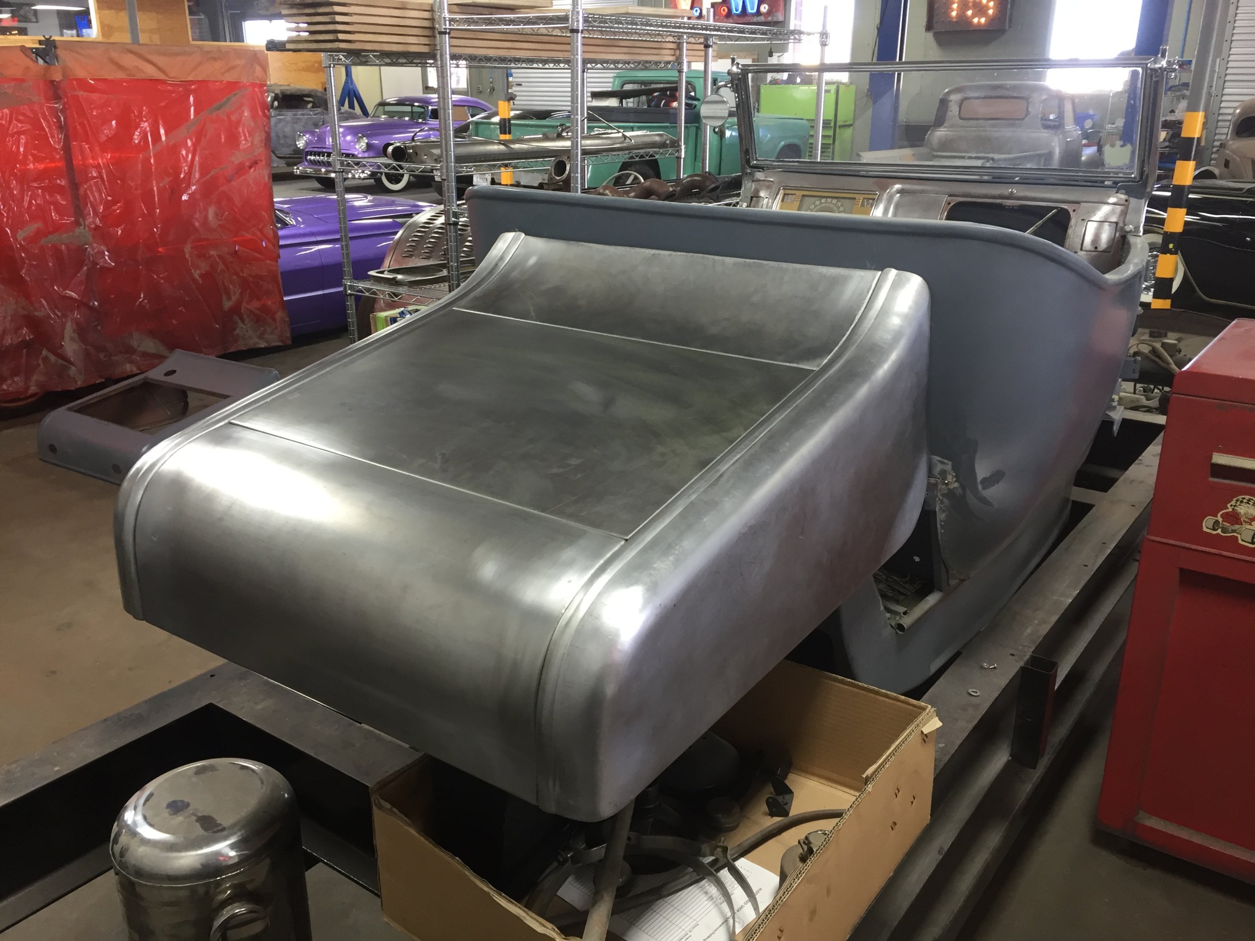

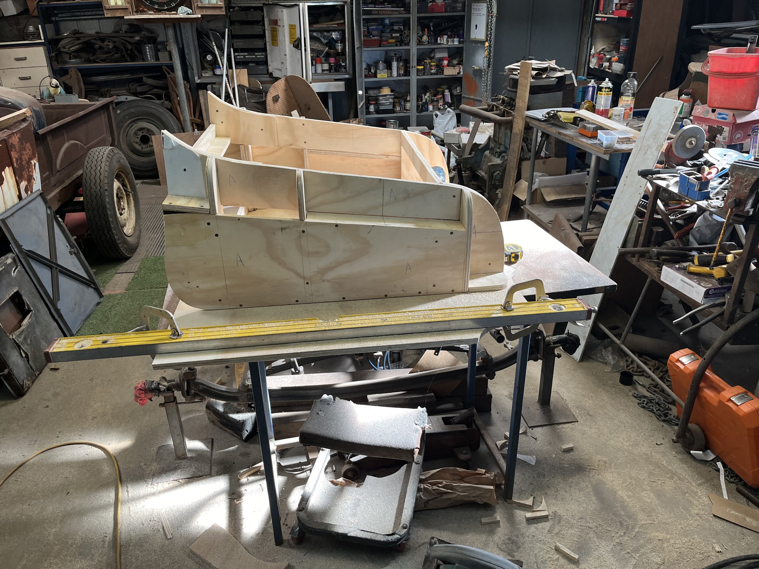

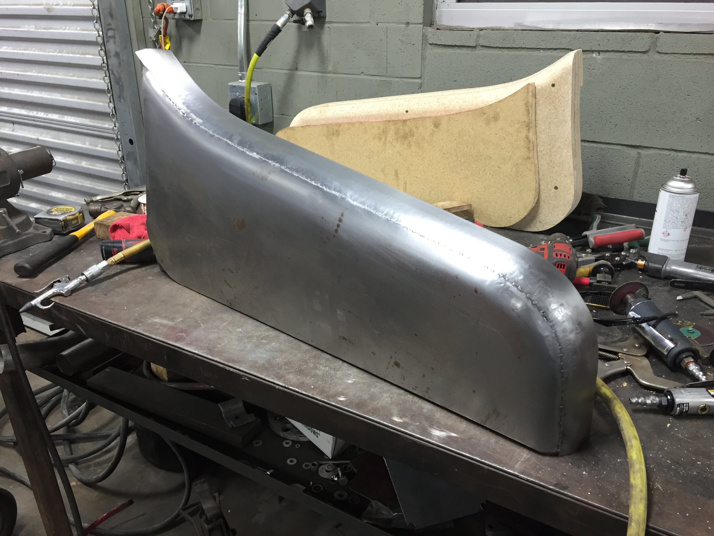

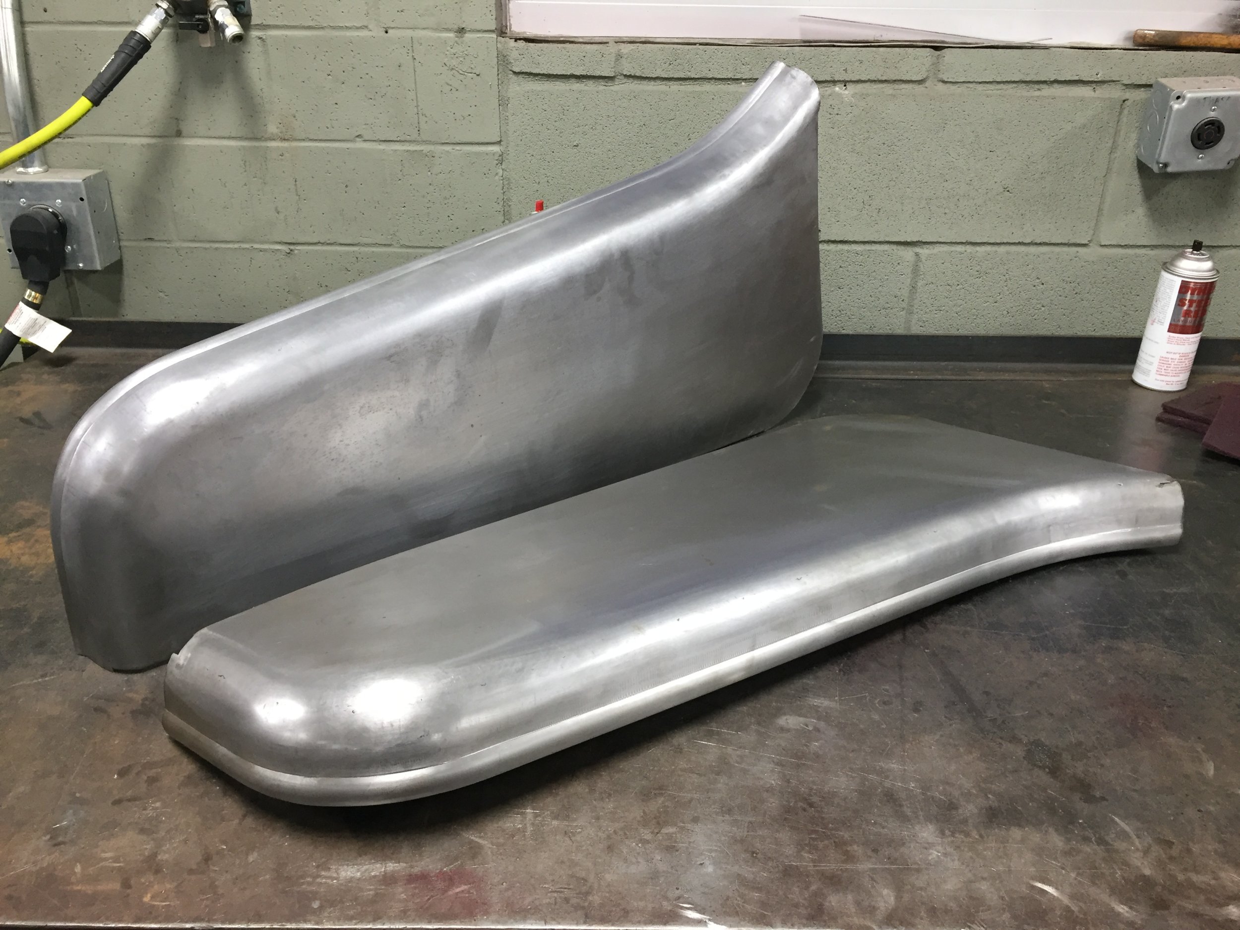

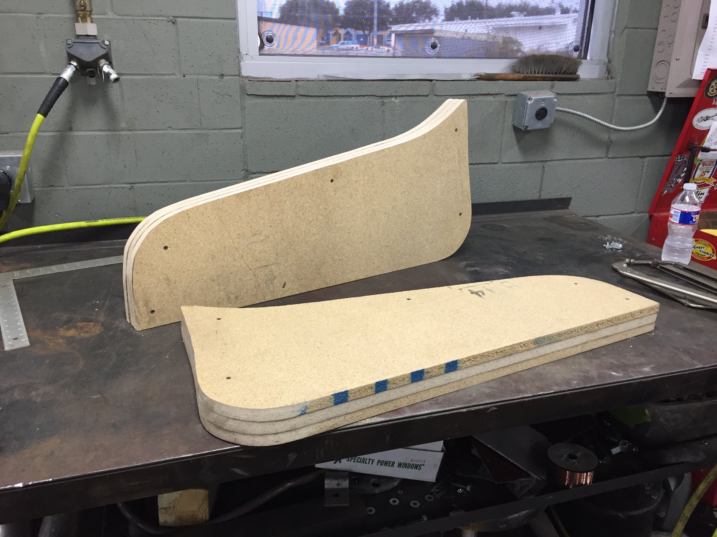

    But here's some shots of the one I built for my '24 T a while back. There's not nearly as much shape in this as a '26/7 but it would work similarly.
    IMG_0012.JPG IMG_0013.JPG IMG_0014.JPG IMG_0018.JPG IMG_0020.JPG IMG_0022.JPG IMG_0024.JPG IMG_0083.JPG IMG_0206.JPG IMG_0186.JPG IMG_0204.JPG IMG_0205.JPG
