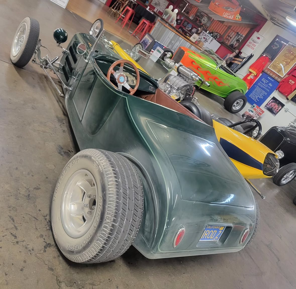

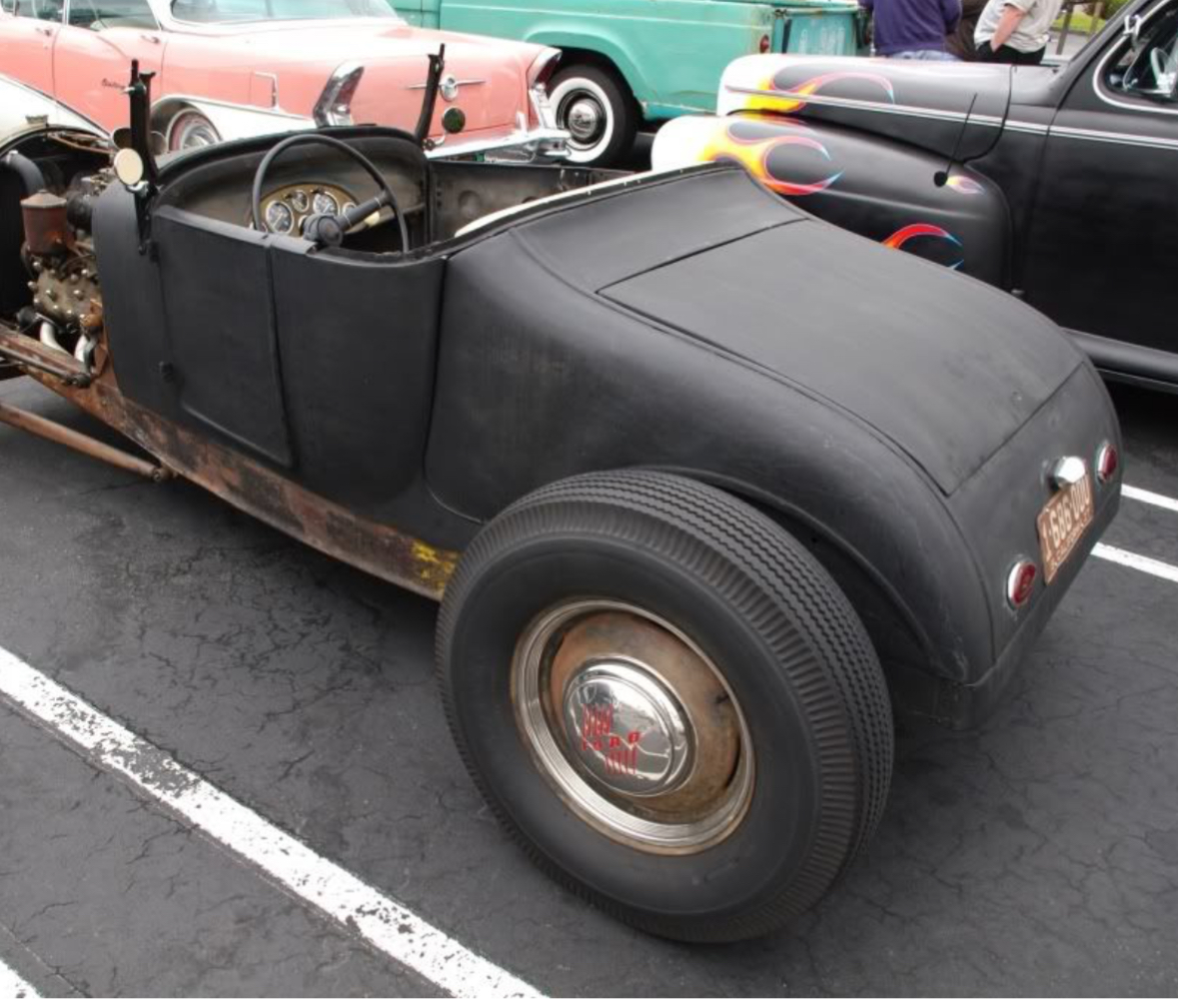

    Looks like Pete deleted the bead and the horizontal seams on the back of the green roadster. Just a visual of how if looks sans bead.
    I’d still want all the parting/flange lines of the panels meeting though, with or with out the bead. Looking at how they go together stock it seems like those points add a lot of rigidness I would not want to lose.
    I’m really trying to keep that sort of thing in mind as I scheme on how the inside of this will be put together IMG_0124.jpeg
    man the more I look, the more that it is smoothed out. Nearly all the beads are gone on that car and the parting lines. Never once noticed!

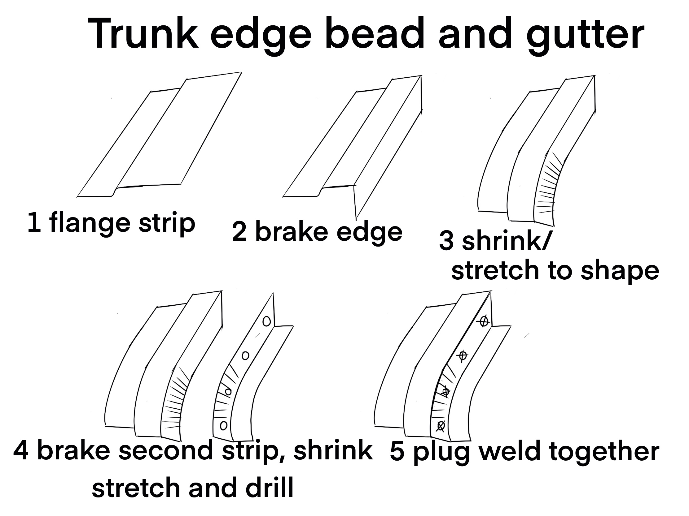

    Alright so I think I’ve figured out a way to make that bead that makes my brain happy. Subject to change but figured I’d draw and post it for reference later. Untitled_Artwork.jpeg you could weld this to the quarter before or after plug welding the gutter/ shelf for the trunk.
    If you wanted to you could make that shape round to channel water down and out but for my purposes I think I’ll put some sort of weather strip there and then very bottom of the trunk opening have the horizontal piece have some sort of collection/ draining. I’m not trying to be to fancy here.

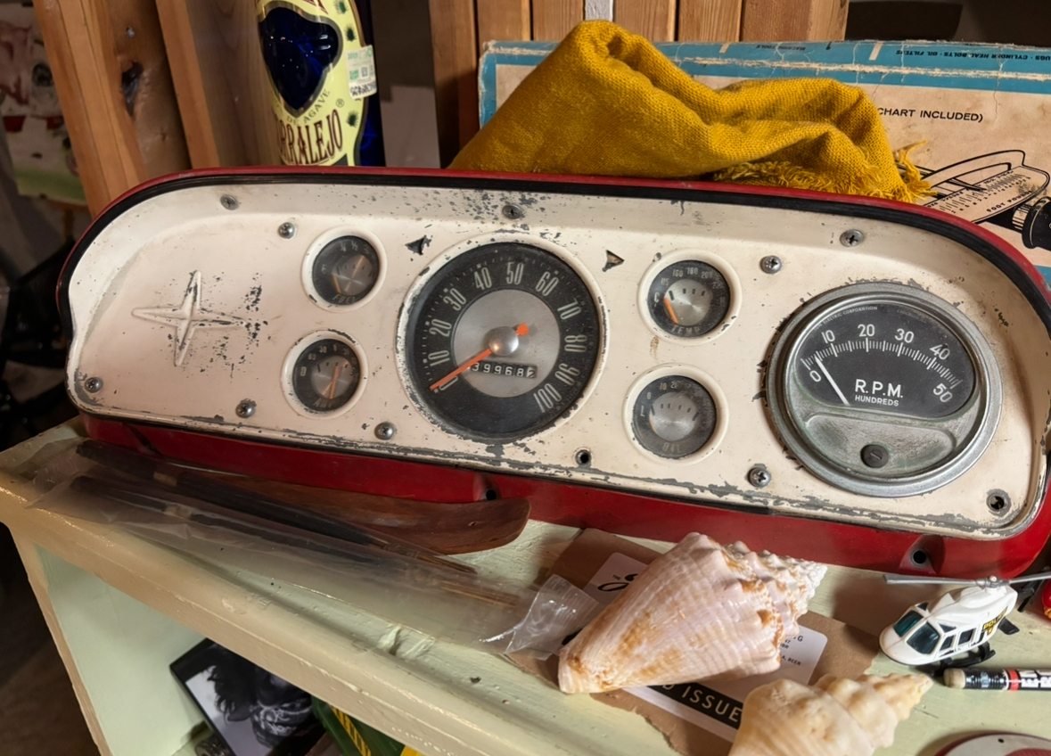

    IMG_0126.jpeg This gauge pod I’ve come to find came from a late 50’s F truck cab over. The pickups have a similar surround but it’s part of the dash. The cab overs it is removable like this one.
    equipped with a sun tach it has most of the sending units tied to the back side. I was gifted this by my Aunt as a wedding present, along with a giant roll of butcher paper. Completely off topic but that stuff is extremely handy whether it’s for a garage project or for the kids drawing something enormous. I’m no where near running out of it over a decade later.
    anyhow she saw it and knew I needed it. And I’ve always thought it would be cool suspended off a dash rail in little race roadster or similar. IMG_0127.jpeg it has this nice scoop shape in the side that’s got me thinking I might just run a dash bar tube at the right height and tuck it right in there.
    I have considered mounting it up side down and twisting all the gauges 180 deg. Also looking at the broad sides and the sizable top I could see putting my switches in those locations depending on how it is orientated in the car. That’s gonna be more of a mock it up and see what it looks like thing I think.

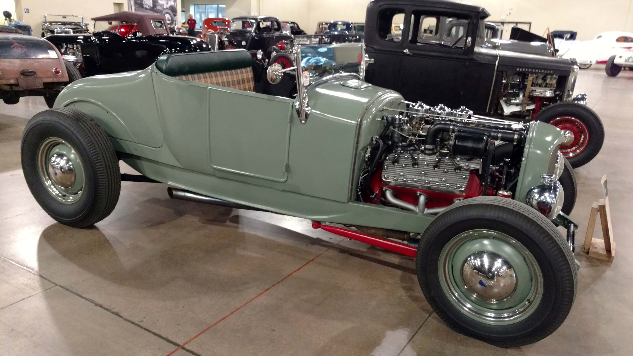

    @winduptoy man that sure looks a lot like the “sweet tea” roadster build I posted early on. I’m not sure where it went after he sold it but you’re on the correct coast. It could be…
  12. Anderson
    Joined: Jan 27, 2003
    Posts: 7,560
    Anderson
    Thats because its a gl*** bodied car. Body by Anderson Industries (no relation!).
    rjgideon and Tim like this.
  13. winduptoy
    Joined: Feb 19, 2013
    Posts: 4,167
    winduptoy
    It was at the Denver Timing ***ociation 70 year anniversary show 5 years ago....
    I love the Big F Ford dash and scoop....it looks like you are digesting what you need to do to form the metal pieces without heartburn....
    Carry on
    Tim and cactus1 like this.
  14. That green T is Tom’s from Colorado. He’s pals with @PINEAPPLE who also has a fantastic T roadster!

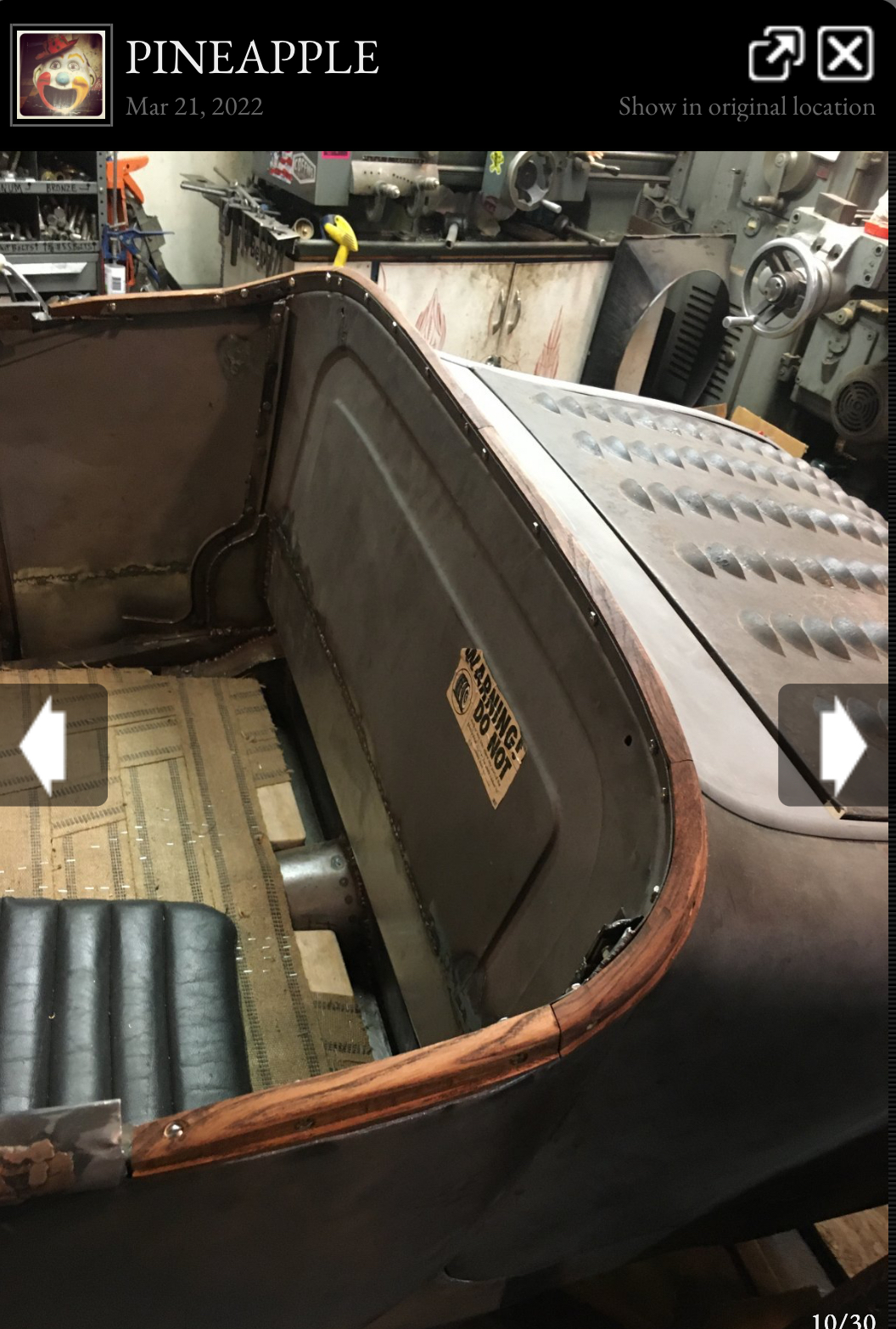

    @PINEAPPLE blasted through your thread again, what a killer build. So many little details I didn’t notice the first go round.
    I’m curious what you made your front wishbone mounts from, the frame rail side? or how thick they are? Really like it. IMG_0132.jpeg also stole this photo of how you took the hump out of the lower section of the back panel. Also shows the overall shape of that panel pretty well :)
  19. PINEAPPLE
    Joined: Aug 26, 2012
    Posts: 534
    PINEAPPLE
    Thanks Tim! Those mounts are model A front body mounts that are usually riveted to the frame rails.. I mirrored them with 1/4" angle behind then to make them 3/8" thick. This also gave wings going both directions to weld to the frame. I machined a barrel with the 7 degree taper inside for the tie rod ball- then welded the barrel in to the mount. Thanks for noticing that, I love all the weird little places to make something cool. Getting rid of that inner hump at the seat riser is mandatory.

    Just a thought on those T strip bead thingees.. They are spot welded in with the rain gutters, they are thick and heavy duty.. If you could source a pair of those, they would give you an accurate profile pattern for the quarters where they meet the decklid. I actually used them to draw the profile on the floor to re-shape the model A decklid for my T.. So if you find an old A decklid with the bottom all rusty etc.. dont p*** on it.
    winduptoy, Six Ball and Tim like this.
