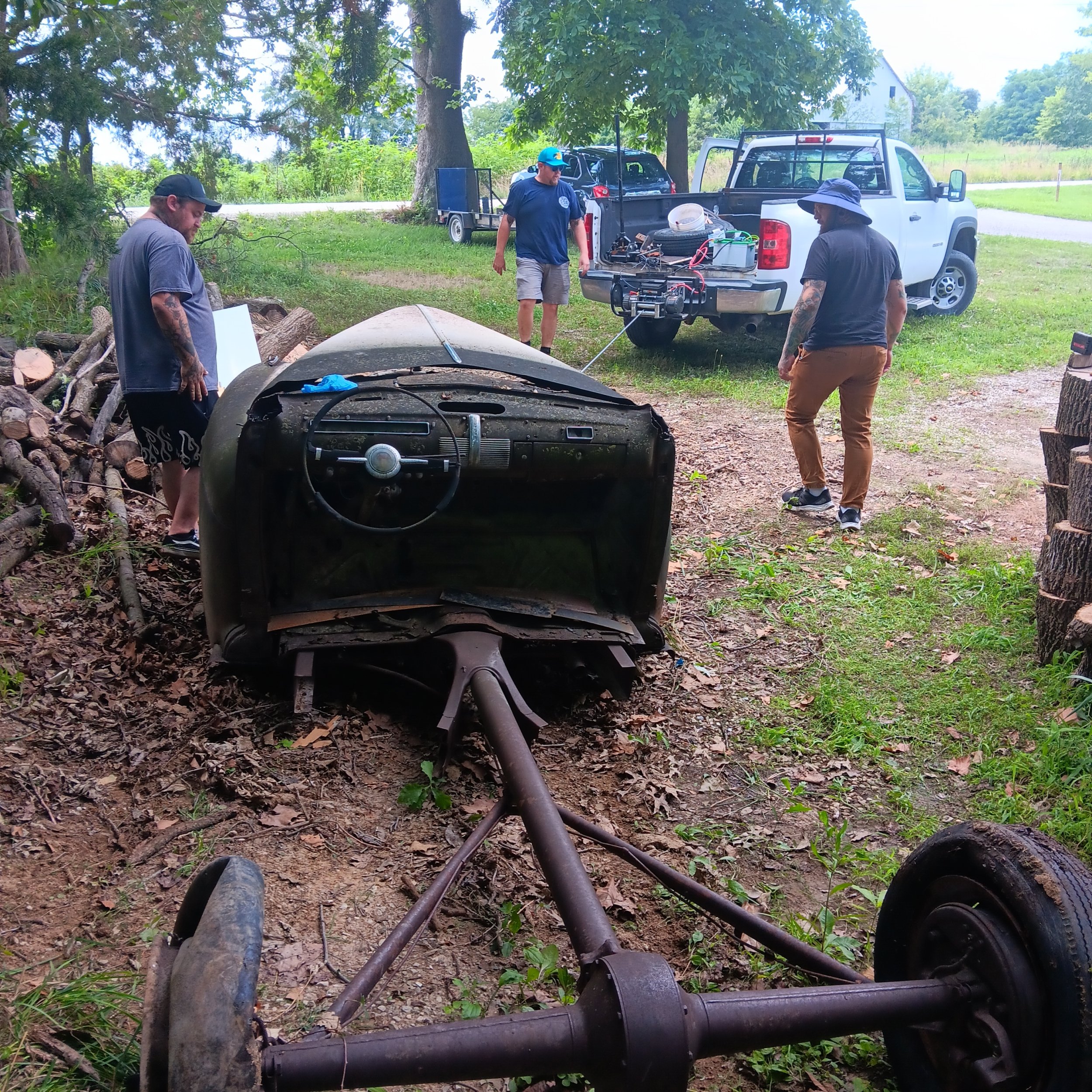

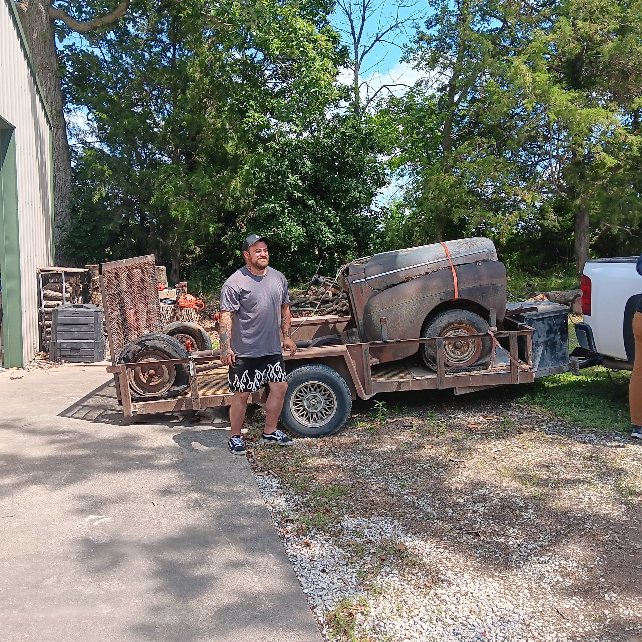

    Btw, here's what Tim's parts car looked like when he picked it up at my place:
  7. Tim
    Joined: Mar 2, 2001
    Posts: 20,257
    Tim
    from KCMO
    Was a good day!

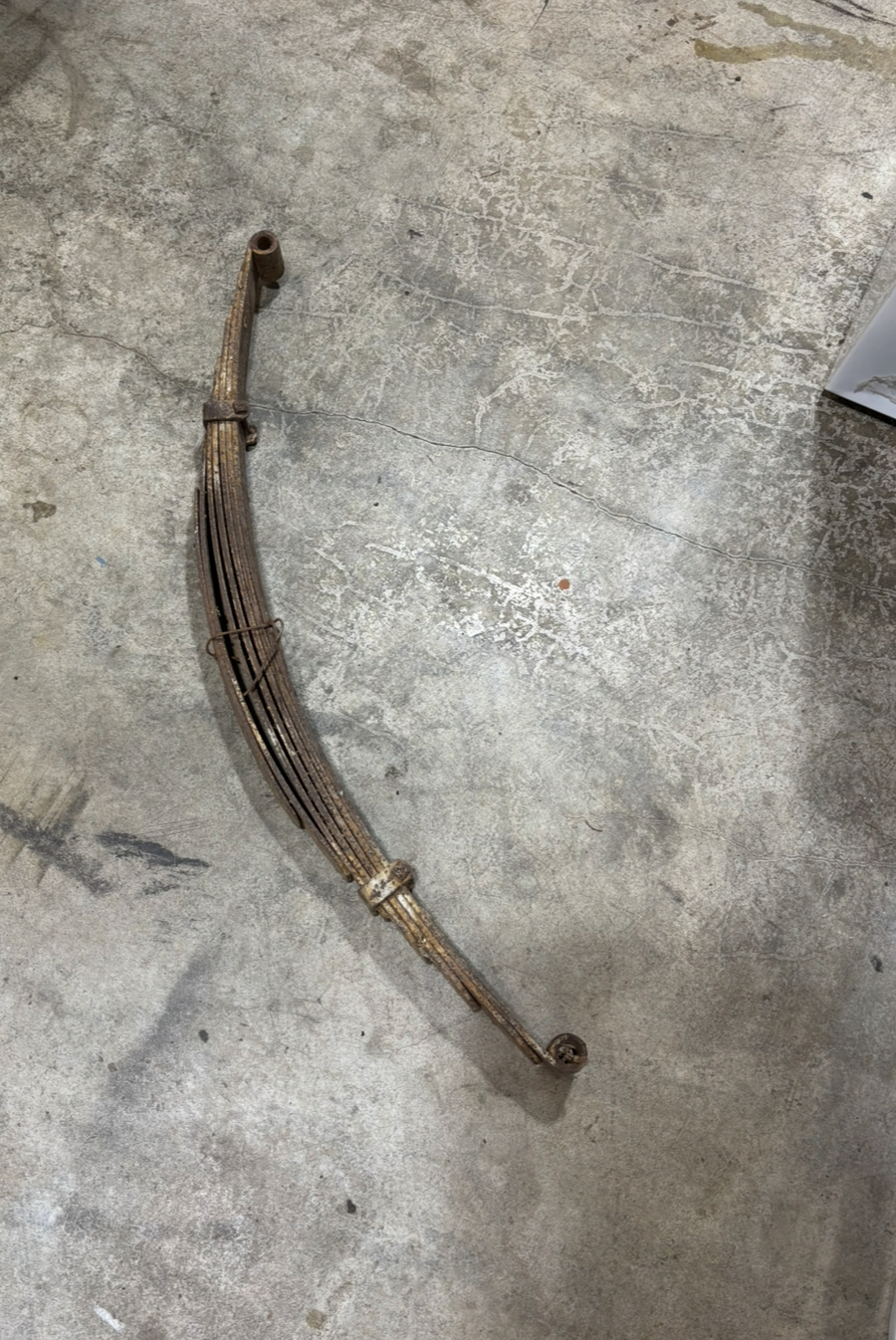

    on that note I got a front spring from him as well so after I get a few bits off the 41 and some from a buddy further south I should be able to put this frame back together with full suspension, brakes and tires for the first time!

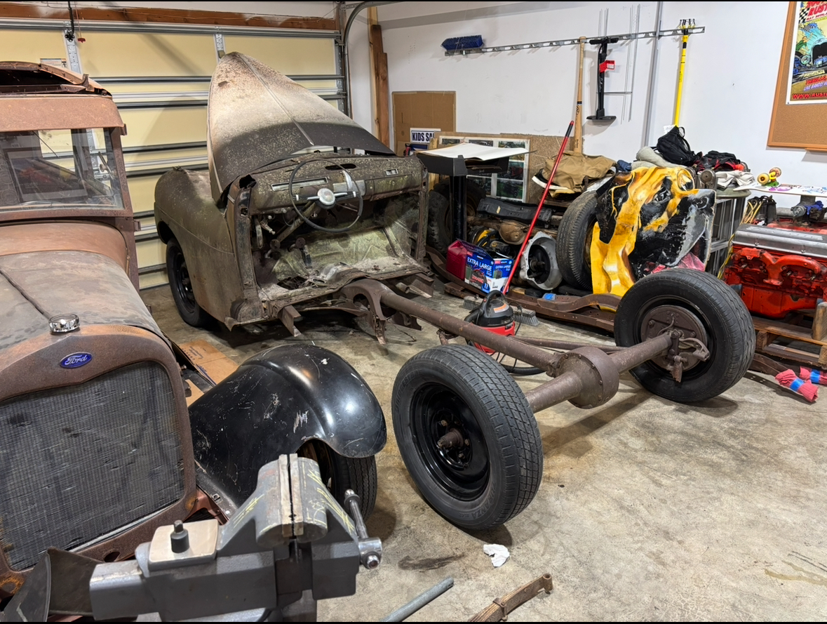

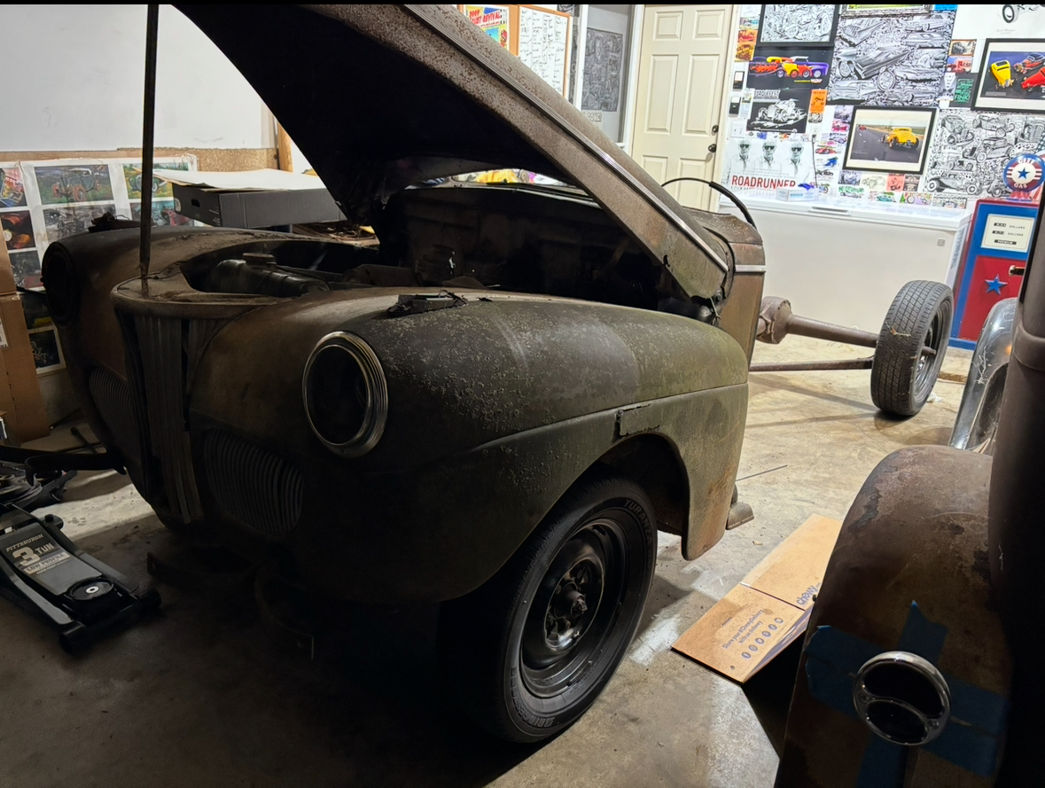

    Alright quick update.

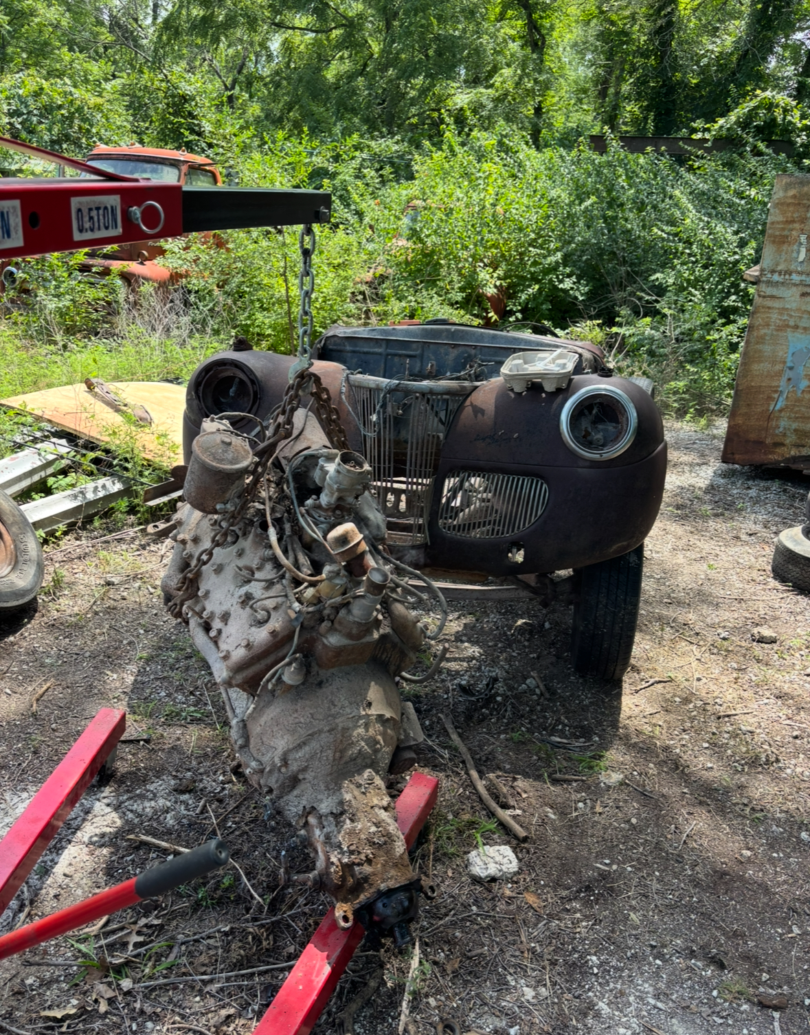

    Nothing to exciting but Davey @Austin kays and I got the 41 mostly apart. IMG_1044.jpeg what we figured would take 3 hours took 6.5 with a torch. We could have picked a cooler day… IMG_1041.jpeg the bolts on the car were soft enough to round almost right away but the shafts strong enough to hold. So out came the hot wrench. IMG_1042.jpeg Hot rod flames?
    IMG_1043.jpeg End of the day the motor, trans, rear, dash and horn ring with north with Austin. Most of it goes to active projects. I think he’s gonna go back for the firewall as well.

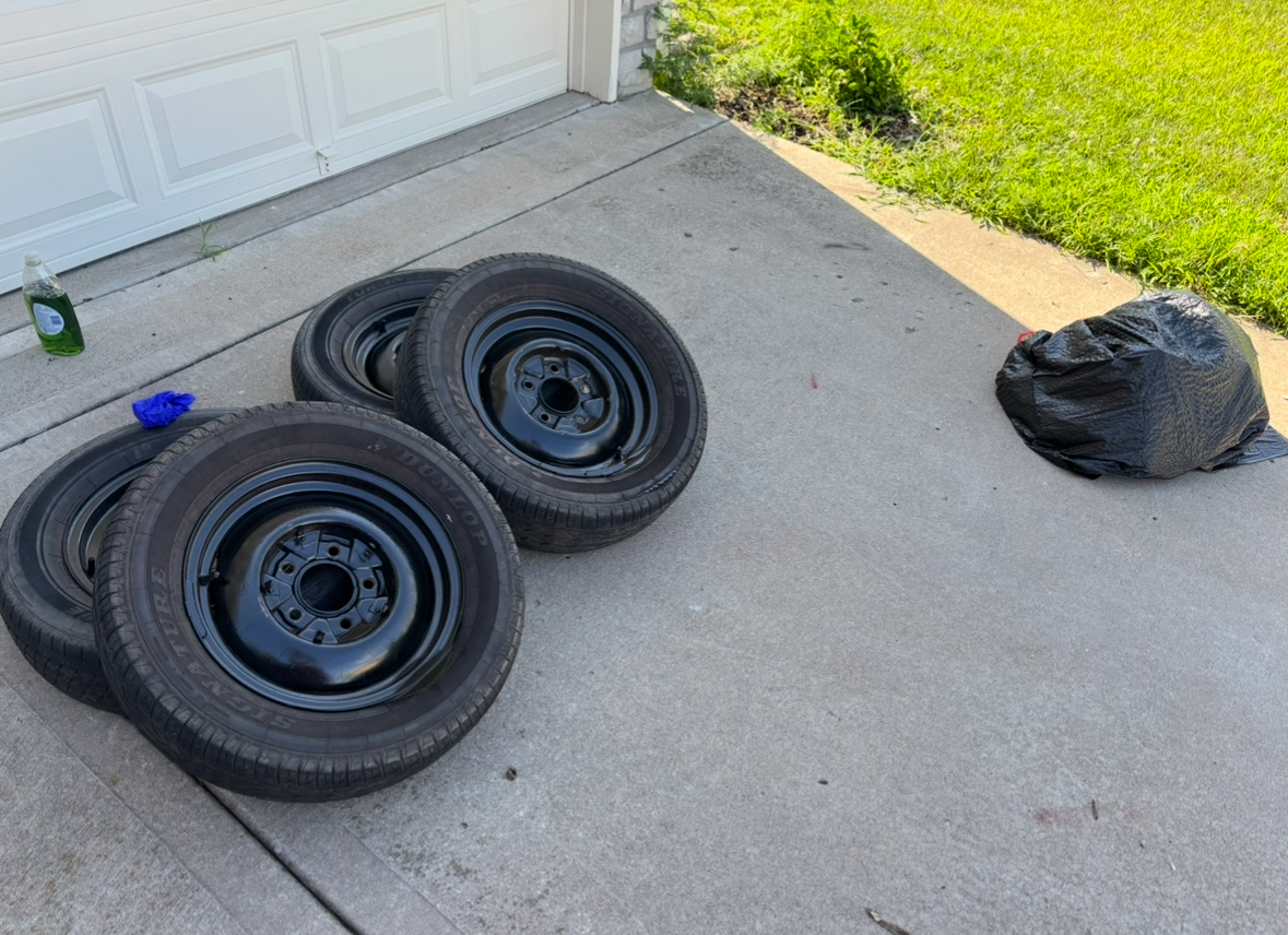

    IMG_1045.jpeg I took my wheels and tires and then the front backing plates, hubs and drums. Dawn soaped the wheels and tires and left in the boiling sun for a day or two to dry. The front end stuff and hardware was really really gross. Had roaches come out of it when I took it apart so the ride home was in 60 gallon yard waist bags with it tight as tight shut as it’s gonna get. And then once home they got a new bag and half a tall boy of raid to hot box before I tied it tight and left in the sun. I’ll probably open and spray again and then when I get time I’ll inspect and spray. Then Dawn dish soap and hot water trying to get the grease off the hubs and catches.
    That being said I’d rather take greasy parts over rusty ones!
    after Austin gets what he needs from the drivetrain I’m going to snag the 3 speed and clean it up. I havnt opened my donor trans for the build yet so figured an additional one would be a good idea.
    Davey is going to pull a few parts and then flip the rest for his trouble. I’ll list them here in case someone’s looking
    1941 ford parts
    Front axle and spring - same as a 40?
    Good looking stock radiator
    Good hood side trim
    Fair center hood trim
    Perfect cowl side trim
    The fender tops look pretty solid, the bottoms are thin around the wheel wells but the front is good for patches maybe
    The small grills have zero shine but aren’t busted
    Inner fenders are actually very nice just dirty.
    It has the chin piece under the center grill that always seems to be missing. It’s got a dent in it but it appears solid. Also has the pan that is kind of a front roll pan under all that.
    Good cowl vent and mechanism
    I think the radiator yoke and the slam panel/ supports are probably rough but useable after clean up. The hood side of the latch is toast.
    Front upper shock mount brackets for tube shocks.
    The bracket holding the steering box to the frame is good - used for putting a 37-48 box on like an A threw 32 frame but the box is toast
    One good headlight ring
    anyhow that stuffs available for sale and I’m sure if there’s a little piece your needing he’d go look and see if it’s still there. Let me know and I’ll put you in contact.

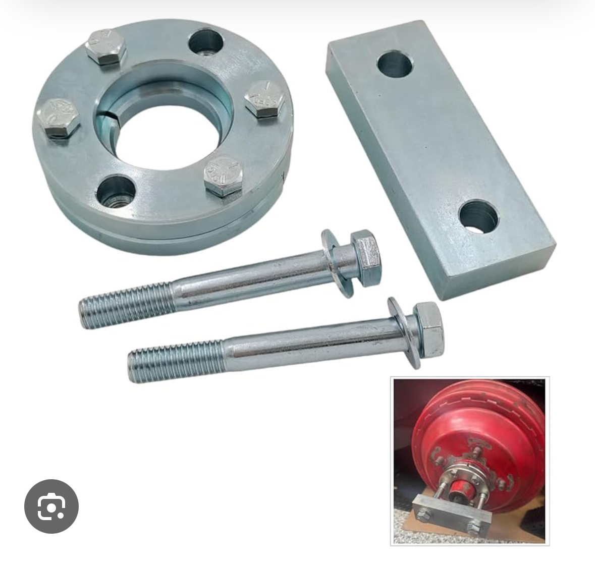

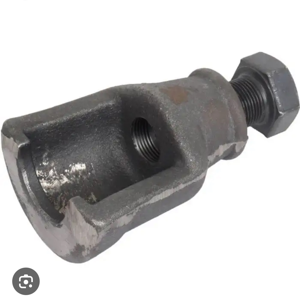

    Alright not to much of an update. Been looking at rear hub pullers for banjo rear ends. Seems like one you need to buy not borrow. The options for buying new seem to be these three. IMG_1207.jpeg thus is the most common and runs 50-60 bucks. Trying to find people who actually own and use pullers this seems to be the one most people have. I don’t love the two puller bolts but it apparently works well enough.
    IMG_1206.jpeg This one is out of stock nearly everywhere. I like the design but I’m leery of any new cast tools after having so many immediately crack. So far I havnt found anyone who owns this one. IMG_1208.jpeg this is the third new option which looks the best but is four times as much money if that price isn’t Totaly out dated.
    Atch had a great thread not to long ago about home made pullers as well. Kinda curious what you guys are actually using.

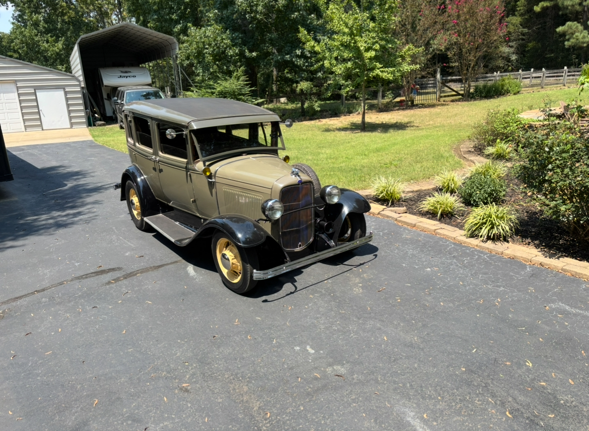

    other than that I did help @drdave dig his model A out and my wife and I took turns cutting laps in it. Fun car!
    Also @atch the spindles are going on Davey’s model A project! It’s a fenderless Tudor on an A frame, it’s a 30/1 but I think he’s toying with putting a 30 ish olds cowl and A pillars on it. Kinda wild but seems like it could work :)

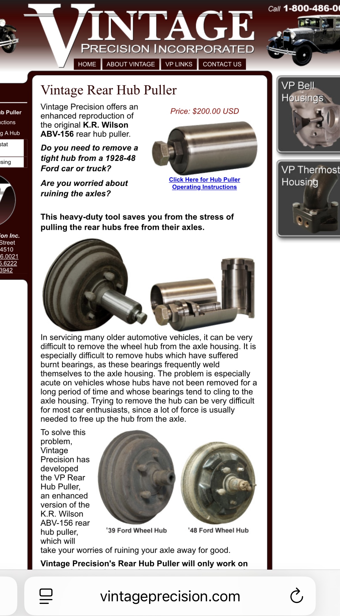

    I had one of the these but loaned it out never to return. I bought the KR Wilson reproduction one and am glad my old one never returned. Way nicer, no damage to threads on axles and worth every penny. Works on even the most stubborn hubs,
    Speedy Canuck and Tim like this.

    Just be sure you thread something on the end of the axle. If you apply a bunch of force to remove the hub, the cotter keyhole distorts, or the puller rocks, wreaking havoc on the end threads of the axle.
    drdave and Tim like this.

    Yeah i see a lot of guys putting a nut on the end.
    seems a long cap nut would be ideal

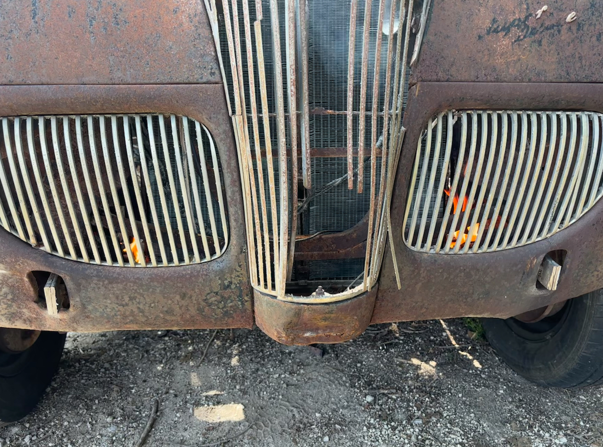

    Saw this on Instagram this morning, little pan to cover the bobbed frame horns and begin the belly pan with a 32 shell. This is similar to what Ive got in mind. IMG_1224.jpeg
