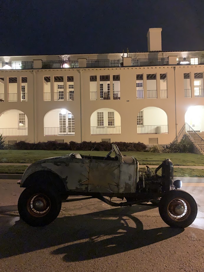

    Back in action! The other night, I went for a chilly roadster ride. Felt great to be back behind the wheel.

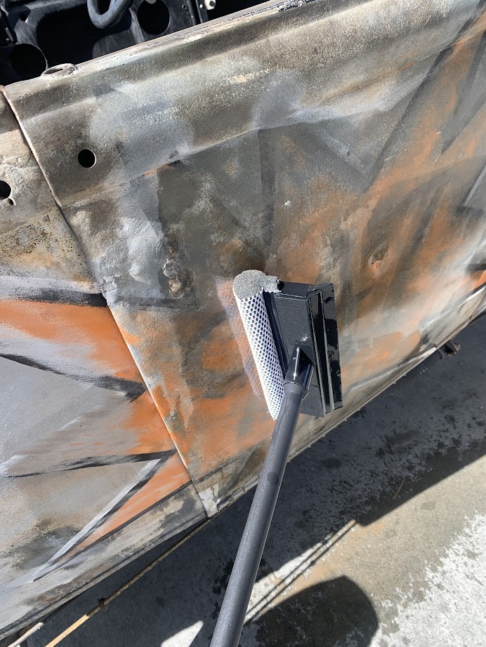

    Oh, and I've been slowly washing off the T.R.O.G. paint.

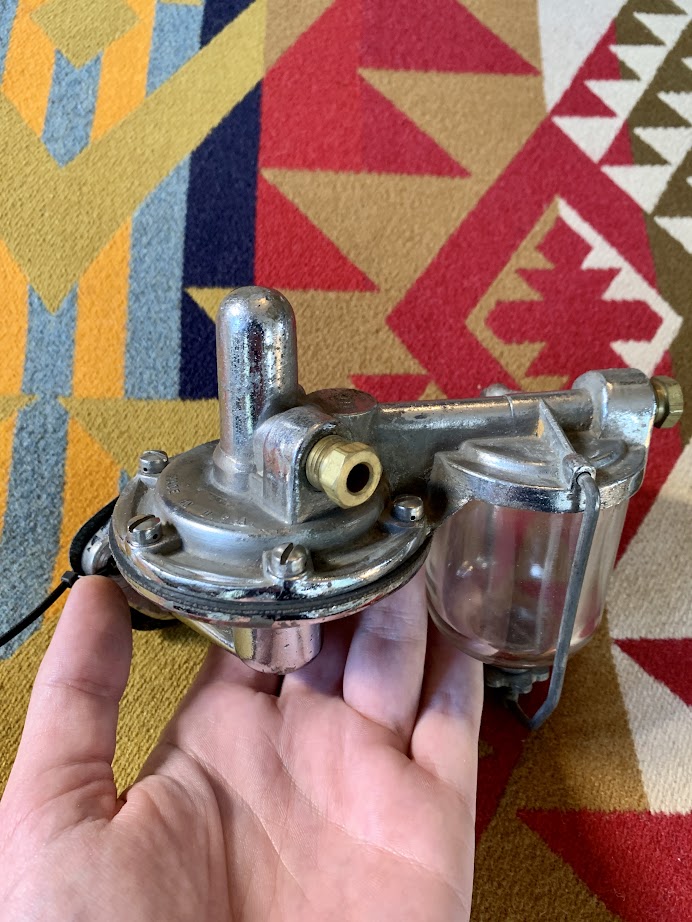

    Yesterday, I got a great piece in the mail from Andy Kohler in Pennsylvania.
    Old chrome 59AB fuel pump, freshly rebuilt. I met Andy while working on the story of his latest Model A for @Kid Rocker 's DicE Magazine. My friend @HelmuthBrothers knocked it out of the park on the photos!

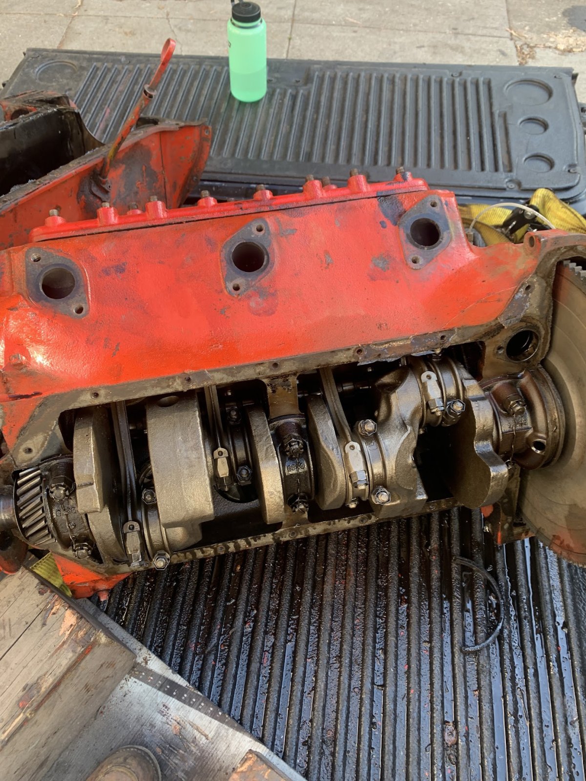

    Sidebar ???: The Motor Mystery
    In all my years of working on mechanical projects, I've never encountered anything as strange as what happened Monday morning. Before we dive in, I'll provide a little bit of context.
    As of right now, I'm hard at work cleaning the second flathead's oil pan and prepping the small parts for paint. While I was doing that, I was arranging the first engine's return to Pismo Beach for a refund.
    When I finally got ahold of the seller, he told me he changed his mind. The deal was off. I was stuck with the seized engine. Buying a locked up engine was one thing, but going back on your word is a different story. Needless to say, I was pretty upset.
    I didn't dwell. Moments after hanging up the phone, I started formulating a plan. I'd pull the parts I needed off the red flathead and then give the rest away for free. I wanted to turn that whole negative experience into a positive one.
    Before work, I unbolted the oil pan, oil pump and carefully removed the starter.
    The underside was clean. There was a little bit of sludge inside the pan, but not much. I studied the pieces and tried one last time to turn it over. Not surprisingly, it wouldn't budge.
    I then took the pan into the garage and set the starter on the workbench. That was that. "Time to take pictures to p*** this thing on to its new home," I said to myself.
    Then, for whatever reason, I scooped up my Harbor Freight deadblow hammer on my way out. I hopped into the back of the truck and hit the clutch/flywheel. Whether that smack was out of frustration or despair or comedic effect is up to interpretation. "Did that just...move?" I asked. I hit it again, this time a little more strategically. Four or five taps later, I was able to turn the engine over, smoothly, 360 degrees.
    I immediately texted David, who suggested that I inspect all eight bores. There was no deep scarring and only slight rough patches where the rings were. His reply, "It's worth a go!"
    Later that night, I called my brother to tell him the news. He was excited, and asked what the plan was going forward. I wasn't exactly sure, but I have a feeling this is a strong engine. Per my measurements, it doesn't have a Merc crank, but it does have adjustable lifters, and it's internally clean. "That engine wants to live," he said.
    I just bought a gasket kit. I'm going to clean everything up and get it ready to bolt back together. (Don't worry, I already liberally oiled everything). This motor is shrouded in mystery, but we're doing what we can to get to the bottom of it. I can't wait to hear it make some noise through those homemade headers.

    That's awesome you got the motor to turn freely, but since I know you're one who doesn't go back on their word, I ***ume you're still planning on giving away that motor for free? Right?? If so I'd be more than willing to be the one that receives this free motor. Let me know when I can pick it up.
    Just messing with you! Way to make lemonade out of a lemon! I'm glad things are working out for you. The car is looking great!

    Super cool that the " DEADBLOW" hammer, had "LIFE" in it and the "RED FLATHEAD" is going to live and sing a great tune through those cool headers!

  19. Now I want to know what the hang up was, I had a feeling that engine was not stuck, your bores looked in too good of condition for there to be a major issue. Maybe a light layer of corrosion on the rings or something. Oh and also that seller backing out after agreeing to do you right is super s***my. Well now you have 2 flatheads, I see nothing wrong with that.
    Edit: I just thought of something, is the oil pump locked up? I noticed that you removed it before the crank was able to turn. The pump is driven off the back of the cam by a small gear set and as you know the cam is driven by the crank. It may be possible the oil pump ingested something and now it no longer turns.

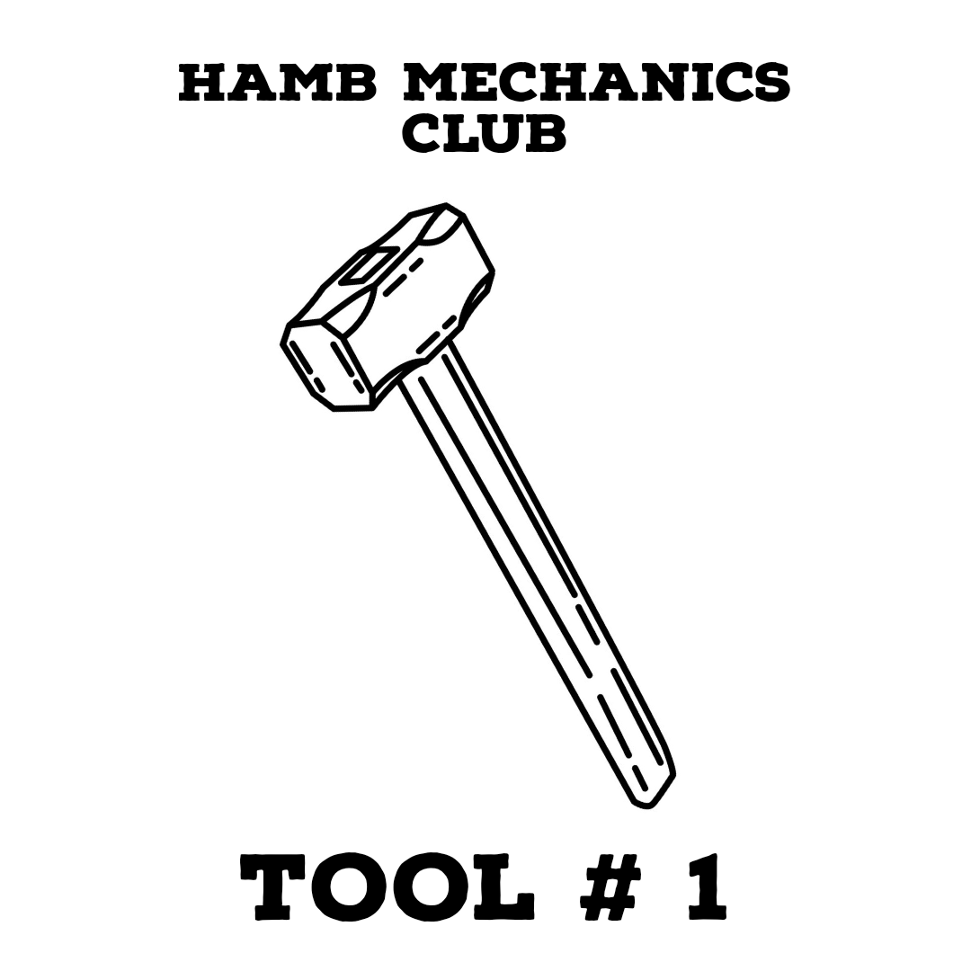

  28. 41 GMC K-18
    Joined: Jun 27, 2019
    Posts: 5,203
    41 GMC K-18
    "Resistance is futile"
    "Beat the "STUCK", out of it"

    Check the items removed and check the timing gears. Look for chunks that could have jammed it up. When you install the starter, check engagement carefully.
    Glad to hear the "bad" engine may well be okay.
