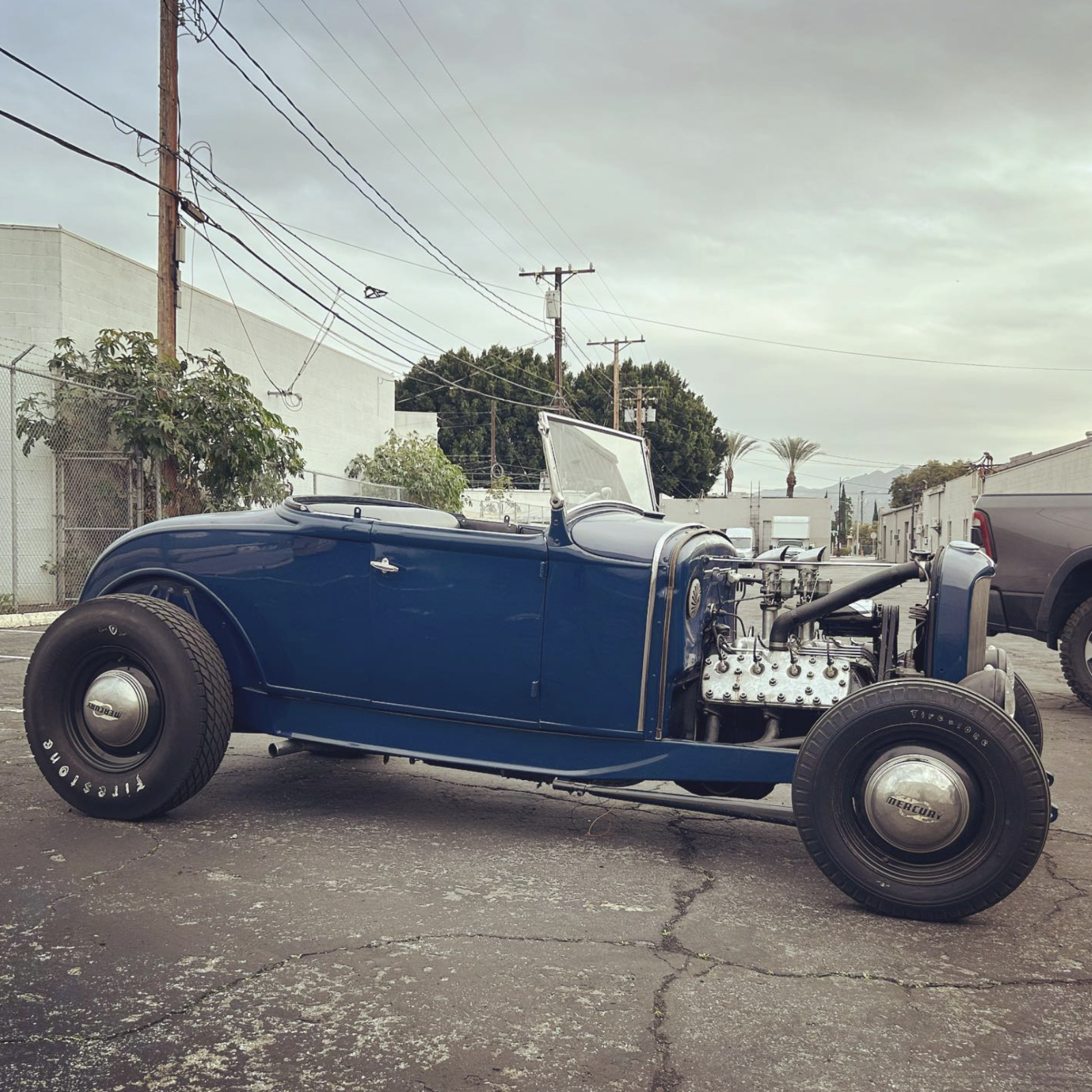

    Thank you everyone for the birthday wishes! I had a very relaxing surprise birthday weekend with my girlfriend on the island of Kauai, and I'll be the first to say it has been a little bit difficult returning to reality. Nonetheless, I'm ready to make 2023 the year that Version 2.0 gets on the road.

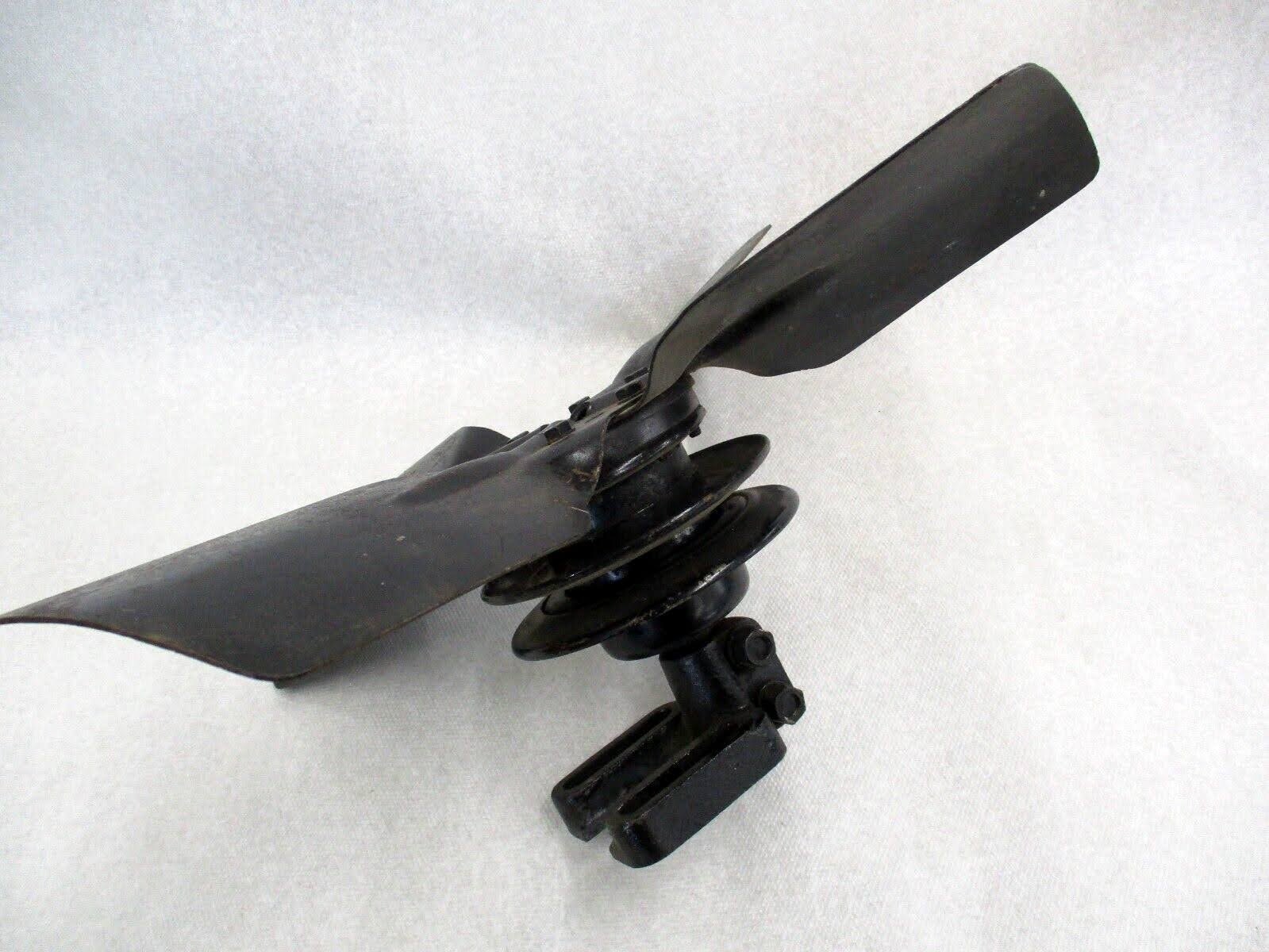

    So, what have I been working on? Once I had finally gotten all the pieces in place to try to fire up the motor, I realized that I didn't have room for my mechanical fan. Damn. So, I looked high and low for other hot rodders' solutions. I already have my PowerGen, so my main stipulation is that I wanted to run it.
    Initially, I thought it would be a good idea to mount a fan on the gen using the Offenhauser adapter pulley from Speedway. After talking with Powermaster, they strongly advised that I go another route because the bearings can't take the turbulence from the fan.
    Then, I thought it may be wise to go with an offset generator bracket and idler made out of an old generator. That, however, meant pulling one of the heads, extracting studs and then putting it all back together again. Also, I like the look of a centered generator. I still may do this when I pull all the head studs for the Edelbrock heads sometime down the line.
    Finally, I looked at cars built by folks I trust. Both Brandon Flaner and Lucky Burton run the stock, 1942-'48 Ford fans on their flathead-powered Model A's on '32 frames.

    Having the radiator and grille a little bit forward defines the looks of these cars. If it can look good on theirs, it should—in theory—look good on mine too. I ordered a stock fan off eBay and gave it a shot.
    When it arrived, everything looked good and it spun well. One of the blades somehow got bent, so I'll have to whip it back into shape.
    Just like they did it at the factory. I'm going to fab some new lower radiator support tabs, but I'm liking where this is heading. I was told I should have between 1/2 and 1 inch of clearance between the fan and the radiator. Does that sound right?
    Earlier today, I received my belts from my friends at All Ford, who now know me by name. I'll be in Flagstaff for work this weekend, but I'm hoping to have this thing ready to fire at some point next week. We shall see!

    Well ****, I definitely could have hooked you up with a 59ab fan. I thought you wanted a 33-34?...I didn't think about the 32 frame either when we were talking..

    I may still take you up on the 59AB fan. This one ended up being kinda bent. I'll see if my dual-crescent-wrench-straightening-while-talking-on-the-phone technique worked.
