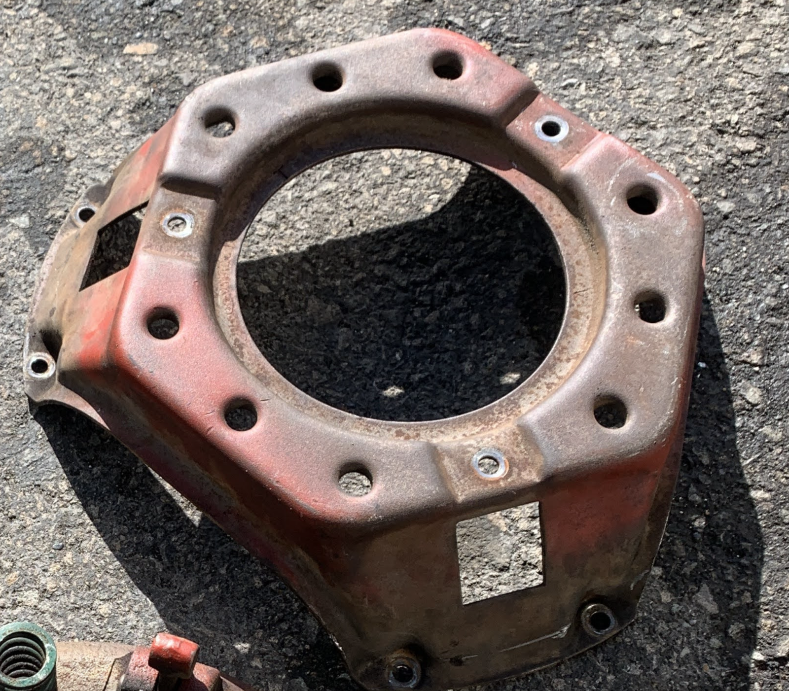

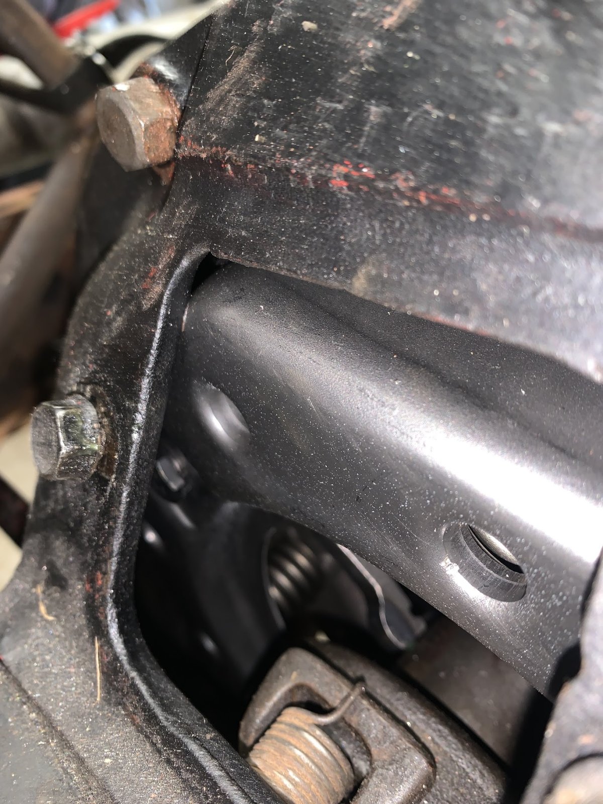

    I came home from work yesterday and, not surprisingly, you guys were right! No clearance at all. Although I do believe the engine was stuck from sitting, I think this has been our main problem since the initial fire-up attempt in November. It's hard to read the numbers, but I'm pretty sure the trans in the car is a 1935 case with 1939 internals.

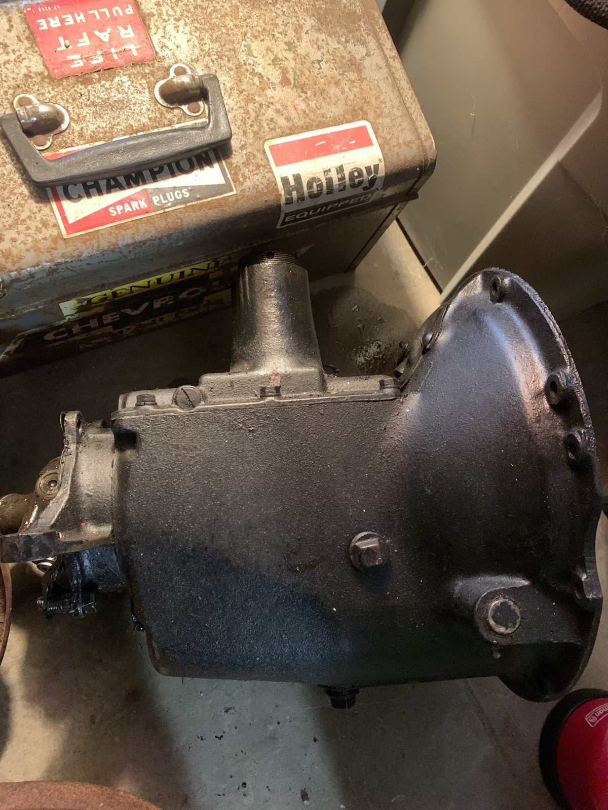

    I then walked to the back of the garage and inspected my second transmission that I got from Flip in Watsonville. The numbers on the back start with 78-, which makes me believe that it should work with the current clutch setup. If so, David and I will be rebuilding this one. It already has a double-detent top, which is a bonus.

  2. Hitchhiker
    Joined: May 1, 2008
    Posts: 8,507
    Hitchhiker
    In one of YOUR old posts you said basically that exact same thing and that if needed. The 10 inch is basically all that is necessary and a good compromise between 9 and 11 if you're overpowering a 9 inch clutch or in a heavier car. Again I'm just regurgitating info from hamb members with more experience than I'll ever have, and that I trust...in this case it just happens to be yours and Bruce's old posts. Lol.
    That's the case you want. Should have a reinforcement rib down the center bottom of case as well.

    Might be a good time to see if it’s possible to pull the trans with the motor left in. And if not if it would be possible with small modification.
    Everything I build will have that accounted for after dealing with a car that eeeevvvvveeeerything has to come apart for to get the trans.

    Glad to hear that was the problem. Build that other box and rid of that huge clutch, there is absolutely no need for it. Also, if you don’t have MVP’s book regarding transmissions I highly recommend picking it up.

    WOW! Glad you found the problem. All the cases I ever used were '38-'39. They were still plentiful in the '60s. So I'm still learning.

    I'm using a #48 case with later gears, will have to keep this in mind when picking clutch & p/p. Good outcome, frustrating but a good one.

    Go with the 78- transmission case and the problem is solved. You can run any clutch/flywheel you want and unless it's a very early 78 case it'll take any of the gear combinations available.

  12. J.Ukrop
    Joined: Nov 10, 2008
    Posts: 3,629
    J.Ukrop
    SUPER MODERATOR
    Greetings from the train from Chicago to Ann Arbor, Michigan. As I take a quick break from my writing ***ignments, I got to thinking about the pressure plate/transmission case interference. Last week, I was 90% sure that I was experiencing the same problem on the November and May fire up attempts. Screenshot 2023-06-06 at 9.54.10 AM.png
    Then I pulled up this photo from when I dis***embled the old pressure plate. See the scuffs on the edges? There's no doubt about it—it was hitting the case, just like the new one. Now I know, and now I have a plan of attack to finally get this engine fired up. Lots to learn, but I'm glad I'm making progress.

    Sounds like the other engine and seller weren't the problem you thought.
    Check the first sentence of POST#3003.
    Or is this that same engine that was 'stuck', then free once stuff was removed?
    Either way, you now have 2 flatheads and the suggestion to have a 'street' mill and a Friday night special remains a possibility, depending on what parts and finances are required to get version 2.0 going.

    So is it smaller pressure plate or re-case the gearbox with a #78. ? Glad you are moving forward

  16. Nobey
    Joined: May 28, 2011
    Posts: 1,517
    Nobey
    Joey, there's not a lot of room in these cases when you run an 11 inch clutch and pressure plate. The next thing
    you might find is the weights will hit also in the same location. This can be rectified by grinding a notch in the inside
    of the case or grinding a little off the weights. If you intend to use another cace #78 or later, check the clearance
    before you build that transmission. Good luck with this......

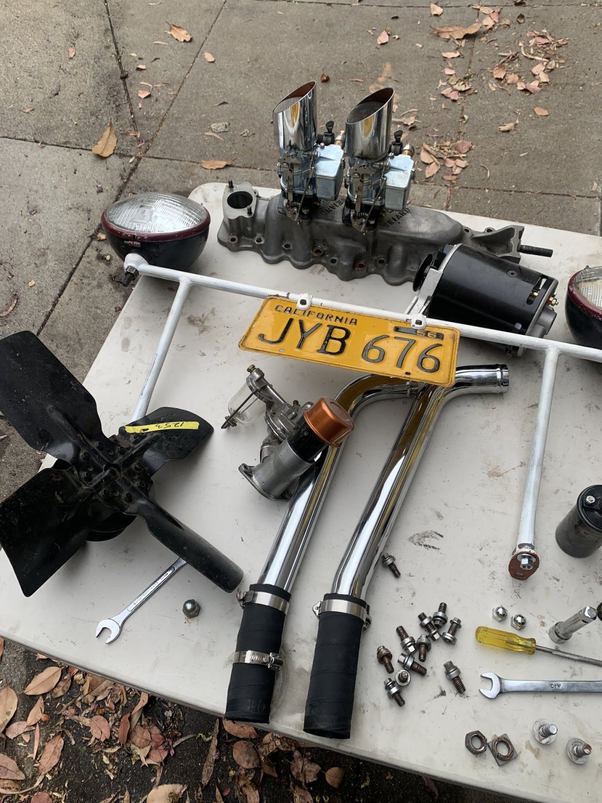

    Before I could even finish unpacking my bags, I was down in the garage tearing into the roadster. Today's goals? Remove the engine and transmission and then bolt on the 78- trans to see if it will clear the clutch.
    It didn't take long to get everything taken apart.
    Looking like a swap meet over here. No, it's all NFS!
    With the engine and old trans out, I was able to perform the swap. I didn't take a picture, but it became immediately clear that the new case had much more room than the earlier case. Rather than trying to turn it by hand, I hooked the battery up to the starter. RRRRR....RRRRR. It turned over! The pressure plate clears, and this is the first time I've ever turned it over with the starter. I’d chalk that up as a big win!
