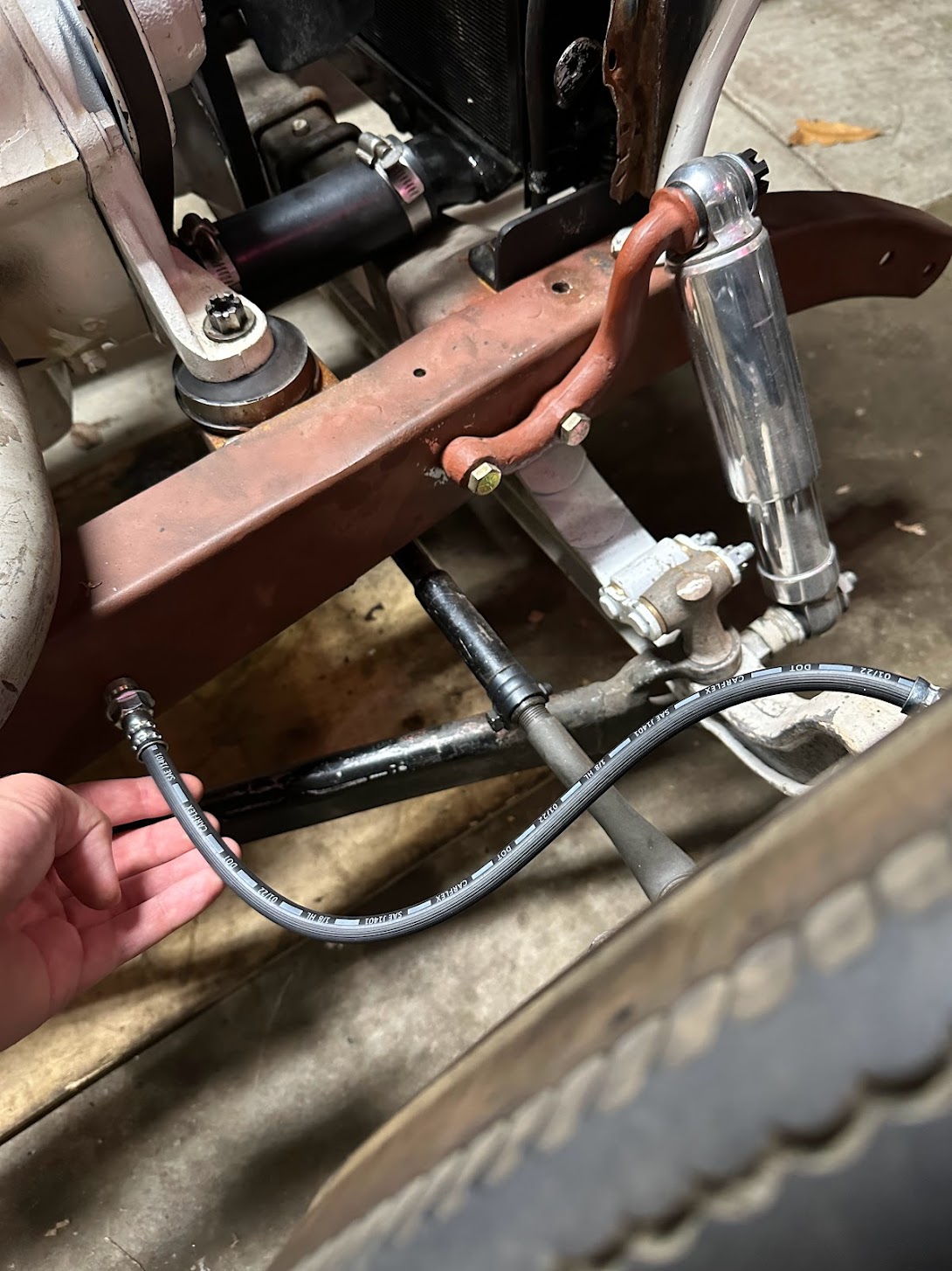

    Before I went to bed, I wanted to mock up the brake hoses to get a feel for where they'll live. I plan to drill the frame rails for the brake lines to pass through.

    Make sure you turn the wheel lock to lock in each direction to ensure enough length and no rubbing. Also give yourself some buffer for possible future tire size changes.

    The first order of business? Think about the brake lines. Recalling @Speedy Canuck's advice, I realized it will be best to actually mount the brake lines beneath the frame on small tabs rather than through it. In this configuration, the lines will be easier to service and the rubber hoses will not interfere with the turning. (I'll conduct another test when I can get a jack under the front end.)
    Next, I broke out all my new fittings. As I pulled them out of the bag, I kept on thinking about the old Eelco slogan: "Fittings That Fit." Luckily for me, everything seemed to fit nicely.
    Progress on the master cylinder.
    And on the front driver's side too.
    It didn't take long in the garage for my mood to change. All of a sudden I was excited to set up the brakes again.
    For my final bit of fun, I broke out the Eastwood tubing straightener. With the nicopp, it was as simple as could be.
    I know many of you have set up countless juice brake systems, but this is my first one—ever. To be completely transparent, I'm feeling a little intimidated. But that's a good thing. Because if I take my time, I can make it work (and grow along the way, too). That's what this project is all about.

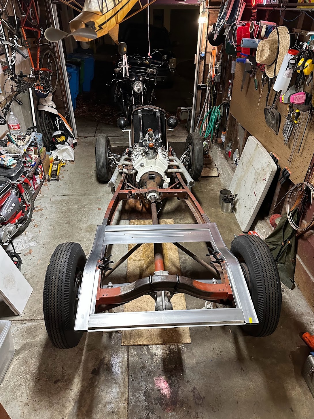

    Since I was on a roll, I knew I had to do one more thing. I hiked back up to the hall closet and pulled out a heavy box that had been sitting in there for months. With the Buck 110 that my brother gave me a lifetime ago, I sliced open the cardboard and pulled out treasure: my @Steadfast mfg subrail kit. "Woah," I said. "This thing is really nice."
    It's loosely mocked up right here, but I can already tell it's going to help a great deal once it's time to move on to the next steps.
    That's all for tonight—hopefully more soon!

    It's always interesting, to see the interior photographs, of fellow HAMBERS garage spaces.
    No doubt that 2.0 is the center of attention in this particular photograph.
    I like to imagine that when the lights go out, the cool Honda trail 90, and the intrepid rubber band powered J-3 CUB and the roll of FOMOCO MOTORCRAFT tape, from their vantage points, all have interesting conversations about the continuing progress of 2.0
    I am sure the dustpan has it's share of positive comments as well !
    Keep at it kiddo, you are making great progress !
