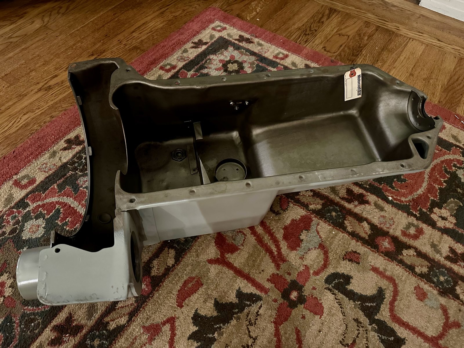

    As I ride the #5 city bus back from work, I realized that I didn’t post pictures of my new oil pan. I went back and forth on this one, but eventually I decided to splurge and buy the nicest one I can find. My old pan was a ‘46-‘48 that wouldn’t clear the wishbone. This is an early pan that I plan to persuade to gain as much clearance as possible. IMG_9874.jpeg
    After scrubbing out two of them, it’s nice to have one clean enough to photograph in the living room. IMG_9875.jpeg
    Oh, and I’ll make sure the crank clears everything this time, too.
