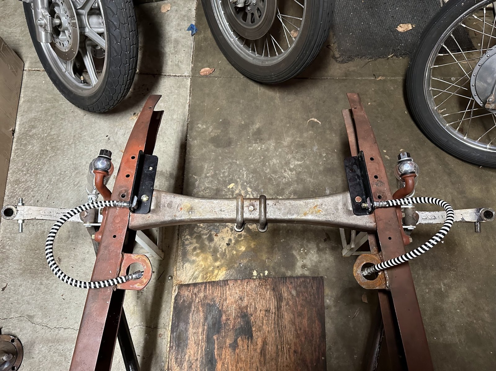

    I didn't get to spend a ton of time on my car tonight, but I did make a little bit of progress. After work, I stopped by the hardware store in North Beach to get some touch-up paint for the transmission. I also, thought I could guess the size the front wheel cylinder bolt, but I ended up being slightly off. No problem—I'll bring one with me next time.
    I pulled the tie-rod and measured it so I know how much to narrow it after un-dropping the ends.
    It'll be nice to check this off the list. Once I have the tie-rod sorted, I will have the spindles reamed. Then it's paint, brakes, and final ***embly for the front end!

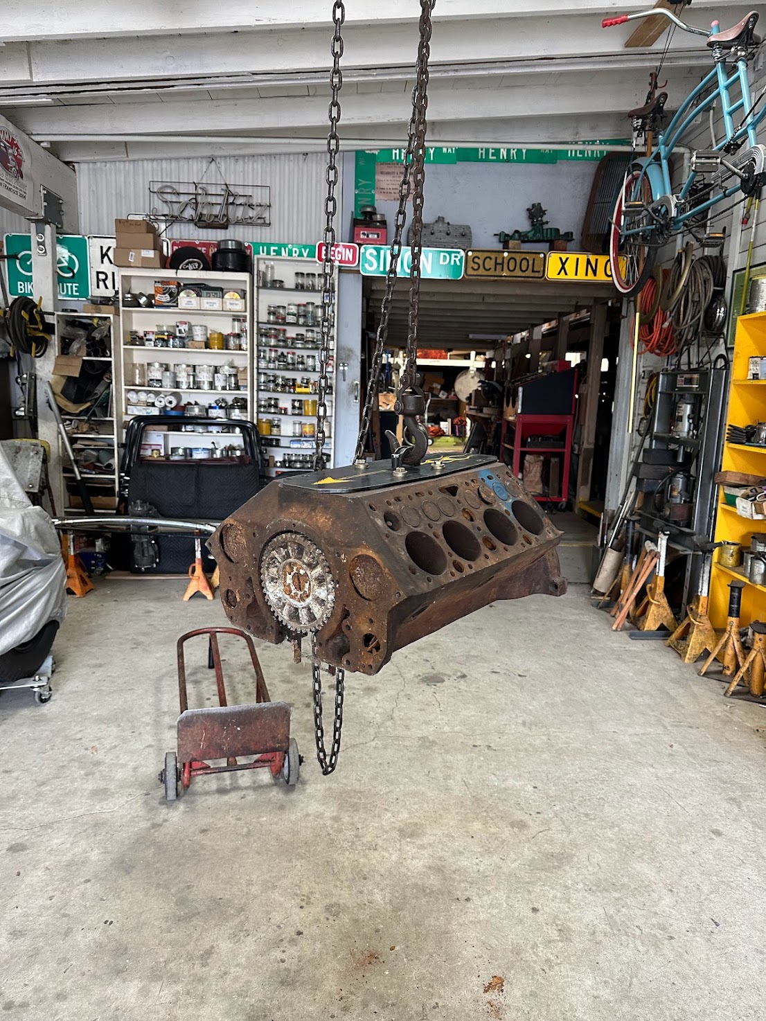

    On Saturday, I got to go to one of my favorite places in the world: David's shop. The whole drive up there, I didn't listen to music or talk on the phone. Instead, I just thought about the projects we were going to take on that day. I soaked up every mile of highway—the traffic, the trees and the exit signs—and I appreciated everything I saw. Driving up Petaluma Boulevard, I just felt so glad to be there. It's hard to explain.
    And when I walked in the door, the fun began. First, a photo shoot with one of his customer's cars.
    See more on his Instagram here.
    Then we dove into modifying my oil pan. To keep everything square, we used the original block from his yellow roadster. DDH3x.jpg
    It once had Grancor heads and 3x2s.
    But on Saturday, it was only wearing a very fresh 1936 Ford oil pan.
    We bolted them together and prepared the torch. Then we paused. "Where would the metal go?" we asked. The more we looked, the more we realized that modifying this piece of the pan could cause a misalignment with the starter and ring gear. Since I have not yet tried this pan in the frame, we decided to not make the modification. Maybe it won't need it? Or, if it does, we can modify the wishbone instead.

    Maybe I missed it, maybe I just forgot but what’s the idea behind modifying the pan? Did the old one hit?

    The old one was a two-piece pan where the flange hit. I was just being cautious with this new pan that should—in theory—clear the wishbone. We'll paint it up, bolt it on and give it a try a little later on.
    Oh, I'll see what other info I can gather on it!

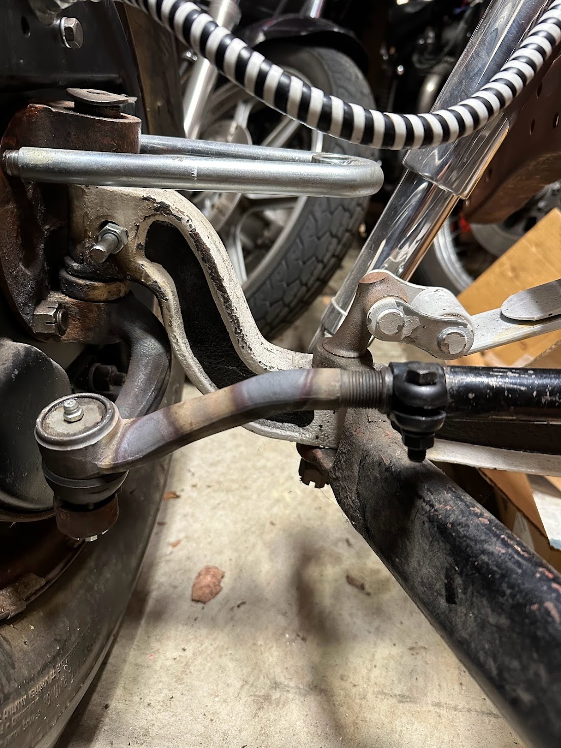

    Next, we directed our attention to the tie rod ends. If you can recall, the Speedway ends brought the tie rod too close to the frame with the engine and transmission installed. Unsure if this would work, I contacted Speedway months ago and they confirmed that they were indeed forged. So, after lunch, we dove right in.
    First, we used my piece of wire as a guide to draw our new drop on the bench in blue Sharpie. Then, David used his expertise to figure out the best way to clamp the ends in the vice. He reminded me that figuring out how to hold the part is often the most difficult part of a job like this.
    With torch in hand, David tackled the first bend. We alternated sides to allow for some cooling. Just like with some of the other ***emblies, he took on one side and I did the other.
    After measuring the altered tie rod lengths, I cut 1.5 inches out on the Grizzly bandsaw.

    As soon as I got home, I dropped the tie rod into position. It was a perfect fit with plenty of room for adjustment. With a little bit of primer and paint, it’ll look right at home on the nose of 2.0.

    At this point, you're probably wondering: why modify the tie rod now? That's a great question. The reason is that I need to send out my spindles to get reamed and I wanted to have everything else finished first. So, along with driveshaft shipping prep, I focused on the spindles tonight.

    Good progress! I’m curious your process for narrowing the tie rod and why you opted to cut and veld verse cut and re thread the end deeper?

    Thanks, Tim! We narrowed the tie rod the same way as we did in June 2022. Bandsaw to belt sander to David's homemade V-jig. As a matter of fact, we actually cut it in the same spot.
    As far as the re-threading is concerned, there wasn't enough room in the threaded "pocket" to do that. We ended up cutting out 1.5 inches. Plus, it gave us the perfect opportunity to fix my less-than-perfect grinding.
