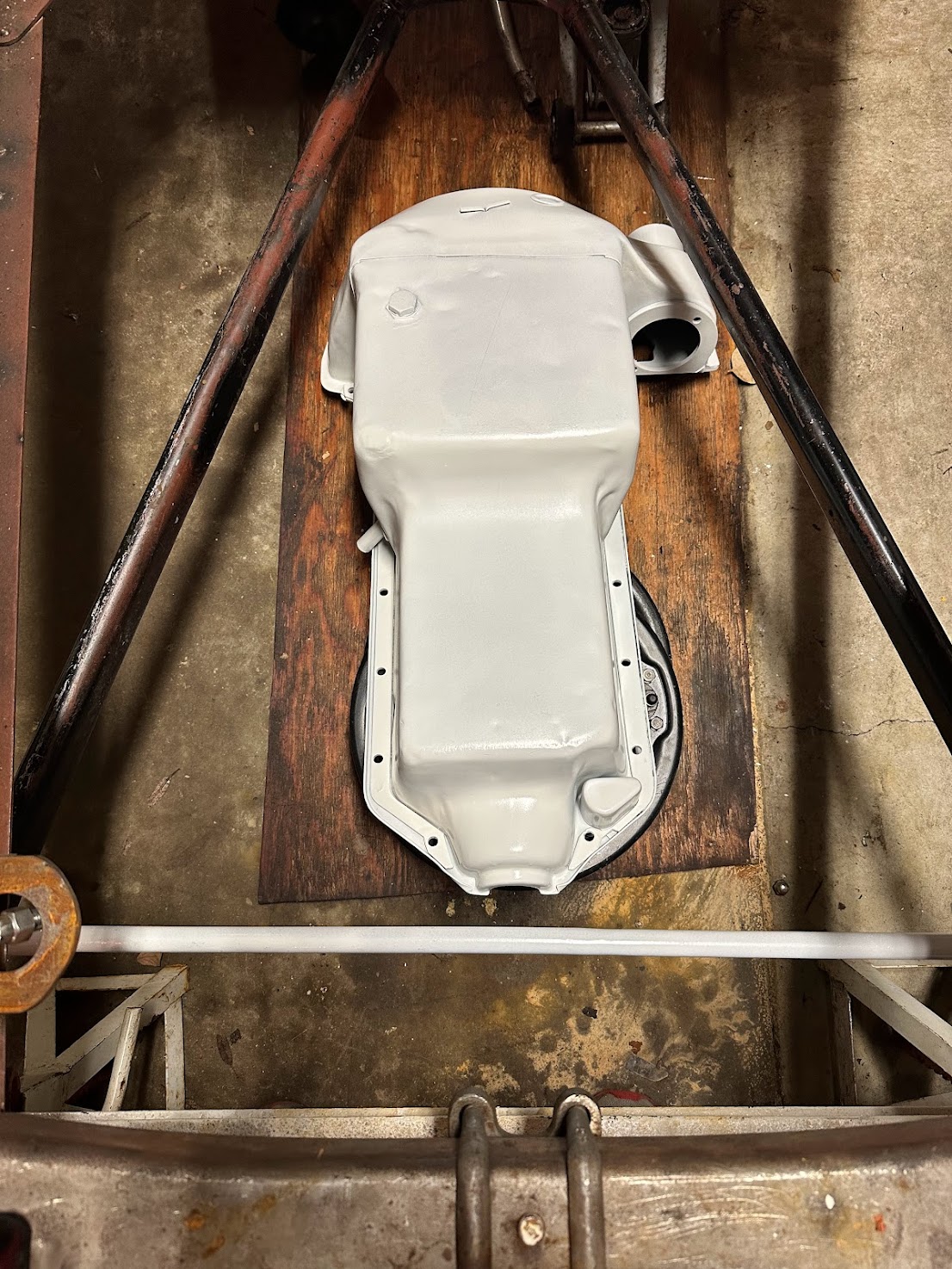

    Back from Idaho and back in action. When I was in Hailey, Idaho, I saw a 1932 Ford five-window parked in a driveway—in the snow! I couldn't believe it. If I recall correctly, the car had black steelies, no fenders, and lettering on the doors. We were on our way to hockey, so I wasn't able to snap a picture. If anyone knows the owner, I'd love to hear from them.

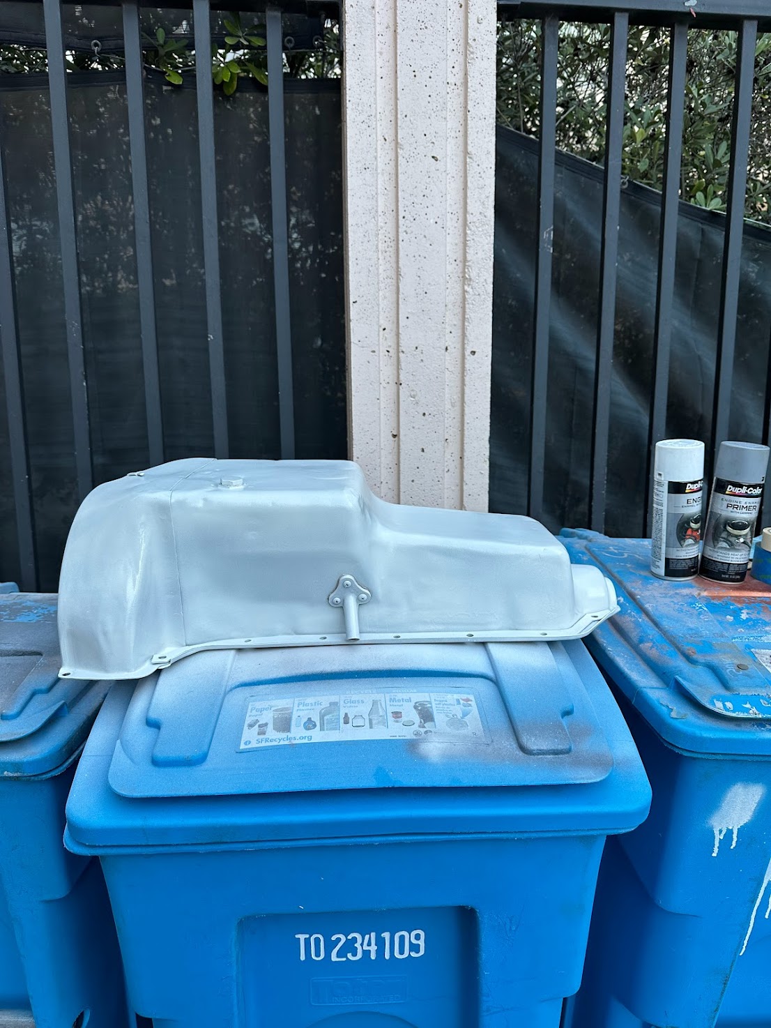

    My flight got in at three, and by 4:30 I was out in the driveway spraying paint.
    The pan is almost completely painted now, and the tie rod will get a few more coats next time the sun comes out. (And don't worry, I made sure there weren't any dents that would interfere with the crank this time.)

    As soon as I got home from work today, I sprayed a little bit of paint. Both the tie rod and oil pan still need more; I'll get to it next time the sun is out. IMG_0235.jpg

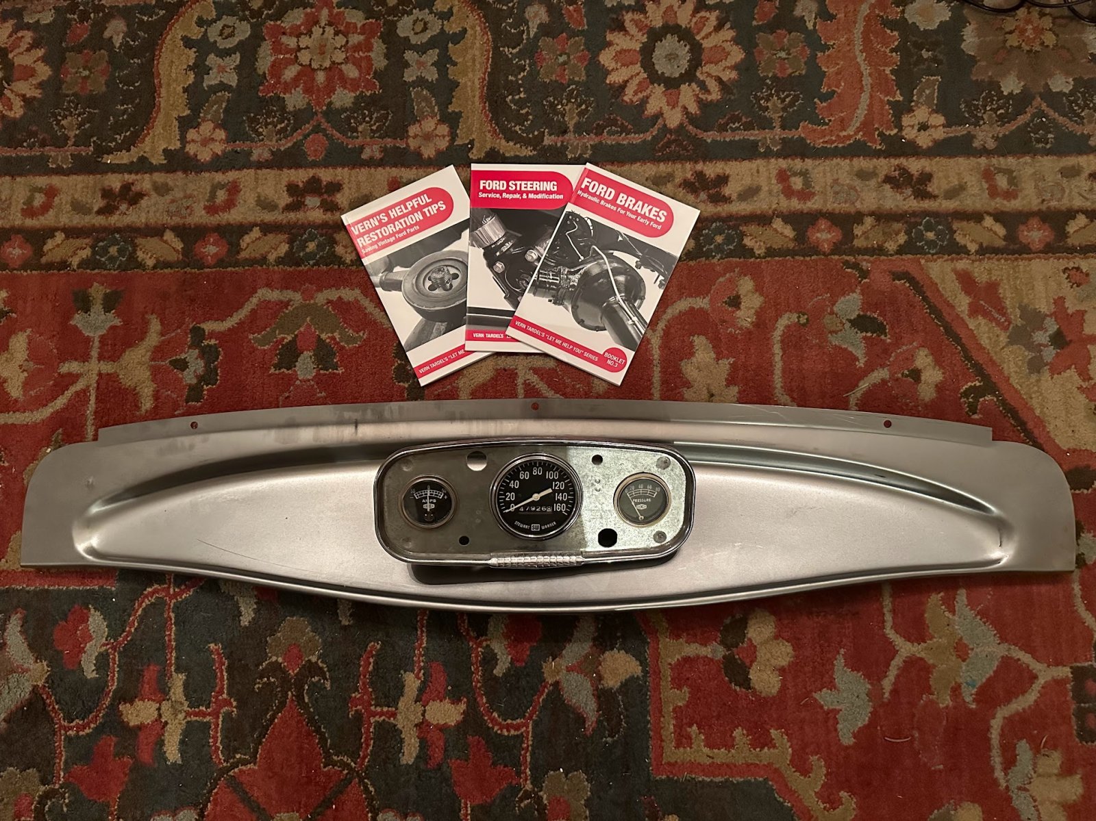

    It was a great mail day at the Terrace. I got my dash as well as some new reading material from Vern Tardel.
    And I had to break out the instrument panel.

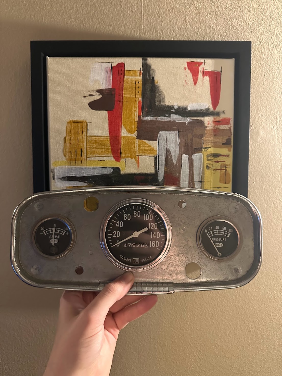

    Hey @J.Ukrop
    What's the back story on the cool retro abstract painting on the wall?
    Was it a score from some cool rummage sale in the neighborhood?
    Or was it something that you actually created?
    Inquiring fellow artistic minds would like to know!
    That dash and the gauges are cool !

    Hey! That is an original of mine. It's called "This is the City Part II." I painted it a few years ago and gifted it to my roommate. It was somewhat inspired by an original abstract expressionist work I have in my collection.
    Figured you would appreciate it!
