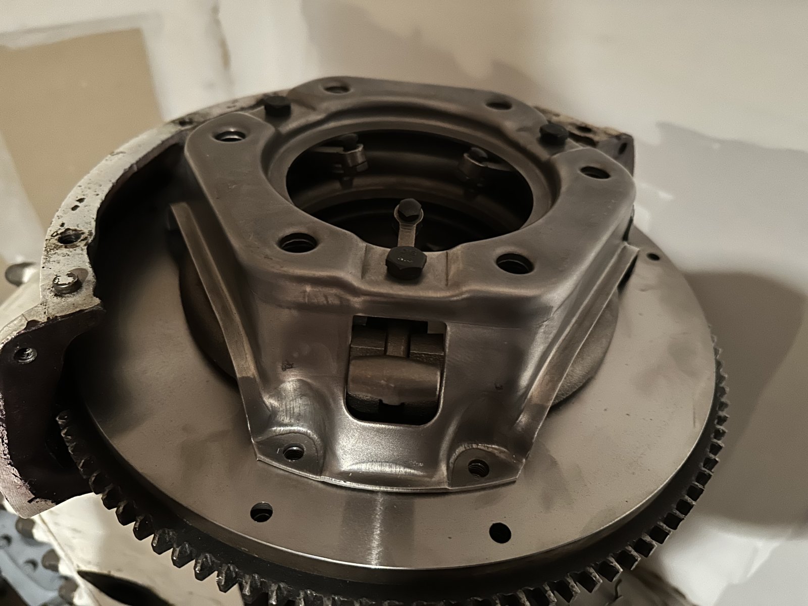

    First, I mocked up the flywheel and pressure plate. Next time I’m in the garage, I’ll bolt them all together, complete with Loctite and safety wire where applicable.

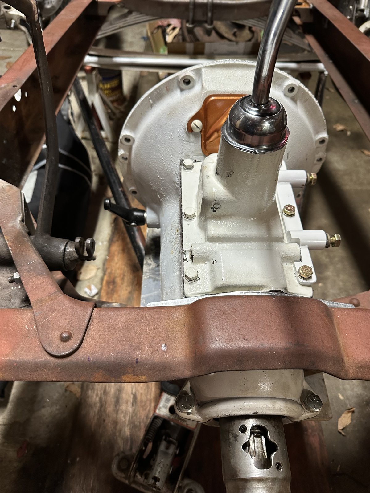

    Next, I installed the driveshaft and bolted in the transmission to make sure everything fits. As far as I can tell, it does.

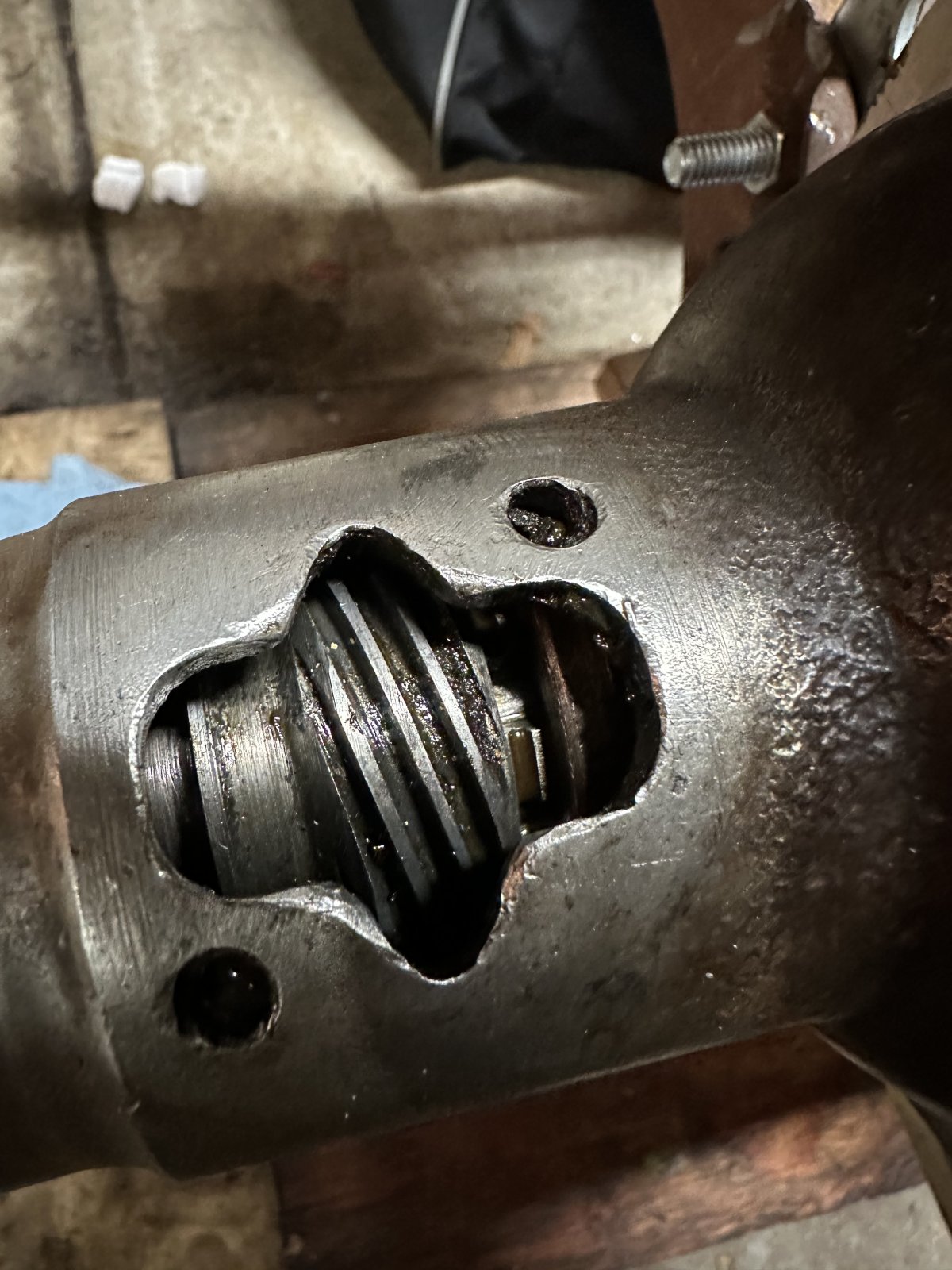

    The setup leaves 15/64ths of an inch of axial movement for the speedometer gear. When I install the gasket between the rear of the torque tube and the quickchange, that’ll bring it up to exactly 1/4-inch. Per my research, that’s spot on. (Yes, the gear needs cleaning.)

    With the rebuilt trans in the frame for the first time, I was pleased to see how well the clutch lever lined up with the pedals.
    After a little bit of modification, I should be well on my way.

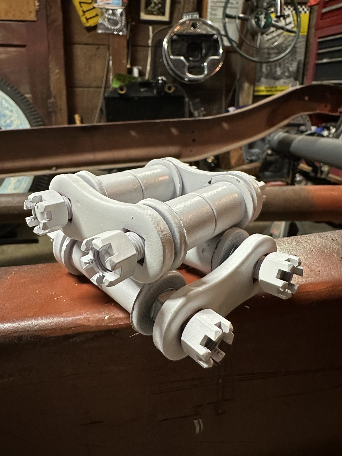

    Made the most of my lunch break and got my Carrillo shackles ready to go. Don’t worry, I won’t be using the plastic bushings. Cotter pins will be used all around.

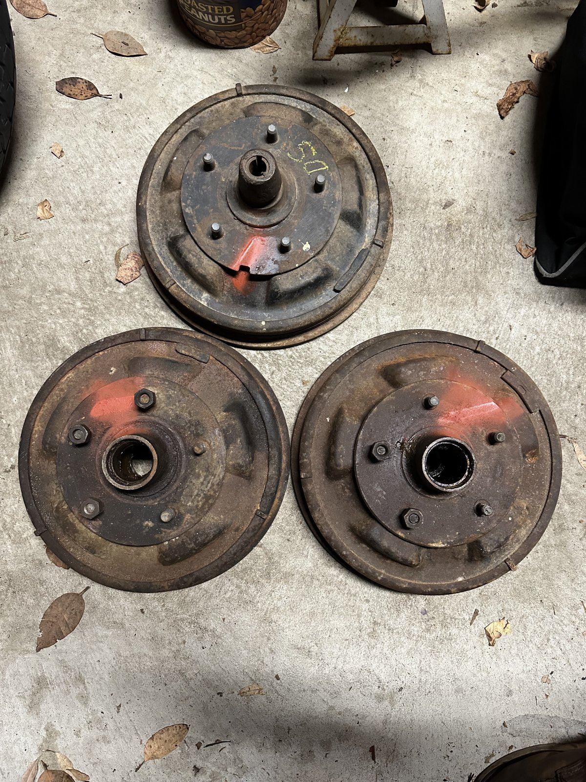

    Then, David taught me the finer points of disassembling early Ford backing plates.
    And pulling seals and inspecting bearing races.
    When it was all said and done, we had three drums ready to hand off to Jeff of Moose Motors. He's a master of all things brakes and clutches, and I couldn't be more excited to have him turning the drums and arcing the shoes.

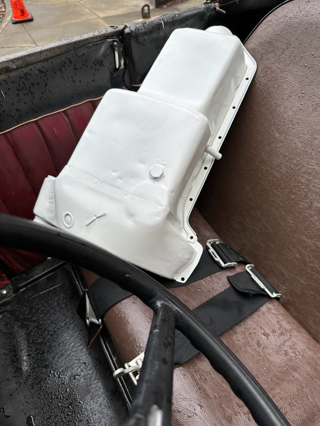

    Updates from the rest of the weekend
    Old roadster, new hat.
    Rainy day oil pan delivery.
    Flywheel install? Check. Clutch and pressure plate install? Check. Everything has been surfaced, balanced, safety wired, Loctited, and torqued to spec. When I had questions along the way, I spoke with Mac Van Pelt.

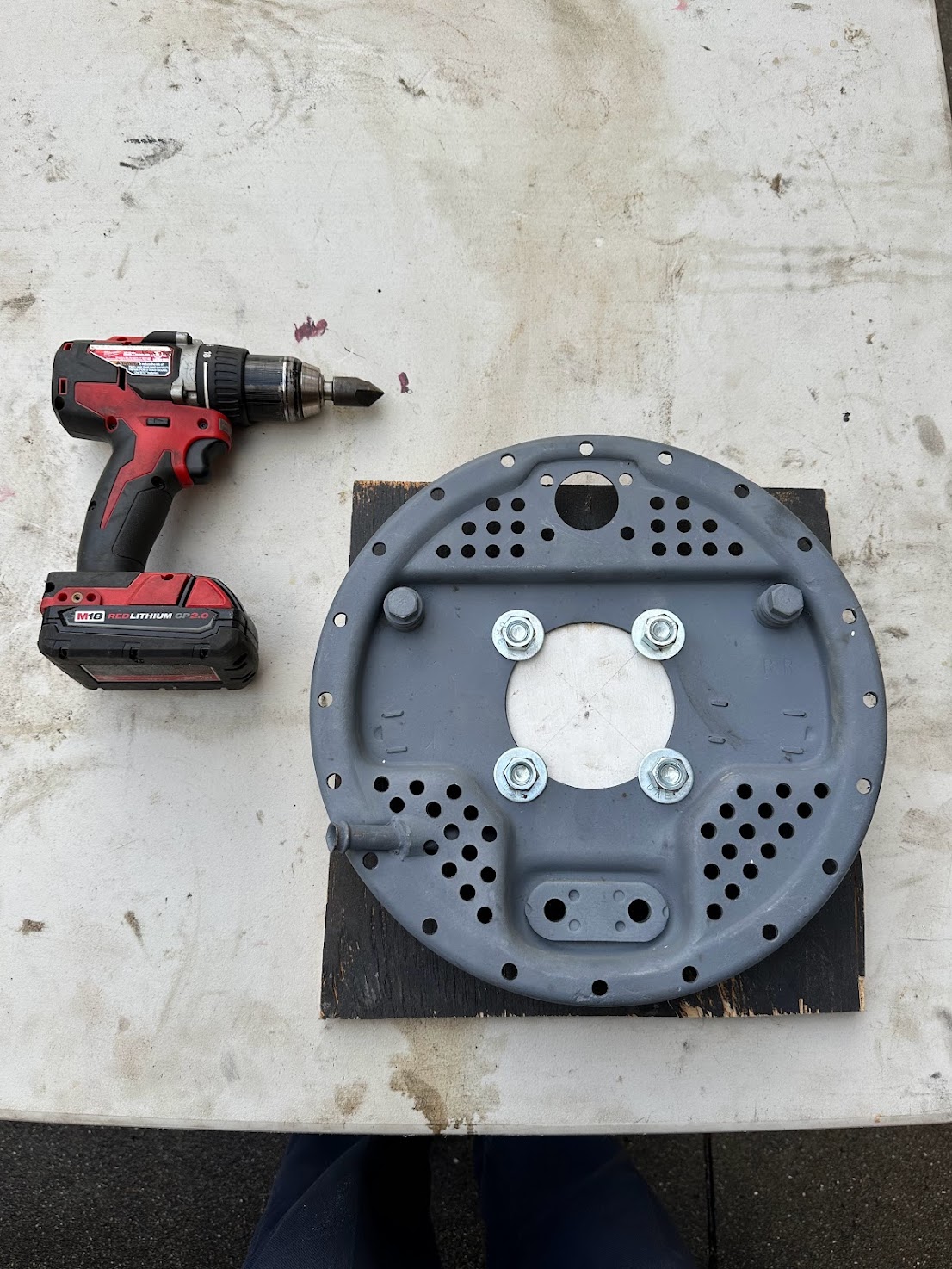

    Lastly, I cleaned up the holes on one of the backing plates.
    Then I primed them and began to paint. I'll post pictures of the finished product this weekend if it doesn't rain!
