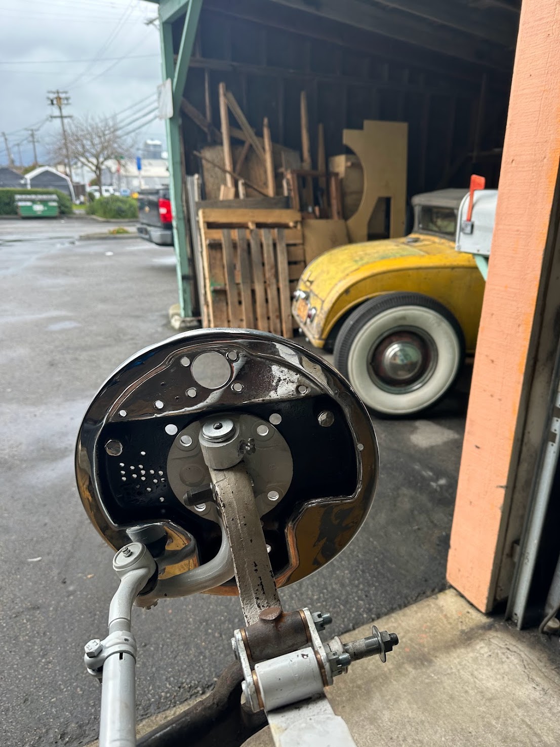

    On Saturday morning, I jumped in the truck and motored north to Petaluma. As I drove across the bridge, I talked to my parents on the phone. "What are you working on today?" my Mom asked. "We're setting up the kingpins, spindles and the front brake backing plates," I said. "And whatever other fun projects we can find!"
    Walking up to the shop, I greeted David out front. The first order of business was to turn on the parts cleaner and then check out the results.
    "No matter how many times I do this, it's always exciting," David said as we sifted through the resin in the back room. I couldn't believe how everything looked brand new.
    Although I may look a little crazy here, it's because I was captivated by the magic of the process!

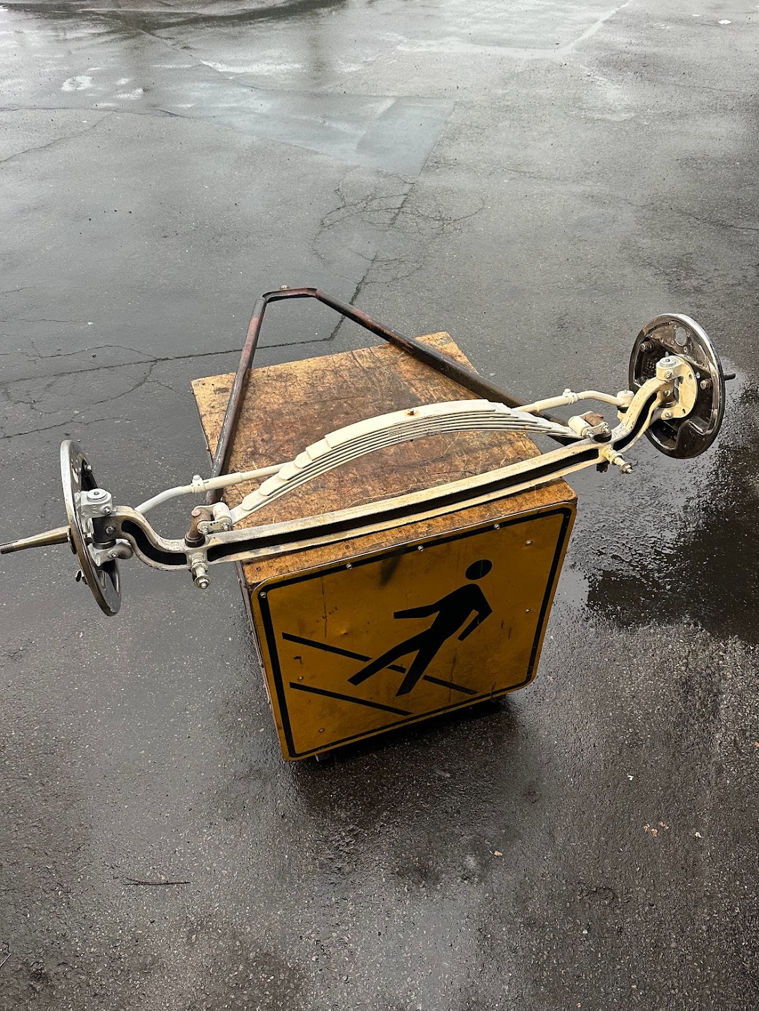

    Next, I turned my attention to the front end. I spent the latter part of the morning cleaning the necessary surfaces and test fitting everything. Then it was time for lunch. The rain had stopped, so naturally we took the roadster. (We would have taken it regardless.)
    Back at the shop, I'd try one shim, then shake the spindle. It would move ever-so-slightly. I'd ask David and he'd offer advice. By the end, I got the hang of it and had both sides looking and—most importantly—feeling right.
    David has the right tool for every job. Here he cleans up the kingpin locking pin hole with a straight reamer. We each tackled one side of the axle. IMG_0991.jpg
    He also gifted me this amazing little micrometer, which I used to measure the shims. Can't wait to use it on future projects.
    Oh, and remember when I said we were able to find a 90-degree zerk? This is where it came from. "This jar of chili peppers was pre UPC," David said.
    We also tuned up the backing plates to fit the spindles. They needed a little bit of finessing, but now they click together perfectly. Before leaving, I had to mock everything up.
    Note the original steering stops. David felt that they would better fit the style of the build. I couldn't agree more. Old chrome, old parts and white paint. It's exciting to see it all come together.

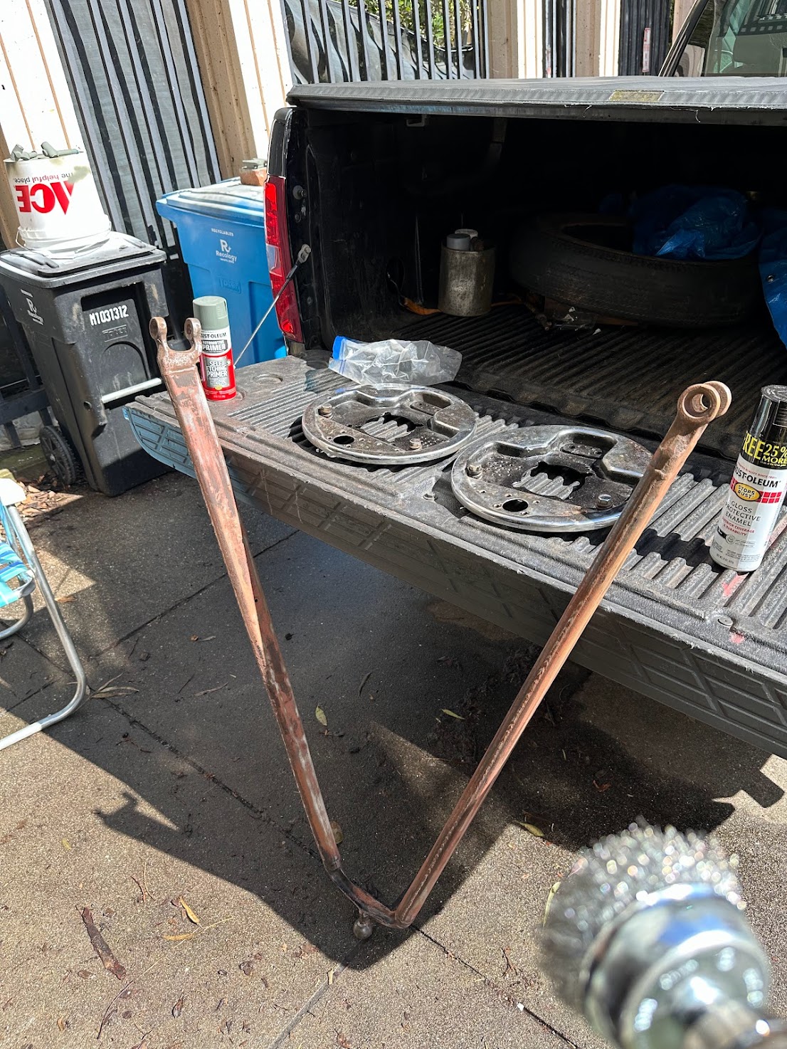

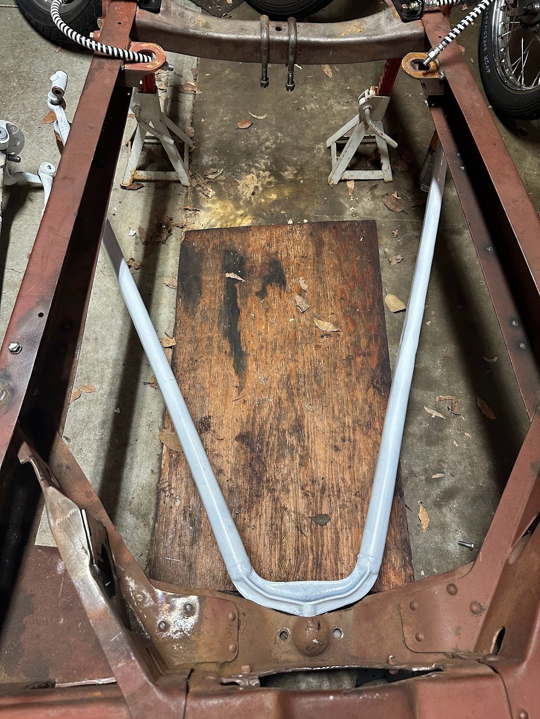

    On Sunday morning, I made the most of the weather and got right to work. I set up shop in the driveway, cued up some Grateful Dead and dove into all the taping, sanding, priming and painting.
    I cleaned up the wishbone a little bit too.
    Bad lighting, but I was happy with how the perch pins turned out.
    Bronze bushings by our friend Jerry Larochelle!
    Tonight I got some paint on the wishbone. I plant to hit it with a few more coats when it's not dark out. That's all for tonight. More updates happening later this week!

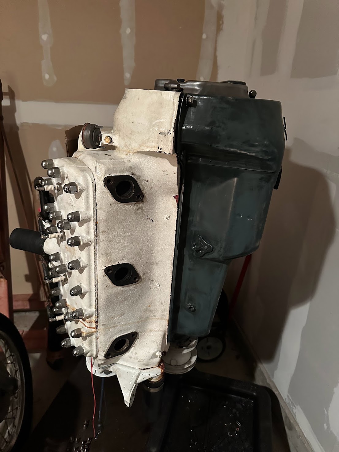

    Oh, one more thing. The other night, I went to go install my freshly painted, early-style oil pan and—you guessed it—it didn't fit. My engine has an 8BA pump, which interfered with the baffles on the earlier pan. Confused, I called Mac Van Pelt and he said running a different pan without a baffle shouldn't be an issue as long as I'm not weaving through a slalom course. I don't plan to (for the time being). So, rather than cut up a super nice pan, I found another one. Enter oil pan number four.
    The best part? It fits! I've scuffed the Ford green, and it's time for primer and paint. I'm getting pretty good at this process!
