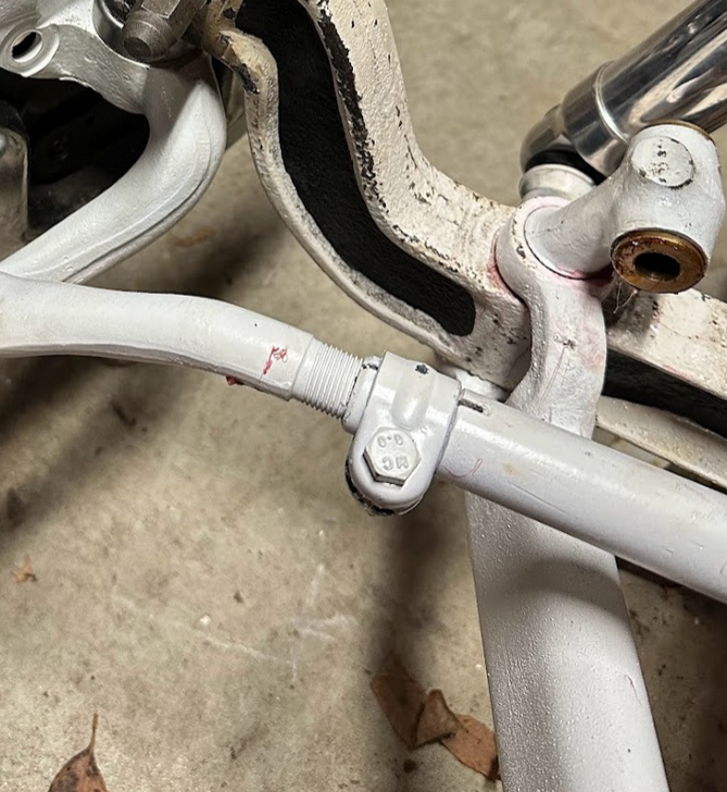

    I realized that in my brake post, I failed to include a finished shot. I'm waiting on castle nuts for the backing plate bolts, but I believe they should be at the house when I return later tonight. Note the chrome hardware for the wheel cylinders. Once I have the backing plates and grease shields installed, I just need to torque everything to spec, add cotter pins, and then the front end will be finished. I'll be painting the drums this week.

    Joey, in that latest picture, the backing plate nuts and the shackle nuts are castle and pin. You might want to trim down the shock stud and drill it to match.

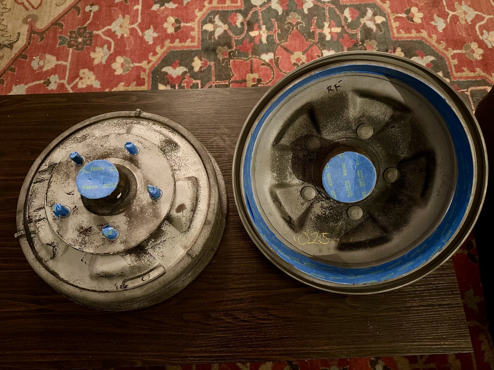

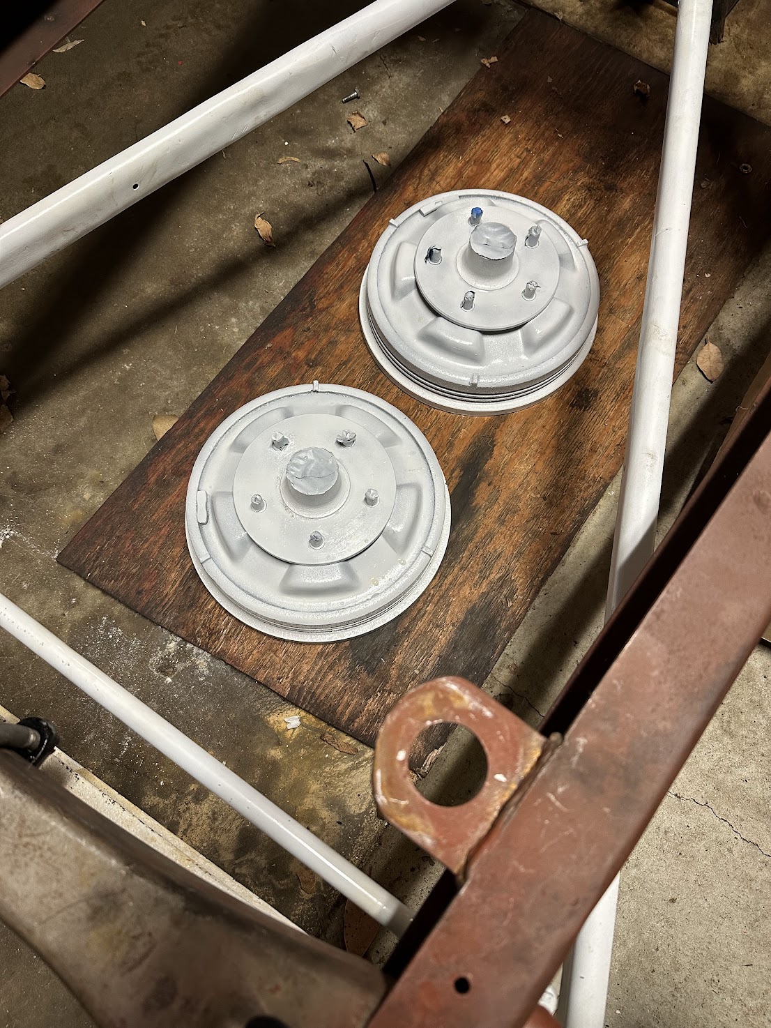

    Last night, I prepped the front drums for paint while watching what’s considered one of the worst movies of all time: “Rock and Roll Wrestling Women vs. The Aztec Mummy.” The critics were right—it wasn’t very good. Nonetheless, I’ll be spraying some primer on these later today!

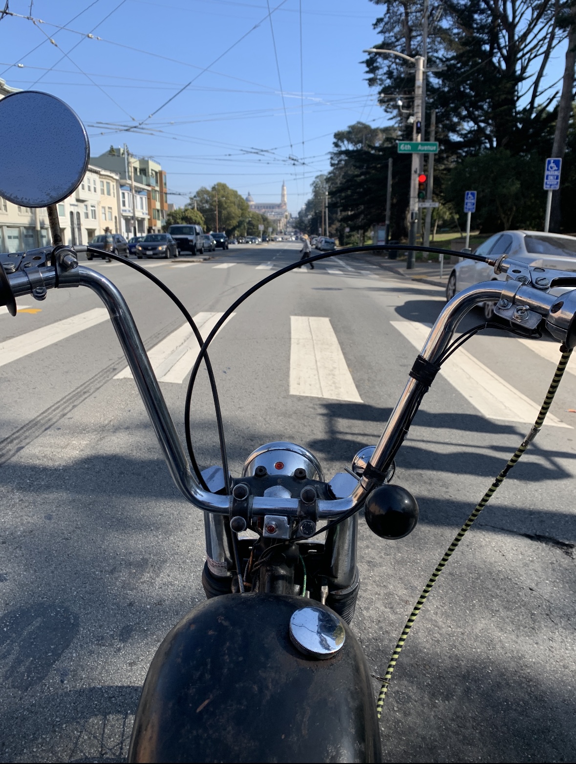

    This weekend, I took a much-needed break from the real world to join my friends on their annual spring motorcycle trip. I left the city after work on Friday, which made for a very cold night on the road once the sun had set. By the time I made it to camp, the temperature was in the 30s. Two days and 400 trouble-free miles later, I'm back on the Terrace feeling exhausted but grateful.
    My Harley is a throwback to my pre-roadster days. It's an old Bay Area survivor bike, but I've been through everything with the exception of the bottom end of the motor. I've been riding it for the past seven years. It's far from perfect, but it's like a member of the family. As I was making my way down Highway 1, shifting gears and listening to the exhaust, I was imagining doing the exact same thing in Version 2.0. Soon.
    All good things take time, and this bike and my roadster are no exceptions. When I got back into town, I immediately swapped two wheels for four. I jumped in my roadster and drove to lunch and then the hardware store. The sun was out, so I finished up a little bit of brake drum painting in the afternoon. I have some fun pieces of the project planned for this week, so stay tuned!

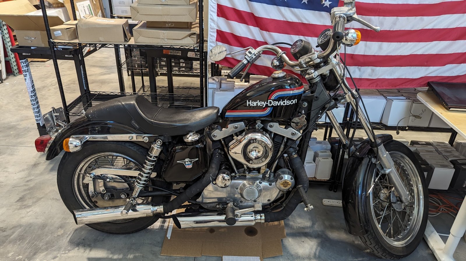

  29. fadingfastsd
    Joined: Jan 30, 2008
    Posts: 365
    fadingfastsd

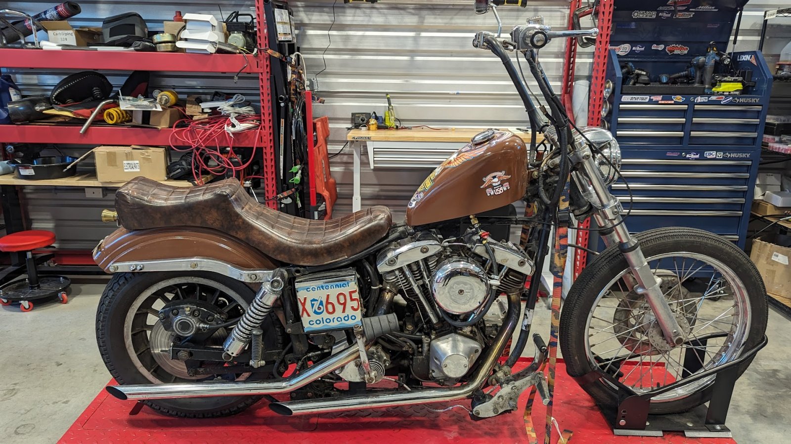

    Right on with the Ironhead! I run the same, Ironhead sportster, building a new chopper out of my Shovelhead, and loving my A. That's the recipe for fun for sure. PXL_20240201_194656136.jpg
    V8-m, Ragged Edge, J.Ukrop and 5 others like this.

    A man of taste! Great looking fleet there. I have a '66 Generator Shovel that I'll be building once Version 2.0 of the roadster is on the road. I have all the parts—I just need to find the time/money to put them all together. The A is looking great, by the way. I love the wheel color!
