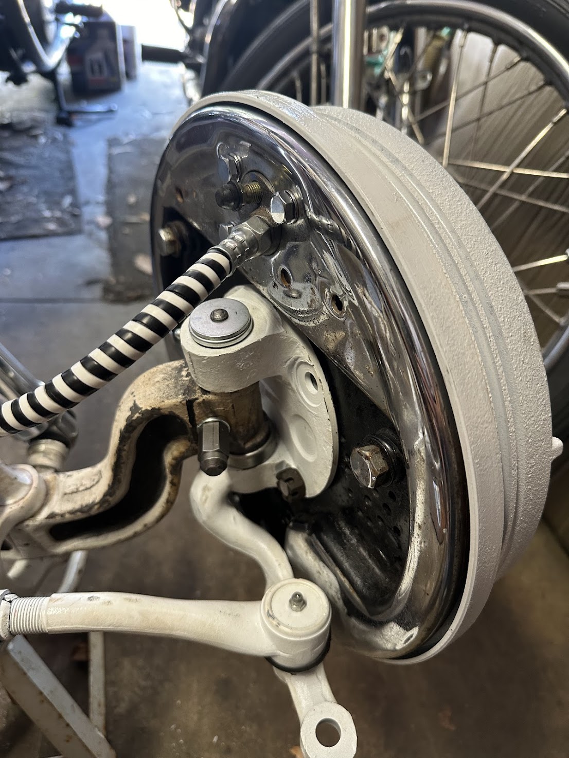

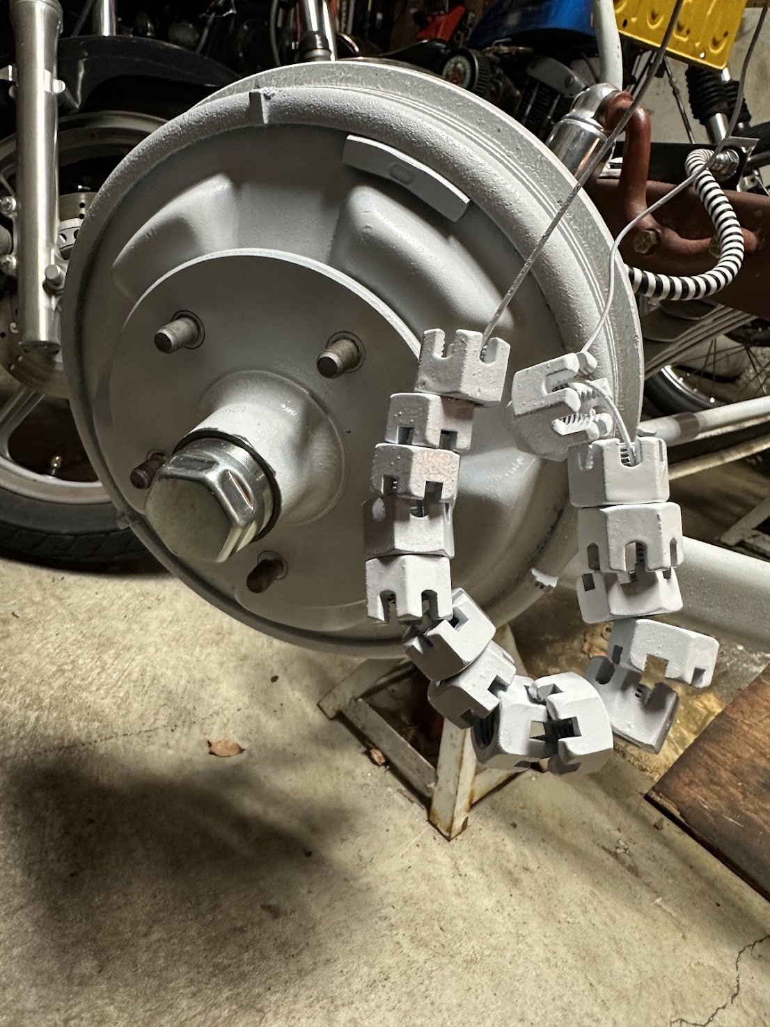

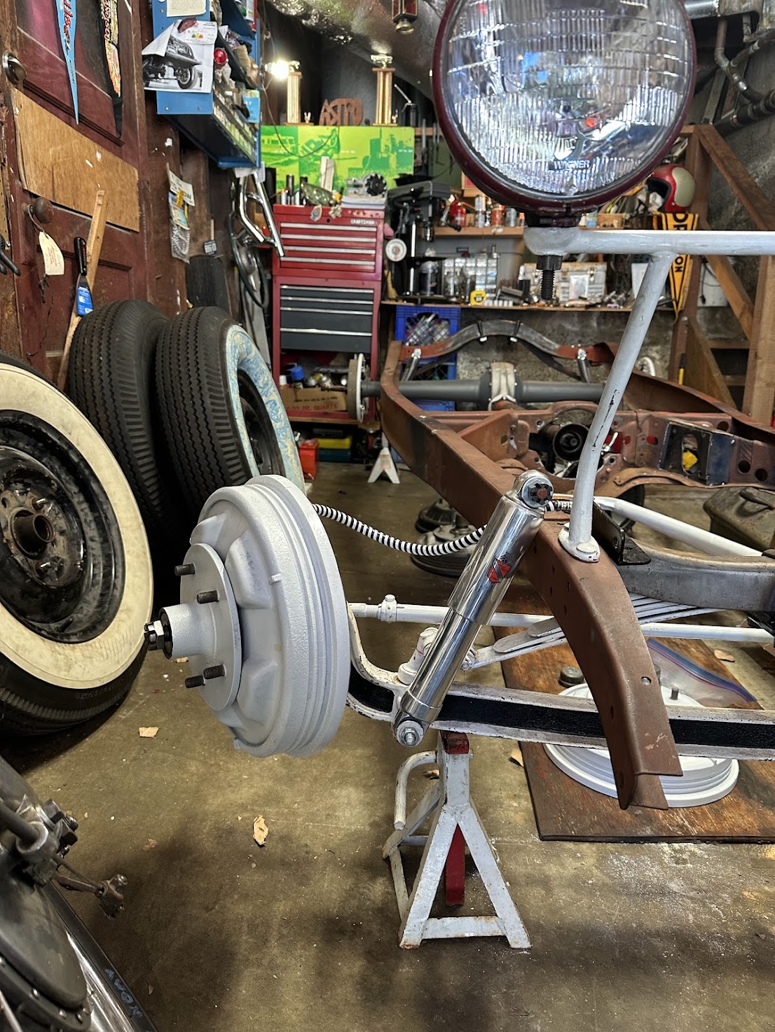

    After a fun call with David on my lunch break, I made some adjustments to my backing plates and slipped on the front drums.
    I'm not sure the last time these brakes were adjusted, but all four upper cams are now operational.
    If you're reading this, you know how long I've been looking forward to this step.
    And, to wind things down for the night, here's how it sits. I'm waiting on my castle nuts from Third Gen, but other than that we're pretty darn close.

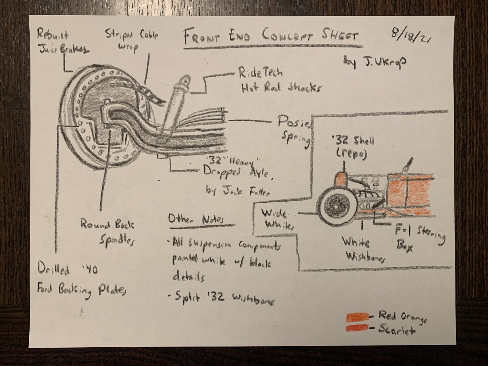

    I believe I've posted this before, but I figured it's worth sharing again. I've dreamt of setting up this front end since the summer of 2021. In so many ways, it turned out way better than I could have imagined.
    Earlier tonight, I left the garage, closed the door and walked halfway up the stairs. Rather than go inside, I walked back down and opened the door again. I took one last look at the brakes. The chrome, the white, the black, the crudely drilled holes, the cable-wrap—this is my roadster. This is vision realized.

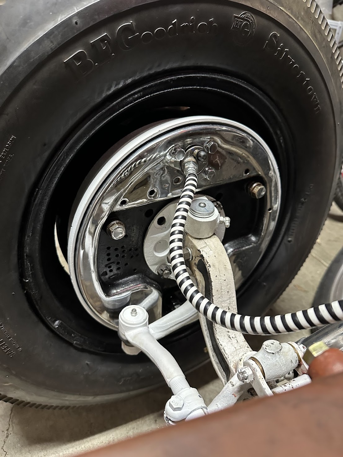

    Hey Joey what are those brake hose covers called? I'm trying to find them on ebay for some motorcycle projects but no luck. Thanks!
    J.Ukrop likes this.
  10. Dick Stevens
    Joined: Aug 7, 2012
    Posts: 4,120
    Dick Stevens
    It's called spiral wrap
    J.Ukrop and fadingfastsd like this.

    I've used that spiral wrap before with similar results. As a matter of fact, I used old phone cord on the headlights of Version 1.5. On the new version, I used Speedway Cable Wrap from eBay. IMG_2073.jpg

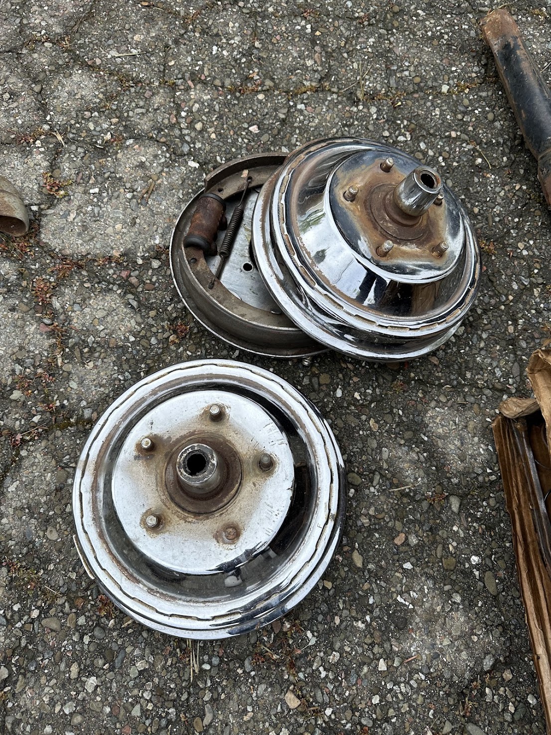

    I have to ask about the brake drums. I don’t remember seeing any with the hubs mounted on the outside of the drums. Are they special or just the way you wanted them?
    Six Ball likes this.
  18. J.Ukrop
    Joined: Nov 10, 2008
    Posts: 3,625
    J.Ukrop
    SUPER MODERATOR
    These are just stock 1946-'48 Ford brake drums. I do like how these have ribs on the outside of the drum. Maybe it's just for style, or maybe it helps with cooling?

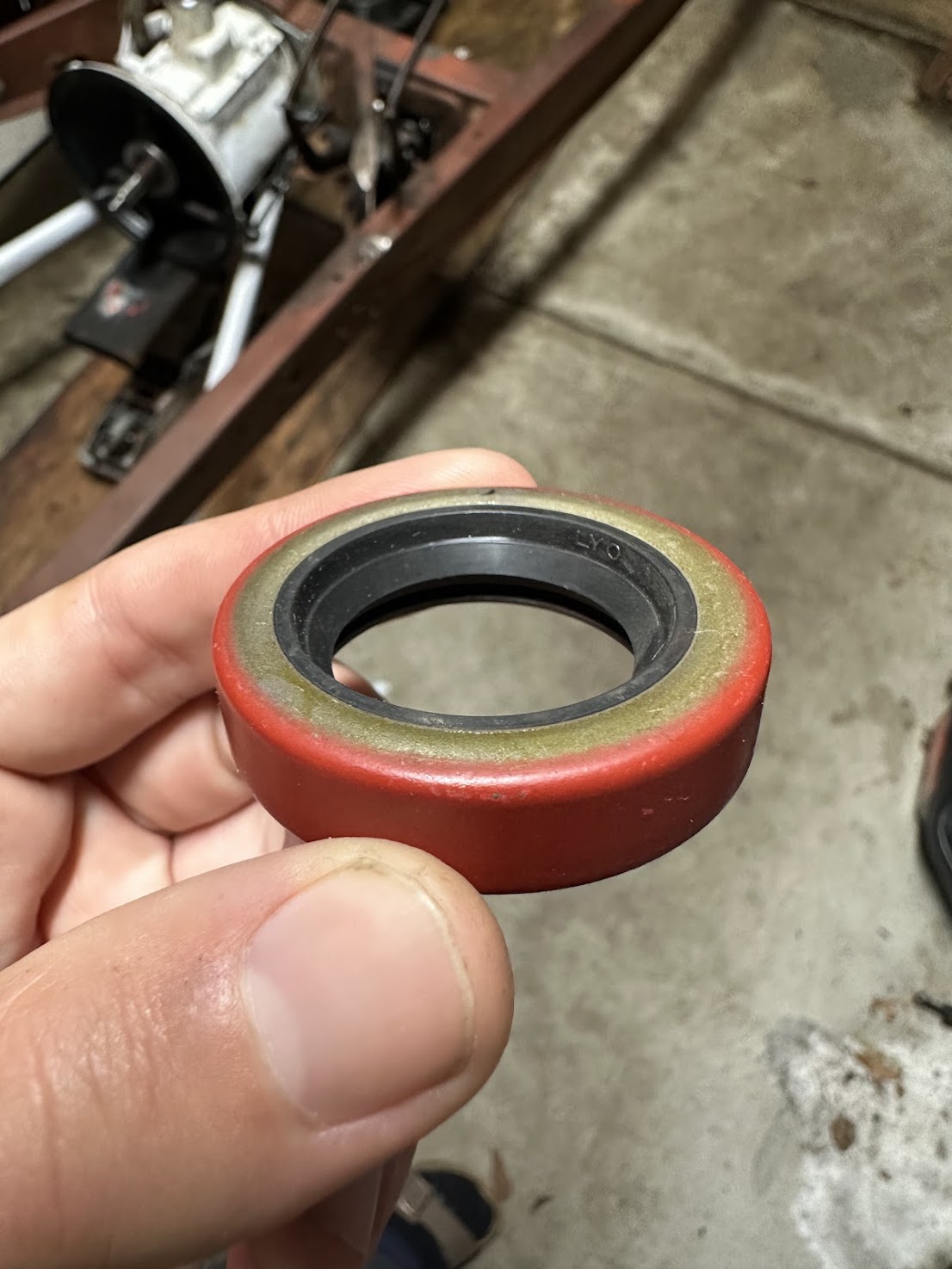

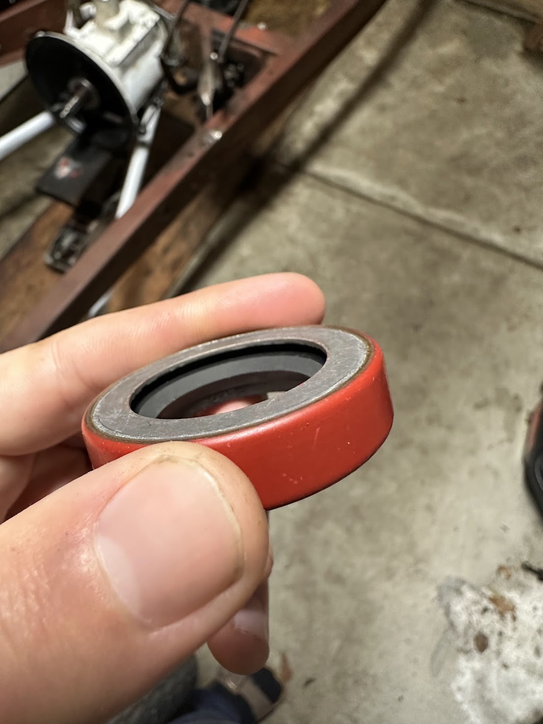

    In the meantime, I'm going to skip ahead. Which side faces the front on the torque tube seal? Is it: IMG_1762.jpg or
    Any guidance would be greatly appreciated.

    I have always installedd that type of seal so that the part it is sealing slips into it without catching the edge & rolling up the seal. Which way did the hub seals face? Maybe I'm just lazy.

    The first picture is the side facing 'out' the second pic is side facing the fluid.
    Hope that makes sense

    The lip of the seal always faces the fluid you're trying to contain.
