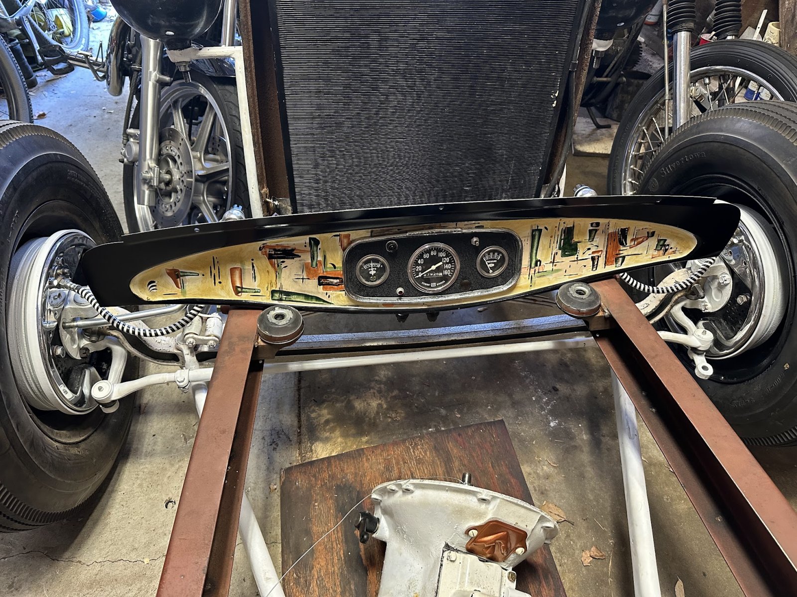

    Today I got to take on a task where I knew I could be successful: cutting my dash for the Stewart-Warner "Mate" instrument cluster. It's a project that started with a whole lot of measuring.
    I then created a paper template and moved it into position. Both the combination square and the cow magnets belonged to my grandpa. I remember being fascinated with the magnets as a kid. They really came in handy here. IMG_2535.jpg
    Next, I made myself a smoothie and mapped out my cuts.
    Using the tailgate of my truck as my workbench, I cut through the dash with my angle grinder. Success!

    To help make things more complete, I pulled a couple of lights and a switch from my collection. Longtime readers will recognize them from my Sunset estate sale haul back on page one of this thread. I plan to touch up the black on the cluster tomorrow.

    A very fun piece of the project, now complete. I look forward to seeing this in the car.

    Hey Joey, I am super impressed at how well the gauge panel looks, now that its mounted on the super cool painted dash.
    I like the way the black paint on the panel, corresponds to the black oval around the cool painted patterns!
    Bravo dude!

    Thank you! Seeing @Austin kays' coupe blast around the yard is getting me fired up to get this thing on the road.

    Thanks Dennis! I've always been a fan of cars with custom paint that retain their trim. My favorite example is the Mox Miller '58 Impala. I love how the trim brings the car back to reality, breaking up the candies, pearls, and fades.
    Here's a photo from the article in Rodder's Journal #32. If you haven't already, check out Pat Ganahl's video about the car here.
    Anyways, I approached my dash with that same mindset. There's a lot going on, but adding the black and chrome panel makes it much more manageable. The panel came from David's collection, and I couldn't be more excited that it has a permanent home in my A-V8.
