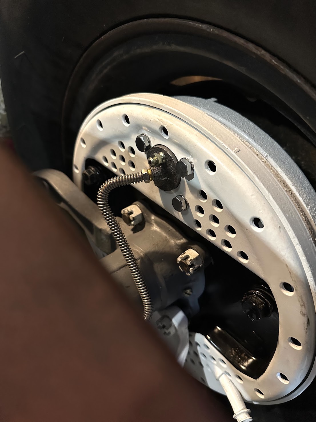

    Getting caught up...I have been absent for a bit.... and happy belated birthday. Looking great but I'm having a hard time getting my head around the springy, coiled stuff around the brake lines. I'm just wondering about NiCop and vibration....maybe my worries are unfounded.

    @winduptoy the coiled spring is basically a rock gaurd of sorts m. I’ve seen them on some pretty ancient hulks so I ***ume they are pretty traditional.
    the nicop shouldnt vibrate any more than anything else does when properly supported. Lots of over seas cars run it from the factory and I think it being a little softer probably keeps from any real chance of work hardening and failing.

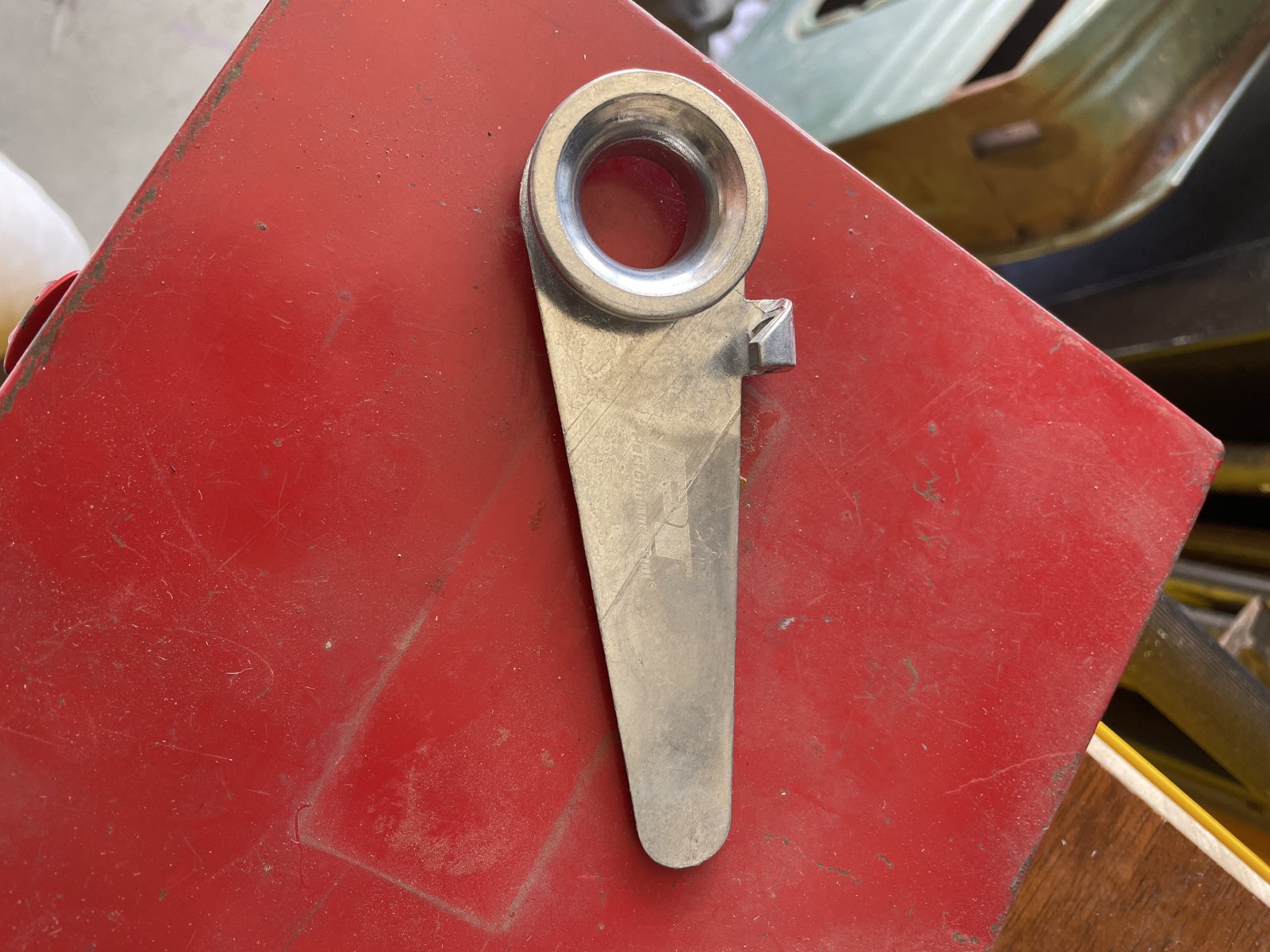

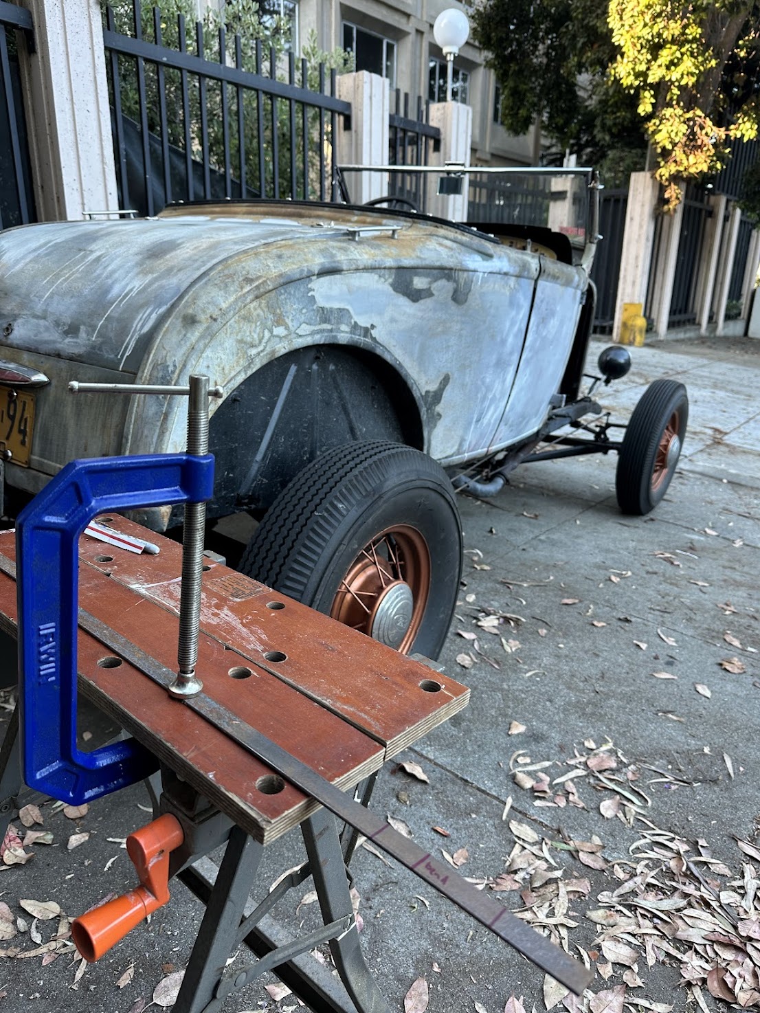

    Thank you everyone for the tool info! eBay and estate sales are my go-to, and it's good to know more about the composition of their handles. Speaking of tools, one of my neighbors must be reading this thread. Look what was left out for Recology to come pick up, but was too big for them to take?
    I scooped it up, carried it four houses down, and put it right into service.

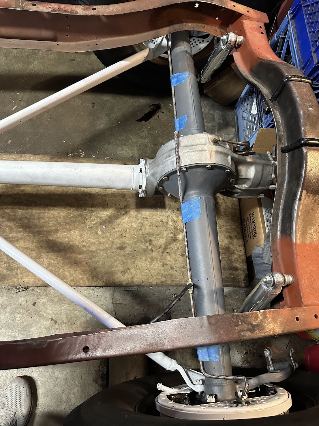

    Now, to a more technical project. I spent the first part of the weekend working on brake lines. IMG_2606.jpg
    Some of them took several tries, but I'm overall happy with how the system is coming together.

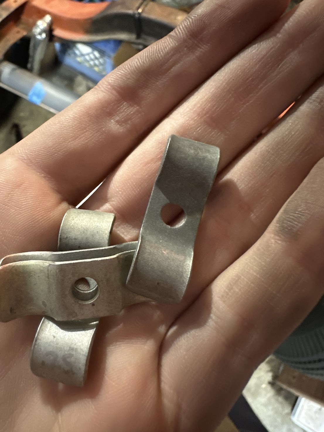

    My hardware for the clips should be showing up on Wednesday. For now, blue painter's tape does the job. IMG_2616.jpg
    Clips to be modified.

    I need to go to sleep, but I just wanted to share this shot before I sign off (I'll explain more later). I'm excited to share that the car now has a complete driveline. Running flathead, rebuilt-'39 trans, custom torque tube, and freshly built quickchange. This is big progress. That's all for tonight—I'll be back with more soon!

    A steering box and a crate to sit on and we’d have a fun video to watch I’m sure of it, but with those local hills I suppose waiting for brakes is ideal ;)
    Thanks for the update, curious to see you attach the lines to the banjo.

    Nice work! I ***ume the lines will be evenly spaced away from housing so they won't vibrate and wear.
    Bolts into housing, or welded studs and nuts? Either way, make sure of no leaks and easy removal and installation later.
