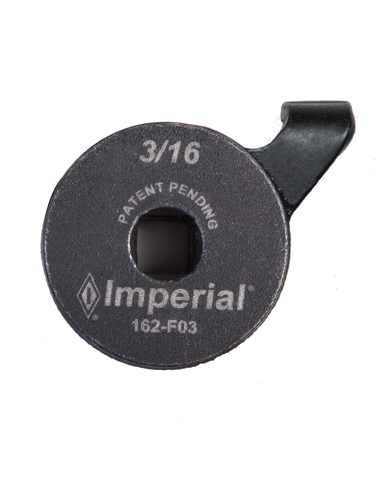

    Shame they aren't made in 5/16" and 3/8".

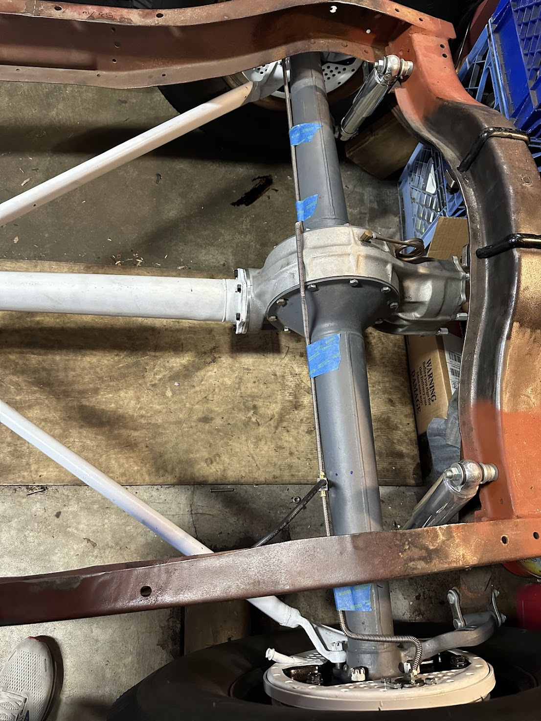

    upload_2024-5-29_20-33-43.png upload_2024-5-29_20-33-43.png it's going to be hard to purge that brake line of ALL the air.

    Tom, please explain why bleeding will be difficult?

    Curious why you didn't run the brake lines down the radius rods like the factory did. That way the mounting holes for the clips are all ready there.

    Great question. I initially had it set up like that, but then I opted for a different routing based on Vern Tardel's book Ford Brakes: Hydraulic Brakes For Your Early Ford. I know Vern and I trust his judgement. Both routings should work well—the one I ultimately chose eliminated the additional bracket that I had made last fall. IMG_7389.jpg

    When you run the brake line as shown on the rear axle, up over and down, you're going to have a hard time bleeding the right rear brake cylinder. The air in the brake line adjacent to the quick change will always try to rise.

    I understand that a high spot can allow fluid to flow under the air and leave it in the line. However, manufacturers have done exactly that for decades. You can argue they have pressure bleeders, but a vacuum, pressure or even two people can and do get the air out.

    Ah, just flip the car over to bleed the right side. Easy Peasey.

    Manufacturers have been building them like this for years. Put speed-bleeders in the wheel cylinders and have at it. Bleeding will not be an issue... The rear brakes on the 9" in my roadster are like this and I had no problems getting them bled.

    The brake lines look killer btw, obviously somebody doesn't understand how hydraulic pressure systems work. mine on the T winds like a Pennsylvania backroad, and it works fine.
