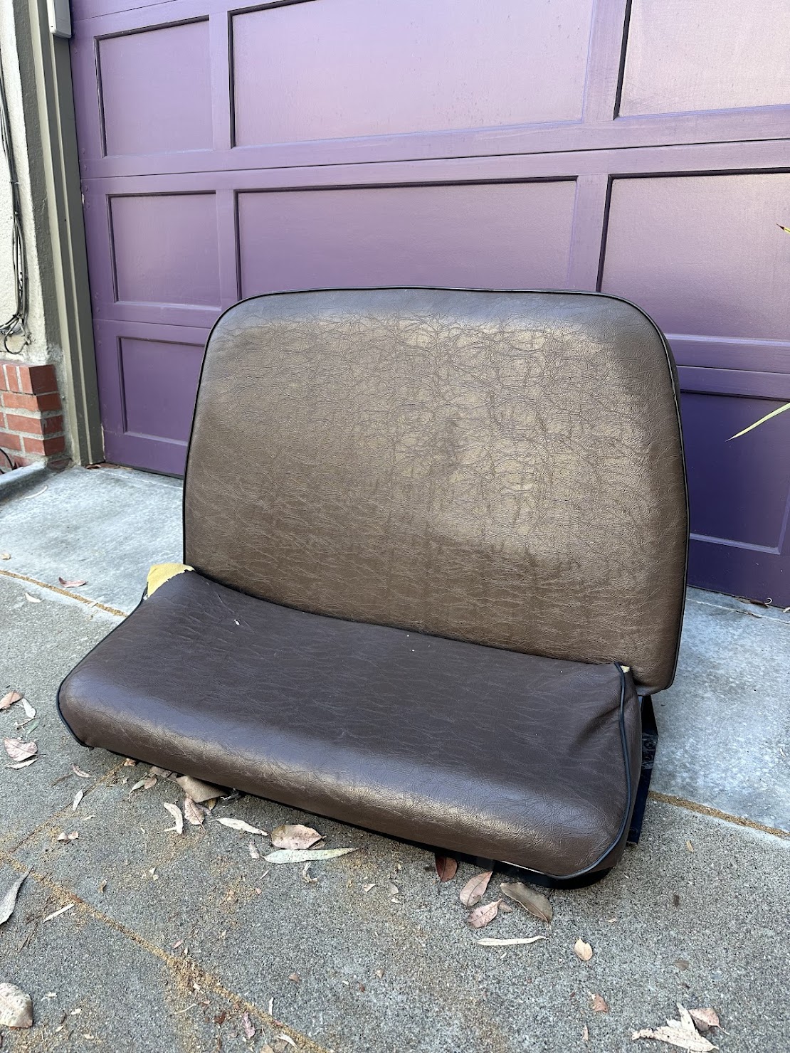

    I have nothing bad to say about the old car (bus) chair. That said, I don't have the space for it. If you're local and you need it for your build, please let me know.
    Mocking things up with the new setup. Note that the steering column has been added to the equation.

    So, the question is, how do you make this seat work with the stock seat riser? I looked at it, sat in it, folded it up, folded it back, and finally devised a plan. It's pretty simple. First, I bought some 1x2 tubing from Bay Metals in Bayview.

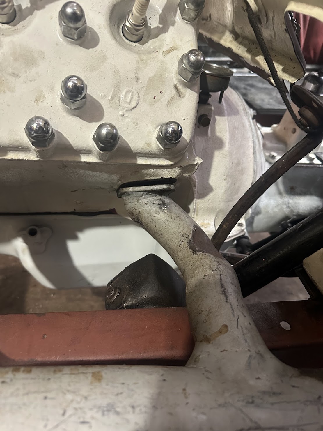

    Got some better photos of what remains of the steering shaft in the wheel?
    41 GMC K-18 and J.Ukrop like this.
  25. RodStRace
    Joined: Dec 7, 2007
    Posts: 8,872
    RodStRace
    The hub of the wheel should be strong. A press could make light work of it.
    Is the nut still in place? Are the splines in decent shape?
    A steering wheel puller is also a typical tool for this. Borrow from a store.
    I'd avoid heat if possible.
    J.Ukrop, Nobey and Tim like this.

    ^ that was my initial thought as well. Take the nut off and use a puller or press to remove the shaft out the back
    J.Ukrop and Nobey like this.

    just use a regular steering wheel puller...you might need that shaft nub later

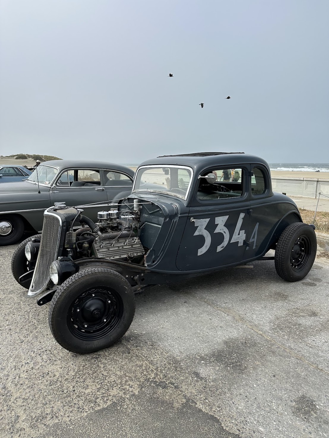

    That looks like a Cad flathead in that 33 coupe.
    J.Ukrop and Outback like this.

    I agree, IF he has access to one. He's shown a press at his friend's place. Also he is pals with 947 works, who should have a press but may not have a steering wheel puller since he does bikes.
    A big vice and 2 well chosen sockets will do it too. Just needs a 'pop', unless there is more to the story.

    I like to put the nut back on a few threads before using the puller so that when it breaks loose, the wheel (or me) doesn't go flying.
