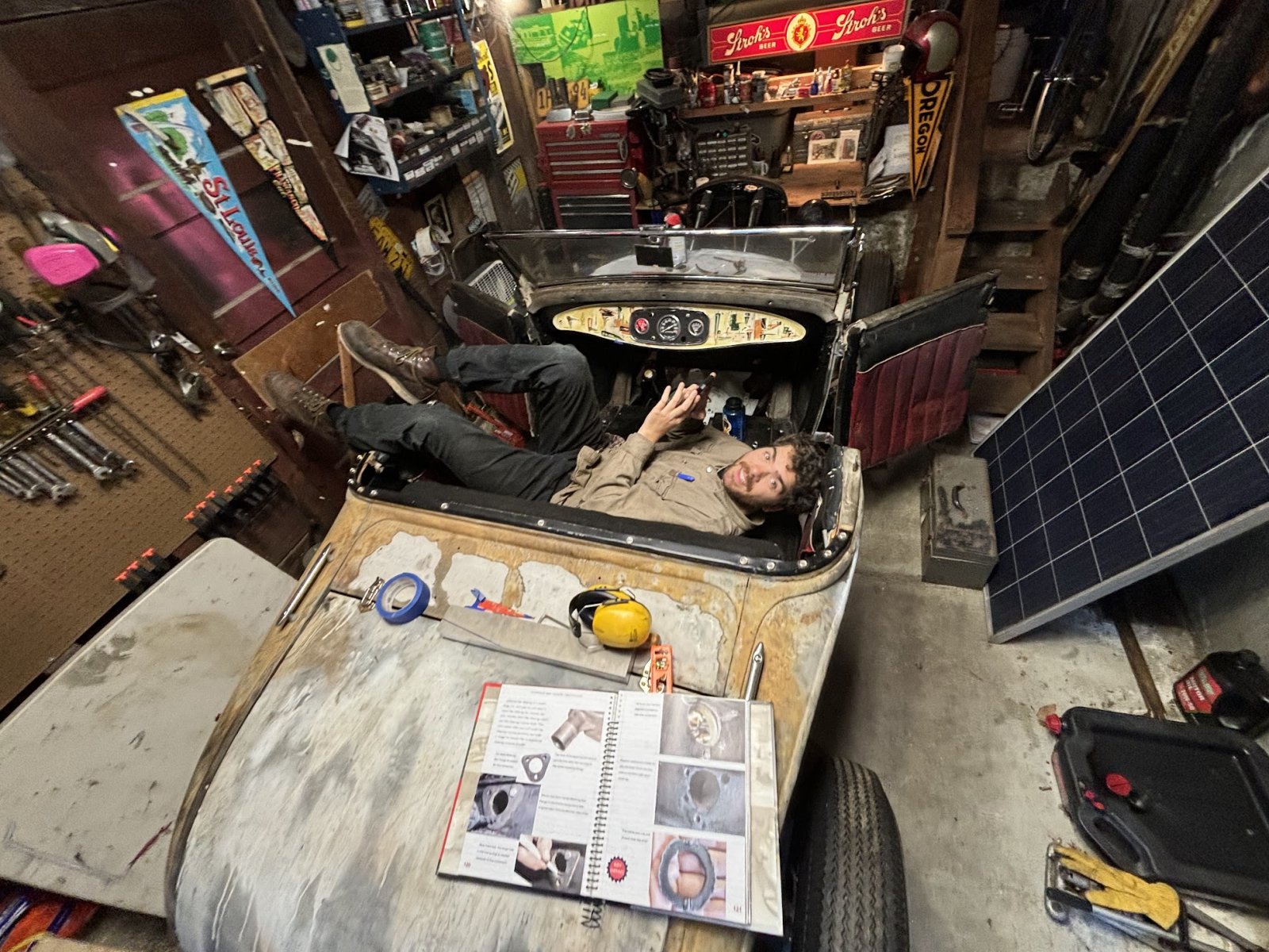

    Replies to come, but here's a super quick update before it's time for bed.
    This first one will make more sense later this week.

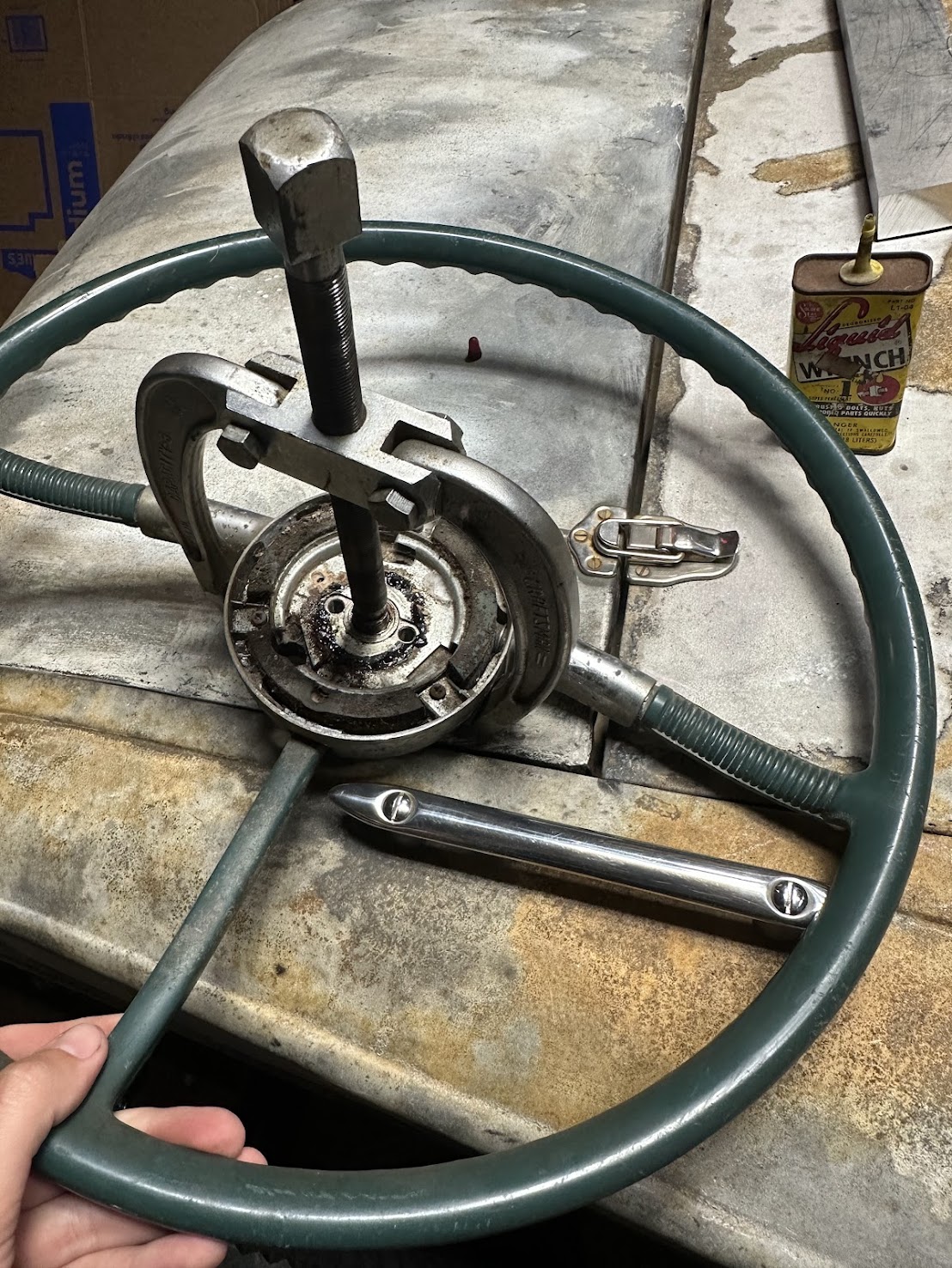

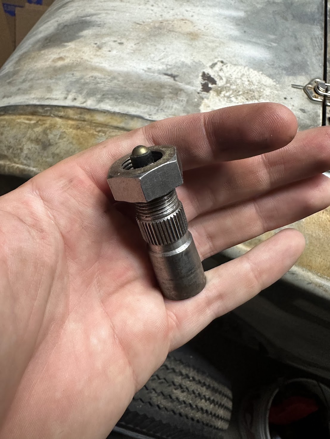

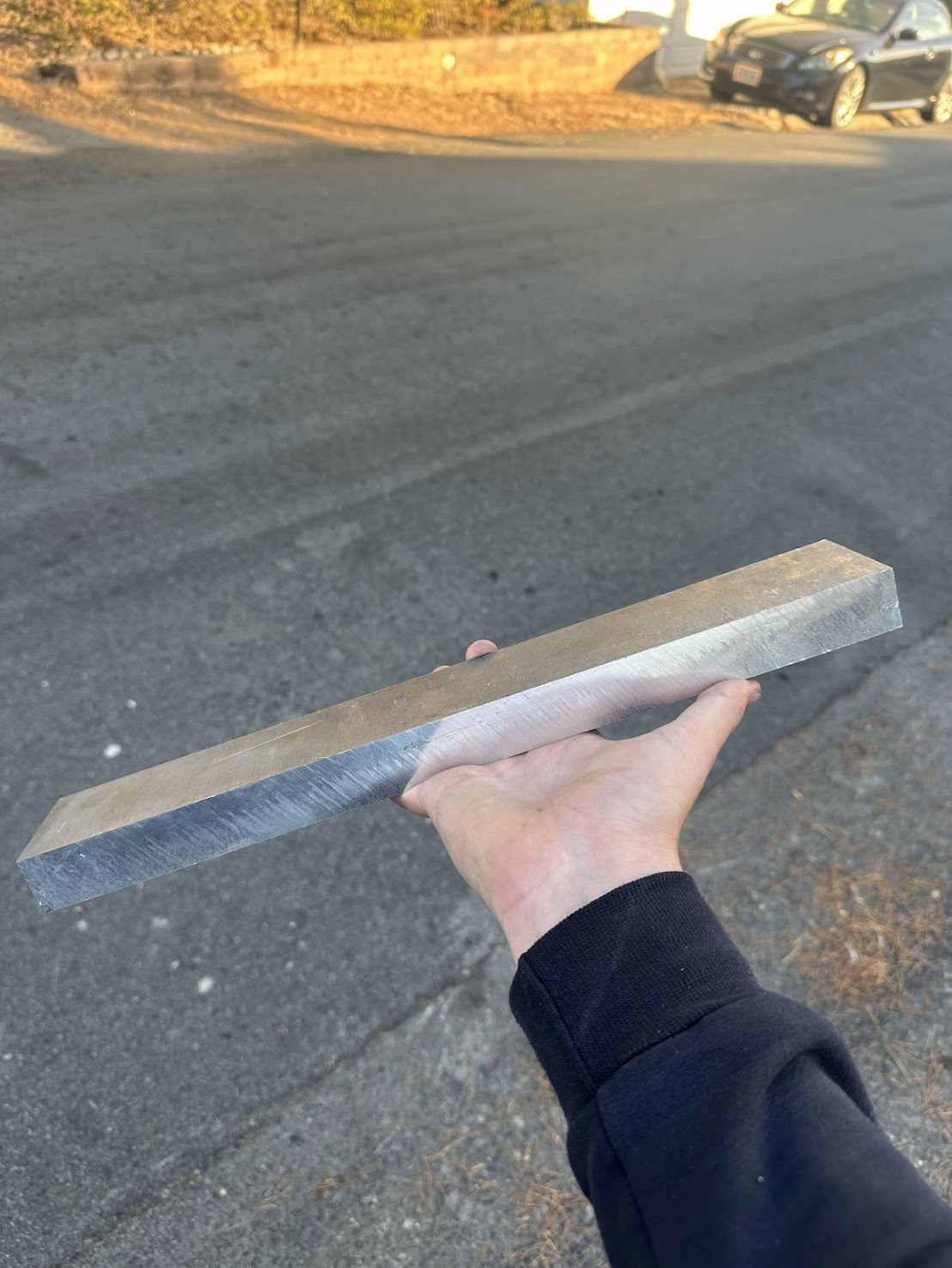

    Upon returning from my trip to the South Bay to buy that fine piece of aluminum, I went straight to the garage to try my hand at separating the wheel from the steering shaft. First, I called upon my tired Craftsman two-jaw puller. Longtime readers may remember that I bought this to pull the fiber timing gear off the front of my 'banger. Attentive longtime readers will remember that it didn't work at all. This time around, I gave it a shot but the threaded portion kept on slipping. To counter, I applied the only tool from my garage with a 100% success rate: Liquid Wrench #1 (check DicE issue 100 where I said the same thing in print).
    After letting it sit for a few minutes, I figured I'd try something that I knew was destined not to work. I pulled out my ball peen hammer and tapped the stub. Nothing. "I'll just try one more hit," I said to myself. POP. The stub came loose and rolled out onto the floor. I couldn't believe it!
    One more item checked off the big list.

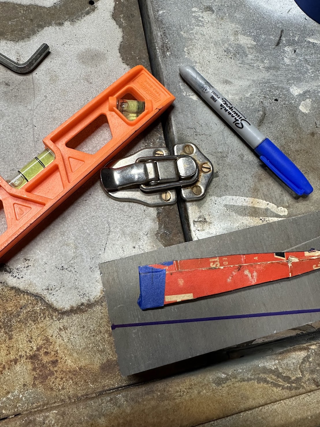

    Other than that, most of my time has been spent figuring out steering things. I've been doing some column drop R&D, but I want to share it when it's further along and I've made a clear decision. So, in the meantime, I present you with this snapshot of my decklid-turned-workspace. IMG_3875.jpg

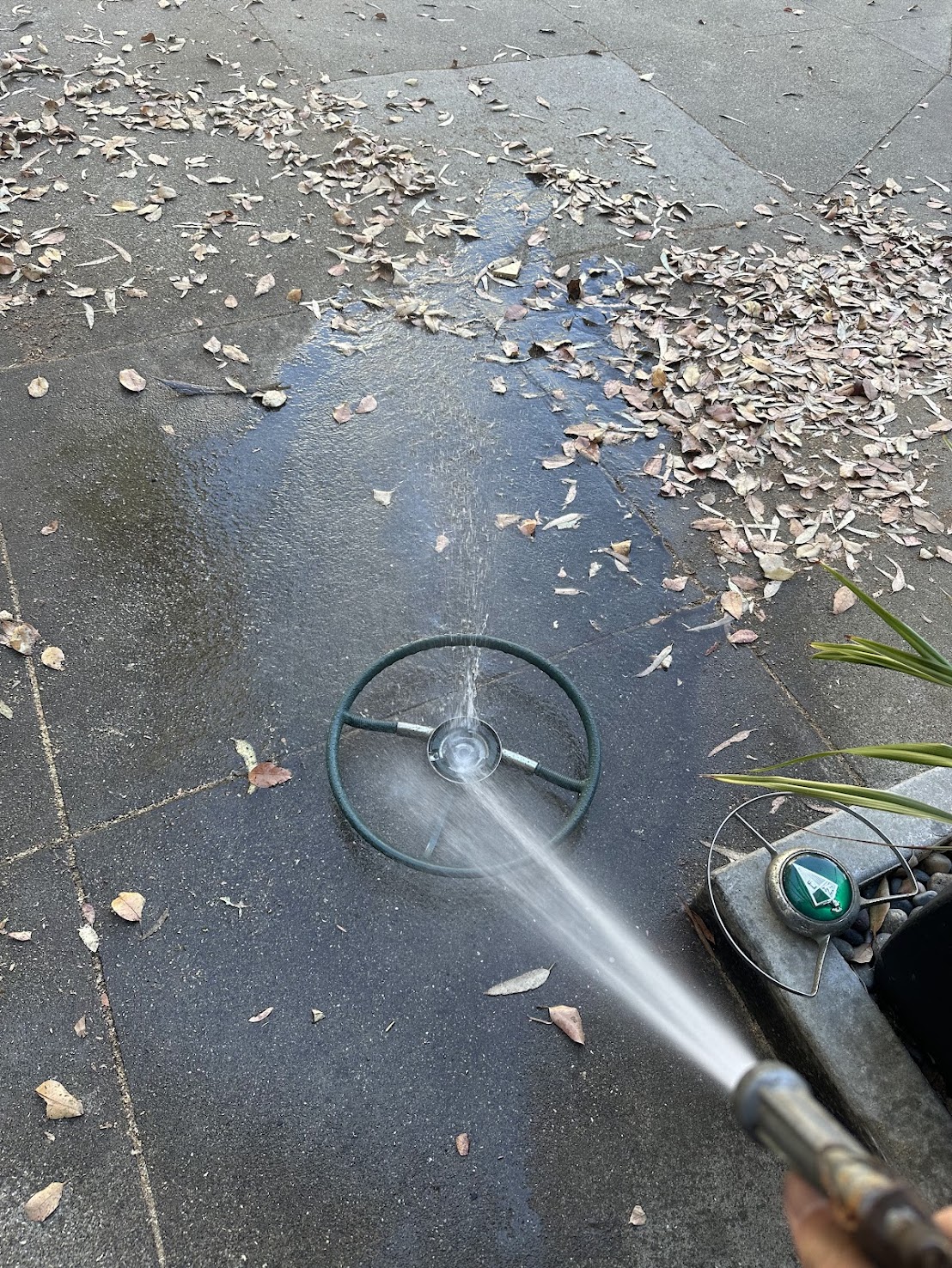

    Nice weather=steering wheel cleaning time. That old goo in there smelled awful!

    Isn't that 'POP' one of the best sounds you can hear!

    a hammer mechanic never fails with a well placed blow
    you are a hammer mechanic.....wheel done!

    Yup a hammer is absolutely my favorite tool followed closely by my favorite can of kroil lol.

    Agreed! That Kroil smell brings be back to my old garage. I used about a can of it to try to un-seize the old Triumph. No luck!

    When Kroil won’t do the trick try a 50/50 mix of acetone and ATF.
