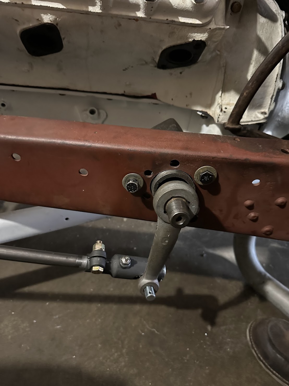

    I then proceeded to mock everything up. Does anyone have a F-1 steering box nut and lock washer either in chrome or in nice condition? I'm on the market for one, but figured I'd ask here.
    With the hairpin steering arm flipped, the whole setup looks like it's going to work great. Very exciting stuff. As you read this, the primer on the steering arm is drying. Next up, white paint!

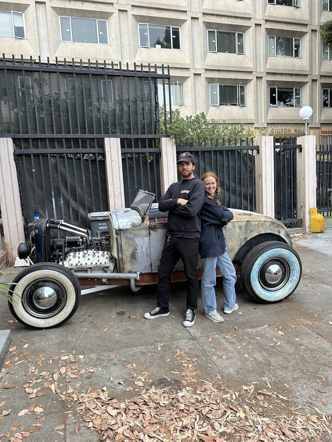

  3. ZerroHalfcup
    Joined: Dec 6, 2022
    Posts: 105
    ZerroHalfcup
    Your friend Yama did good on those photos, that's way too cool.

    Yesterday, I finished up the paint on the steering arm. One day I may make a plate for it to make it a little more custom, but this will do for now. And don't worry, I'll fix that metric bold on the tie rod! IMG_4229.jpg

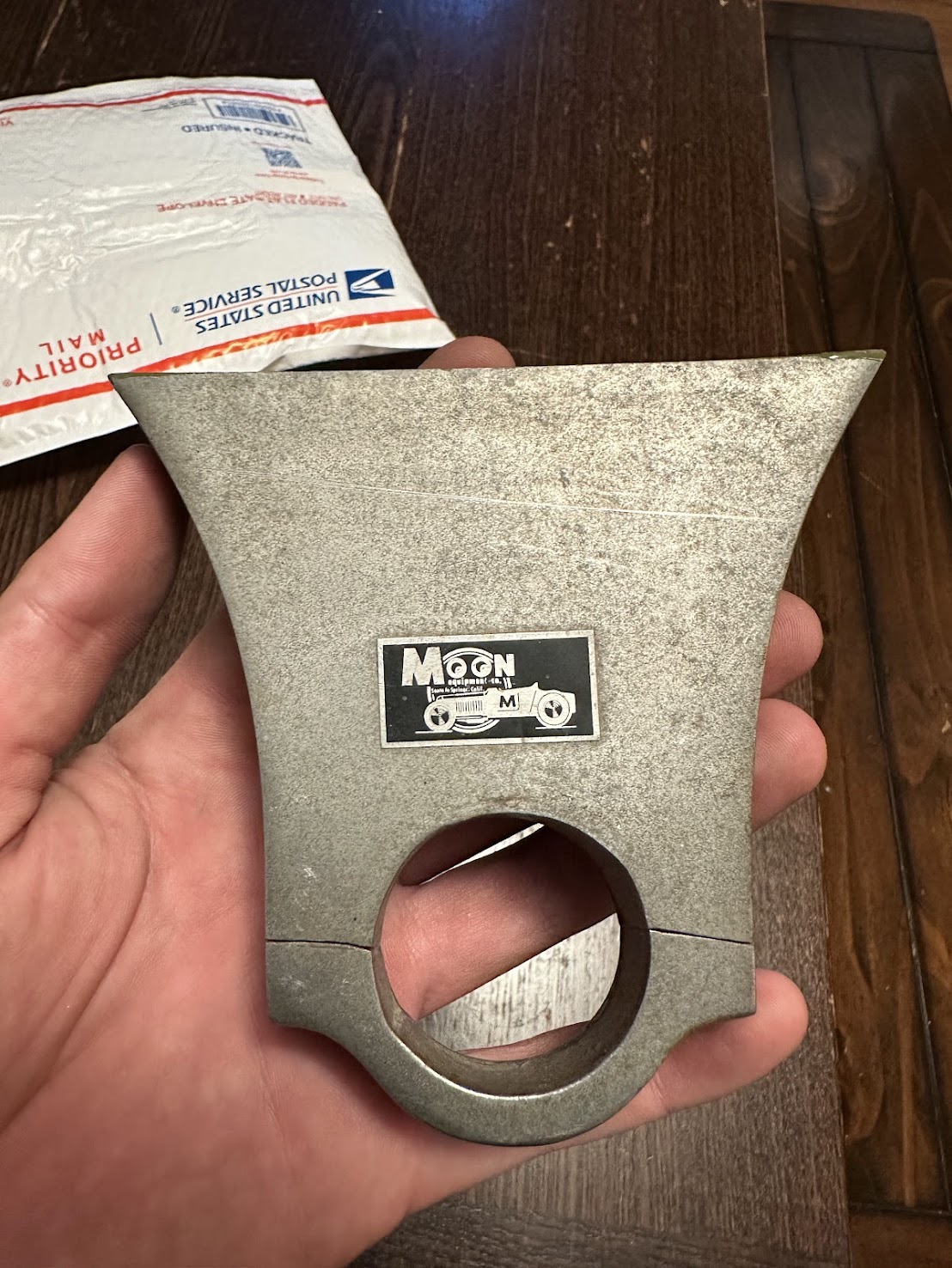

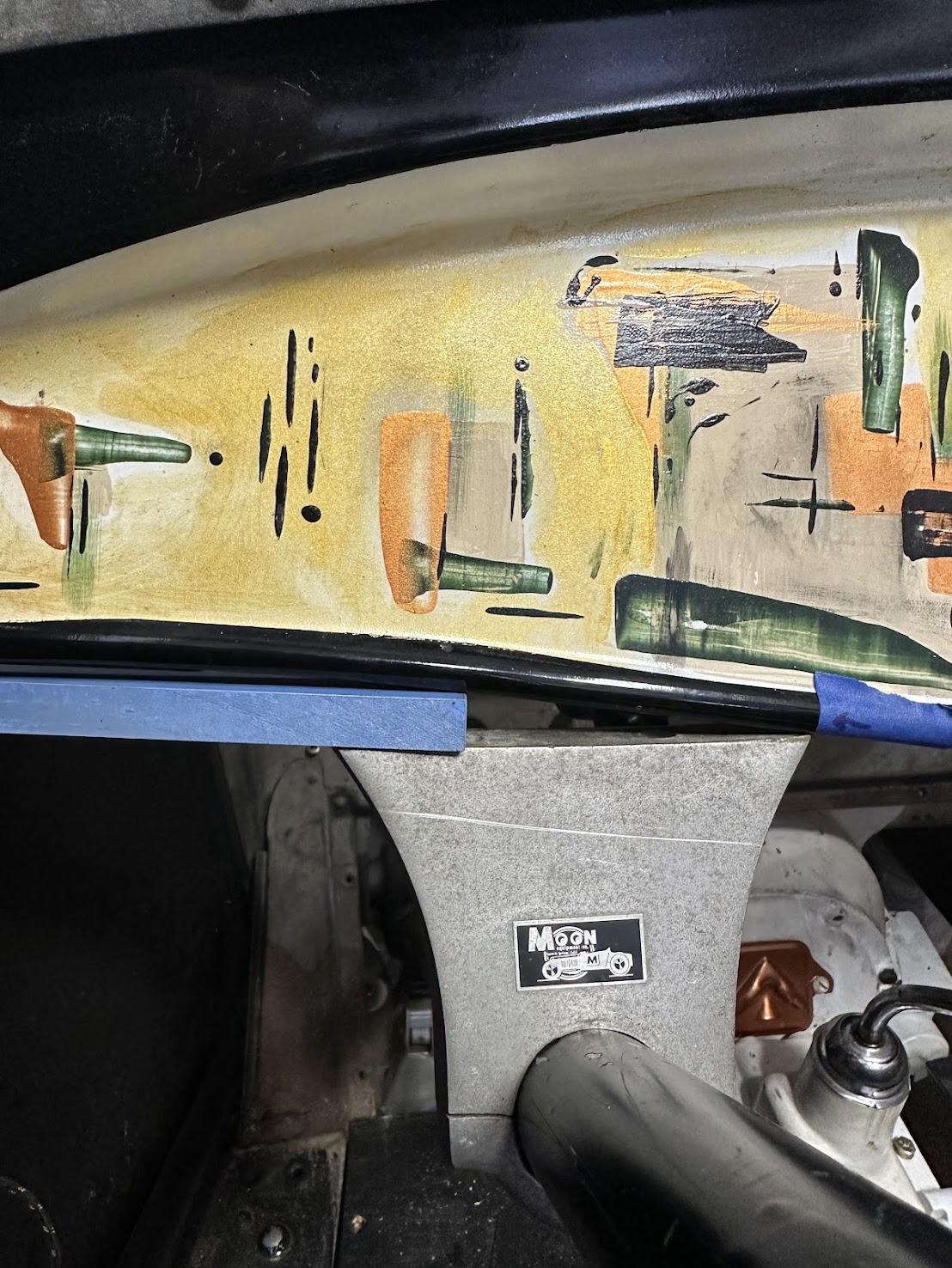

    Sidebar 480: Dropping In
    Moon, and others, made column drops specifically for 1932 Ford dashboards. Mine, however, wasn't one of them. I thought about solutions for awhile. Then, yesterday morning, I came up with the simplest one that I decided to try.
    First, I popped off the cowl top and bolted the dash in place.
    Then, I took my little block of aluminum and misted it blue so I could scribe it.
    Here's how the drop sat. See how it's ****ed to the left? IMG_4340.jpg My plan? Make an aluminum wedge to fill the space. Then I would distress it to match.
    CAD (Cardboard Aided Design) time.
    Stogy, Tim, Six Ball and 6 others like this.

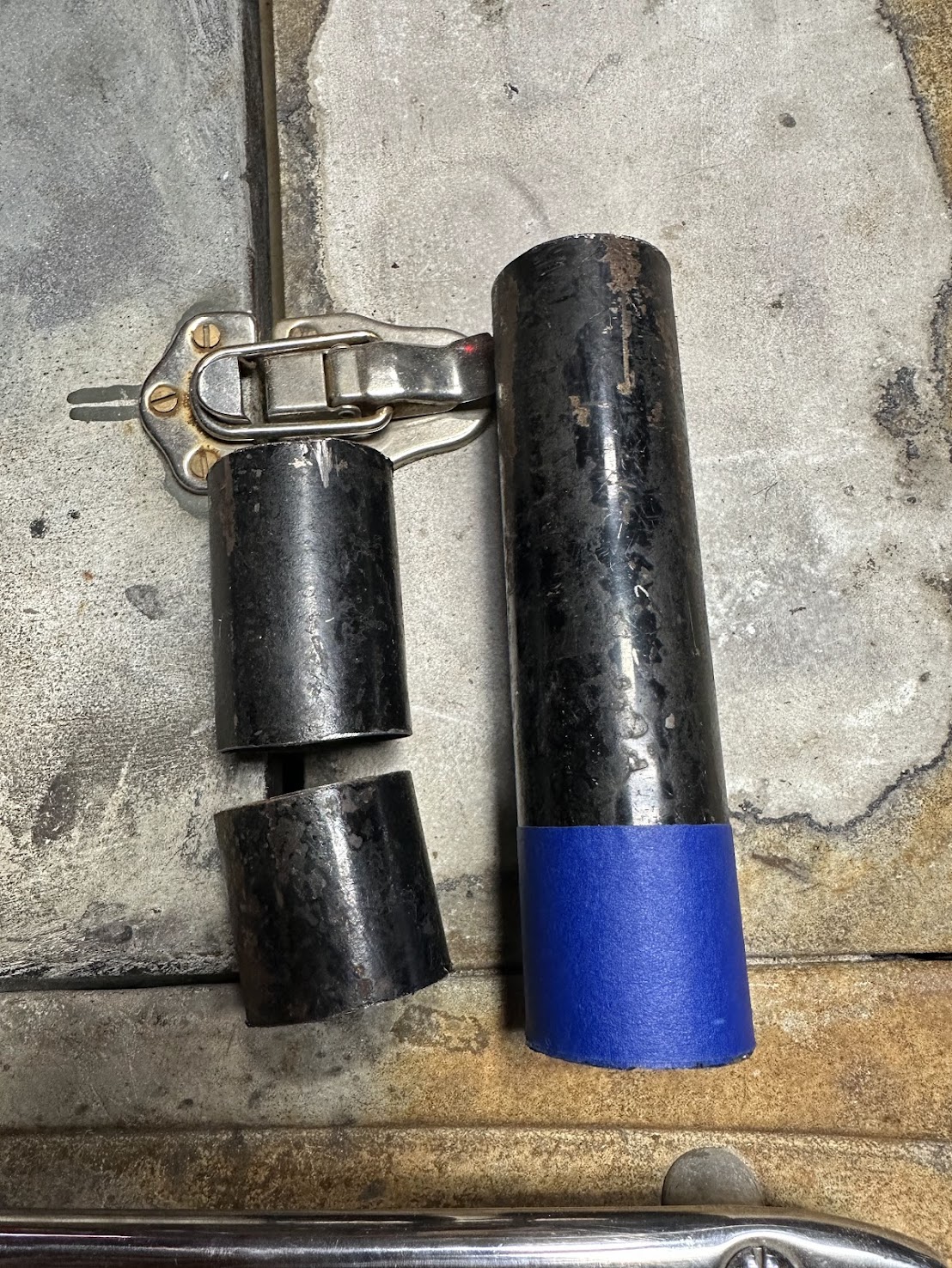

    Then, as I was messing with the column, one of my clamps slipped, sending the drop behind the dash. "Hey, wait a second," I said, lifting the column. "That looks great!" IMG_4361-1.jpg
    I thought back to photos from Deuce and Andy Southard's Hot Rods of the 1950s, and I remembered that this was a common way to mount a column. And, strangely enough, this drop already had a score line that matched the lower contour of the dash rail.
    Now that I had the positioning right, it was time to shore everything up.
    Step 0: Cut steering column to length.
    Step 0.5: Make at least three cuts as you zero in on the most ergonomic position.
    Step 1: Make a steel column drop mounting plate. I cut staggered spacers for the dash-mount bolts using square tubing.
    Step 2: Take a walk through the city.
    Step 3: Laugh as you remember that this is a genuine LOON accessory. Textured paint adds to vintage appearance.
    Step 4: Trim upper washers and bolt it all together.

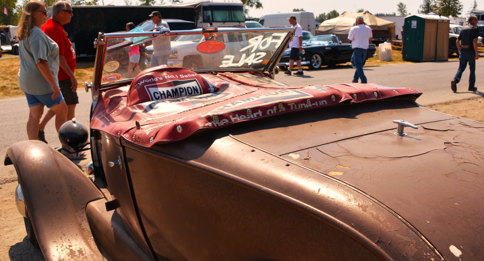

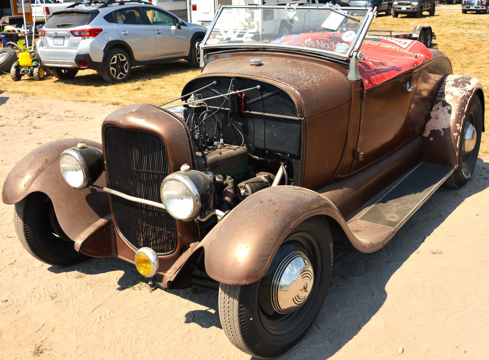

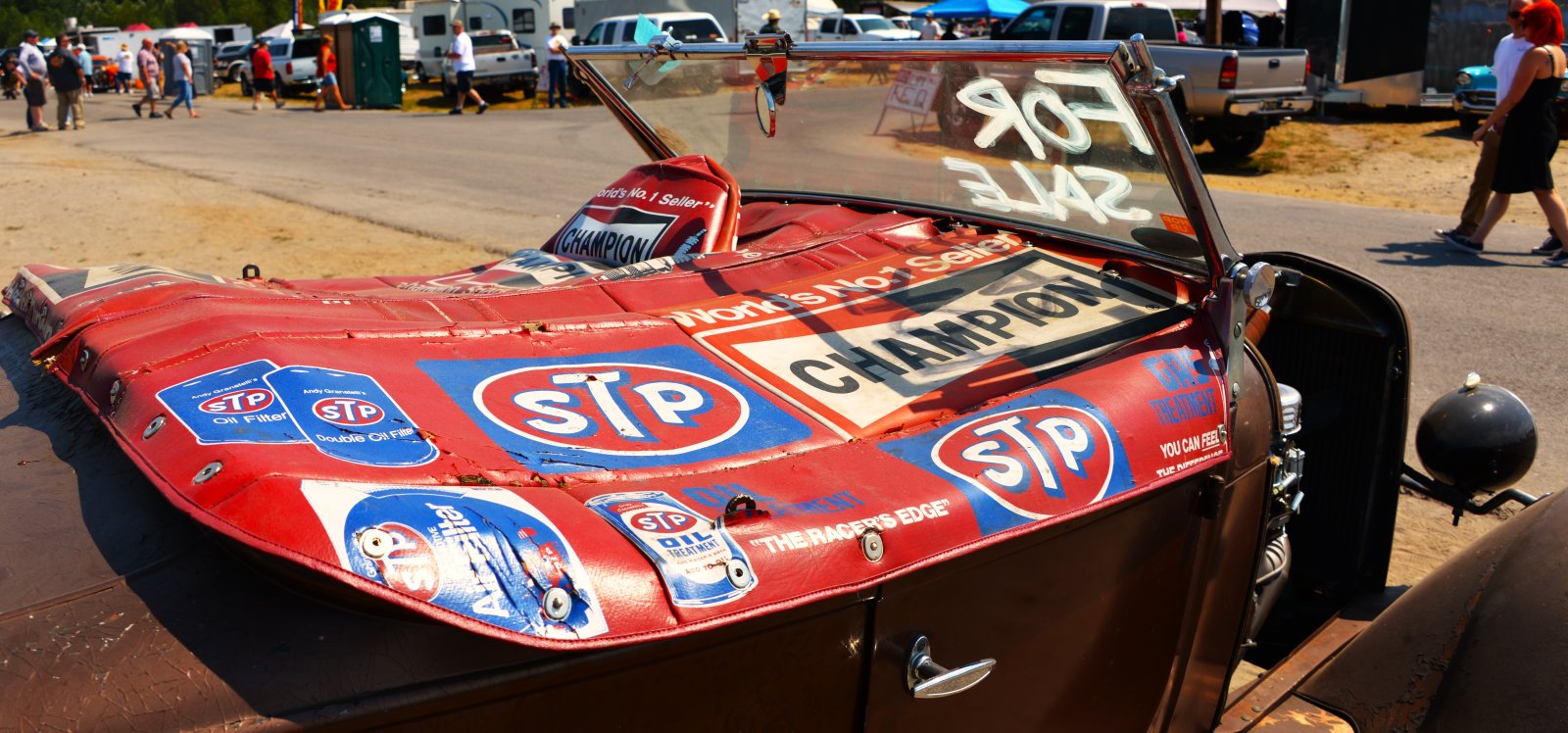

    Hey Joey, this is just a suggestion and nothing more. I was at this great kick *** gathering down at "TMP" Toutle Motorsports Park this past Saturday.
    I saw this very cool, unique
    "TONNEAU" "COVER" made out of Champion Spark plug, and STP fender covers. I thought it was pretty cool.
    Something to think about in the future, maybe one made out of "BARDAHL" fender covers or some other cool vintage product line, that suits the over all theme of your cool 2.0 roadster.

    Wow! That is wild. I'm planning to do a tonneau down the line, but with all the busyness happening on the car, I think I'm going to stick with plain white. But you never know...
