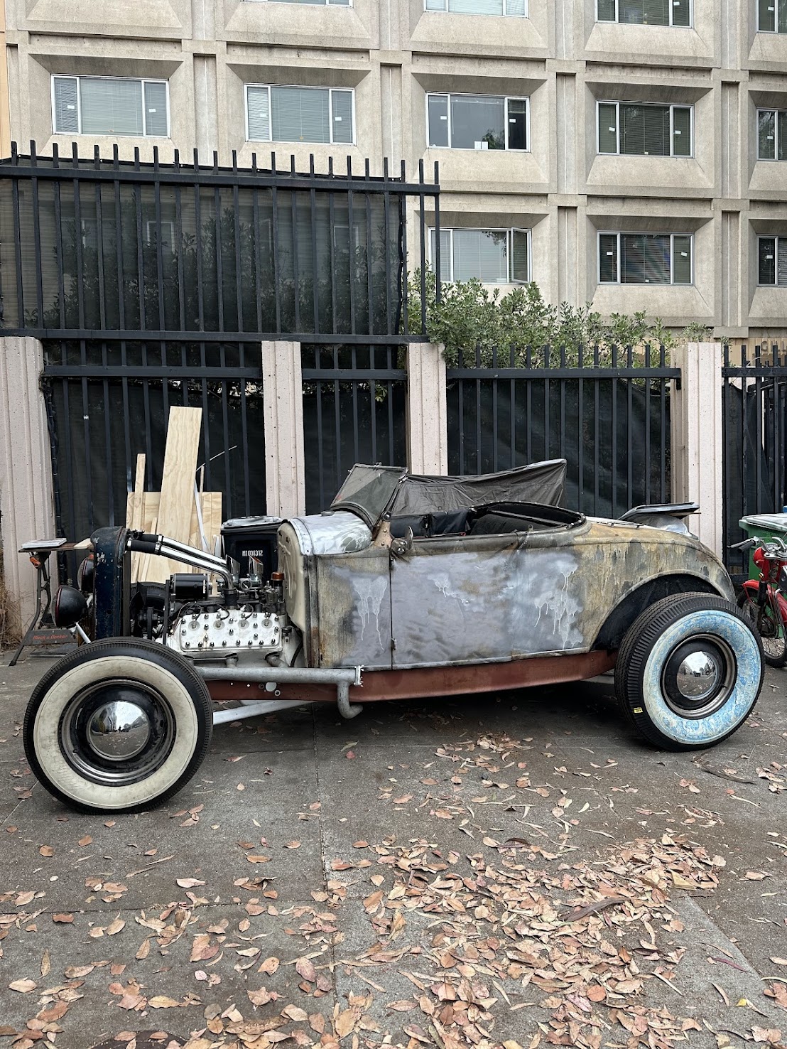

  2. Eisenmann
    Joined: Feb 3, 2018
    Posts: 77
    Eisenmann

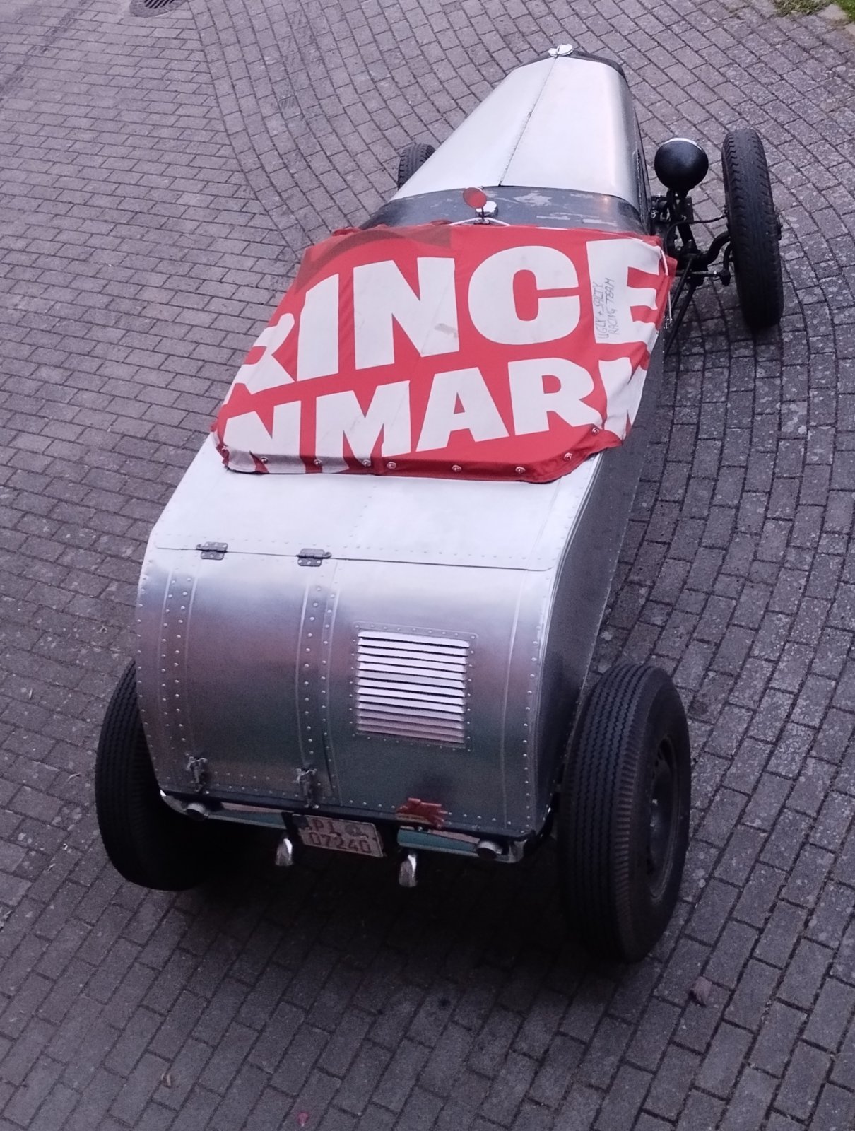

    IMG_20240730_170013.jpg cool car Joey . Made my Cover of an old sunshade from a Bar.
  3. J.Ukrop
    Joined: Nov 10, 2008
    Posts: 3,664
    J.Ukrop
    SUPER MODERATOR
    Very cool. Works great with the baremetal.
    Stogy, winduptoy and 41 GMC K-18 like this.

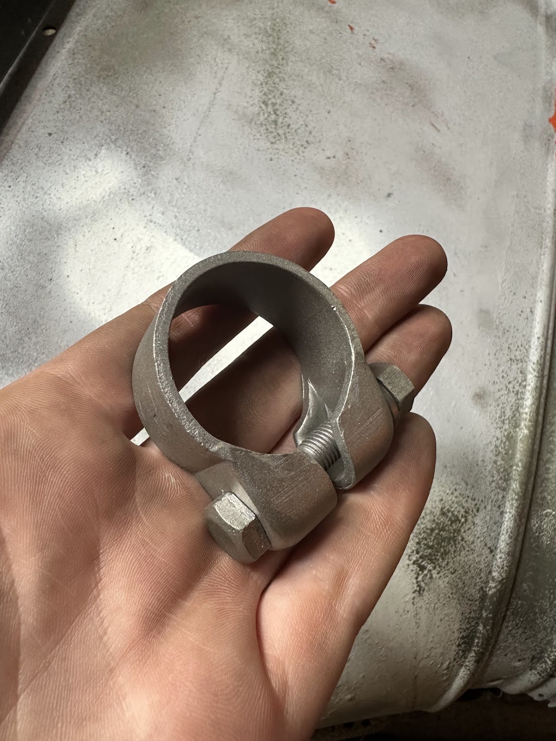

    Last but not least, we have the steering column clamp, sandblasted and ready to go. IMG_4590.jpg
    Black paint happening tomorrow, as well as other updates.
