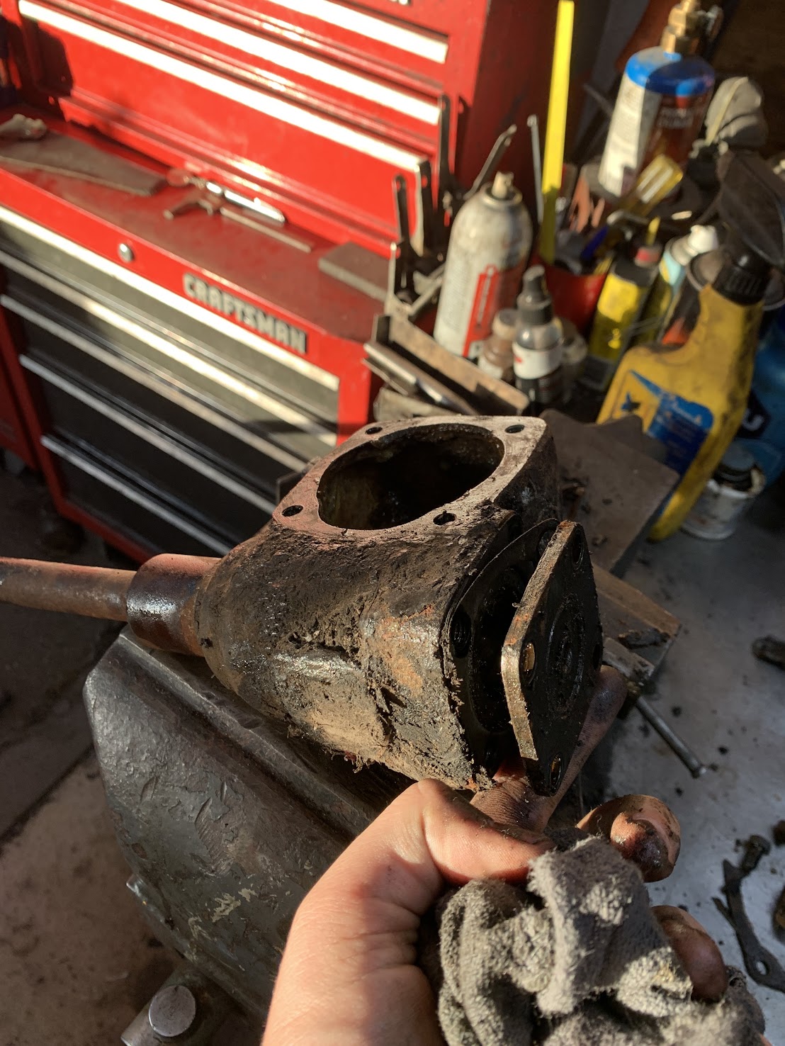

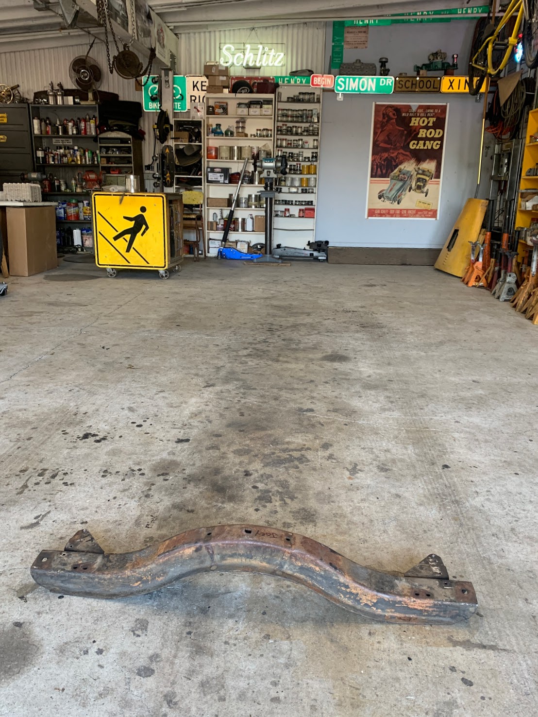

    I'm currently waiting on the box tubing to finish the gas tank mounting. With any luck, it should be here by the weekend. In the meantime, I turned my attention to the steering box.
    Longtime readers will remember that I started with a complete box that just needed a little bit of TLC. IMG_4666.jpg
    There was one area on the gasket mating surface that required some work, but I got things tuned up with some metal-to-metal.
    All threads have been checked and cleaned too.

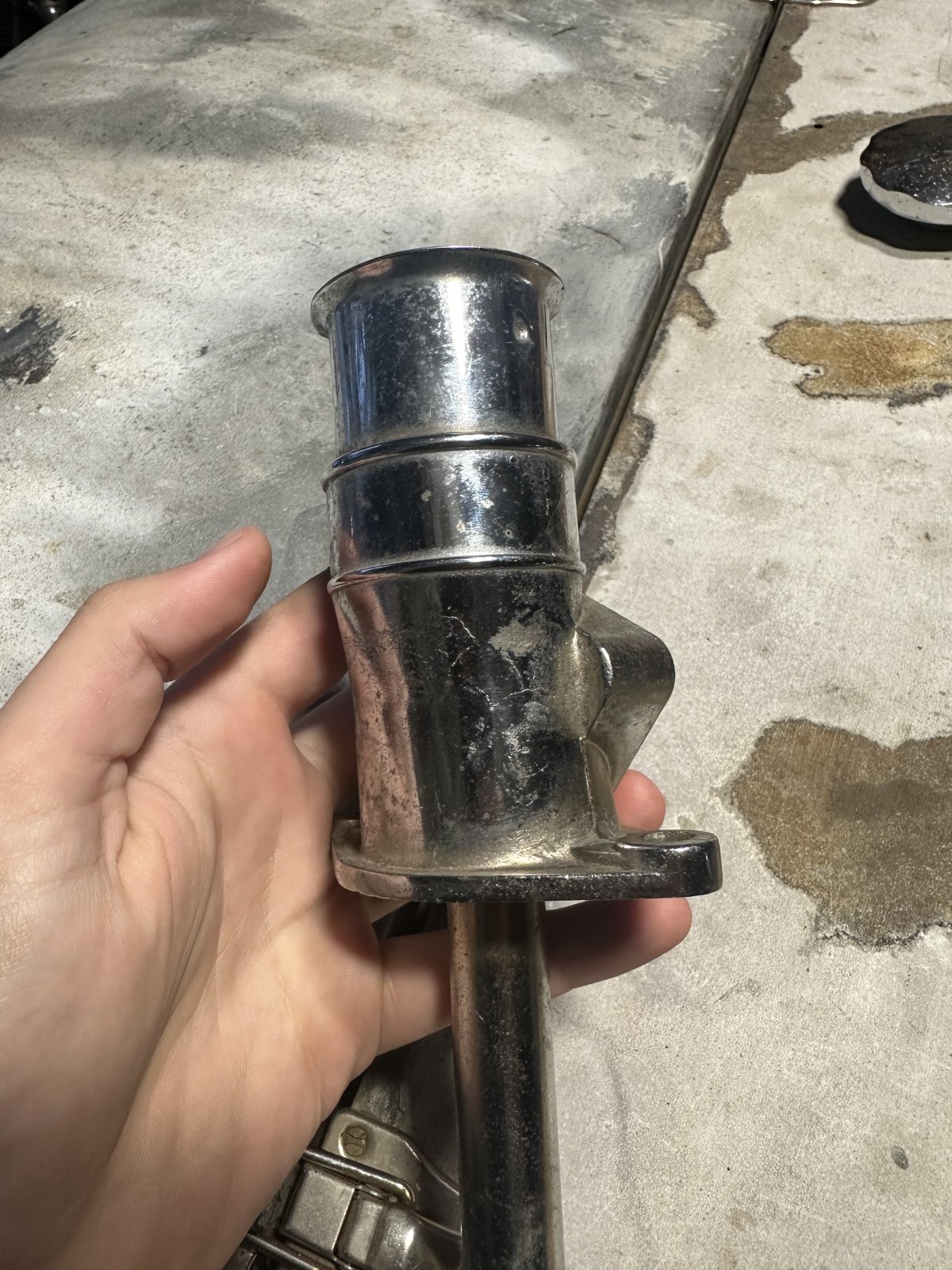

    I then robbed hardware from Version 1.5's e-brake setup, which treated me well through the years. Check out the very old chrome on the handle on the left.

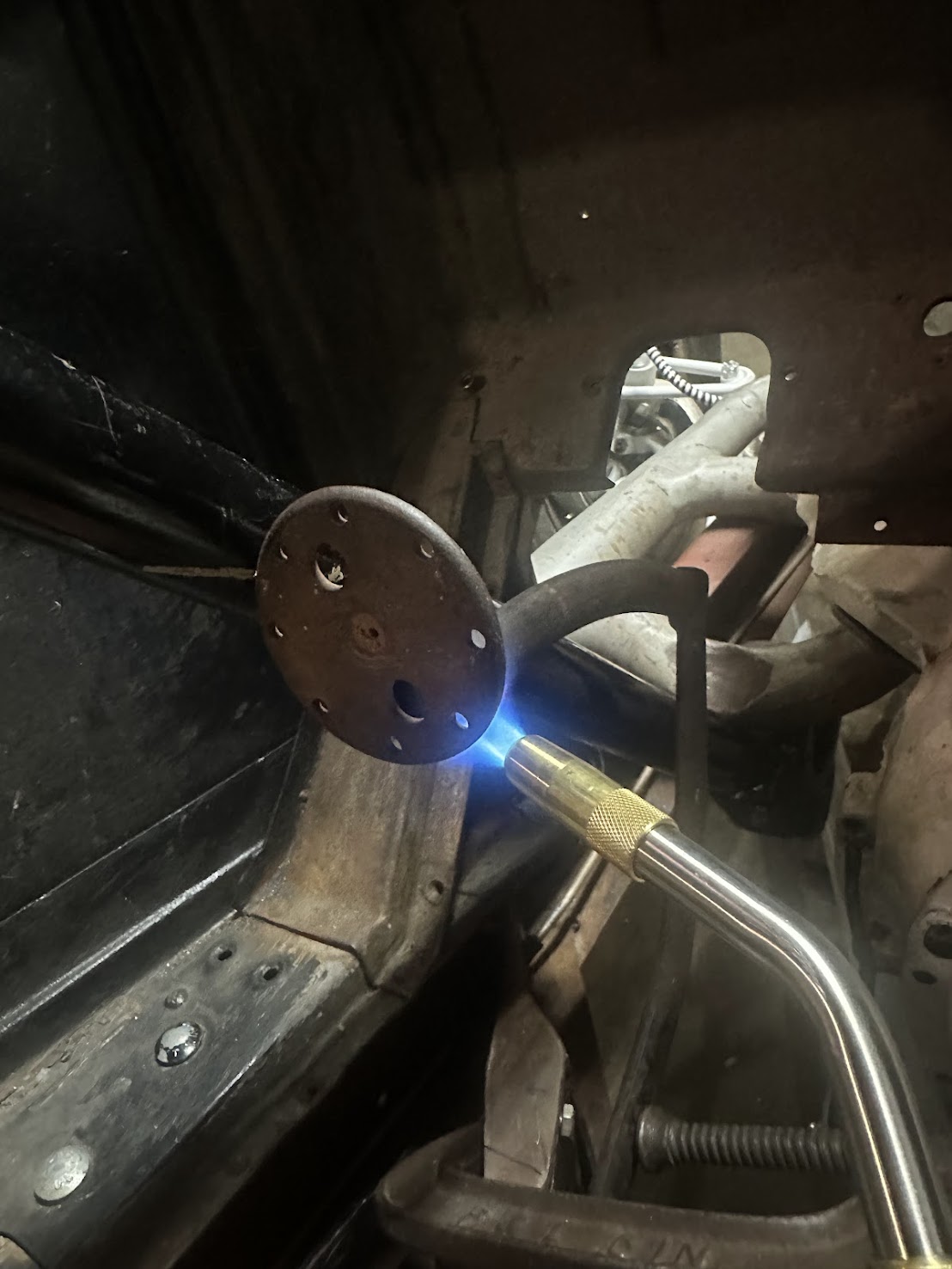

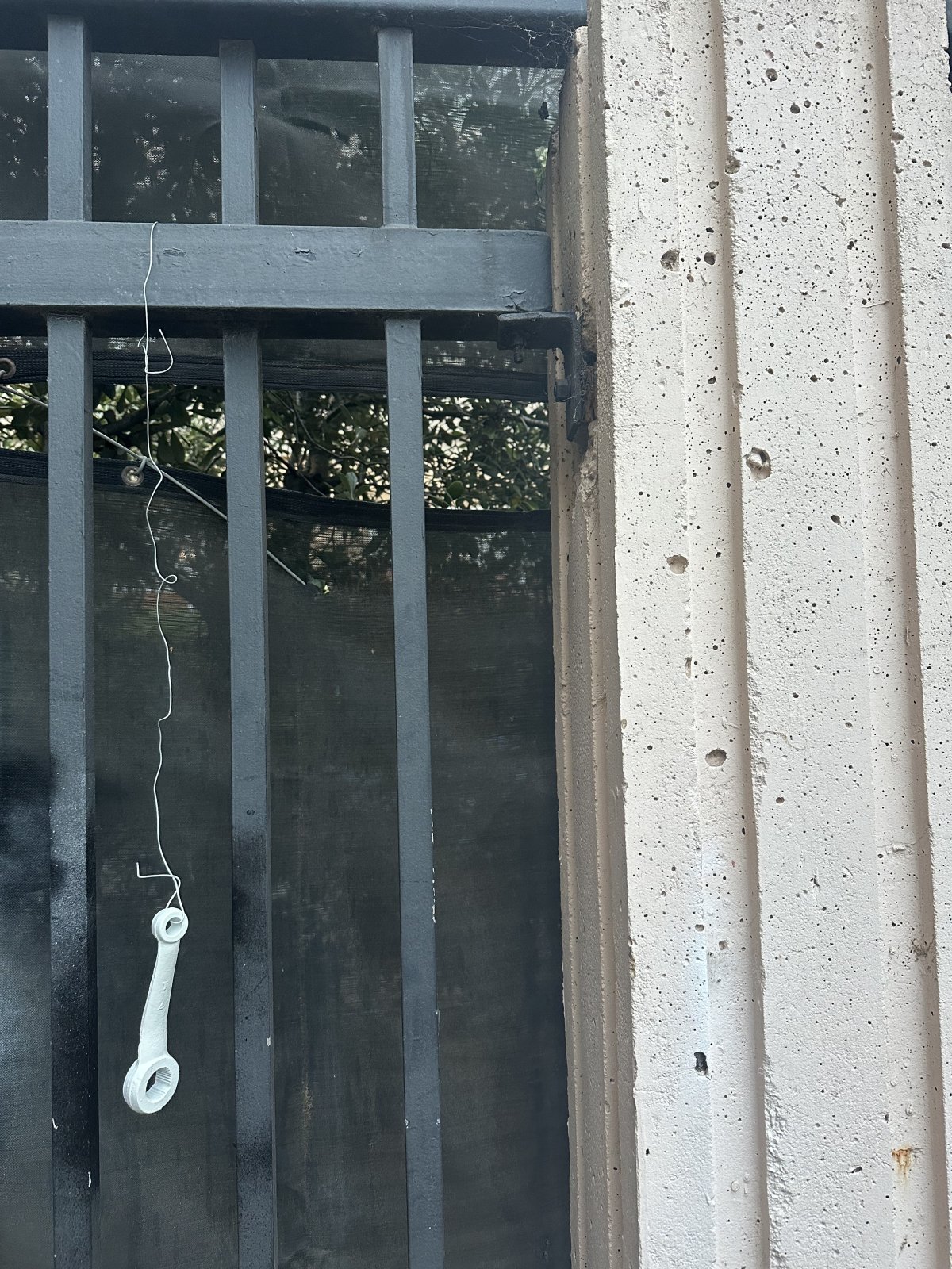

    As I was working on the steering on Saturday, I was talking to Justin about bending the pedals. "You know," he said, "you can heat them with a MAP gas torch, although it might take a long time." That's how he did them on his car. I had originally planned to make metal mock-ups and then bring the pedals to Yama's to bend with oxy/acetylene. This seemed like a simpler solution. So, $59.95 at ACE hardware later, I was in business.
    With the garage door wide open and my safety gl***es on, I flicked the torch to life. Pshhhhhhhhhhhhhhhhhhhhhhhhhhhh it huffed onto the pedals. I moved the flame around the zone I wanted to heat. Just as Justin had told me, it began getting hot very slowly. After what felt like 15 minutes, I started to see the cherry red. I grabbed my biggest wrench and began to bend. Nothing. More heat. Still nothing. I changed my clamp position and heated it longer than the last two times. Arghhhh. I groaned and the metal responded. It moved! I then applied the same heating technique to the top of the pedal to clear the column.
    It's hard to say for sure, but I think it worked? I applied plenty of heat and managed to unscrew the rusted pedal pad. Fun fact: you can use a Milwaukee angle grinder wrench to take these off.
    And here we have the finished product.

    Tonight, I revised my strategy on the clutch pedal. Rather than heating it in the car, I strung it up on a piece of wire and hung it from a nearby fence. As night fell, I wielded my torch, aiming the flame at the metal until it glowed cherry red (again).
    Donned in my grease-stained jumpsuit and SUMMIT wraparound sungl***es, I was pulling off one of my better looks. (Nobody approached me to ask why I was heating this strange piece of metal with a torch on a fence after dark.) Although this piece needed less persuasion, I heated it the same as the brake pedal. Much to my frustration, I couldn't get it to bend how I wanted it. As a matter of fact, I could hardly get it to bend at all. I gave it everything I had before it was time to call it quits for the night. Frustrating, but that's the reality of it.
    This is just another reminder that building these cars is tough. Being a first-time builder with limited tools adds to the challenge. Once I make my way over to Yama's, I'm sure things will go quickly with the O/A torch.
    The task reminded me of this scene from "One Flew Over the Cuckoo's Nest," which I re-watched at the Roxie Theater in the Mission on Saturday.
    Building hot rods is all about being someone who tries. Sometimes it works, sometimes it doesn't. Either way, we learn something.

    I bet it not being bolted to the car drastically reduced the amount of muscle you could put into it to get the bend.
    progress is progress though, and at this point even the children who have a view of your work in the driveway probably just muse “there’s hot rod Joey!”

    I bent my headlight stands with a Propane Torch like you're doing and it did take forever, but it got done.

  30. Propane torch for heating and bending, Hank Hill approved.
