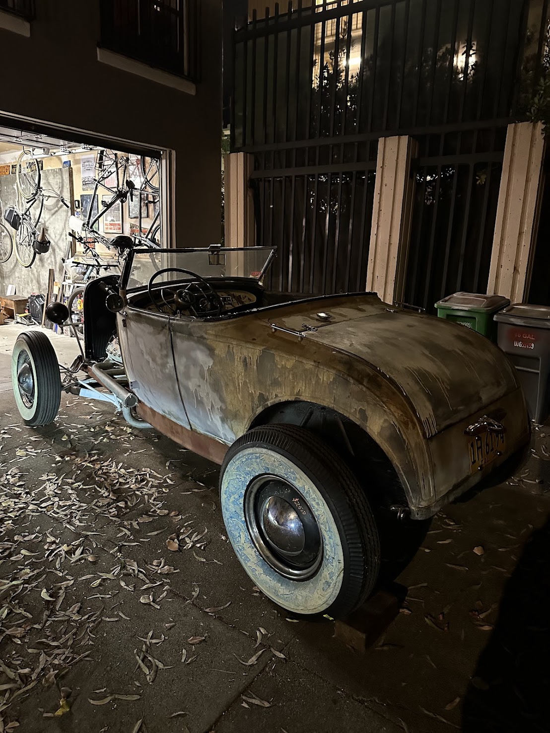

    Joey, this image needs to be in a magazine or on a calendar!( imho) Great progress by the way. I always enjoy checking on your build progress. Your youthful enthusiasm for this project and this hobby is always a breath of fresh air and an inspiration to this old geezer.

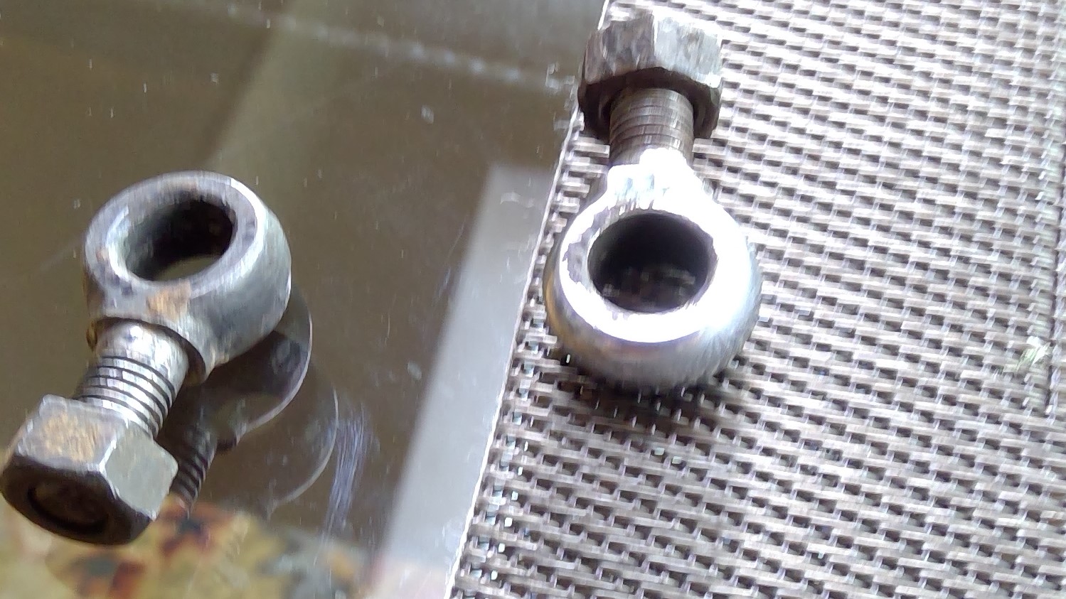

    I’m on the 5 bus barreling towards work and I’m thinking about my throttle pedal. I’ve seen folks set them up using two of these mounts, and that’s the route I’d like to go. I’ve searched around for a place to buy just this mount, but haven’t had any luck. I’ll ask here: does anyone have a junk s**** pedal they’d be willing to sell? I just need it for parts. Any leads would be greatly appreciated!
  12. Oneball
    Joined: Jul 30, 2023
    Posts: 1,632
    Oneball
    Have you tried looking for an eye bolt the correct size?
    Six Ball, 41 GMC K-18 and warbird1 like this.
  13. Tim
    Joined: Mar 2, 2001
    Posts: 20,224
    Tim
    from KCMO
    That’s really all they are. If you want you could just buy a 46-8 section and then weld the s**** pad to the arm. That’s what I’m doing in the model A.
    that being said I’d think @Hitchhiker has some
    Six Ball and 41 GMC K-18 like this.
  14. Weedburner 40
    Joined: Jan 26, 2006
    Posts: 1,121
    Weedburner 40
    Check with FK Rod ends, they have rod ends that are not spherical, that are very similar to what you are looking for.

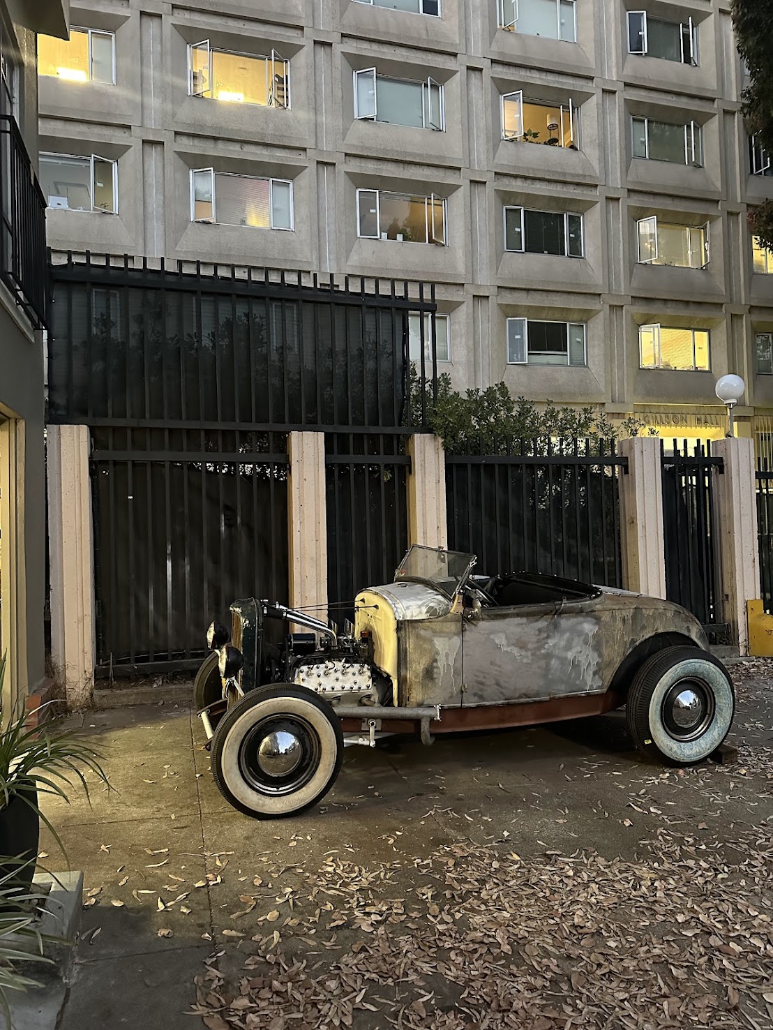

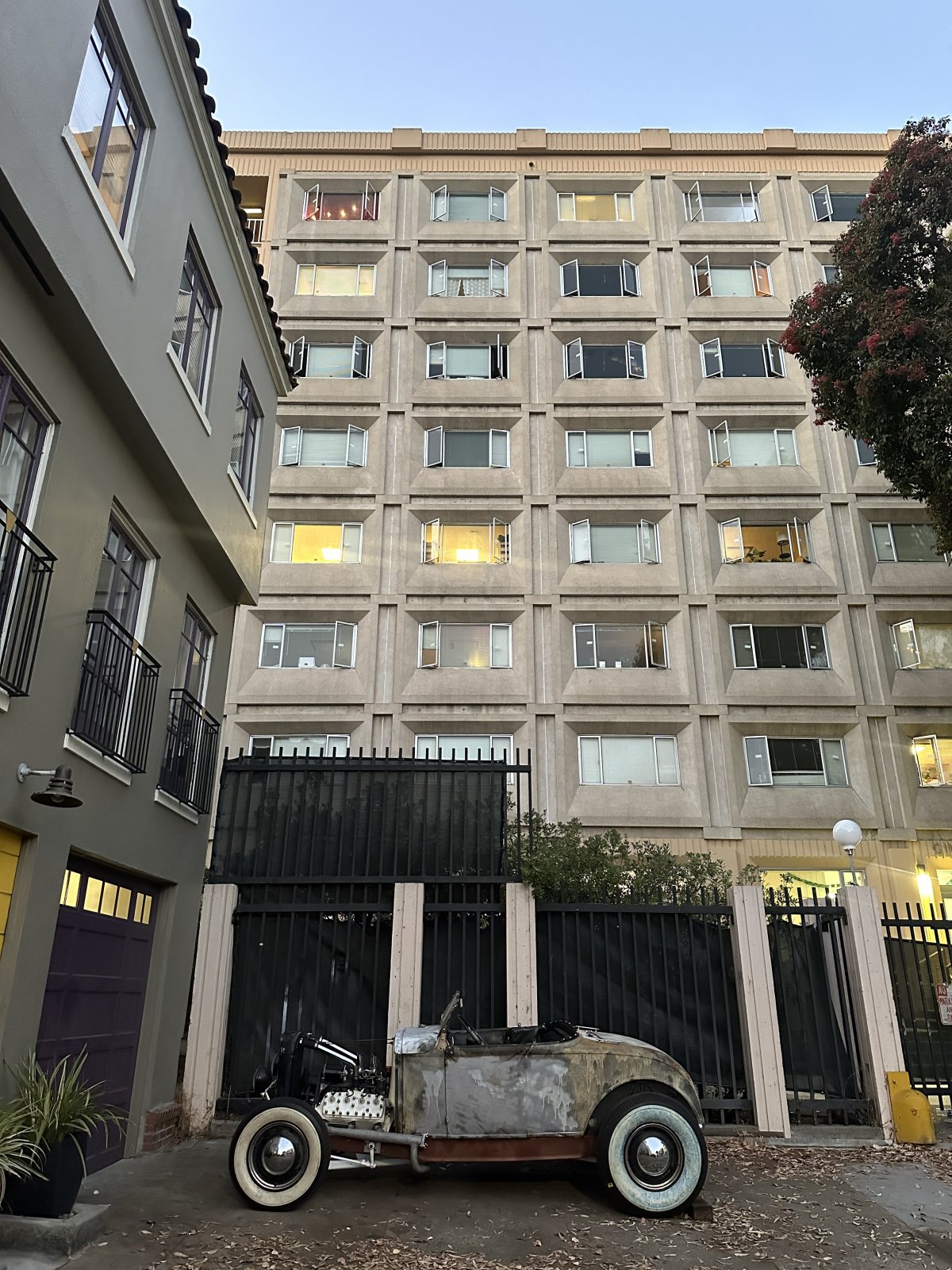

    Last night, I had a few tasks that I wanted to take care of. After work, I cleared my schedule, put on my coveralls, and made my way down to the garage. It was unusually warm on the terrace, and in the depths of my soul I could tell that it was going to be a good one.
    I could hear crickets in the bushes on the edge of campus, and the families across the street rolled in from their evening bike ride with smiles on their faces. I pushed the car out into the driveway, more complete than ever.
    And there it sat, basking in the warm glow of the garage lights. We've seen a lot of this car through the years, but never like this. Note the steering. The stance. The headlights. The headers. I had to take a step back and remind myself that this is what we've been working towards.
