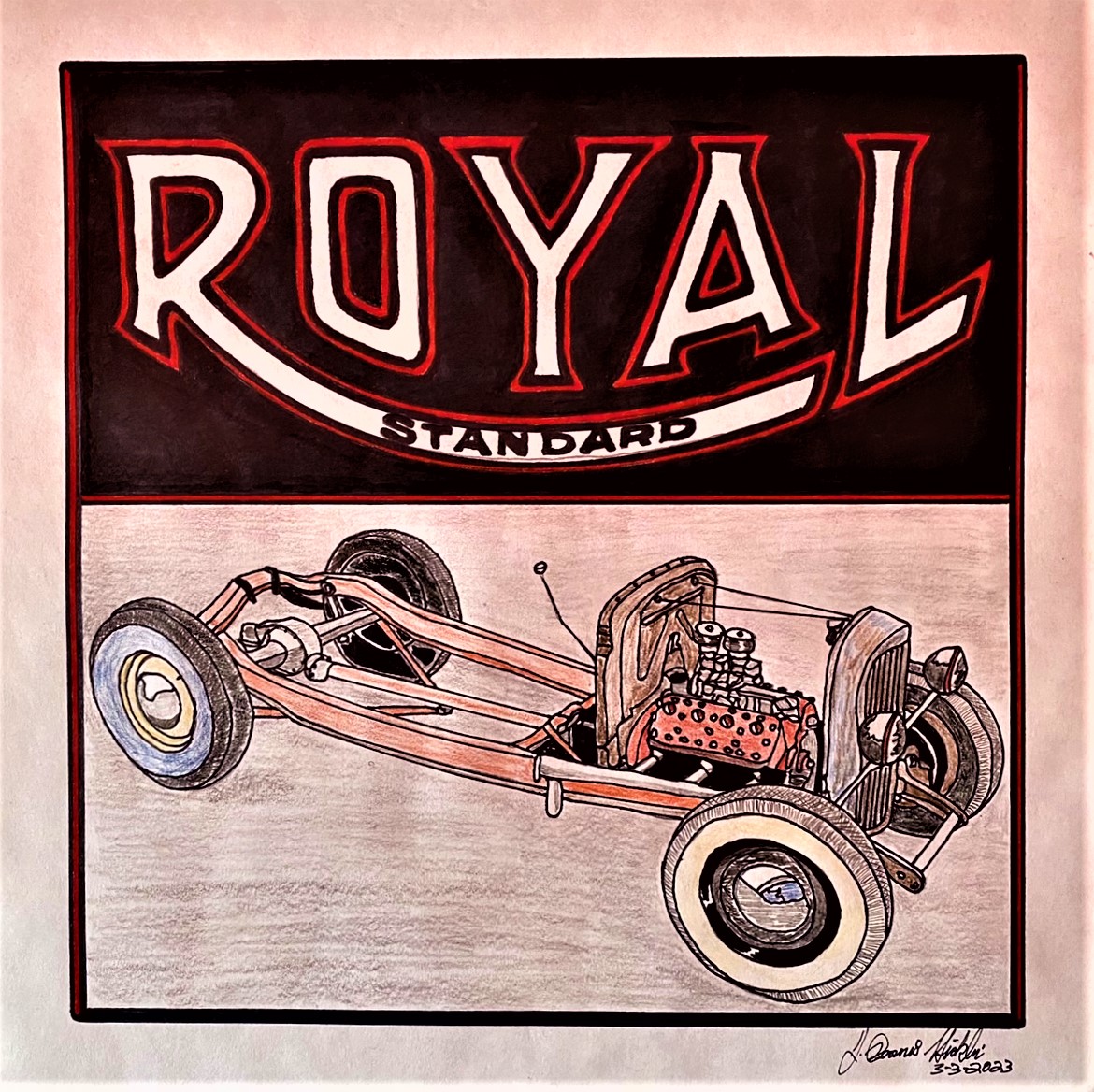

    Quite the dramatic metamorphosis, from the "ROYAL STANDARD" laminated place mat, to its current state of nearing perfection !

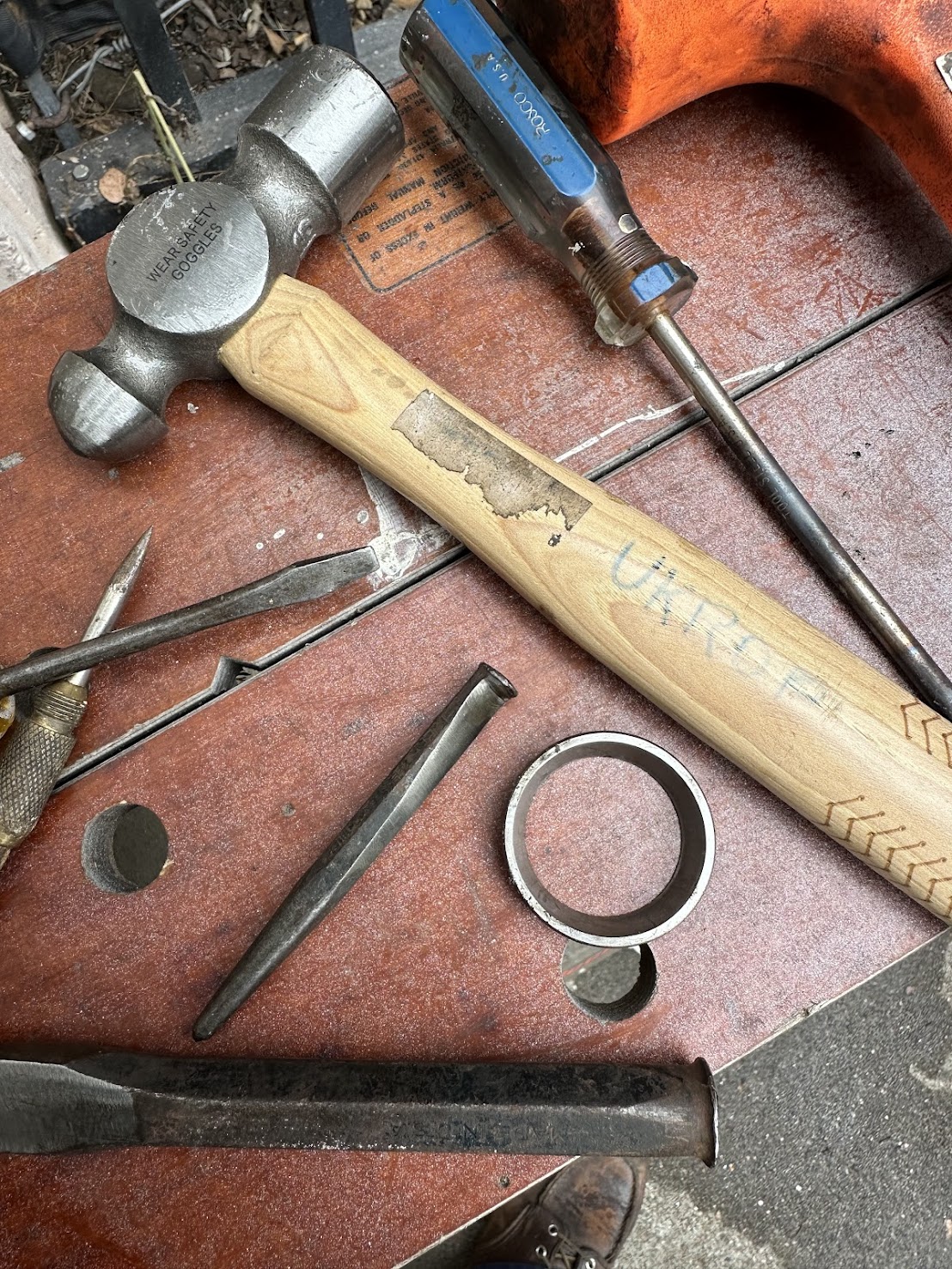

    On Saturday, I had big things planned. I started off the day by cleaning up the steering shaft and getting it ready to drop in the box. Next, I cleaned the box one final time and got ready for****embly. As I did, I realized that there was some pitting on the upper bearing race. IMG_4990.jpg
    I knew it wasn't going to work, and a quick conversation with David confirmed it. "Knock it out with a punch," he said. He suggested I find one with a foot on the end, because it's impossible to get at it with a straight punch. Well for the next hour I tried everything I could. I heated and bent an old screwdriver until it resembled a chopper kickstand, but that just bent more when I hit it. I then pulled out the only two punches in my*****nal. I ground down the smaller one to resemble a railroad spike. That seemed to do the trick. Many strategic hits later, the old race popped out. Success!
    Using a 23mm socket that also works for Triumph stem bolts, I tapped the new race into position.

    Fun fact the upper race on a 37-48 ford cross steer box is also pressed in place and hasn’t been available for purchase new for about 12 years.
    thankfully a lot of the Minnesota shops that have the market cornered on nos parts have them.
    anyhow more to your actual box I have these two tips.
    1: if possible the next time you have to drive one out it’s pretty common to tack weld a strap across the race and then hit that with your drift and hammer.
    2: make sure that seat for the race is VERY and I mean VERY smooth. I went through more races than I wanted to with my build and I lost at least one to a burn that was almost to small to catch my finger nail. Had it most the way in with the press and crack! Get to start over.
    I think the race that ultimately ended up in the box came from a donor box and I band sawed the top off it so I could plink the race out with a drift super easy.
    Anyhow good update! Your drawing closer!

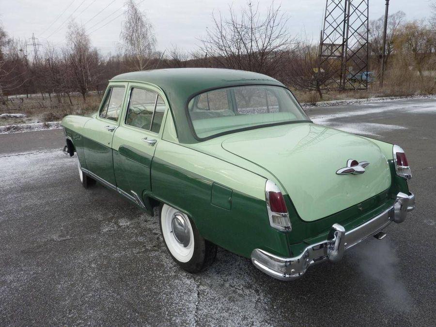

    It’s a mid-to-late '50s Gaz M21 Volga decklid light

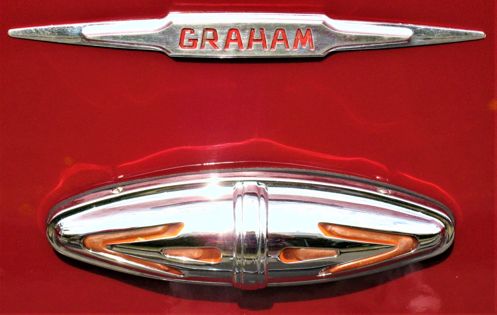

    Back in the day, "Graham" made some pretty cool turn signals as well, but super rare and super spendy if you ever see a pair for sale.

    The upper race is a Timken #6, which is readily available. I have purchased hundreds of them in the last 12 years. This race is used in all Ford boxes 1932-1960ish.
    I tack weld a 1/2" flat washer into the old race to knock them out. I have begun using a carbide in a die grinder to make two small reliefs, so the race can be knocked out in the future without much trouble.
  17. Tim

    Or just weld (carefully!) a couple of beads on the inside of the race. It'll shrink when they cool and just about fall out...

    1/2" flatwasher welded into the race. Sometimes the weld is enough to shrink the race and they will fall out like stated above, but the washer gives something to tap with a punch if not
    And this shows where I grind a small notch to make future removal easier

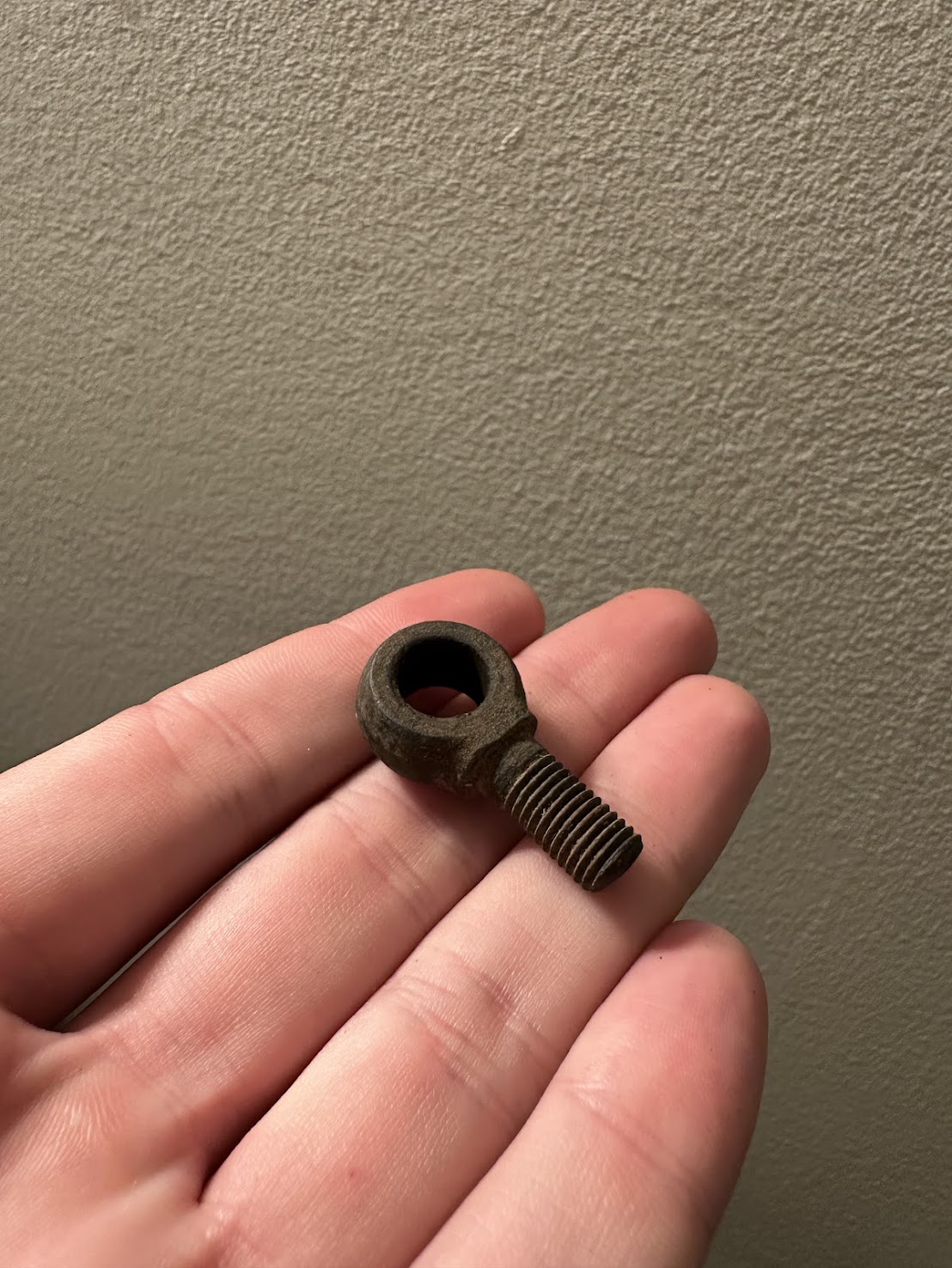

    Also, I received a great care package from @Nobey with the eyelet we were looking for. Thank you again, Rich!
