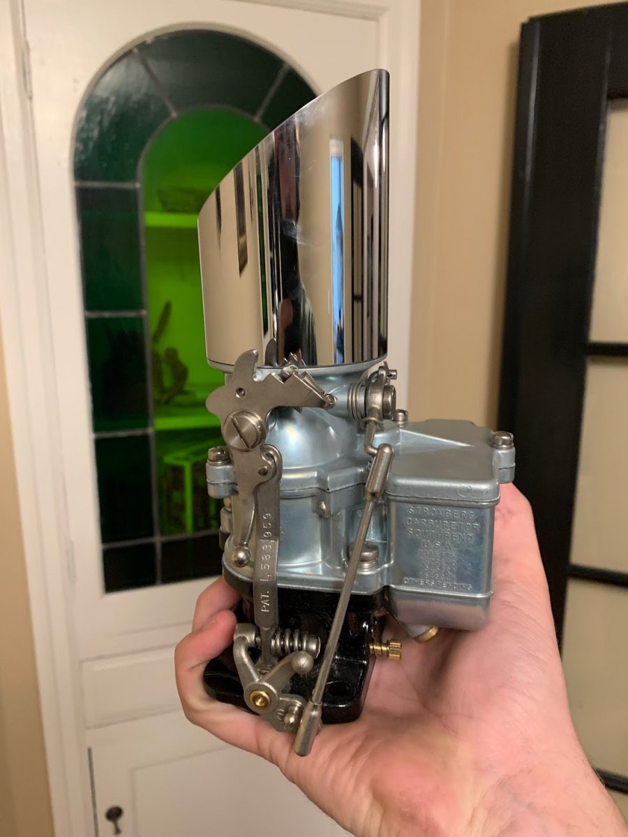

    While we're talking hot rod componentry, I'm super pumped to run one of the new Stromberg 81's on this project. I've heard lots of good things about them. I'll also be rebuilding the Ford 94, so it'll be interesting to see which one will work better with my combination. This carb seems huge compared to anything I've ever put on a motorcycle, and it's currently sitting on my desk because it's so damn cool to look at. The only place that it'll look better? On the car. Soon! IMG_1577.jpg

    I'm running a pair of the new 81's on the Vicky. I had to re-jet for the al***ude here. They (Stromberg) made these using a 97 body. They install a sleeve for the accelerator pump to change it from a 97 to an 81 size pump. If you look at the 97 body, there is a slight radius at the top of the bore. It is missing on the sleeve. Without the radius, it is next to impossible to load the pump leather into the pump bore without hairlipping (for lack of a better term) the leather when it is wet with fuel....
    When do you do a rejet of the power valve? When the leather is wet... I learned this the hard way. I suggest you radius the top of the bore while you can with the carb off and dry. I did p*** this onto Clive and they said they would consider the modification to future production...
    With the two x two I go rich with the power valve open and I've blocked them off. Mileage and performance increase.
    Had a dyno session with AFR readings to achieve this.
    Going to be fun....

    Nice, thank you for the detailed explanation. I'll send you a PM prior to me running it to figure out what exactly I should do. Can't wait to get this on the engine, along with the tube header and new/old intake manifold.

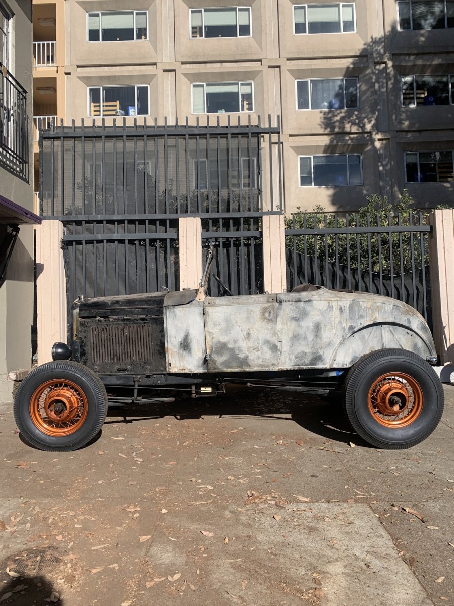

    Yesterday afternoon, my friends and I were working on a top secret project that I'll share more about later. Amidst the chaos, I was able to roll the roadster out for some pictures—and a quick drive around the block. It ran great. I still need to work on my downshifting, but I'm definitely feeling more comfortable behind the wheel. The new windshield changes the look of the car big time. IMG_1775-1.jpg

    My Pap’s advice on any type of build that has a thousand little details: “It’s a weekend project, Ryan. It’s 112 weekends long... but it’s just a weekend project.” At the pace you’re going, you’re racking up the weekends at a good clip and will be scooting’ around in that roadster in no time.
    drdave, AHotRod, Dedsoto and 2 others like this.
  24. trevorsworth
    Joined: Aug 3, 2020
    Posts: 2,046
    trevorsworth
    She looks ready to rumble! I think that's about the point where I'd get distracted driving it and never get it "done."
    brEad and J.Ukrop like this.
