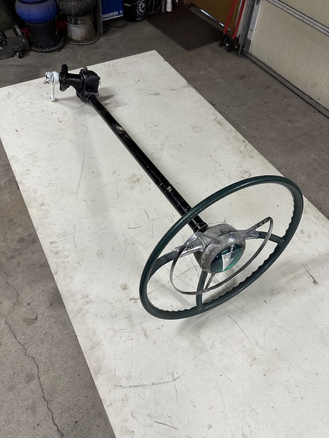

    Sitting here on another warm San Francisco night, I'm winding down what I would consider a perfect weekend. On Friday afternoon, I went to the local hardware store to secure the steel and fasteners for my upcoming throttle pedal bracket. If all goes to plan, I'll start on that next week.
    As much as I wanted to spend Friday night in the garage, I switched gears and baked a key lime pie instead. My neighbors gifted us a carton of fresh limes from their parents' house in San Jose, and I figured it'd be the perfect opportunity to make one of my favorite warm-weather desserts. With the pie cooling in the freezer, I went to bed dreaming of Saturday in Petaluma.
    At the shop, we inspected my steering box and took the necessary steps for a smooth operation. Then****embly began. Following the Tardel book step by step, I pieced together the box. Along the way, I'd ask David and Justin for input, making sure I was heading in the right direction. IMG_5066.jpg
    The end result couldn't have been more exciting. I now have a fully rebuilt F-1 steering box set up for a '32 Ford frame, complete with a 1939 Ford steering column and a 1954 Hudson Hornet steering wheel. Everything is tight, and it steers oh-so-smoothly.
    IMG_5100.jpg It looks right at home, but don't worry: it'll get lock washers and cotter pins for final****embly. Another huge step checked off the list!

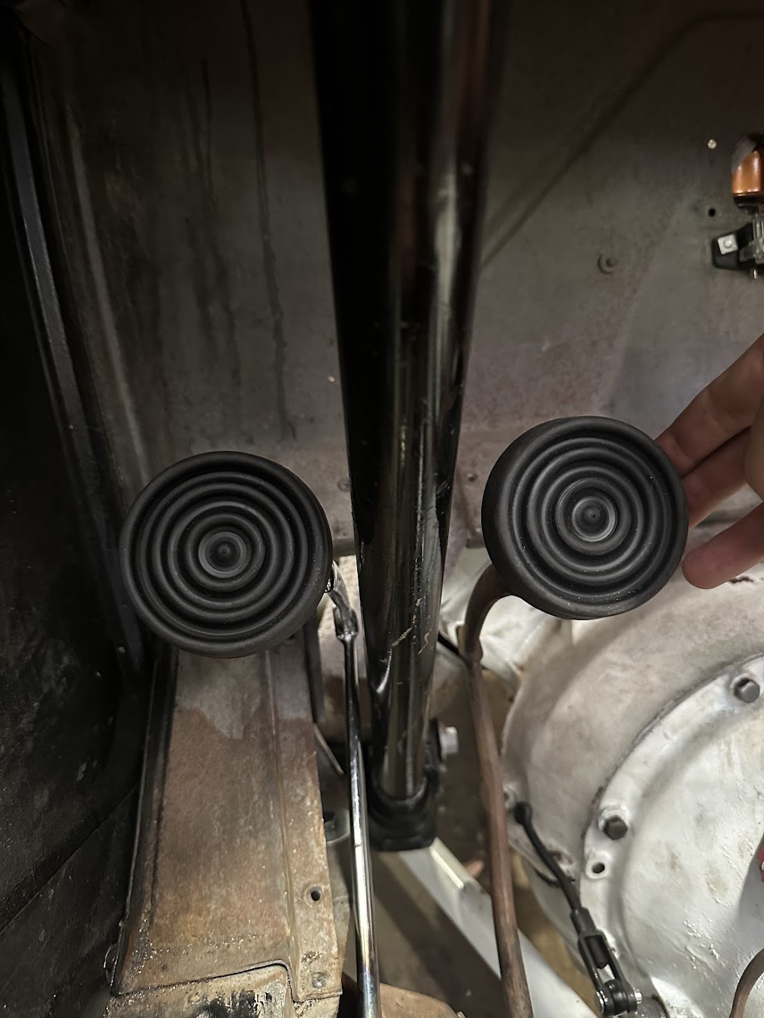

    Inspired by yesterday's progress, I dove right in this morning and started bending the clutch pedal (again). Frustrated by last time, I devised a plan to do things differently. IMG_5101.jpg

    On Sunday morning I sprung into action. Both the vise and the roadster itself acted as heat sinks, so I grabbed a piece of wire and hung the clutch pedal from the outside of our fire pit. Out of curiosity, I broke out the timer on my phone to see how long it really took to get it red hot. The answer? Eight minutes. With a gloved hand, I carefully brought it over to the vise I had mounted on our back porch with a giant C-clamp. IMG_5101.jpg
    Using my right hand, I popped the torch back on and continued to apply heat. With my left, I grabbed the pedal and leaned backwards with all my weight. The pedal moved. Thankfully, vise didn't move too much. When I thought I was close, I rushed down to the garage to mock it up. Just a little more, I said. I repeated the process until the very hot pedal cleared the column.
    I'm overall happy with how they look. That said, I'll need to trim a little bit of the subframe, which shouldn't be a problem. The K-member will also need to be notched, but I'll tackle that once the body is off so I can make it clean and ensure everything is strong.

    If I ever win the lottery, I'll chrome the brake pedal to match. In the meantime, I'm going to paint it silver in the same vein as the headers.
