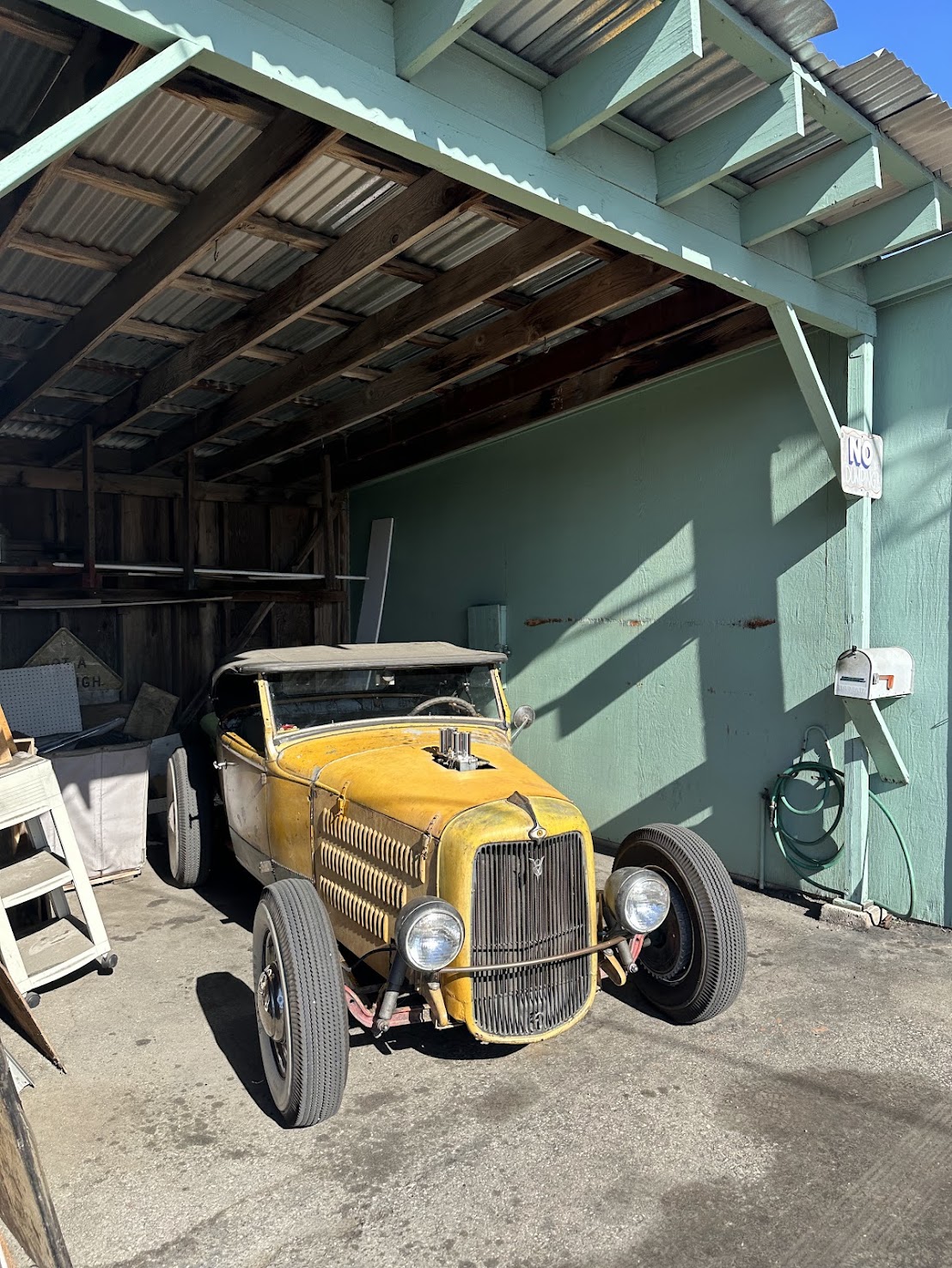

    After my morning at the park with the friends, I jumped in my truck and headed north to Petaluma. IMG_5370.jpg
    Being greeted by my favorite hot rod always makes me smile.

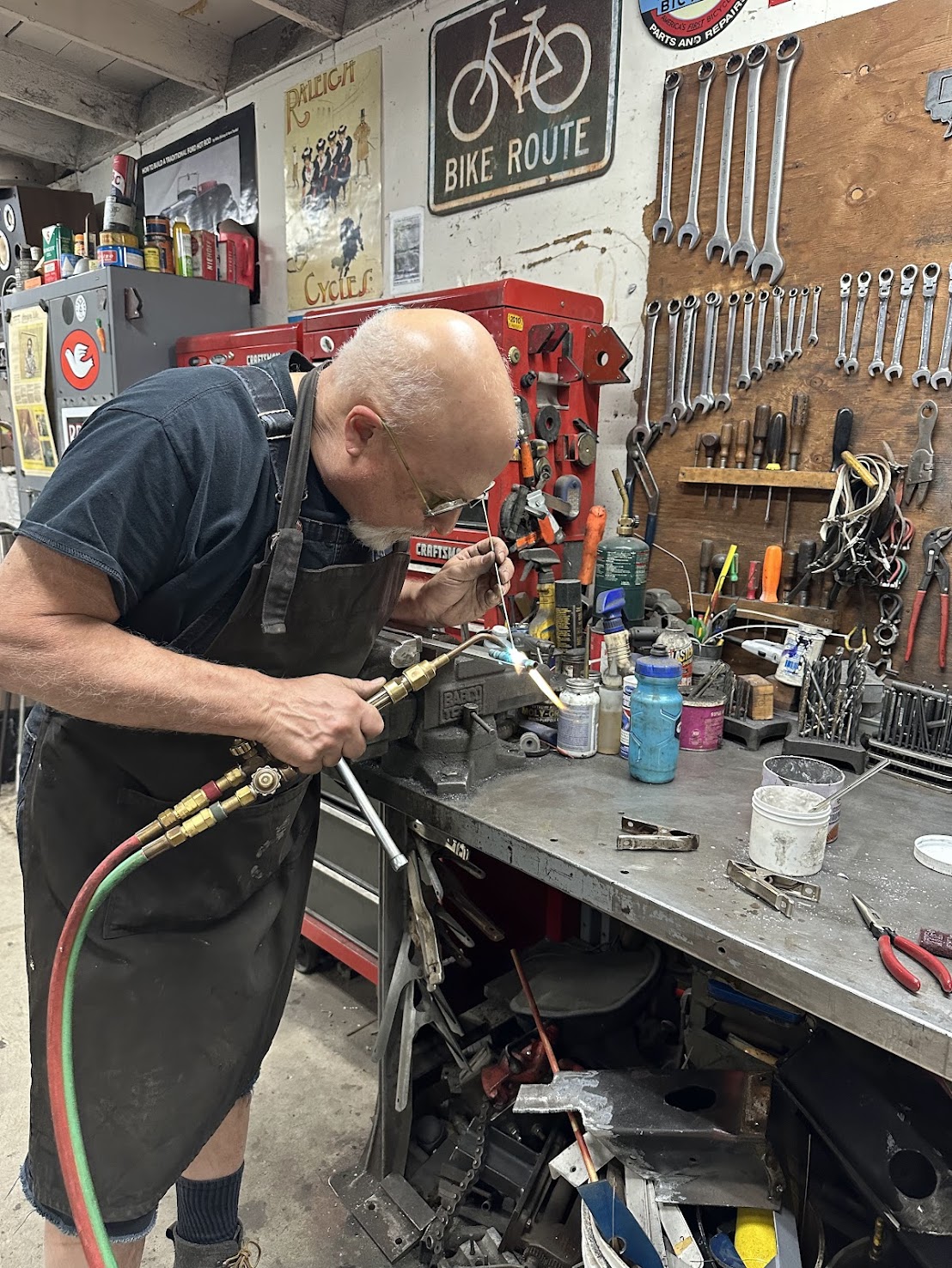

    David and I had a great half day at the shop. I had some brake parts for Ted's quarter-mile machine, and David helped me out big time by brazing the pedal shaft retainer since it was too thin to weld.
    The master at work!

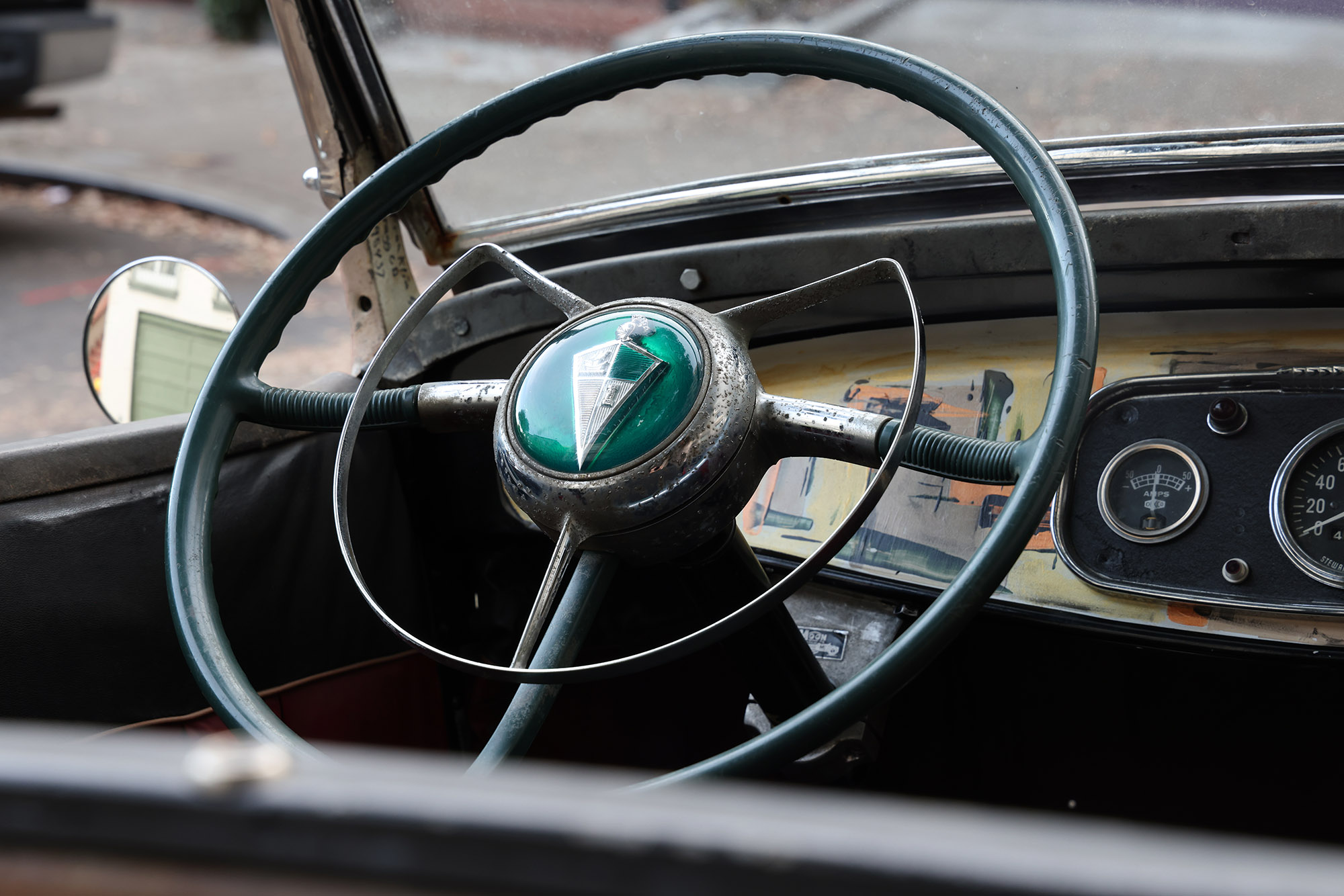

    The recipe is: Hudson wheel, 1932 Ford dash, Moon column drop, Stewart-Warner "Mate" cluster, and old hot rod upholstery.
    Later this fall, I'll be painting the axle bells, spring, and shackles white. That's all for now!

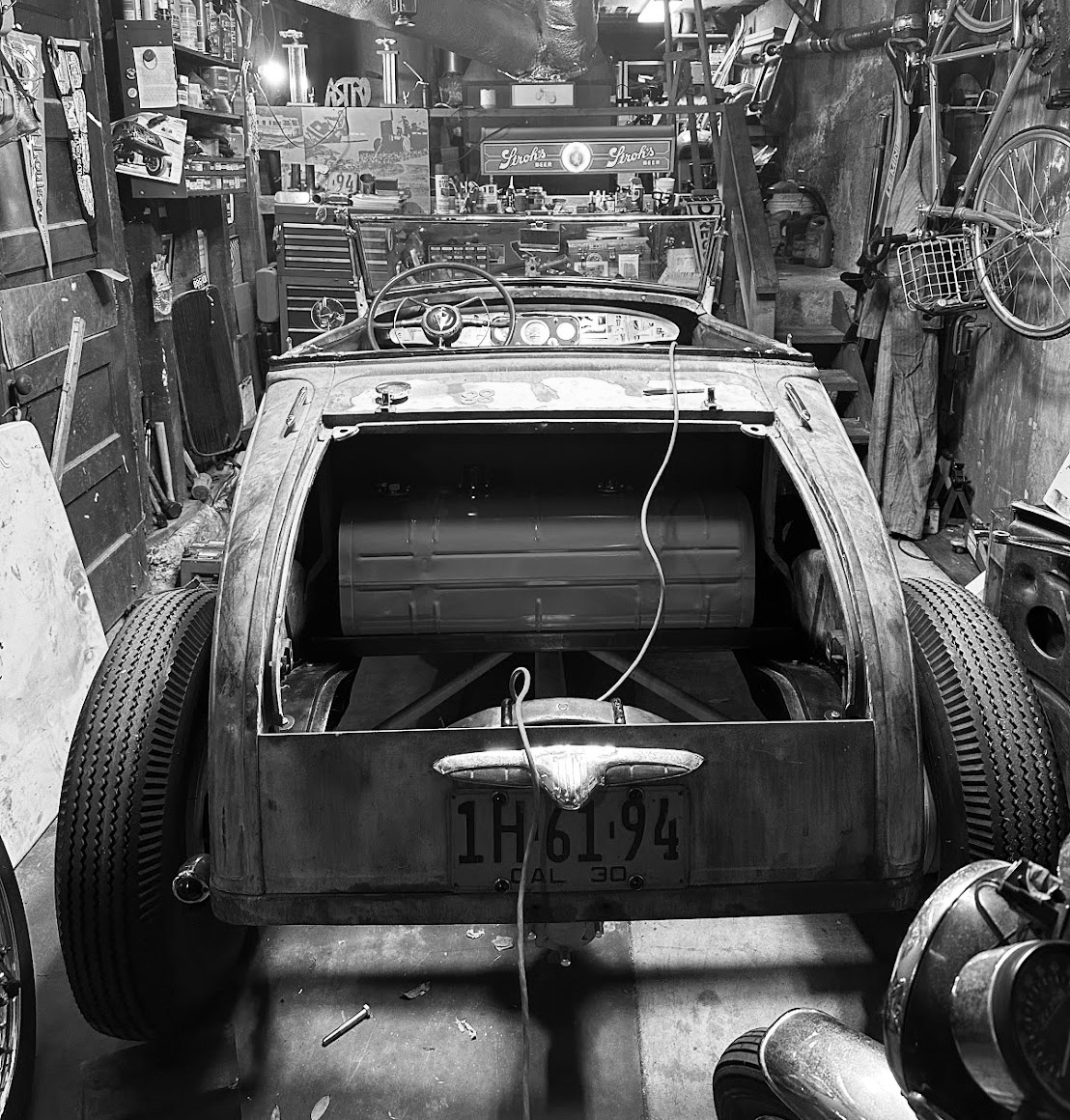

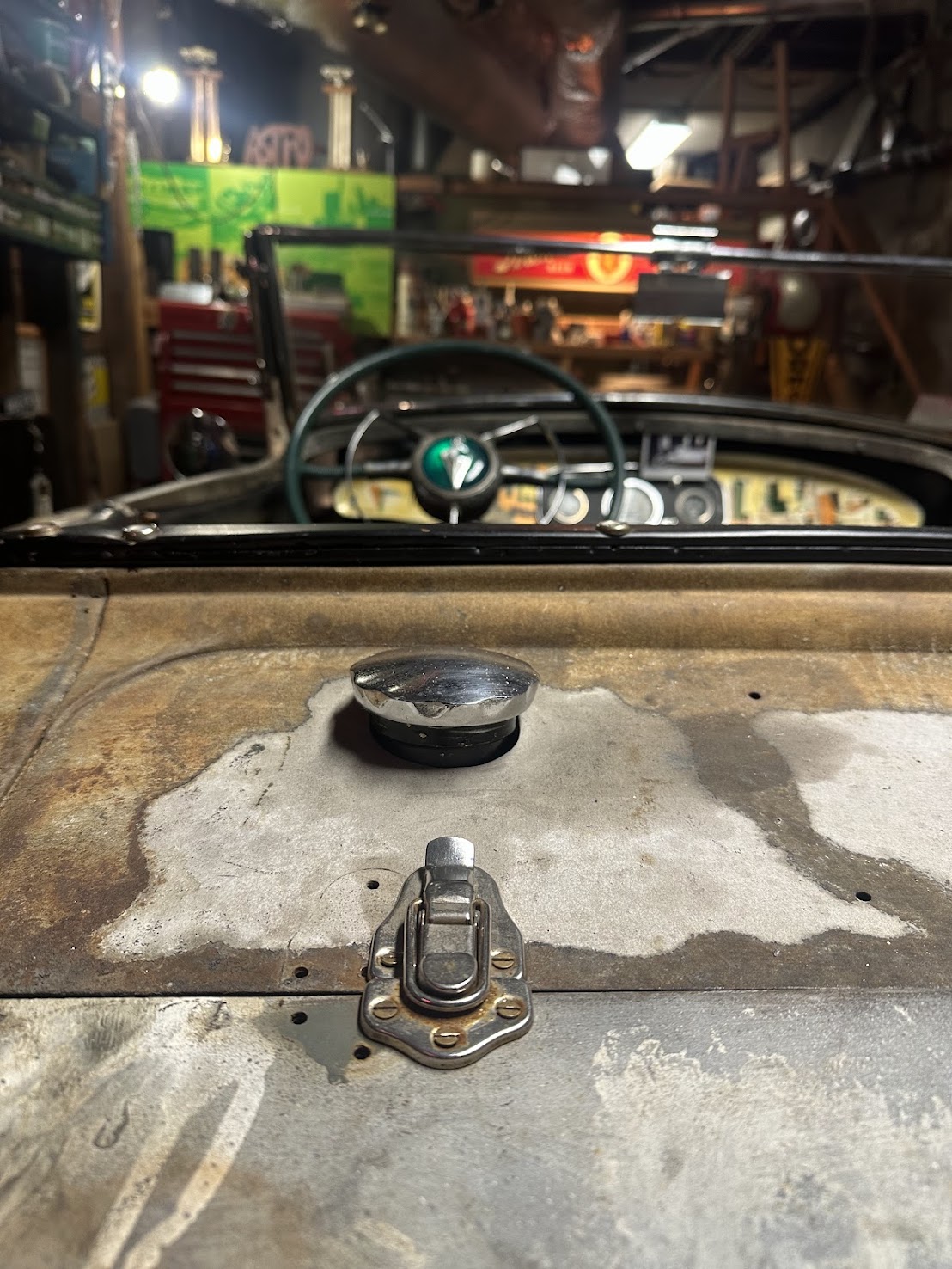

    This weekend, I spent a couple of days finishing up the gas tank mount.
    The tank is fastened via six grade 8 bolts to a piece of 3/16ths steel that spans the width of the car. That piece is then bolted through the subrails to the frame via four 1/2 inch Grade 8 bolts. Rubber insulation was used to reduce vibration.
    Once the tank was secured, I took a 2-1/4-inch hole saw to the tulip panel.
    Once the filler neck was poking through, I moved the lunchbox latches slightly inboard. Now the steering column, gas cap, and latch are all in a line. The extra holes will be filled soon.
