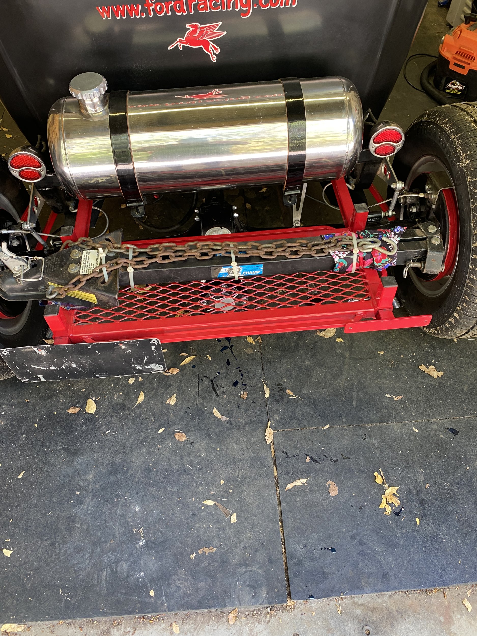

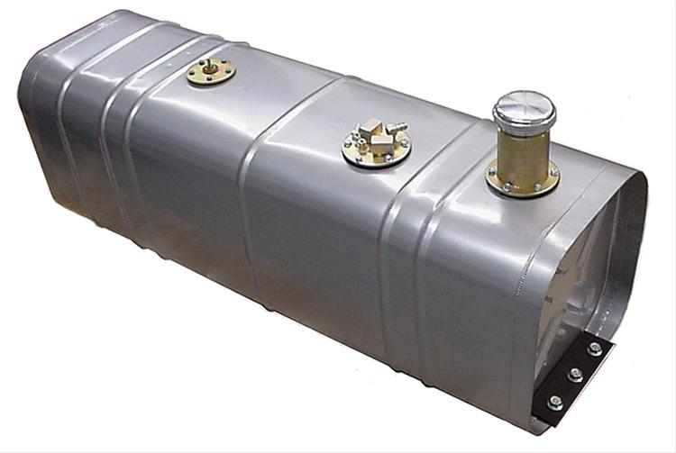

  1. No one has mentioned the tank hold down you came up with, but it looks like it will stress the hell out of the tank seam causing a leak over a period of time and use. I only bring this up since that thin sheet metal it is made from does not look structural, it is just to cap off the ends of the tank. I could have sworn that style tank uses straps to keep it planted. If I'm incorrect, then you can disregard my paranoia. We have seen so many gas fires on this forum and I would like to not see that with your dream car.
  2. The 39 guy
    Joined: Nov 5, 2010
    Posts: 3,768
    The 39 guy
    Pocket Nick brought up a good point there Joey. A pair of straps would be a better option for mounting the gas tank. Some rubber between the tank and straps would also be something to consider.

    Nick, to be totally honest I have no idea because I’ve never done this before. Here’s how they had it on their site, so I was basing it off that?
    I’m happy to run straps—maybe I’ll make them?

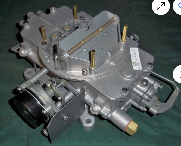

    If not brass, then what?
    41 GMC K-18 and Six Ball like this.
  5. RodStRace
    Joined: Dec 7, 2007
    Posts: 8,646
    RodStRace
    Think of brass AND aluminum as soft, malleable metals that form fit.
    Think peanut*****er and jelly and trying to separate them after they are smooshed together.
    I'd go with a steel fitting.

    NPT fittings are available in stainless steel, if your so inclined...

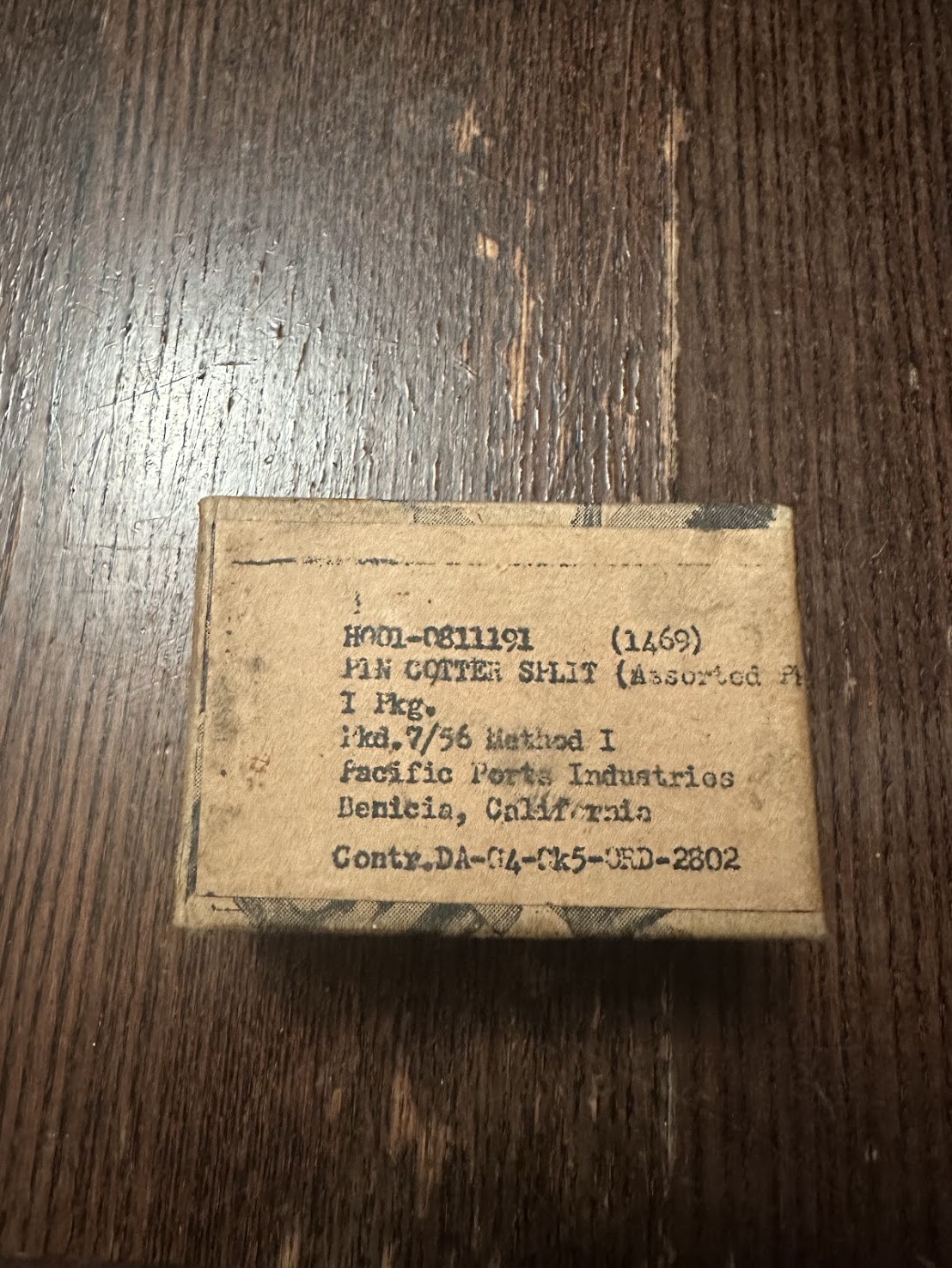

    Cool that the cotters found their way home back to the Bay!
    41 GMC K-18 and So Cal Brian B like this.

    Don’t use stainless in aluminum.
  9. Beanscoot
    Joined: May 14, 2008
    Posts: 3,609
    Beanscoot
    I think the worry over brass fittings in aluminum is over rated. Ford used brass fuel inlet fittings on its aluminum body carbs for decades and I didn't see any problems.

    I agree adding straps to your existing tank mount. In my head I’m seeing a sorta cylinder shape, sloshing gas and San Francisco hills. That’s a lot of rocking. Straps would be peace of mind at minimum

    I've used brass fittings in aluminum stuff for 60 + years with no problems with the ones I put together. I have had trouble getting old****emblies apart. Head gaskets with copper seals on aluminum head has caused problems. Just look at the water passages on old heads.

    I have installed that exact tank, with that exact mounting methodology, going as far back as 12-years-ago.
    None have had any issues.

    Go to a thrift store and buy a couple of leather belts to go under the metal straps. This set up is 24 years old.

  15. Looking at the picture it seems it should be ok since that is how it is advertised to work and you also have a real world testimony using your method. There are a pair of raised sections, one by the filler and the other pair right after the sending unit, that is where the tank straps could go. Seems like they gave you a few options to secure it. My only experience with tanks Inc is with an off topic El Camino. Carry on.

    I get your point, However I've used stainless in aluminum with antiseize to mitigate dissimilar metal corrosion. I've also used brass in aluminum with teflon paste and zero issues...
    Either method is fine.

    Like Neal said. All the old ones ive taken apart had brass fittings.
    I've never seen an old stainless one.
    Since joey is building a period correct car, it makes sense that he should use brass fittings. End of discussion.

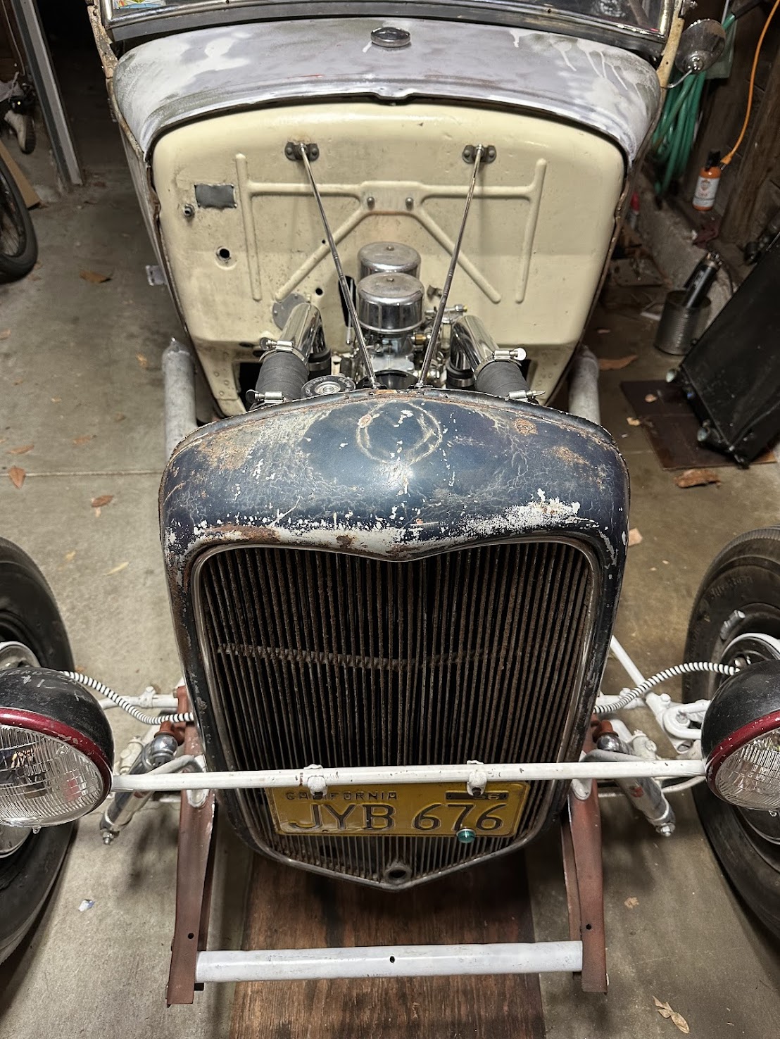

    Thanks everyone for the continued support! Remember the cheese Bugles? Those were the best.

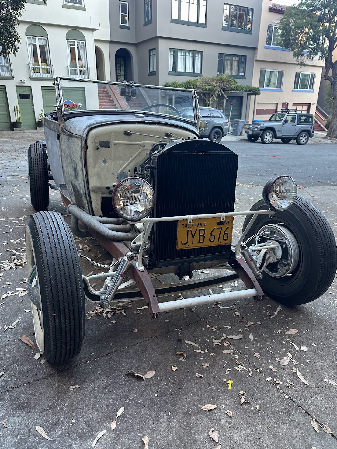

    Over the weekend, I was able to take some time to turn some wrenches on the ol' A-V8.

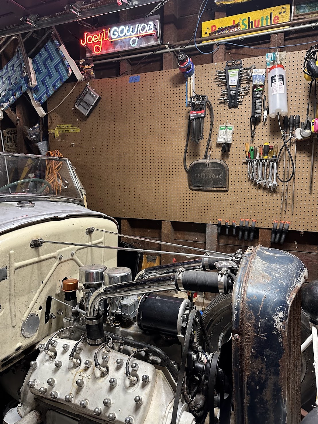

    The main task? Install the new radiator and make everything else fit. Back when I was looking at the car mocked up, it came to my attention that the radiator was a little bit too tall. Per my measurements, it was about 5/8 of an inch. Being the traditional hot rodder that I am, I figured I could have just left it, adjusted the support rod mounting position, and moved on with my life. But when the thought of having an uphill hood came around, I knew that wasn't going to fly. So, after a phone call to Johnson's (formerly Walker) and a major investment, my new radiator was on its way for Alabama.
  26. J.Ukrop
    Joined: Nov 10, 2008
    Posts: 3,602
    J.Ukrop
    SUPER MODERATOR

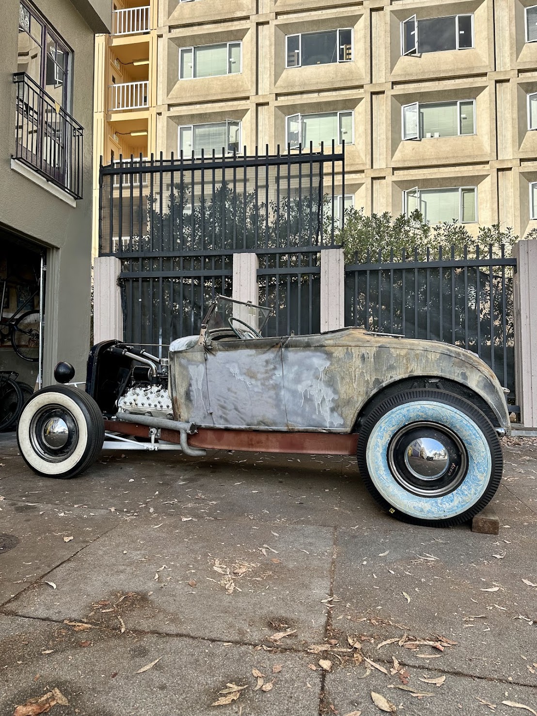

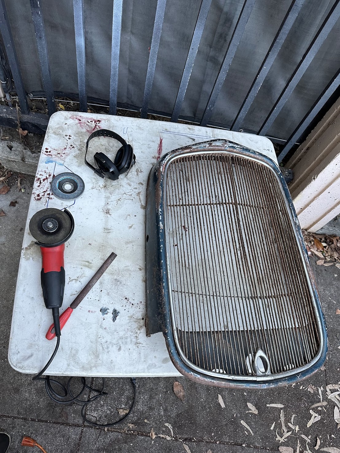

    Like a novice, I figured the shorter radiator would just bolt right in. Yet when I set it into position, I found that nothing lined up. I spent part of Saturday and part of Sunday making a new front brake line, trimming the grille shell, and modifying the radiator support rods.
    Mocked up and it's already looking better.
    Backyard mechanic, defined.
    Doodlebug.
    What's that quote about restoring a car versus cutting it up?
    It was dark by the time I wrapped things up, but I was happy with how it all turned out.

    As cool as this car is and its evolution, I always get a kick out of the details on the walls of this tiny garage. The vintage dustpan that has the embossed letters on it, with that distinctive wire handle, so far with web searches, that relic hasn't shown up!
    So fess up amigo, where did it come from, was it a find at a swap-meet back east?
    I am also curious about the radio hanging on the pegboard, what brand is it?
    I will say I am very impressed with the custom NEON sign.
    I have a Mobile Pegasus NEON sign in my office, the cool thing about NEON is, it never goes out of style.
