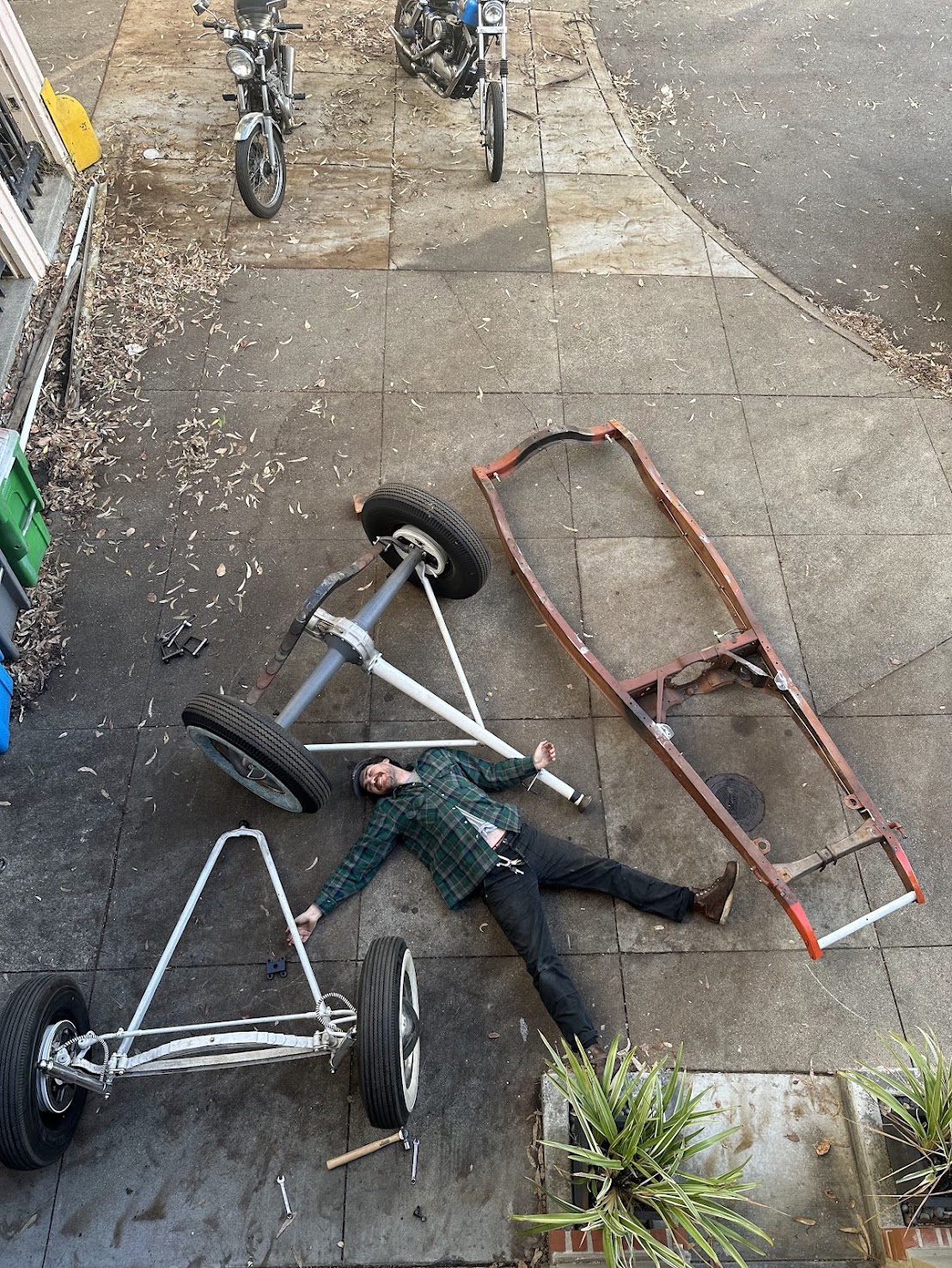

  6. J.Ukrop
    Joined: Nov 10, 2008
    Posts: 3,664
    J.Ukrop
    SUPER MODERATOR
    With the driveline removed, I then pulled the front and rear ends. Sometimes you just have to take a rest a**** your model kit pieces.

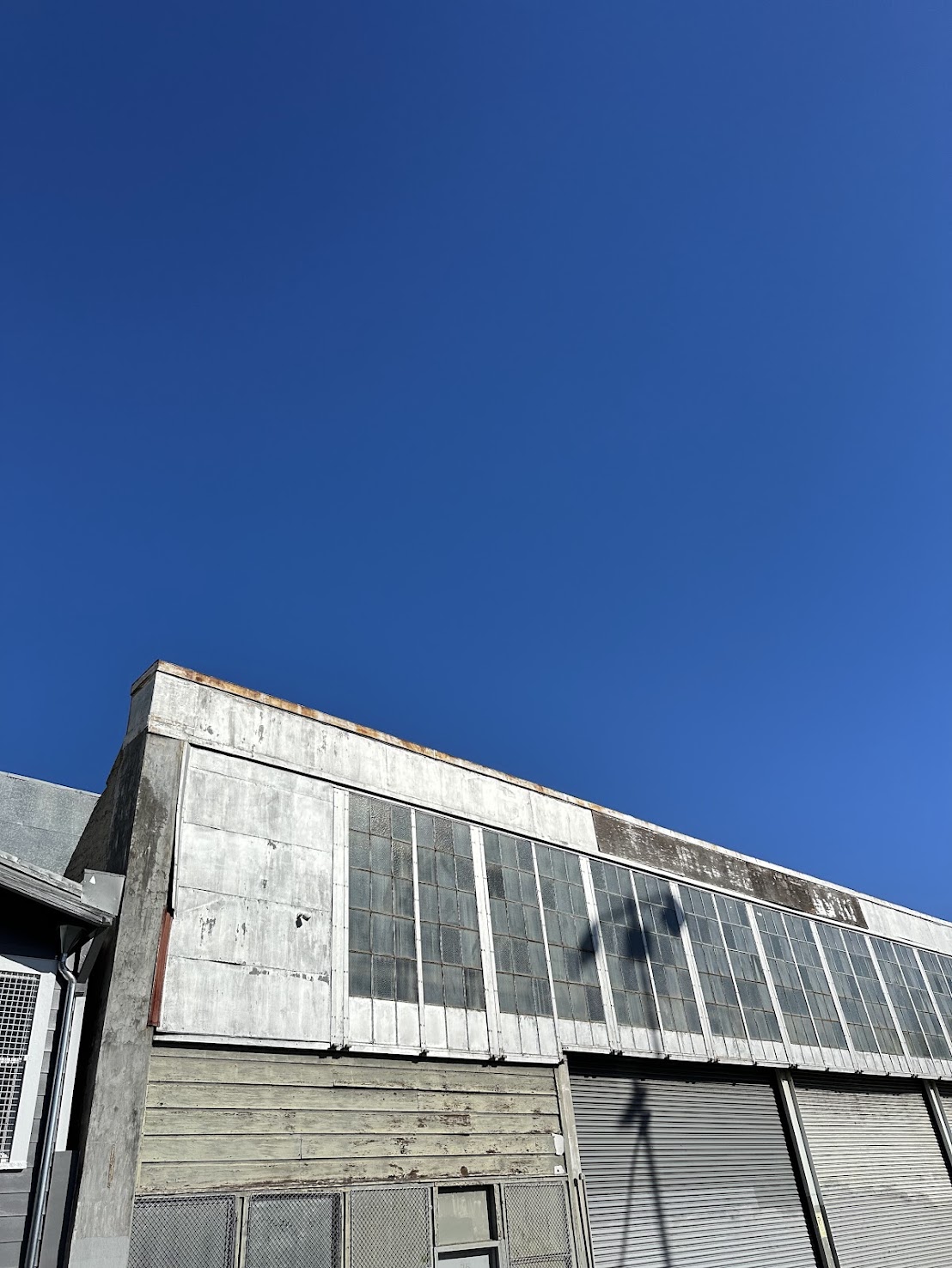

    Only tangentially related to the build, but I was out for a post-lunch walk and I fell in love with this building. The colors, textures, and materials feel very similar to my car. I'll have to stop by for a picture next year.

  10. RodStRace
    Joined: Dec 7, 2007
    Posts: 9,031
    RodStRace
    At least 3 roll up doors with likely driveways, an entire second floor with good windows, probably an open loft.
    Certainly commercial, so should have some heavy duty power supply.
    Aside from HVAC economy and probably some questionable 'upgrades' over it's life, it's a perfect rodder property! If it has a freight elevator, you could even have completed car storage upstairs.
    Only problem outside of that is that in SF, that's a multimillion dollar property.
