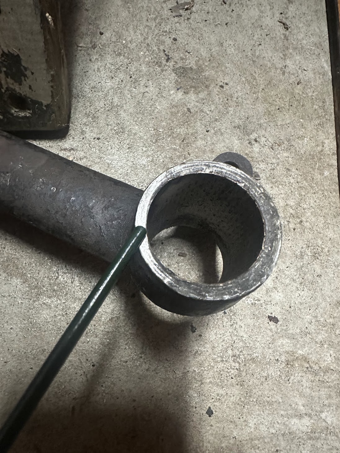

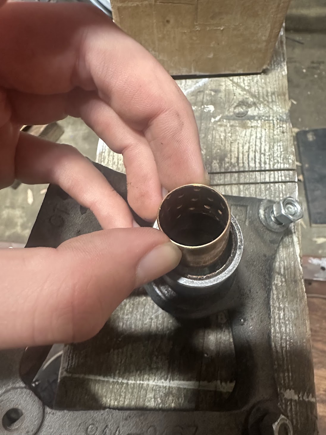

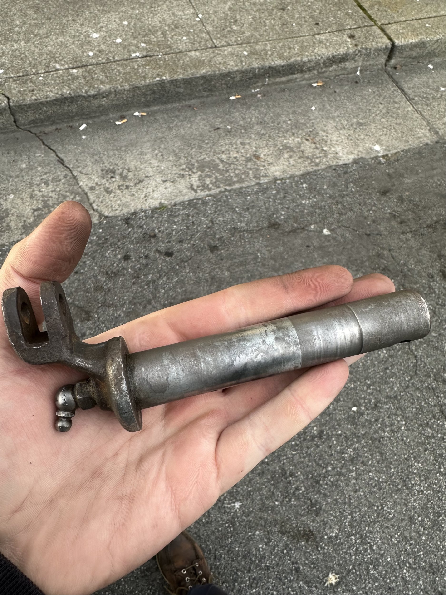

    These things are all about the order of operations. Right now, I can't install the engine and transmission because I have to re-bush the pedals. IMG_7193.jpg
    Unfortunately, the Millworks bushing did not fit. I managed to find a complete replacement shaft from Third Gen, which is on its way.
    The larger issue, however, was the brake pedal. You'll see that it has worn through the bushing and into the body itself. I found an NOS bushing (also en route), and I may have a line on a replacement pedal. I can't wait to have this thing re-bushed, painted up, and back in the frame!

  6. It does look a little worn but still round just off center, the bore in the pedal looks like it might have been done late on a Friday at the Ford plant. Would not be the first one I have seen like that.

    Either way sounds like you have the problem
    Sorted. Keep it on the shelf who know when you’ll find a new use for it or an over sized bushing

    Thank you, everyone! I’ve been away all week on a work trip, but I’ll be back in the garage tomorrow to make some more progress. Before I left, David and I had a great day in Petaluma working on the pedals.
    First, I removed the smoked bushings. I was very impressed with the sharpened chisel technique.
    R.I.P.

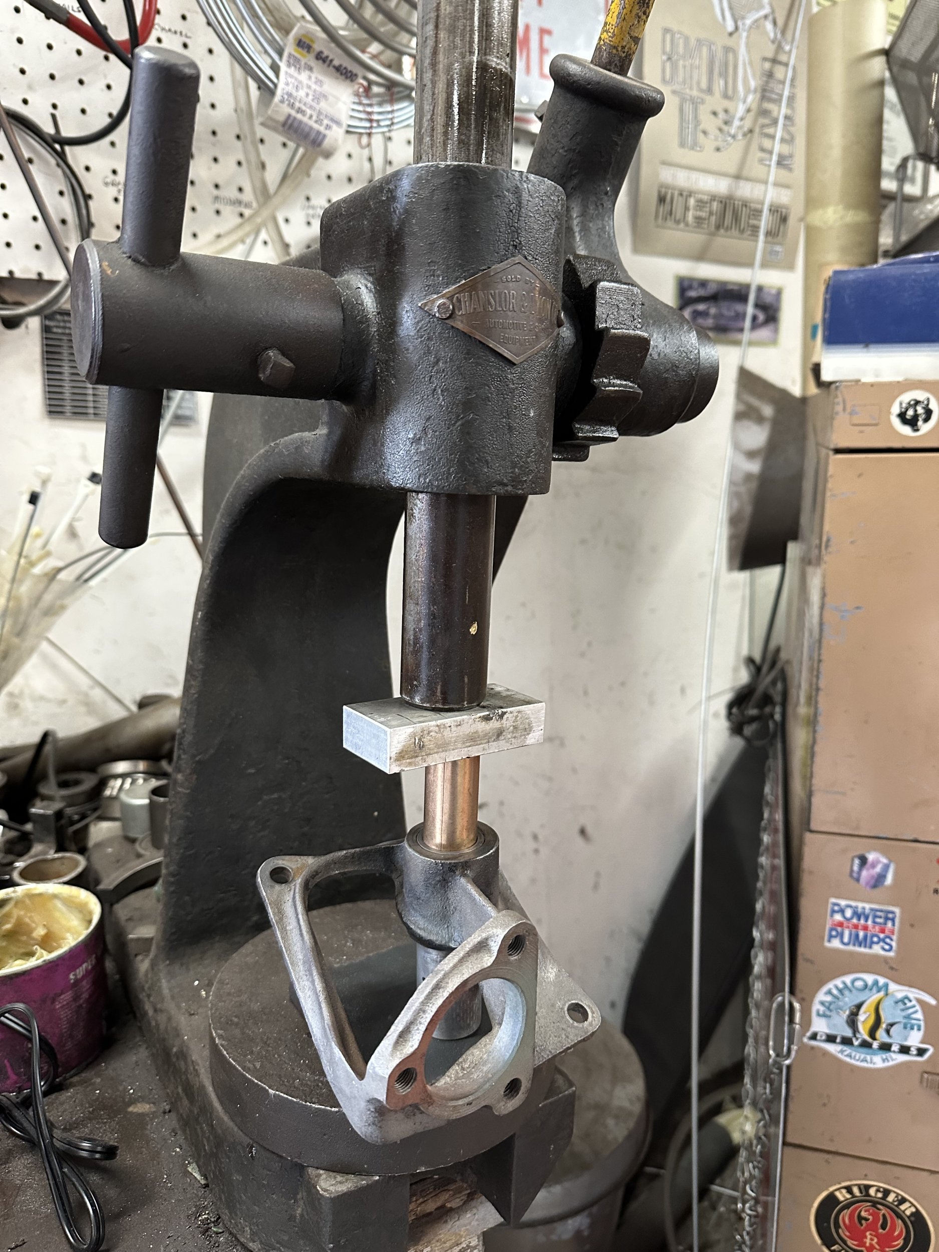

    With everything cleaned up, we installed the new bushings with this amazing old two-ton press.
    David’s shop is my favorite place around. Where else would you get a view like this while wrenching? This is Ted’s A-V8, which you’ll see on the road with my car in the coming years.
    Unfortunately, my clutch/brake pedal shaft was way too far gone. I thought there were reproductions available, but that’s not the case. These are one-year only and very hard to find. Without the pedals, there will be no engine and trans install. Simple as that.
    Well, looks like this project is on ice until I can find this hen’s tooth, right? On the drive home, I sifted through my options. Have it machined? Buy another set of pedals? I knew one thing—I’ve come too far to work with anything less than the best. I shot off a few texts. A minute or so later, a H.A.M.B.er (who has the best build thread on here) texted me back that he had one, and it’s NOS. More on that tomorrow.

    With a hacksaw, a chisel, and a big enough hammer you can remove anything. :eek:
    Weld it up and turn it down, almost free. :rolleyes:

    I was thinking you could get an over sized bushing and reem to fit the worn down shaft. But that’s a good project for later since he’s found a replacement part

    During my apprenticeship I had a similar deal (a worn small engine crankshaft bearing surface). The company was nice enough turn it down smaller, nickel plate it and grind it back to standard.
    I wouldn't want to have to pay for such a repair though!

    Remember when I said someone saved the day on the pedal ***embly? That someone was @NealinCA. While I was out of town last week, he sent me an NOS 1939 Ford pedal shaft. It's absolutely perfect. With David (@six5monster's) handiwork on the pedals and the new shaft, everything fits together exactly as it should with no slop.
