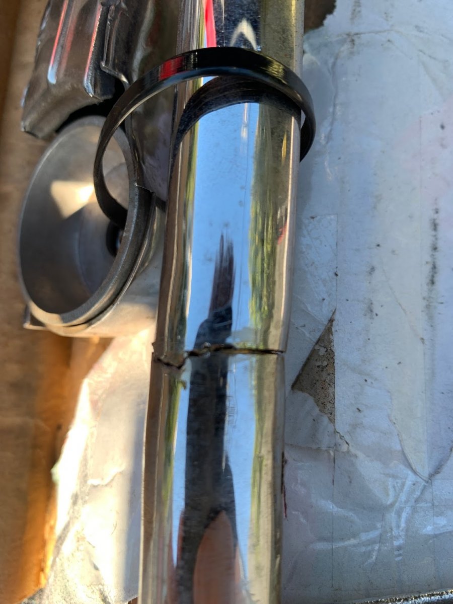

    Yeah , I should have realised David would be the man to help with that. I have seen roadster windscreen frames brazed before and they always seem to break again . I think they are just too flexible and prone to vibration, without much room to splint them internally ... and if you make a stiff point the gl*** breaks there.. damned if you do damned if you don't! Hard to know what to do!
    I think I would probably fix it as best I can and then look for parts or another damaged one at swap meets. Once I had the part I needed, dismantle the whole thing and replace the broken piece . I know the budget etc and the philosophy so just make it a long term goal, and move on with other stuff, the parts will turn up.
    Maybe put a sleeve/fillet of some sort on the outside , that still allows it to function, maybe a mirror mount or ? and just call it a war wound, .... wear it with pride sort of thing, until it can be replaced.

    I'd seriously consider silver brazing that up. Your bicycle guy might have that talent. If done right it should be able to be done without bluing the plating and would polish up nicely. Proper flux and probably 45% silver. I'd do it for you if I/you....well really car was closer. Needs to be done on the car for alignment in my mind.

    That's the plan. David is a master of brazing, and he says silver will do the trick. Thank you for the offer!
