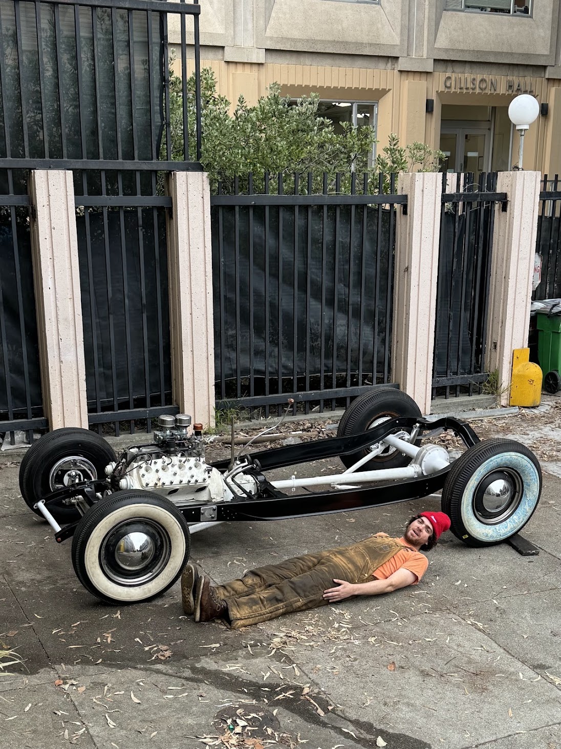

    We have tales of travel, action, and adventure that are long overdue, but I wanted to share yesterday's triumph here. IMG_9880.jpg
    With the help of Yama and Blue, the engine and transmission are back in the car.

  19. Should be UNDER the car doing something!
    Stogy, J.Ukrop, Woogeroo and 5 others like this.

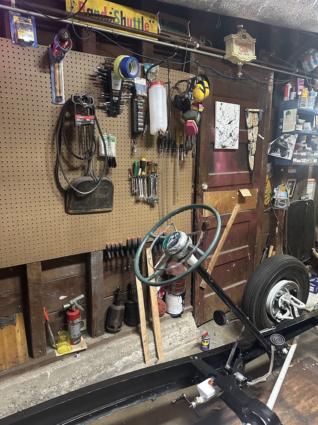

    Then, Saturday night, I fine-tuned the pedals.
    And plugged in the steering, too.

    Sunday
    Called up Blue and Yama. Yama's still recovering from the accident, so he was supervising and shooting photos with his 2010s #digicam for that early H.A.M.B. look.
    Setting the scene.
    Making moves.
    Touchdown.
    Joey Ukrop: Happy Camper.
