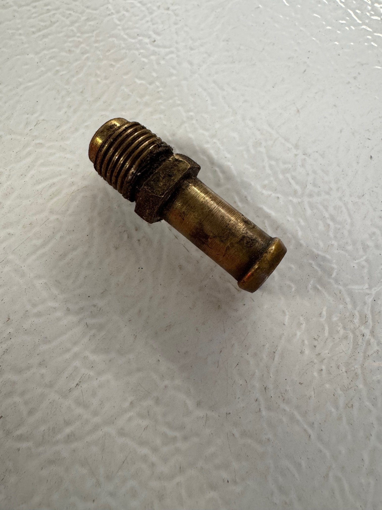

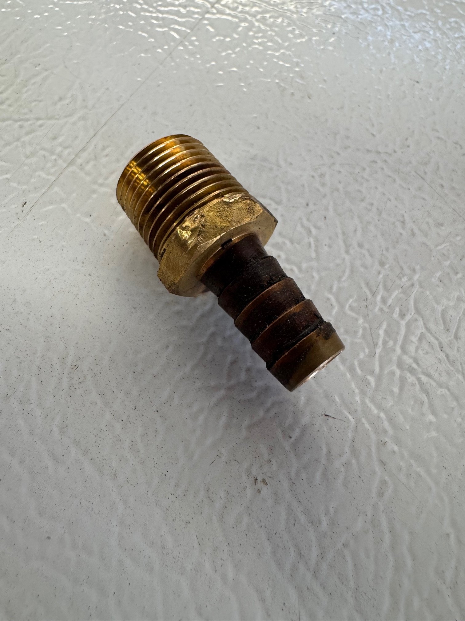

    Hey Joey, GREAT progress man! Lovin how that's looking. If you want them, I've got a couple of old br*** fittings that might work to replace that Q connect on the fuel pump. The smaller one is in good shape, and I think it's the correct thread. The larger barbed one has some damage to the hex area. IMG_4528.jpg IMG_4529.jpg

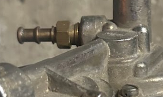

    Just a suggestion, Ford fuel pumps and carburetors have straight cut fittings, the inlet uses a flex line, with a taper that seats at the bottom. The outlet uses a straight thread with a ferrule to seal.
    After market fuel blocks use the tapered thread or pipe fittings. The fitting that Joey has there should be alright. I don’t know where you can find a straight thread fitting with the tapered end today, all the speed shops used to carry this stuff. I’m sure someone on the H.A.M.B. knows where to acquire one.

    There you go, you need that first one with the straight thread Joey, and thanks Jeff….

    And remember to use the "beaded" type fittings, not the "barbed" ones that often tear the hose when disconnected.
    Stock hose fittings are almost always the former, for that reason.
    The best way to deal with those hard-to-find fittings is to get some br*** bar stock and something like this:

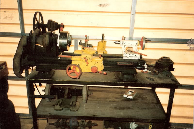

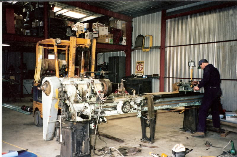

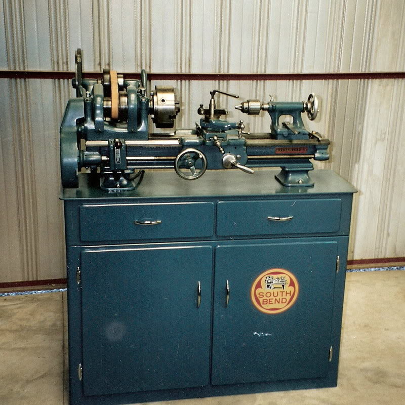

    My Dad gave me his South Bend lathe that I grew up using. Occasionally he'd ask me if I ever used it. " Every time I'm in the shop!!!! ". I would be lost without it.

    I've been using a lathe since I got hooked in high school metal shop. I bought a 9" Southbend right out of college and then bought and sold various lathes to work my way up to a 14x40 gear head lathe. I'd be lost building a car with out a lathe...

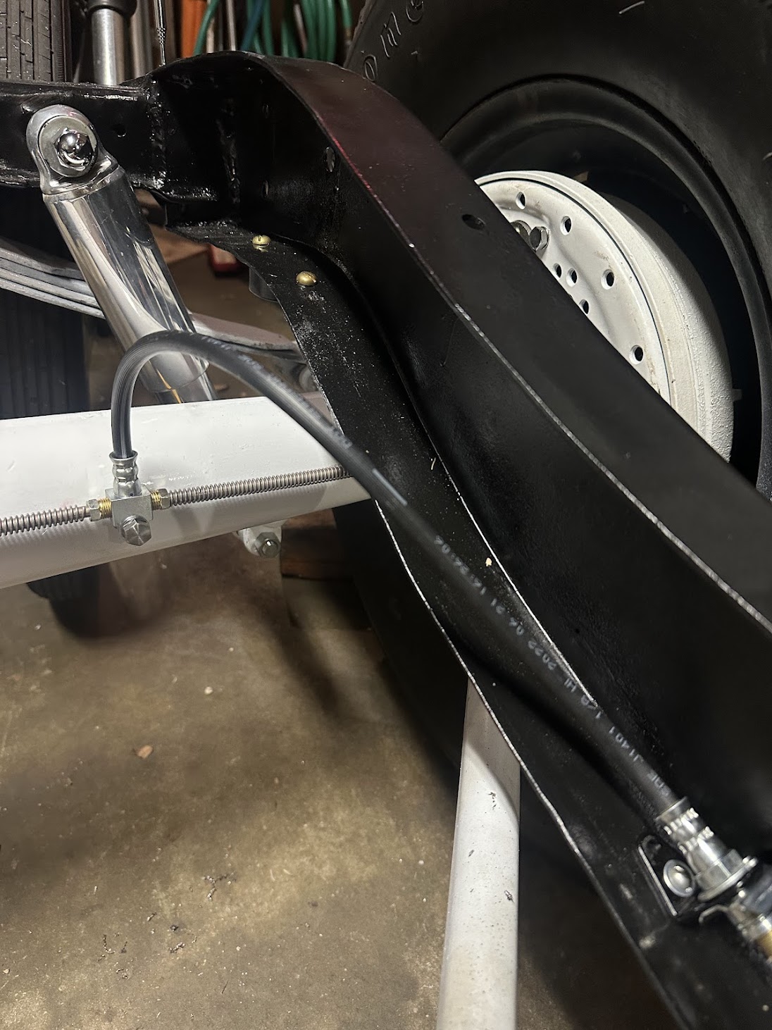

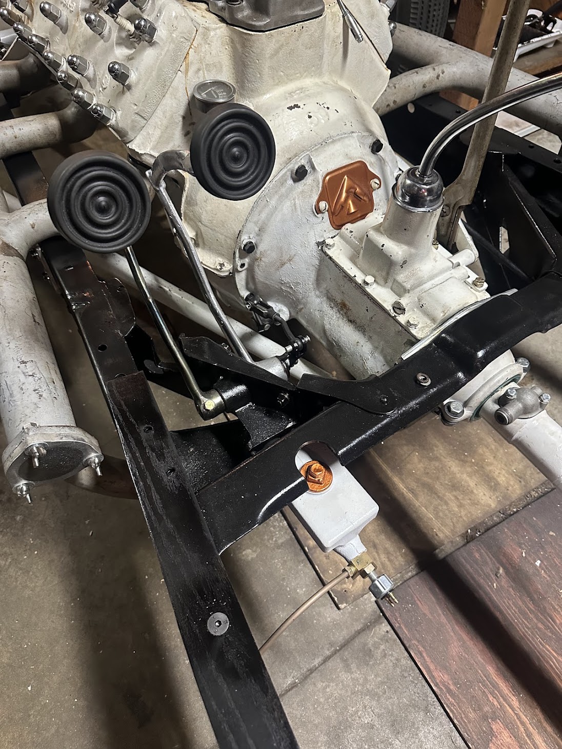

    Hey everyone, I'm back after some very fun travel. No finished car to show (yet), but I am chipping away at the little things on this ch***is.
    Before I left, I got the first anti-chatter rod in position. It's since been painted. The other side will need to be doglegged to clear the clutch linkage.
    The speedometer turtle received some grease along with fresh gaskets and hardware.

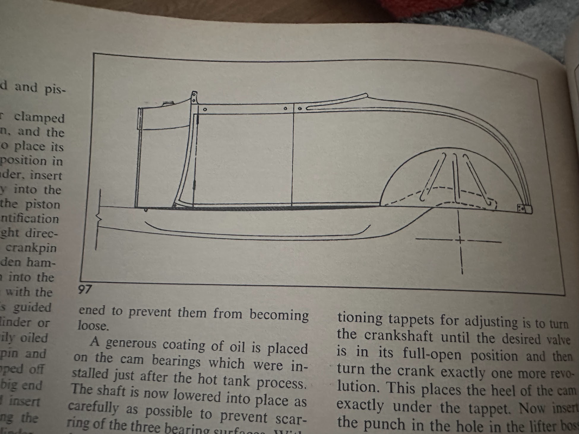

    The wood strips were finished up and secured to the frame, exactly how it was described in Street Rod Quarterly for Bud Bryan's "Project '29."
    And the copy.
  26. J.Ukrop
    Joined: Nov 10, 2008
    Posts: 3,664
    J.Ukrop
    SUPER MODERATOR
    Lastly, I very carefully tapped the rear axle bell to secure the rear brake line.
    I used grease, a low speed, and a magnet to make sure no chips made their way into the bell. Note the bolt head—that was the first lesson David taught me at di Falco Fabrications. I'll be installing the rest of the smaller clips later this week.
