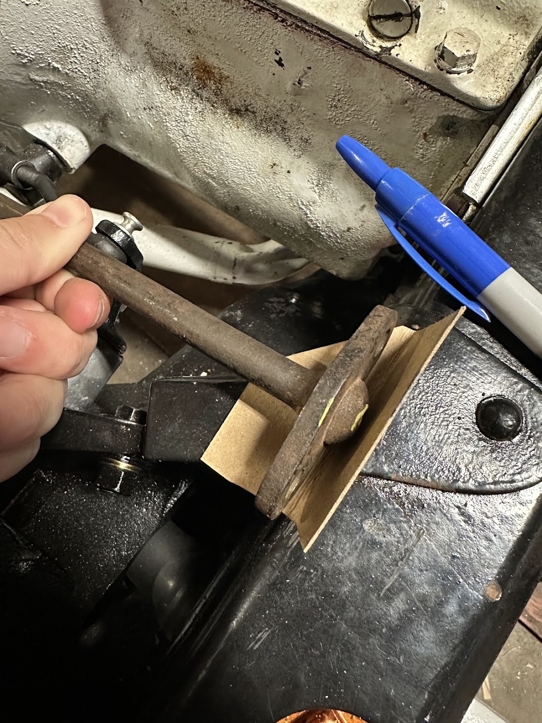

    As promised, I hit the garage right after work. First, I installed the new low-profile zerk and slipped the steering arm back into position. After mocking everything up, I realized that I had almost forgotten the grease shield. Luckily it was close by. I had to modify it to allow the socket to clear. Once I did that, I broke out the torque wrench and tightened it to spec.
    (Grease shield not pictured here, but this gives the general idea.)

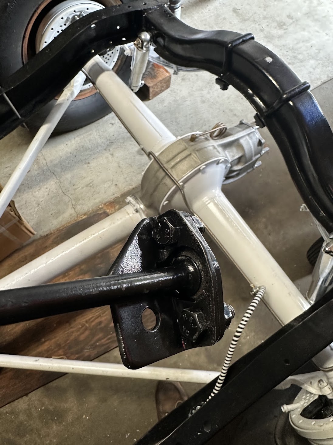

    For today's first project, I wanted to finish my anti-chatter rod bracket. I had actually started this earlier in the week, but it needed some finessing (even though it will be 100 percent hidden beneath the floor).
    Due to the location of the 1939 Ford pedals, I had to re-route the rod. The new layout is inspired by early 1940s Ford rods that mounted to the top of the frame. IMG_9022.jpg
    Keeping it very simple.
    Nothing too crazy, but it accomplishes the task at hand.

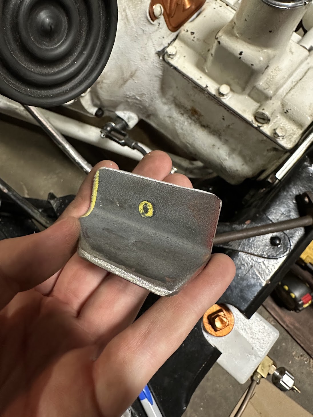

    The next order of business was fitting the ignition wire tubes to the intake manifold. For whatever reason, the tabs didn't line up with the ones on the intake. Most would cut and re-braze, but that wasn't in the cards for me. Instead, I whipped up a pair of relocating tabs out of some thin aluminum that spent most of its life in the form of a Petaluma street sign. IMG_9082-1.jpg

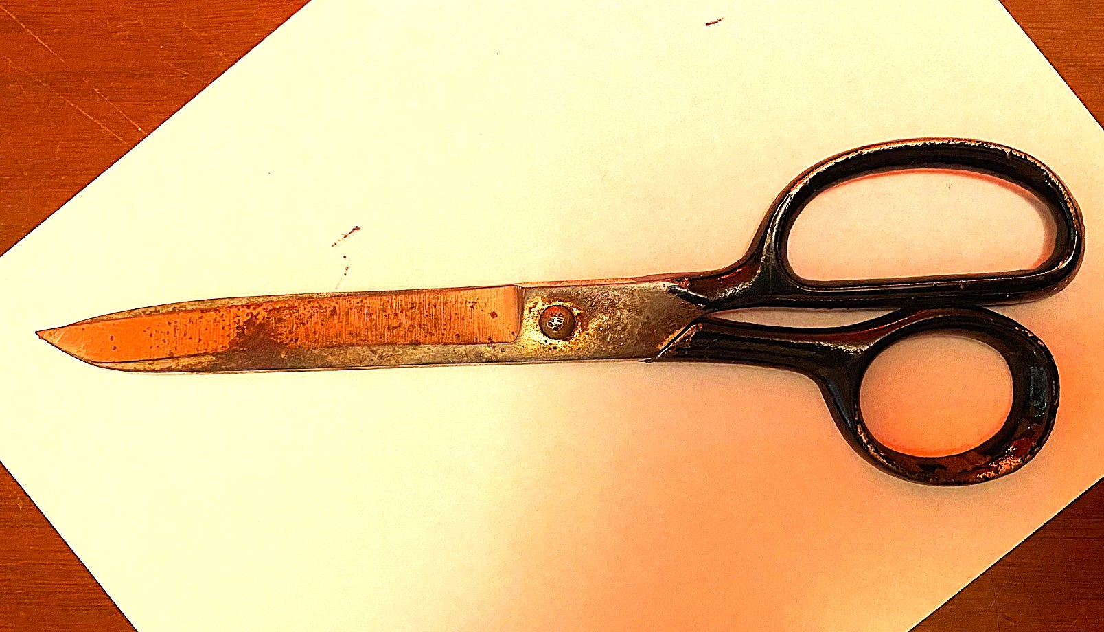

    I love the CAD. Note the vintage scissors.

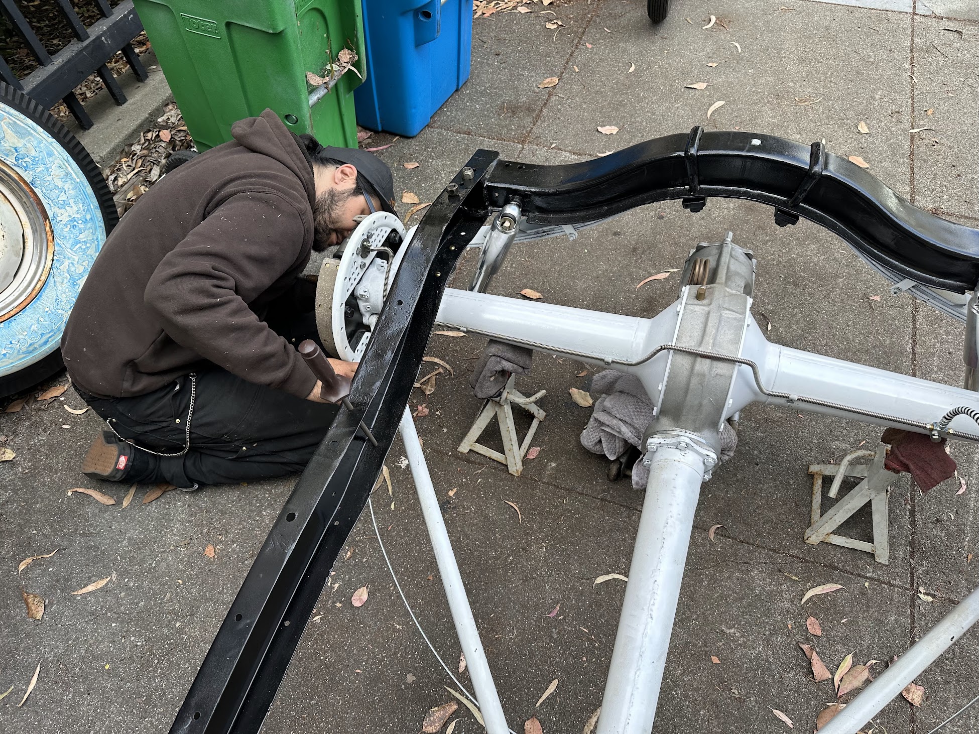

    Although they may seem small, it's these little odds and ends that will make this car more solid in the long run. For the day's grand finale, Yama joined the fun. The task? Setting up the emergency brake.

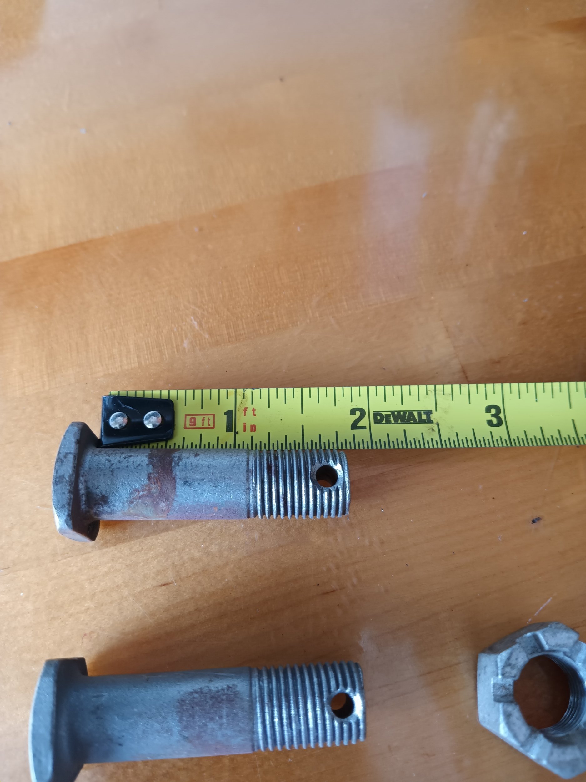

    IMG_9091.jpg The job was fairly straightforward thanks to the @Dennis Lacy kit. While we were at it, we also torqued the backing plate bolts to spec.
    Unfortunately, we discovered one of the long bolts had been damaged. I tried chasing the threads, but I wasn't happy with them. Does anyone out there have a single one of these long bolts that the could sell me?

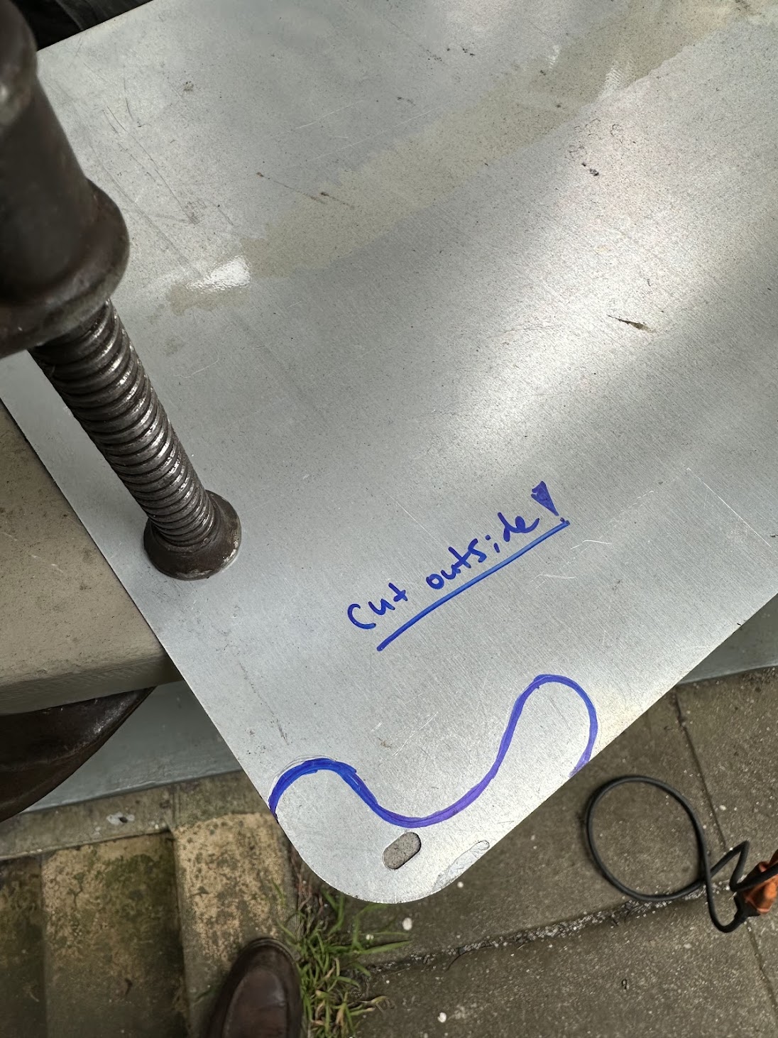

    as fun as it is to watch you solve problems with what you have, it makes me want to gift you a welder and a plasma cutter. :D:D
    did you cut this out by drilling a series of holes in a line?
    your patience knows no bounds buddy.

    A time honored method! That's how I did the radius on my AV8 transmission mount. Drill baby drill...

    I thought the same but I think it’s edge marks from a cut off wheel in a grinder.

    Hey Joey, as ever, I love the great shots, close up of various elements in your shop and the cool vintage things that often appear.
    So yes indeed, the vintage scissors caught my eye, because I have a pair that are very similar, the brand is "KLEENCUT" as you can see on my pair.
    I have had these for decades and they still cut very precisely!

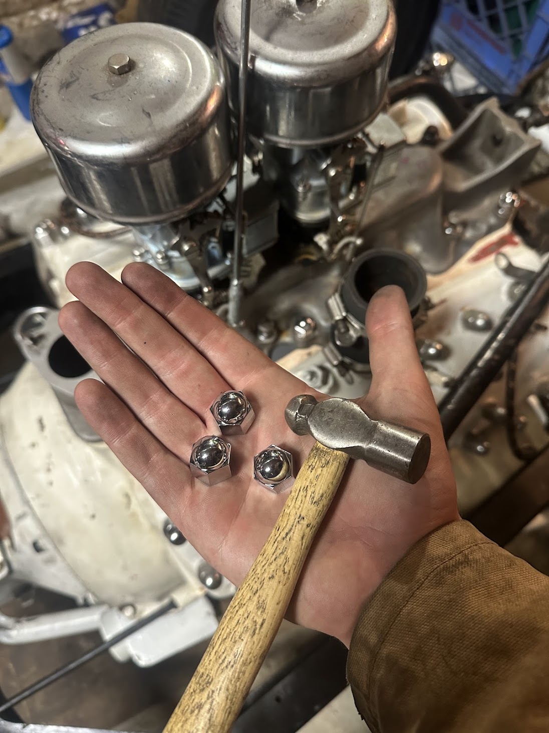

    My reward for getting the intake torqued down? Chrome acorn covers. Acorns that gave me grief were given a small tap with an even smaller geological hammer (that we once used to split geodes).
