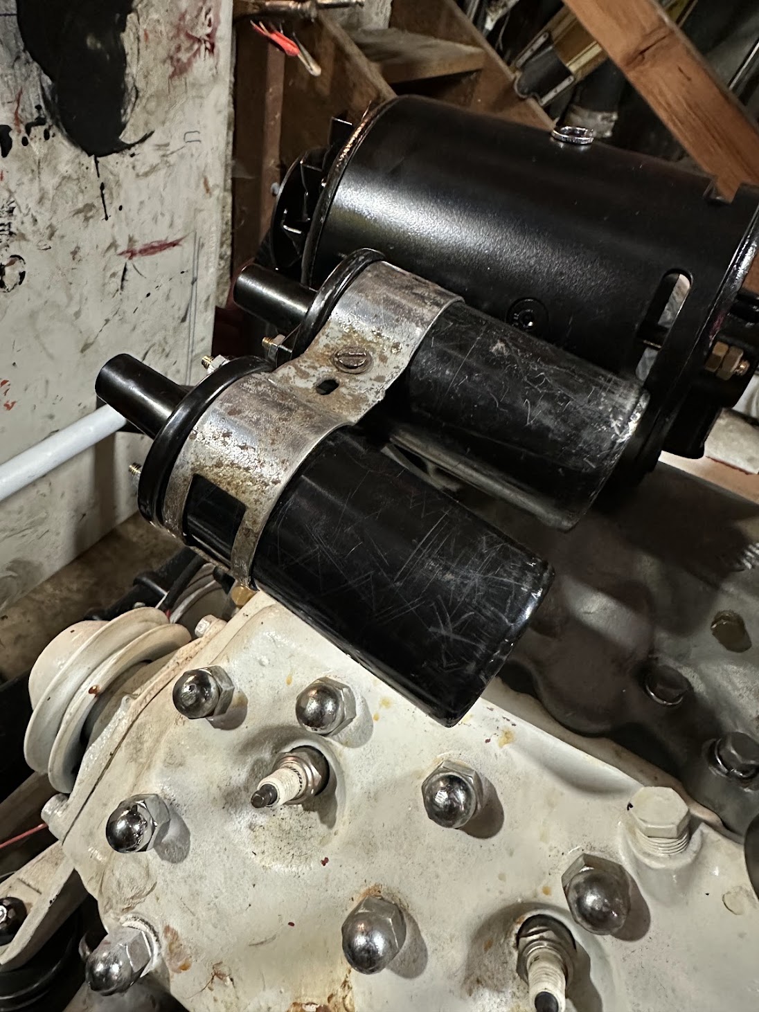

    Next, I focused my attention to the coil bracket. Longtime readers may recall my killer, old chrome dual coil setup. Well, when I got it mounted, I realized that it would simply be too flimsy with the weight of the coils. That said, I loved the look.
    With that out of the question, I went back to the drawing board. While I was considering this configuration, I splurged for a pair of El Cheapo coil mounts mainly for the chrome canister wraps. When they arrived, the wheels started to turn.
    The end result is painfully simple—take a stock 1940 Ford coil bracket, elongate one of the holes, trim the trailing edge of the bracket and find some vintage hardware to tie in with the modern pieces.

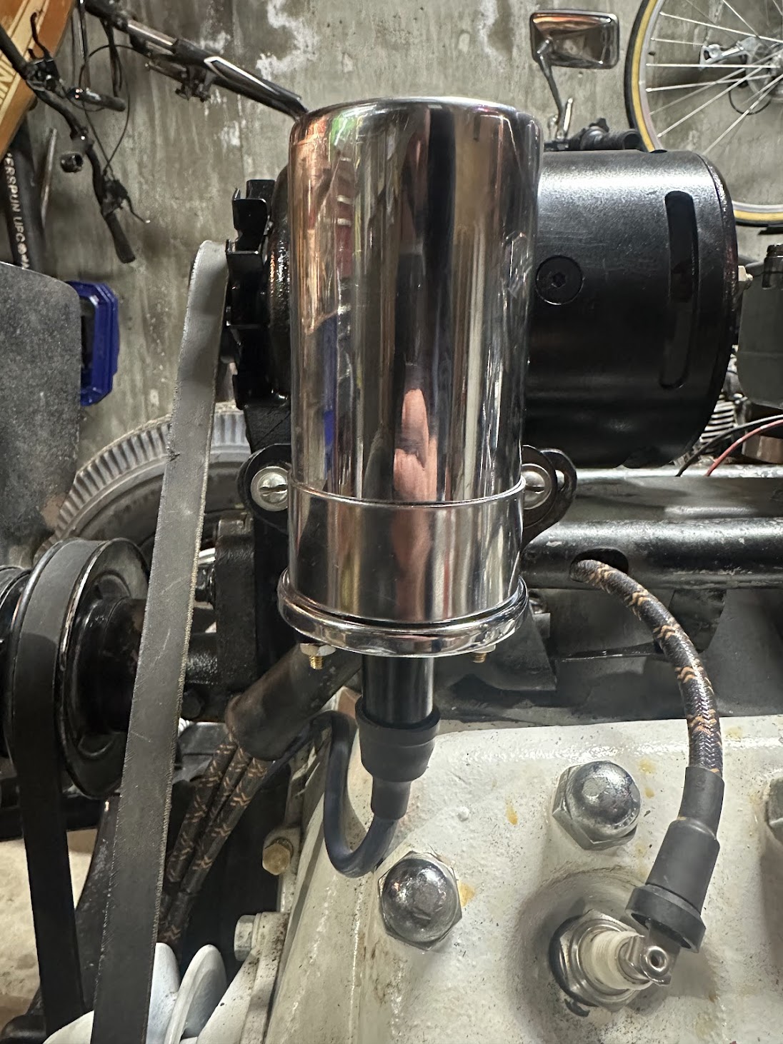

    Bolts in the stock location, and is very sturdy. With the success of that mini-project, I proceeded to install the PowerGen, belts, and fan. More details to share, but that's where we'll call it for the night. Thanks again for following along!

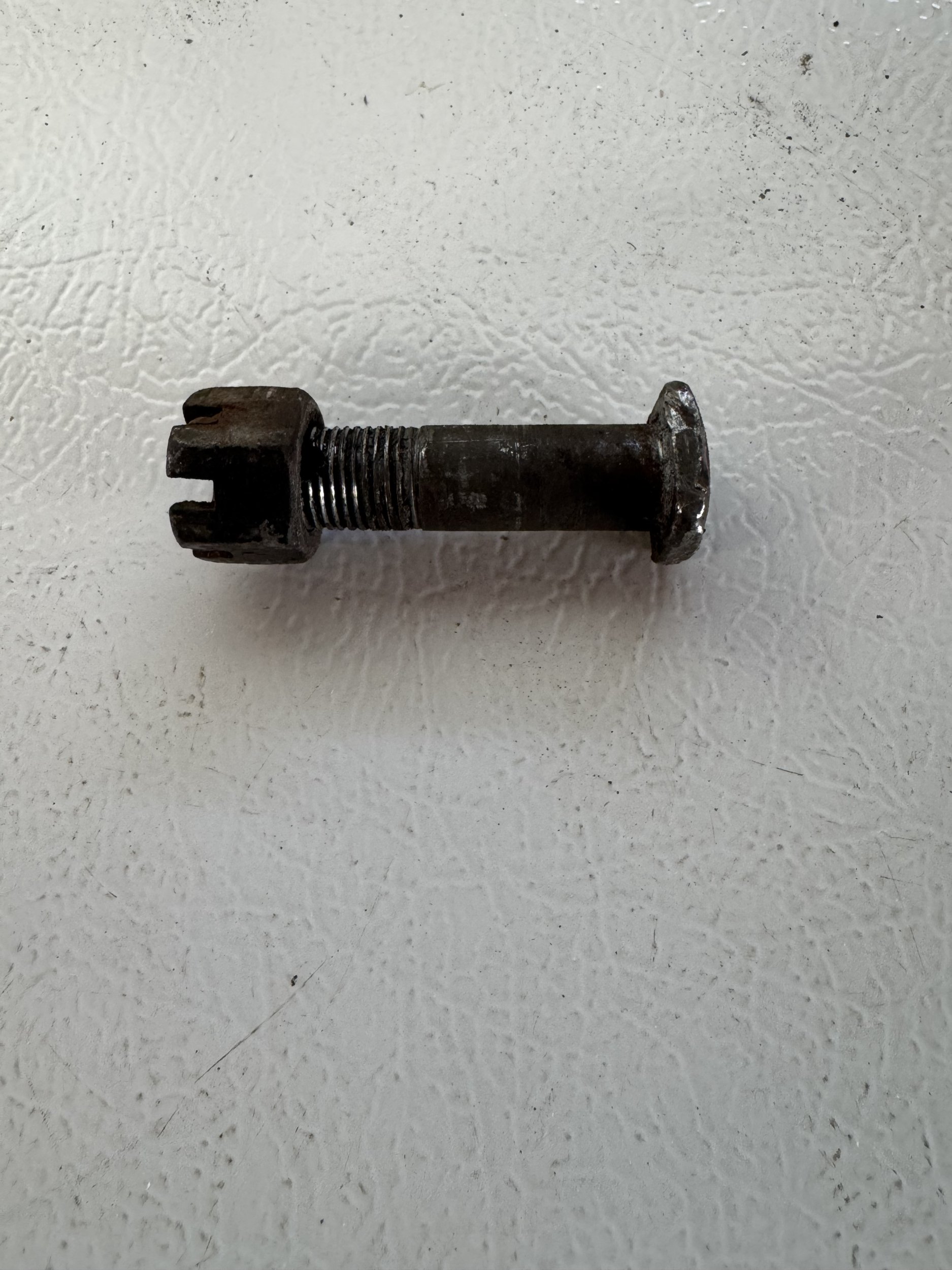

    Still looking for one of the long bolts? I have a couple that I won’t be using IMG_4711.jpeg

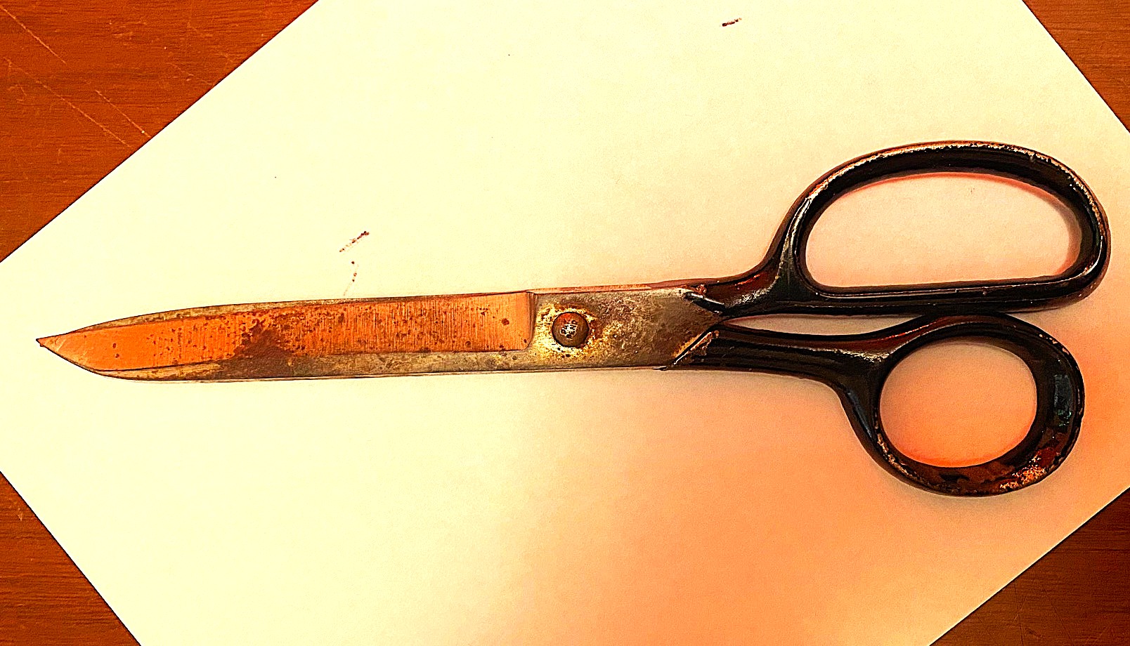

  6. J.Ukrop
    Joined: Nov 10, 2008
    Posts: 3,664
    J.Ukrop
    SUPER MODERATOR

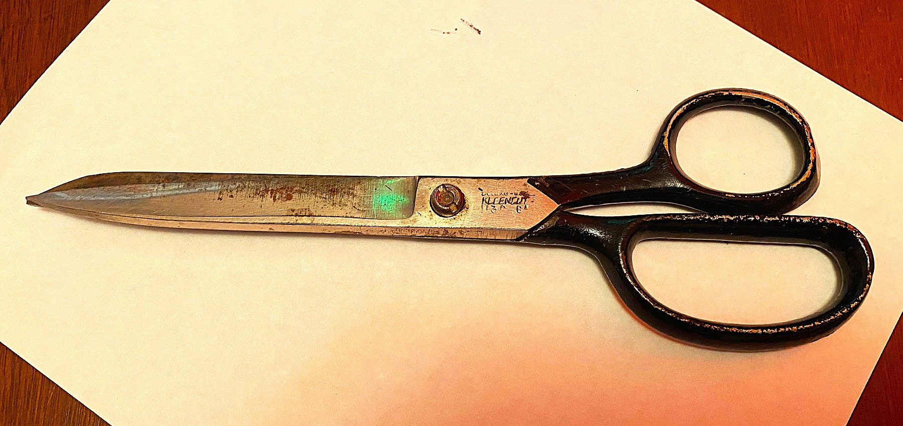

    Thanks, Trevor. I'm doing everything I can to do things as correctly as possible. We'll see how it does out on the street soon.
    Thank you, guys! I've been having a ton of fun wrapping up these little tasks that will transform this thing from a mockup into a functional vehicle. I do wonder what summer of 2020 me would think of this ch***is.
    Nice sheers there, Dennis. I'd say they're a cut above!

    Thank you to everyone who reached out about the bolts. I have a set on their way, but I'll reach out if they fall through. I've said it many times and I'll say it again—without you guys, this car wouldn't be happening.

    A few small updates. First, the coil setup was bugging me for a couple of reasons. I probably could have lived with it, but the fixes were easy enough.
    The cheap mount was looking too cheap, so I went ahead and painted the mounting tabs black to match the modified 1940 Ford bracket. I also ditched the Phillips clamp screw and replaced it with a flathead br*** one. Oh, and see the coil? I subbed in a chrome one because I am an aspiring street rodder.

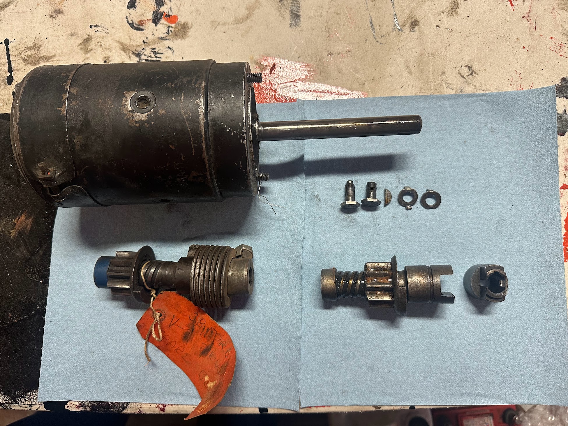

    Next, I tried my luck at installing my first flathead starter Bendix. The original Bendix on this starter ended up on the Hartley's A-V8 after theirs broke on the mean streets of San Francisco. IMG_3610.jpg
    Being the cl*** act that he is, Jeremy sent me an NOS 1938 Ford starter Bendix ***embly. IMG_9138.jpg

    The whole process was very straightforward. Once it was back together, I tightened the anti-chatter rods and put the cotter pins into play. Having the starter in position will allow me to finally put on the p***enger side header.

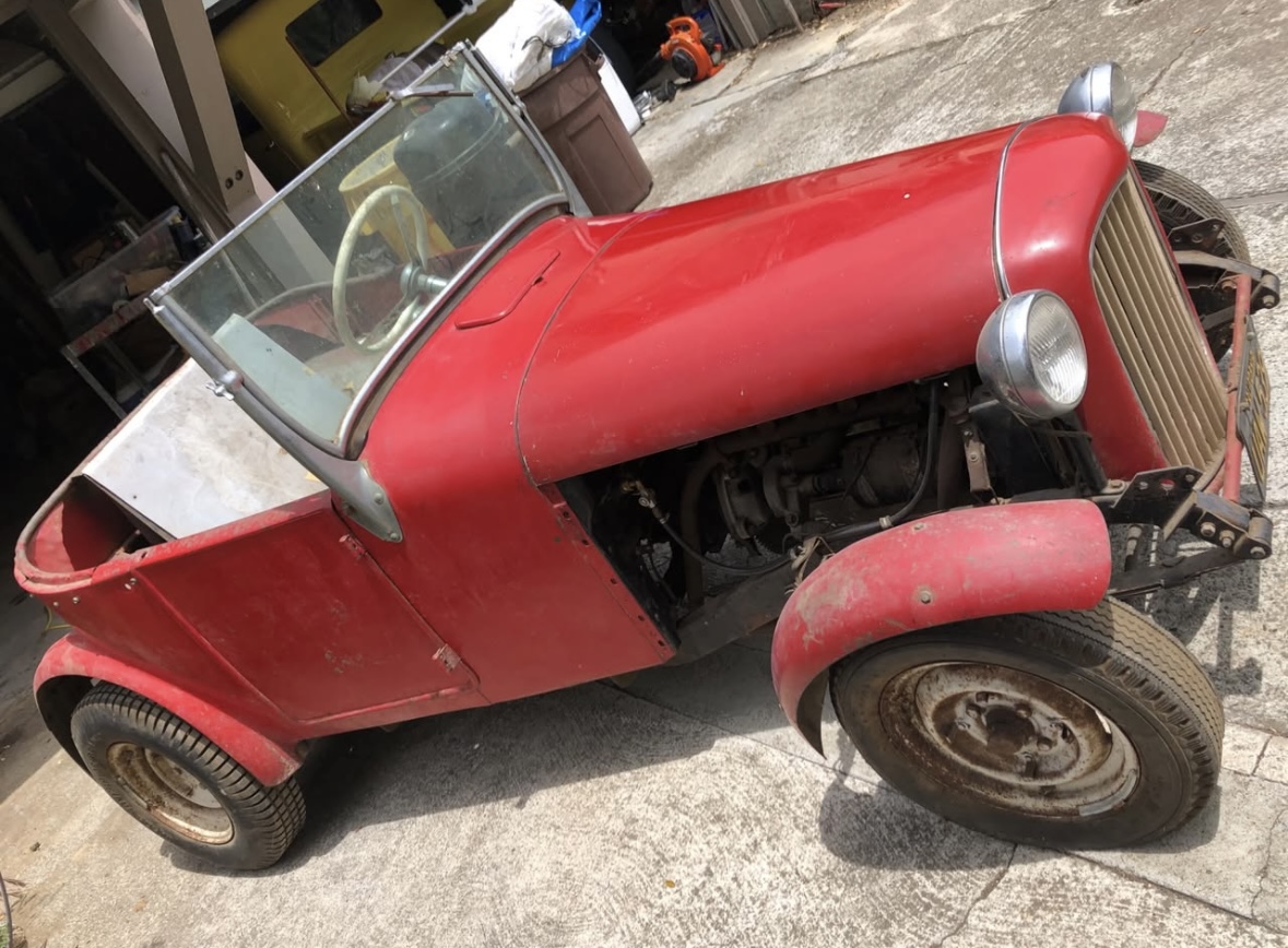

    First, I almost bought this Crosley-powered Model T roadster for $2,500 on Sunday.
    It's one of the neatest survivors I've seen in a long time.
    It's an amazing source of inspiration for my car, from the fit and finish to the detailing. I'll share more about it in my Friday Jalopy Journal column.

    That Crosley Rod is neato, but between the price and paying for storage, it would be a big setback to the A progress.

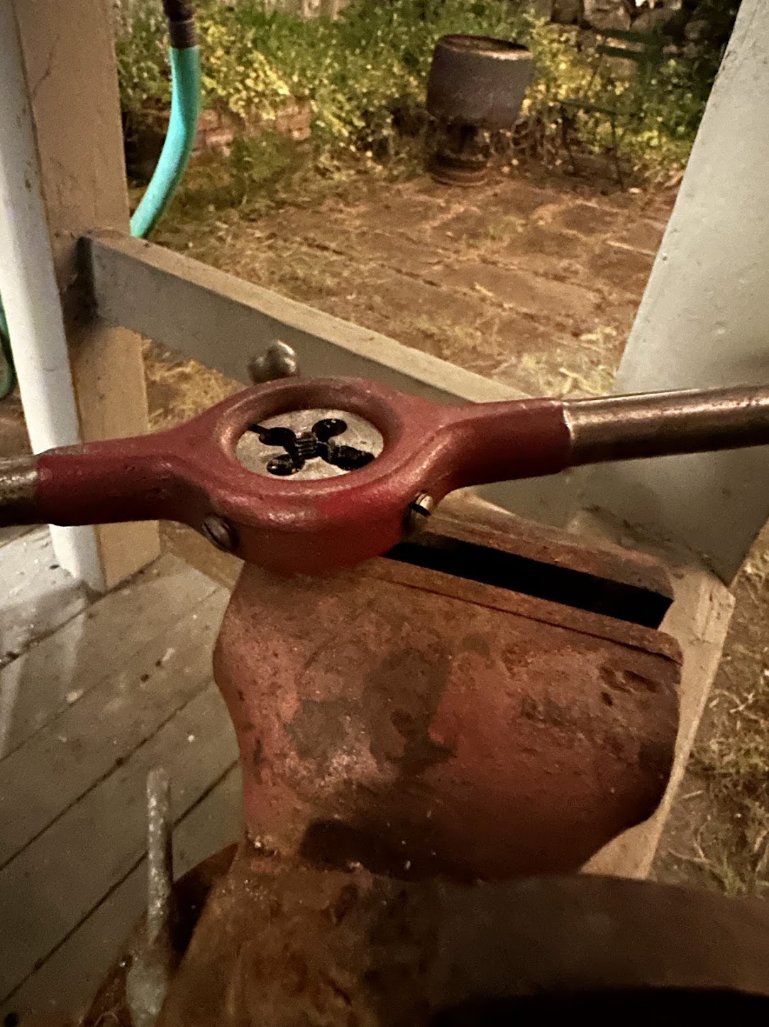

    Back in the backyard, I broke out the die again. I panicked for a second that it wasn't the right thread but, after a few rotations, I knew it was going to work just fine.
    I don't know the last time this had a nut on it. (And don't worry, a br*** nut is en route to the Terrace.) So, that concludes tonight's task. No update is too small!

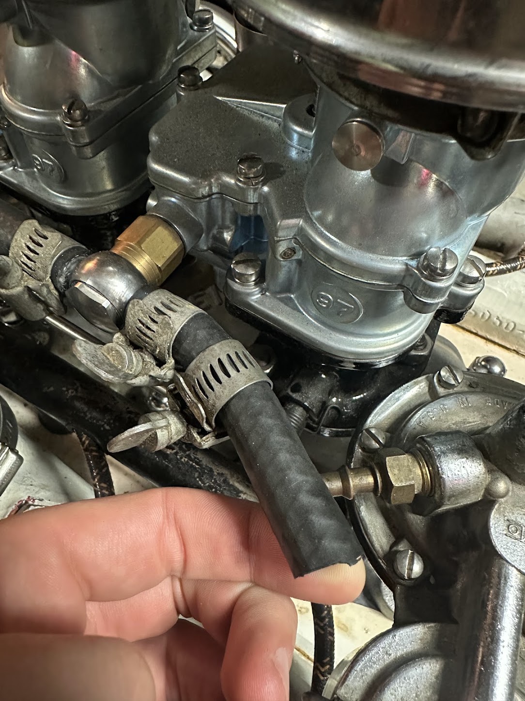

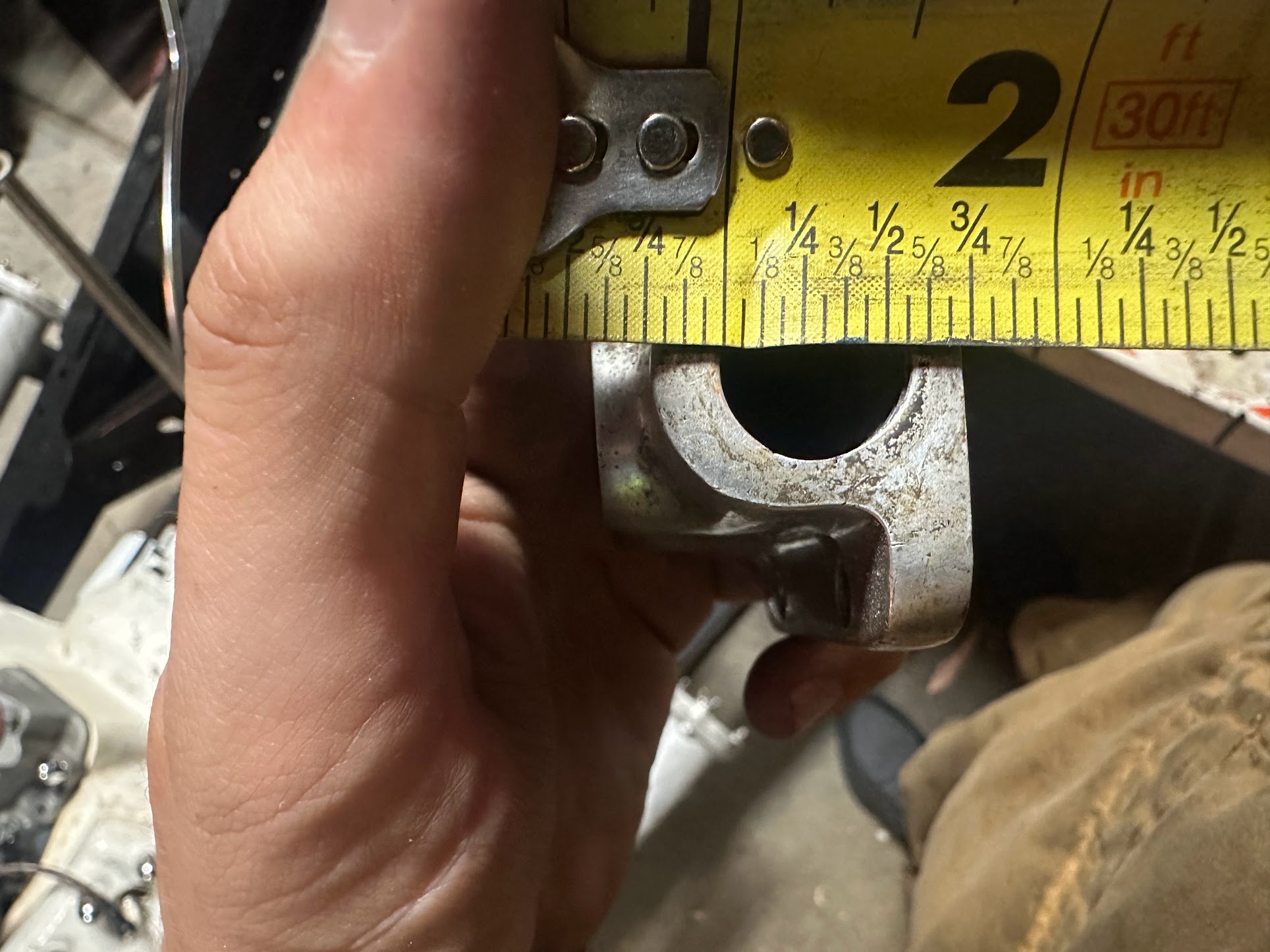

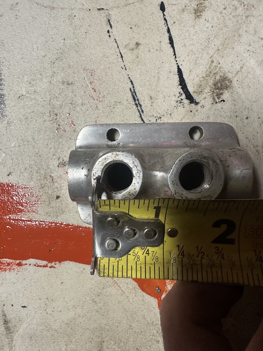

    Two questions for the group to close out the night: IMG_9235.jpg
    Do you guys have a preferred rubber fuel line? This kinks pretty badly going to the fuel pump.
    Also, I know it's been discussed here before, but do you have any good resources for fuel fittings? IMG_9116-1.jpg

    For fuel hose I've been using Gates Barracuda.
    You may find it to be stiff, but it is quite compatible with alcohol laced gasoline.

    I just always went to a well stocked auto parts store for fittings. As far as your linked line I’m thinking there has to be pre formed fuel injection lines that would fit the bill with a little t*******.
    or is that fuel pump “clock able”?

    Yeah, I don't know if there were angled vintage fittings, but that short section between the 2 fittings with low pressure is going to warm up and fold. Check vintage aircraft stores, they may have something.
    This would have to tighten into perfect alignment and looks modern.

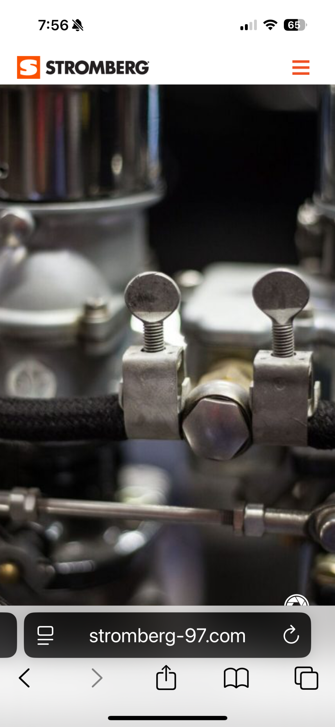

    I’ve always liked the fittings you have with Wittek clamps and braided fuel line. IMG_4737.png
    enloe, Six Ball, Outback and 2 others like this.

    Man thinking about it and looking back at it a few times part of the problem is the length of the barbed fitting coming out of the fuel pump but I don’t see an easy way around that.
    im gonna change my vote to making hard lines. By the time you find the mystery pre bent hose, or machine Shorter barbs, or find a fuel pump you can clock you could have bought to fittings that you might already have in a bucket 4” of hardline and have been two tasks and a slice of pizza down the road

    Secondly; I don't see the need for hose going from the pump to the bowl inlets, hard line would be viable since there is no movement between the pump and the carbs. You could probably skate by with copper lines since the issue of work hardening the metal would not be too big of a deal, but the fancy copper/steel brake line would eliminate that concern entirely and still look the part.

    I don't know, but I am thinking a banjo fitting off the fuel pump, it looks like it is a male flare?
    Good thought...I bet the top can be removed by removing the diaphragm screws and clocking.
    Br*** fittings are getting harder to come by...refrigeration or hydraulic supply house...
    then there is McMaster-Carr
    I've had stainless, flex lines made up at the hydraulic hose store for the fuel block to carburetors. I'll see if I can go snap a close up
