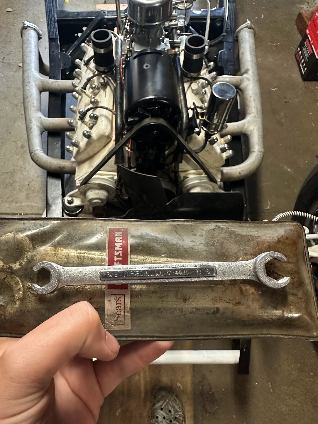

    What a whirlwind of a weekend. It was filled with hot rodding on Friday, Saturday, and Sunday. I'm leading with a picture of this vintage Craftsman brake fitting wrench because I thought I mislaid it. Come to find out it was in the top tray of my toolbox the whole time.

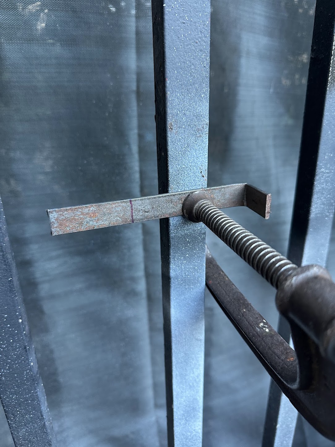

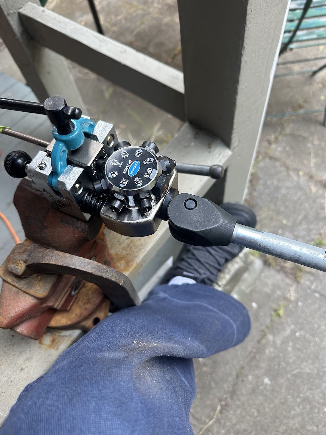

    Back at the house, I bent the new brake line that will slip under the radiator hoses. Backyard hot rodding. IMG_9462.jpg
    And front door hot rodding too. Here I used the school's fence as I created a brake line support tab.
    Oh, and the vise too.
