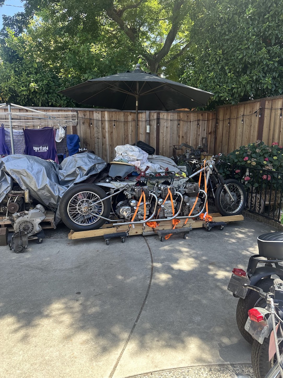

    It's Sunday night and I'm exhausted! On Friday, I was able to pick up my rear wheels, which is a step in the right direction. Then, on Saturday, Yama and I went vintage motorcycle hunting.

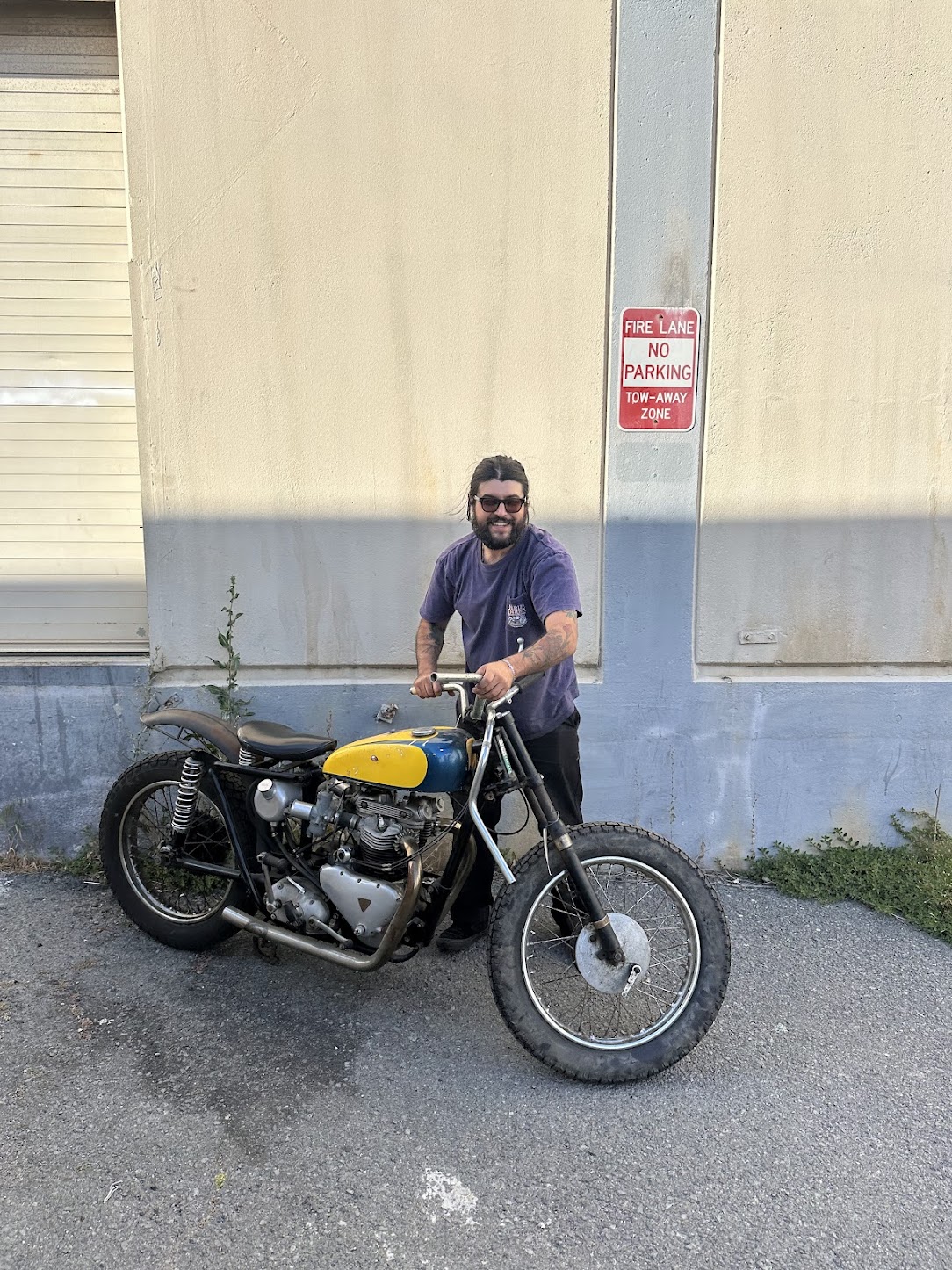

    An old hot rodder/motorcycle racer in San Jose had passed away, and Yama was helping the family get some of the machines ready to sell. In addition to the two-wheelers, he had a T-bucket and a pair of 1928 Model A pickups. From the stories we heard from his wife and son, he was a talented builder and mechanic who loved to take on projects. IMG_0226.jpg
    Like this one, for instance. He also had a twin-engined drag bike that was featured in Hot Rod Magazine in the early-'60s. It was residing in their living room until about a week ago.
    In their effort to clear space, they offered to sell Yama and I a few bikes. Yama knew I have always wanted a Pre-Unit Triumph. So, with a little bit of convincing, he and I now have a pair of TR6s. His is the desert sled pictured above, and mine is a hot rodded 1957 nicknamed "Ol' Yeller." The paint matched the previous owner's RPU perfectly. In retrospect, I should have taken a picture. Chev2.jpg

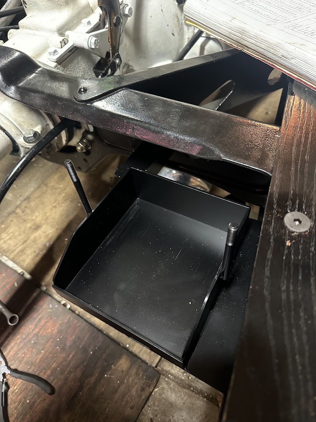

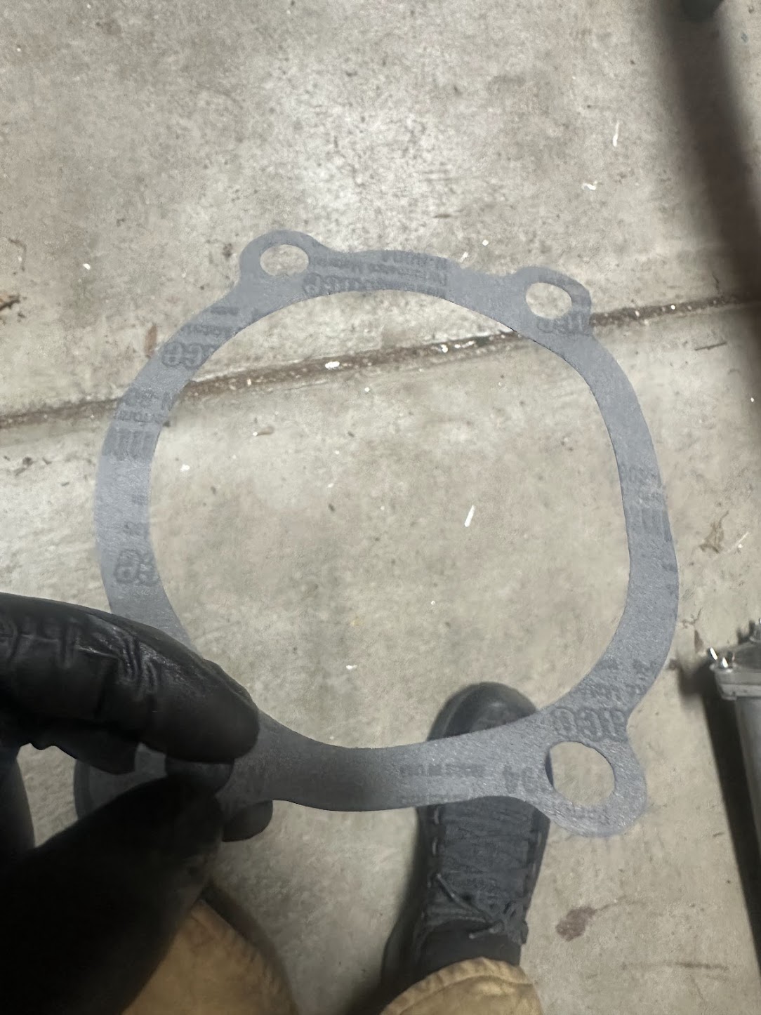

    I only had a couple hours out in the garage tonight, but I ended up getting more done than I had originally planned. For my first order of business, I finally installed my battery box. That meant drilling one hole in the frame and tightening all the hardware.
    Next, I focused my attention on the clamshell. It came to my attention that I had forgotten to install this gasket. IMG_0313.jpg
    I wasn't looking forward to taking things apart to get it on there, but I made it happen. Hi-tack gasket sealer should hopefully seal the deal. Once that was completed, I torqued everything to spec and installed cotter pins.

    I'm curious of the clam shell gasket location. I’m guessing it’s the forward face, does seal against the trans or the mount?
    It’s my first time seeing this gasket so I'm curious if it’s unique to the 32 style mount or I’ve just been leaving them out all this time lol.

    Thank you! It seems as if "a few minutes" or "one quick thing" there ends up being a full night of wrenching. These days, that's not such a bad thing.
    The gasket seals against the rear transmission mount. I think it's 1932 specific, but don't quote me on that.

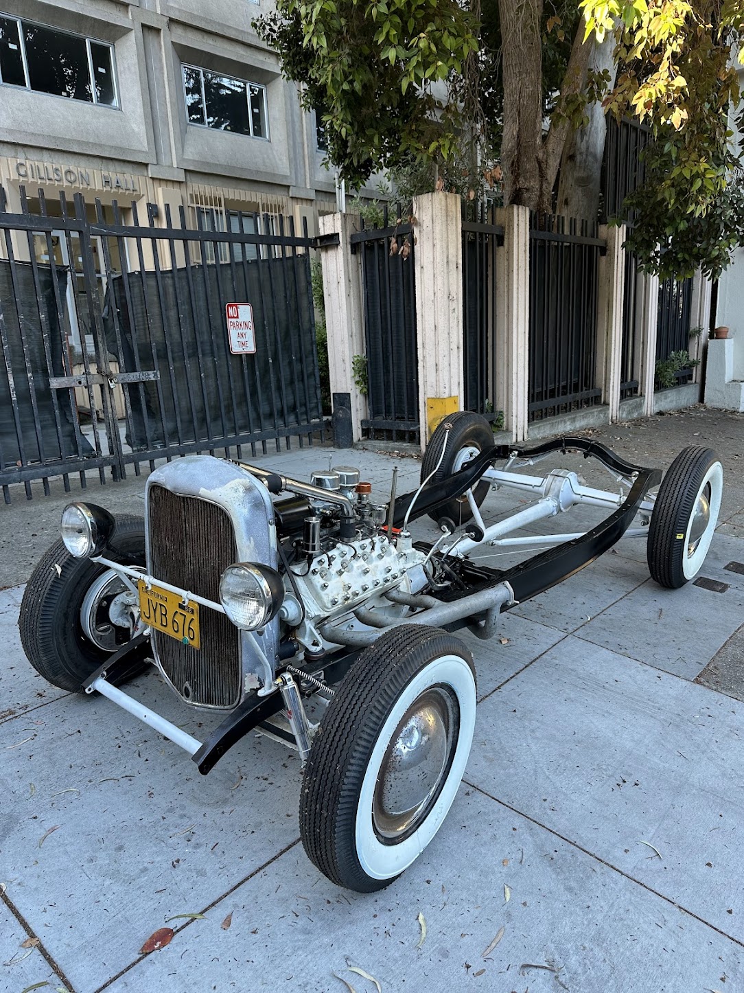

    I took a step back to look back on how far we've come—and then I got straight to work. Tonight's task was super straightforward and much like ones I've discussed here before.
    Torque, cotter, repeat. These are the steps that nobody ever talks about but are necessary pieces of a project like this.

    There should be two of those gaskets, they go on either side of the inner housing cap. That’s the bell that the torque tube pushes against. Same on all rear ends 32-48, the outer housing cap then slides up to it, with the 4 bolts. Make sure you have the inner housing cap in there.

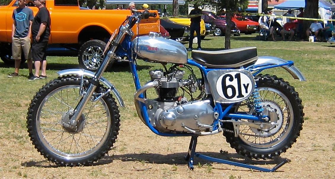

    I’m so happy for you and Yama on your Pre-Unit score. Need a photo of “Ol’Yeller, please.
    This is my 1954 Tri-BSA, nothing like a roadster and Triumph IMG_2472.jpeg IMG_2472.jpeg

    Oh Wow, that bike has some nice pieces and look at the oil tank. What gas tank will you run? Be nice to paint your roadster and bike to match and you’re just the guy to do it…..

    That was a biggie for a while. 61y is bad****! Yours will be soon I'm sure.

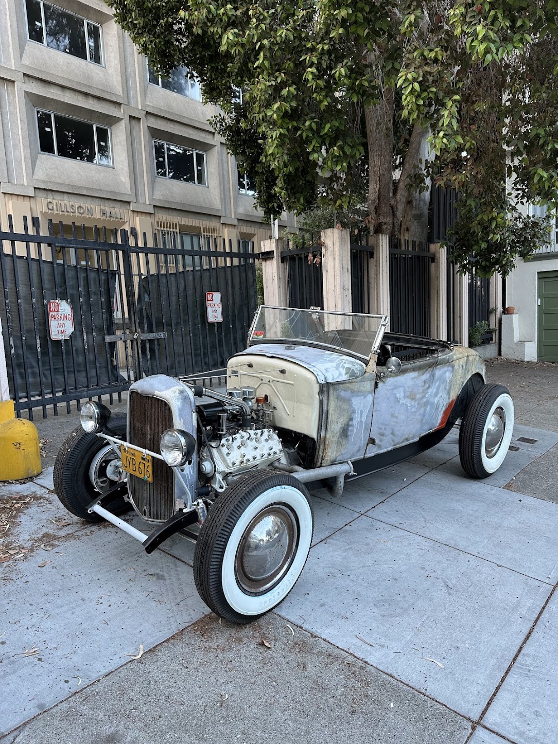

    A very fun, very full day in the sun today in San Francisco. I'm exhausted, but I wanted to post this up for the morning crowd. Ten-year-old me wouldn't believe it. Thirty-two year old me almost doesn't believe it either. I have a ton to share, but I'll try to do that tomorrow in between painting the firewall and installing the steering.
