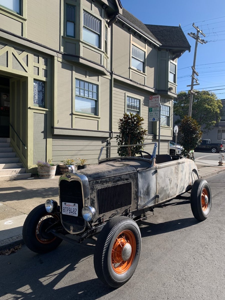

    Man...that outside photo reminds me of my roadster in front of Grandma's house in Santa Clara in '56.
    Mine was channeled, but the same young excitement was there...
    From months in her garage to a running hot rod...thanks to the older guys (Hernando's Racing Team) many parts were donated/traded to my first ride around 6 blocks...taking care to avoid the ever-present 'FUZZ'!
    Now it stirs once again...with my '27 T Touring.
    Thanks a lot, Joey...Now I'm regressing to flathead power! (the DeSoto hemi is now 'on hold'... LOL)

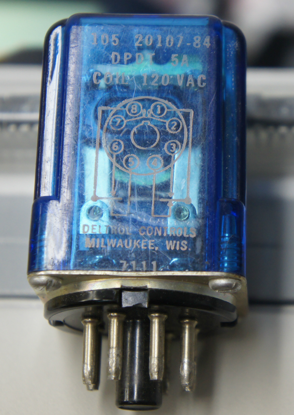

    There's lots of really neat old relays on the auxion site, here's a couple cool ones for instance (might be wrong voltage):

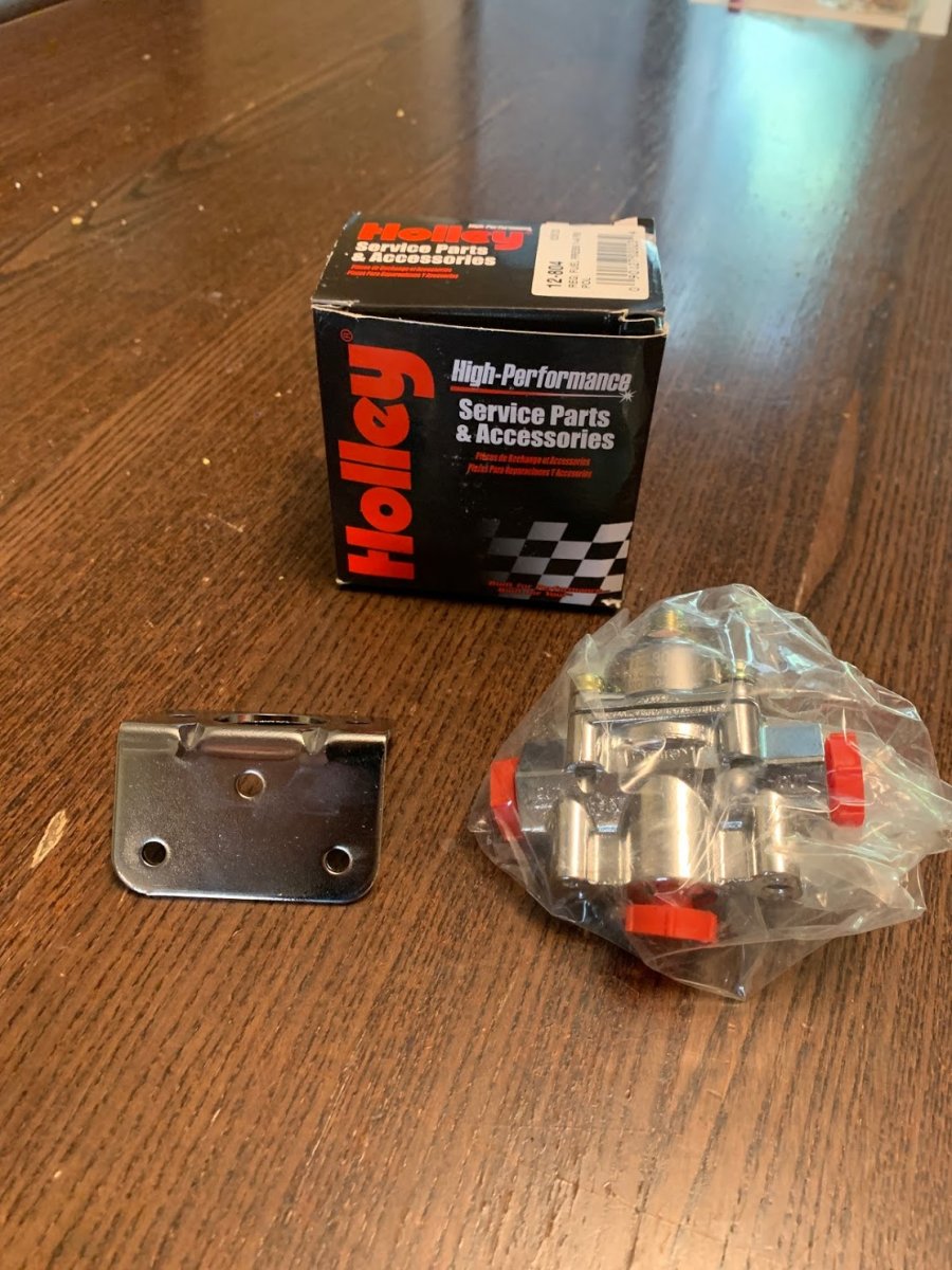

    Speaking of electronics, my electric fuel pump is on its way. My 1-4psi Holley regulator showed up, so that's good too. IMG_1971.jpg
    Since I'll only be running one carb, I'll attach my fuel pressure gauge to the regulator. It will be mounted inside the firewall, while the pump will be located down low with some sort of heat shield (tbd).

    These two are pretty self explanatory but also super exciting. It was sunny so, on my lunch break, I hopped in and cruised around the neighborhood, past the college and over towards the heart of the Inner Richmond. The car ran great other than me thinking I somehow messed up the electronic ignition by leaving it on too long with the engine off (it ended up being fine). I took these shots in front of one of the Richmond's many architectural gems, built in 1906.
    My goal today was to work on downshifting. After studying a handful of YouTube videos, I built up the confidence to try double-clutching down a hill. And you know what? I got it. Not once but twice!
    It's pretty funny seeing peoples' reactions on the street, whether they're waving, taking photos or just smiling. While I was stopped, a gruff-looking guy came up to me and asked, "It's a 1932 Ford Victoria, right?" I'll take that as a compliment!

    Regarding the fuel pressure regulator, I think the regulator needs to be between the fuel pump and the carb(s).

    Joey, I run a Mr. Gasket 42S fuel pump on the inside of the firewall between the fuel shut off and sediment bulb. It's rated at 2-3.5psi but I think that's wishful thinking as it runs fine on the Holley 94 with out a regulator. I'll flick you a pic of the setup through next time I walk past the car.
