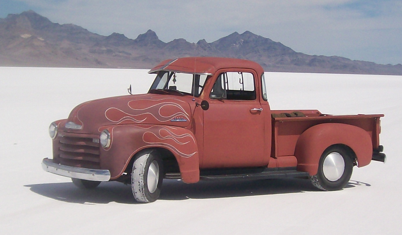

    I have 15" Olds caps on my pickup. 3 fit fine. The spring clips on the other is are a little different and it is a ***** to get on. Tens of thousands of miles on freeways and dirt roads and I'v never lost one. The only hubcap I've ever lost in 65 years was a screw on Moon. It went out into a corn field in Texas and looked like a UFO!

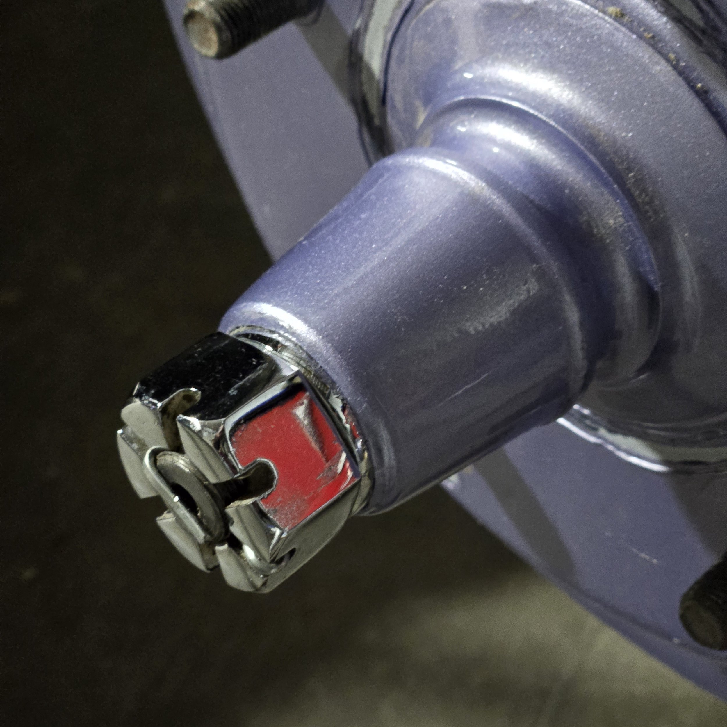

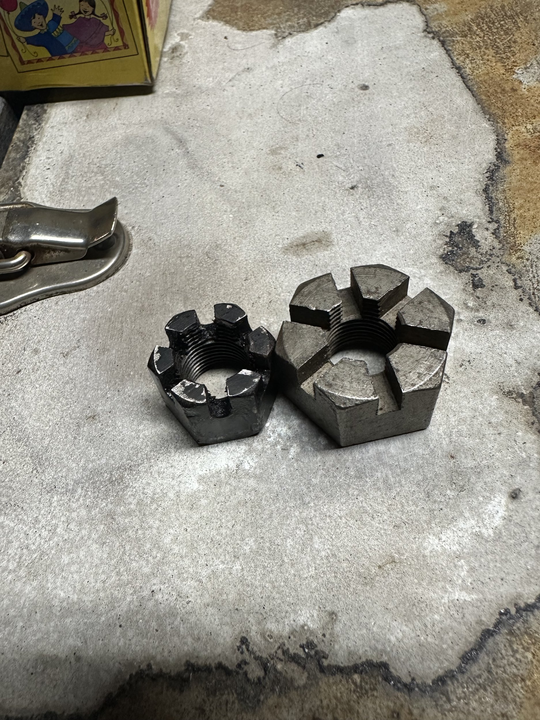

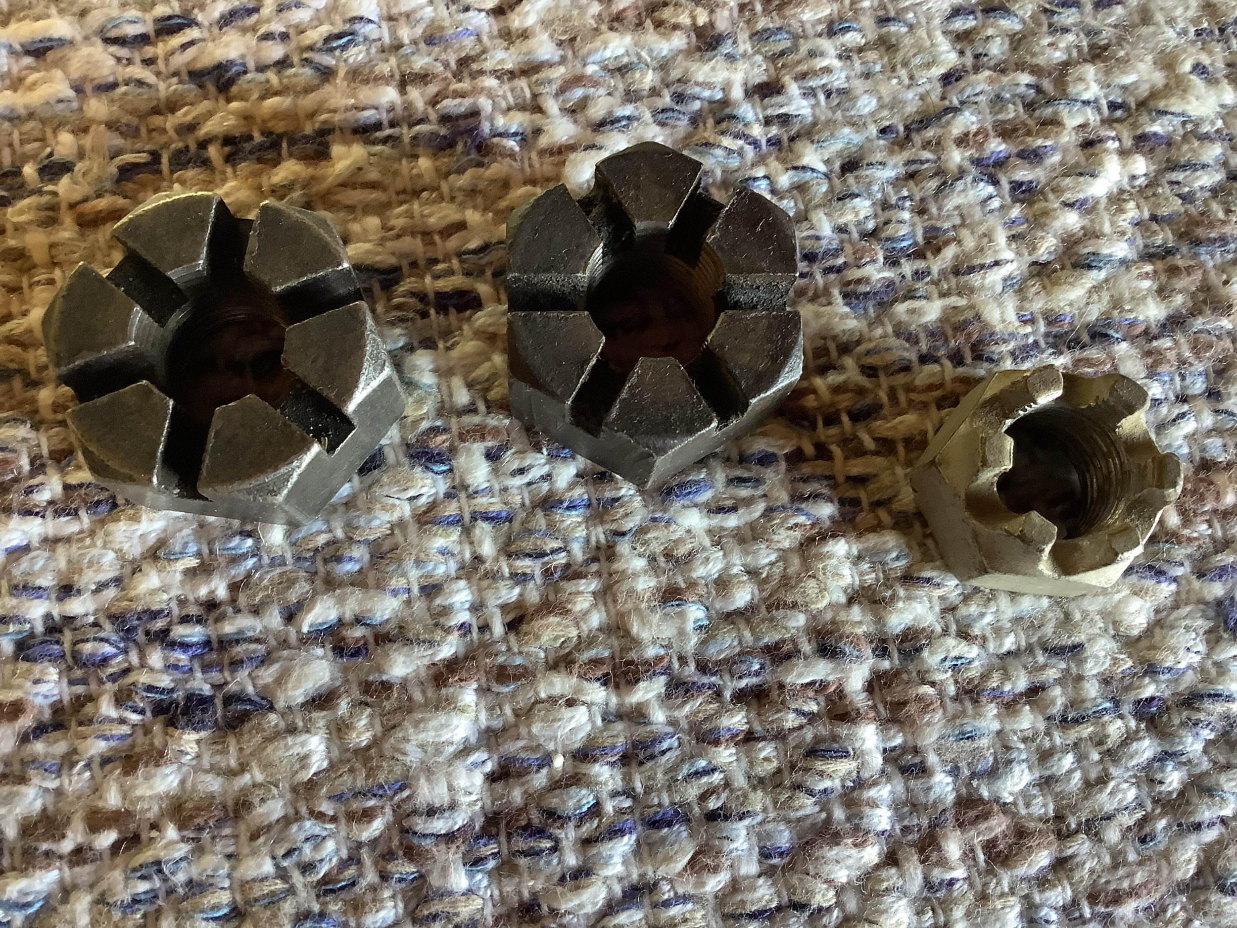

    Thanks for the wheelcover advice, guys! No big updates from the 5R bus this morning, but here’s a little comparison between the reproduction axle nuts and the original Ford components. IMG_0801.jpeg

    Man that’s waaaaay off!

    The 15/16" hex were used pre-war, the 1-1/4" hex were post war and became popular with hot rodders, as they were heavy duty. I use them just because.
    winduptoy, Outback, Six Ball and 3 others like this.

    I have the 15/16” on my ‘40 rear. I bought new felts and one new washer (missing)

    Joey, those are reminiscent of the old EELCO racing nuts, back in the 50’s. This is a photo of an original pair. They were used for track and drag cars, for the extra safety. If you choose to run them, make sure they are 18 thread pitch, check them first before installing…..

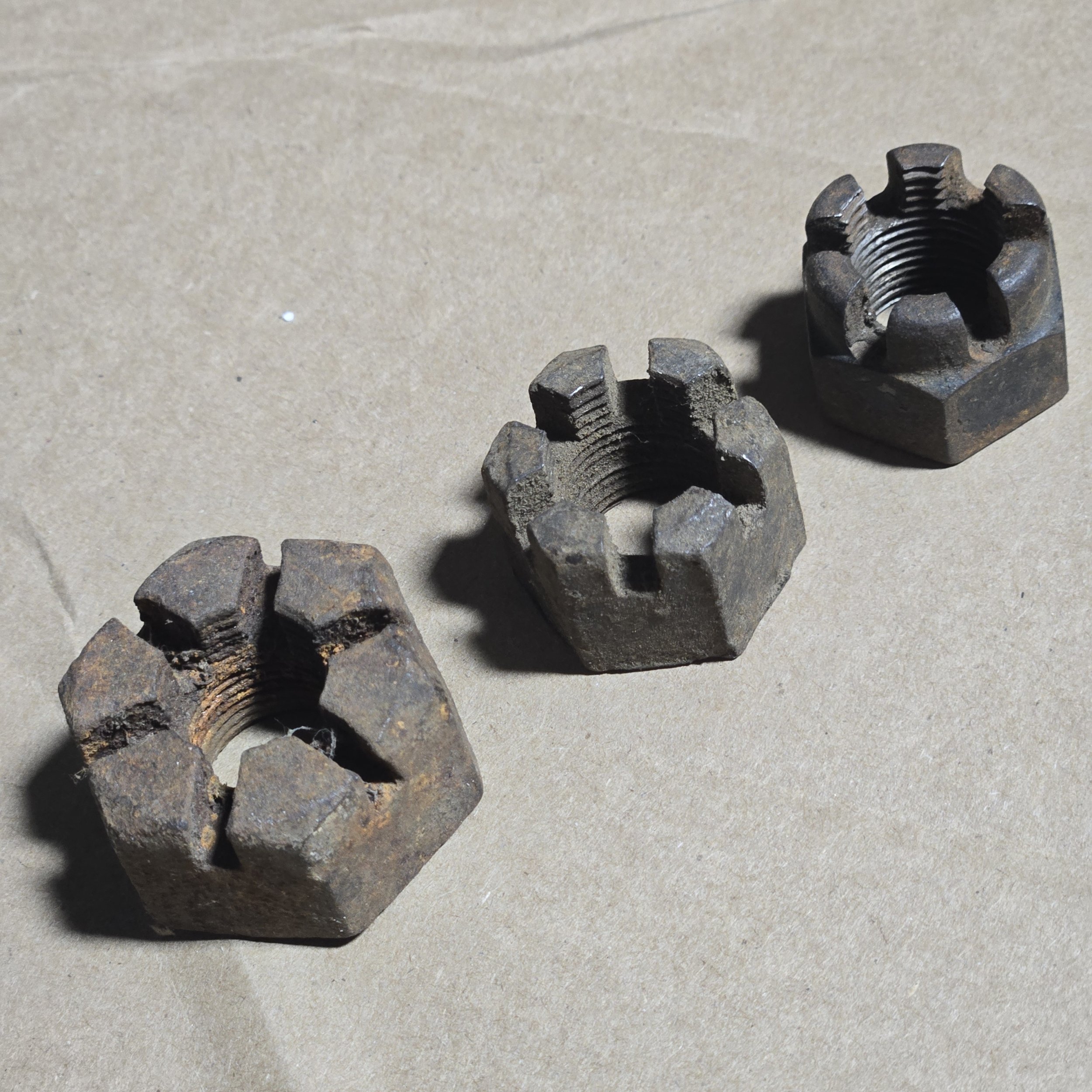

    The chrome "big nuts" on my 5w...
    Plus the 3 different varieties Ive seen.
    Far right, Model A up to 34 I think
    Middle 35-41 or 42
    left are 42 or maybe 46-48

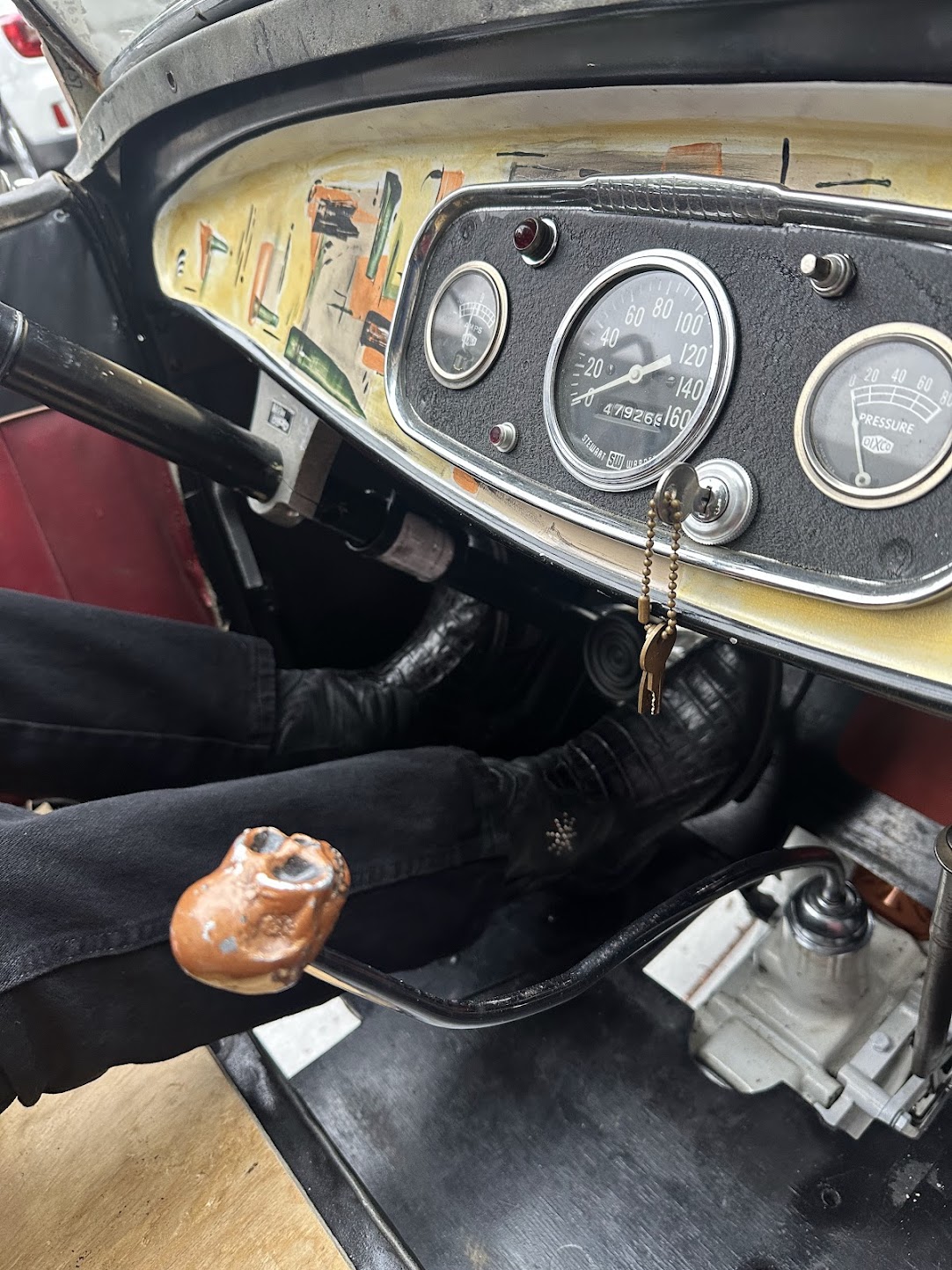

    On Thursday, I broke out my new stepped bit and got to work on the dash panel.
    After much thought, I found the perfect spot for my NOS chrome starter ****on compliments of @Hitchhiker. I have a new headlight switch on the way, so I'll share the photo of the full panel once I have it installed.

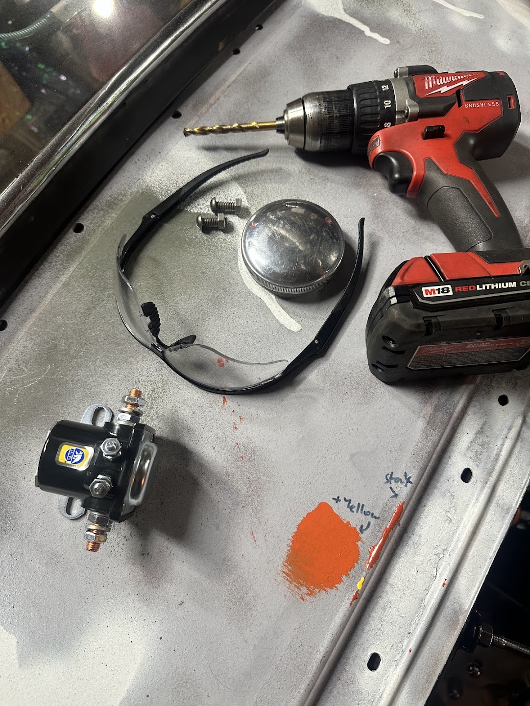

    Tonight, I dedicated 30 minutes to the starter solenoid installation and battery cable measurements. Vintage hardware from my recent estate sale haul was used.
    That's all for tonight. Who remembers when I made that stainless heater block off plate? And does anyone know what the "Z" stands for?
