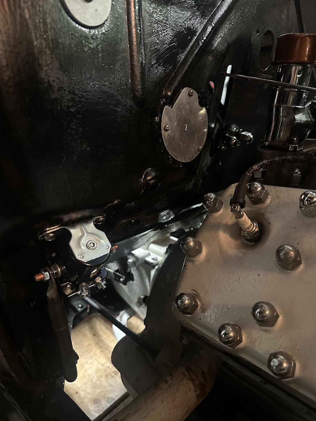

    Today I was greeted by two great packages on my doorstep. We now have wheel bearing seals and battery cable. IMG_1026.jpg
    Two of the cables have already been installed, and the starter solenoid is bolted in. I'm looking forward to getting out to the garage this weekend and making some progress!

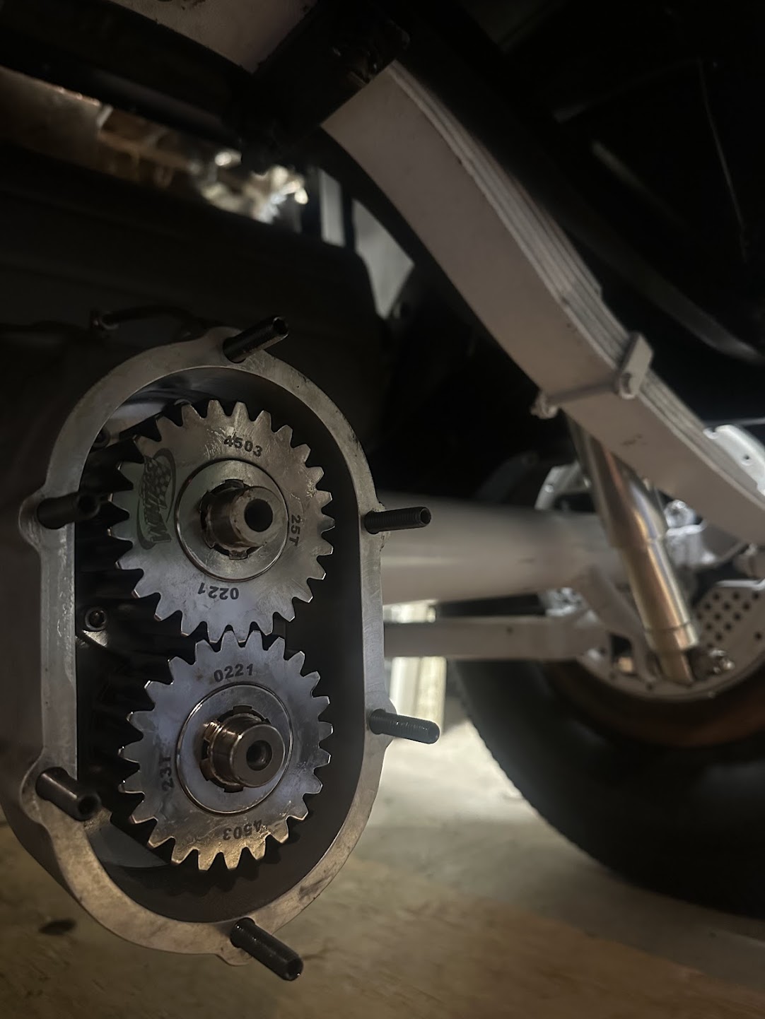

    Here's the closing shot for the night. I had to pop open the quickchange cover to see what my starting gear set will be. In its current configuration, it's a 4.11. If I flip them, it's a 3:48. I'm thinking I'll start with 4.11 because it will be a bit of time before this guy sees the 101 down to SFO.
    That's all for tonight. Maybe I'll do front wheel bearings and seals tomorrow. We shall see!

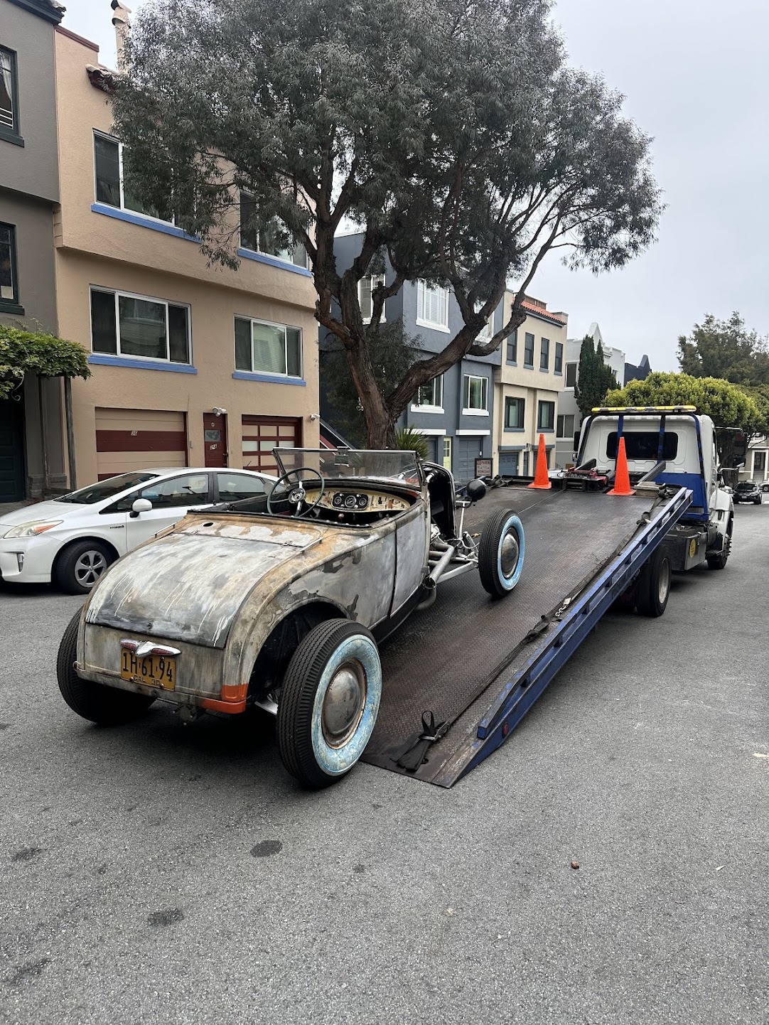

    Sidebar 220: On Hold IMG_1138.jpg Summer is always a busy time, and this year is no exception. There are many exciting things in the works, including a big move across town into my own apartment. Seeing your car on a rollback is usually a bad feeling—but not this time. As I write this, it's tucked away in the basement of my new building. It's going to take some time to get things set up over here. But as soon as I rolled the car into the garage, I realized that this is where 2.0 will have its first drive. Stay tuned.
