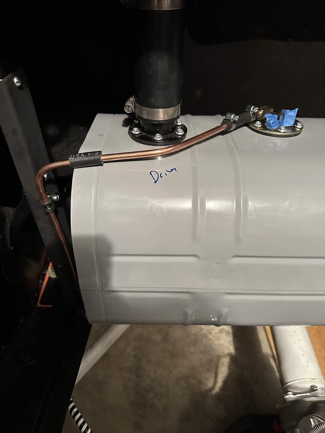

    I was able to get a few minutes down in the garage tonight.
    That meant I could bend and flare my final piece of fuel line. I'm still dialing in the mounting points and insulation (nothing has been tightened down yet), but this will be the general approach. It'll connect to the electric fuel pump on the frame rail via a rubber segment.
    You'll note that I'm using modern-style hose clamps on the top portion. Does anyone have a pair of vintage 5/16 hose clamps they would be willing to sell me?

    Joey, a small suggestion. I see it going straight from the 90 degree at the body to the pickup. I'd want a line bend between those ends so the hose will flex, rather than the straight shot compress and extend. It's probably fine, but doesn't look like how things are done.

    Is that fuel line Nicop or copper? If copper, either it will vibrate against the tank and break or eventually split. I would use steel or Nicop to prevent future failure or disaster.

    I believe he's using Nicop. He was warned early on. ;) Good eye, though.

    Hi, it is NiCopp as most recently stated in post 4934. I may be a new builder, but I know better than to use copper. Thanks.

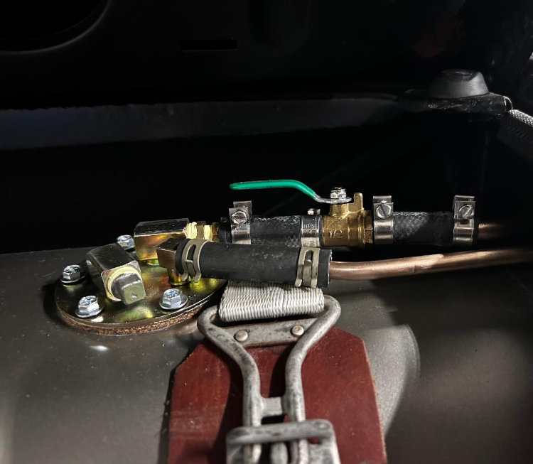

    Agree with you guys......absolutely nothing wrong with the gear type clamps historically or otherwise. That being said, if you're looking at something that looks similar to the old solid clamps and is dependable as the gear type, I use SS fuel injection clamps. They're 20 bucks a dozen on Amazon.

    Thank you everyone for the thoughtful replies and insights. @winduptoy nailed it that I was posting pictures of a work in progress, and I ended up taking @RodStRace's advice and adding another bend to the pickup line. IMG_2225.jpeg
    I'm going to refine my rubber insulator, but this will eliminate any metal-on-metal interactions.

    Really clean setup, Joe. Any tips on running the vent line, other than making it higher than the fuel filler? Also, I really like that in-line pet**** idea. Do you use it every time you park the car?

    Hey Joey,

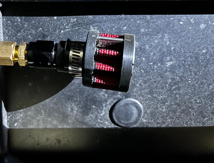

    My vent line starts off about an inch higher than the fill tube (hard to tell with the angle of the pic) and it's double looped and tucked up under the quarter panel. Then down thru the pan with a 90 that leaves it parallel under the pan floor....with a carbon impregnated filter.

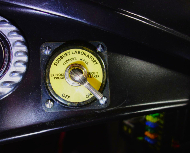

    I shut the pet**** off if I leave the car for an extended period.....just a CYA because I have my battery dis-connect on the dash - not to hard to figure out.

    Thank you, Joe. This is very helpful! I might have to borrow a couple of ideas.

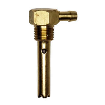

    Hey fellas....you might want to look at this. It's an "in tank" rollover vent valve. You mount it in the top of your tank. It has a steel ball that sits below the tube vent hole that's the roll over.....and a plastic ball that floats with fuel to block the vent for over fill and splash....and pulls down if there's vacuum on the tank....other wise sits below the vent hole too. That's a very crude explanation but you can contact Tanks Inc. and get the exact facts. They come in 1/4" & 3/8".
    https://www.tanksinc.com/index.cfm/...1JfAULDB9l3TL3Yx09pGmjxZIOs6ZqVhoCKiwQAvD_BwE
