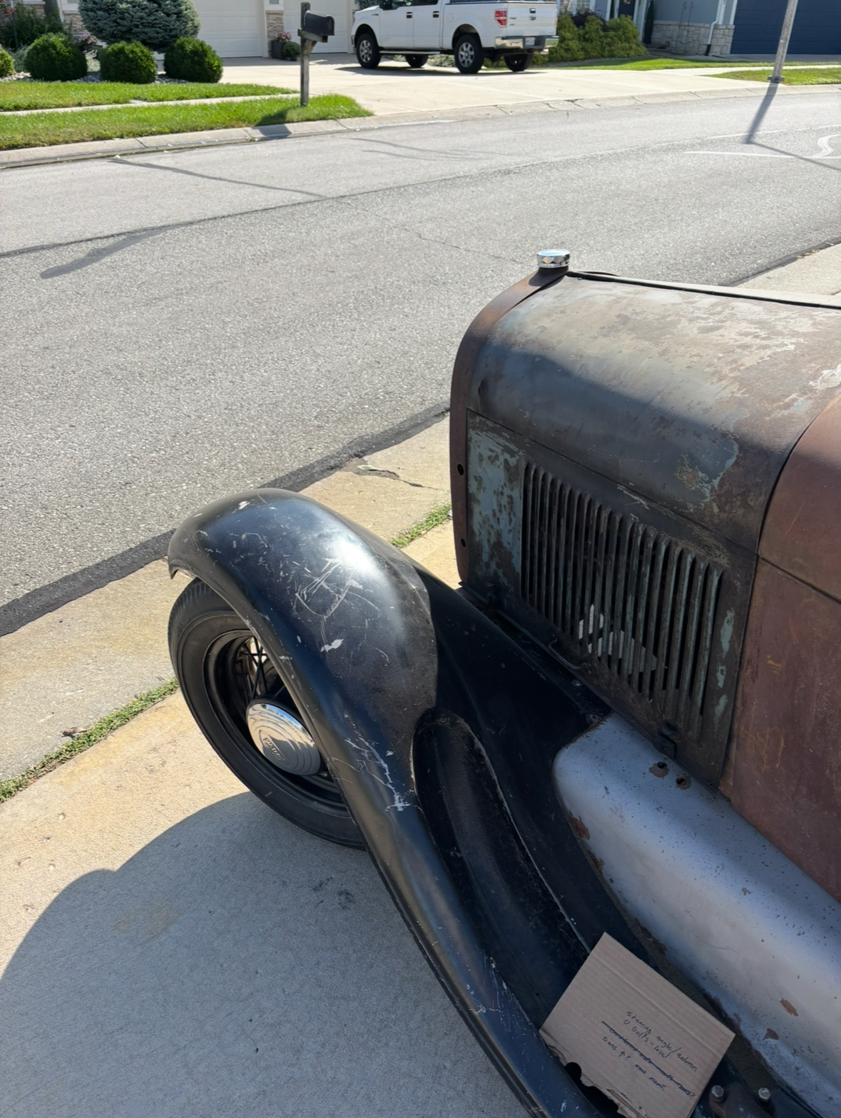

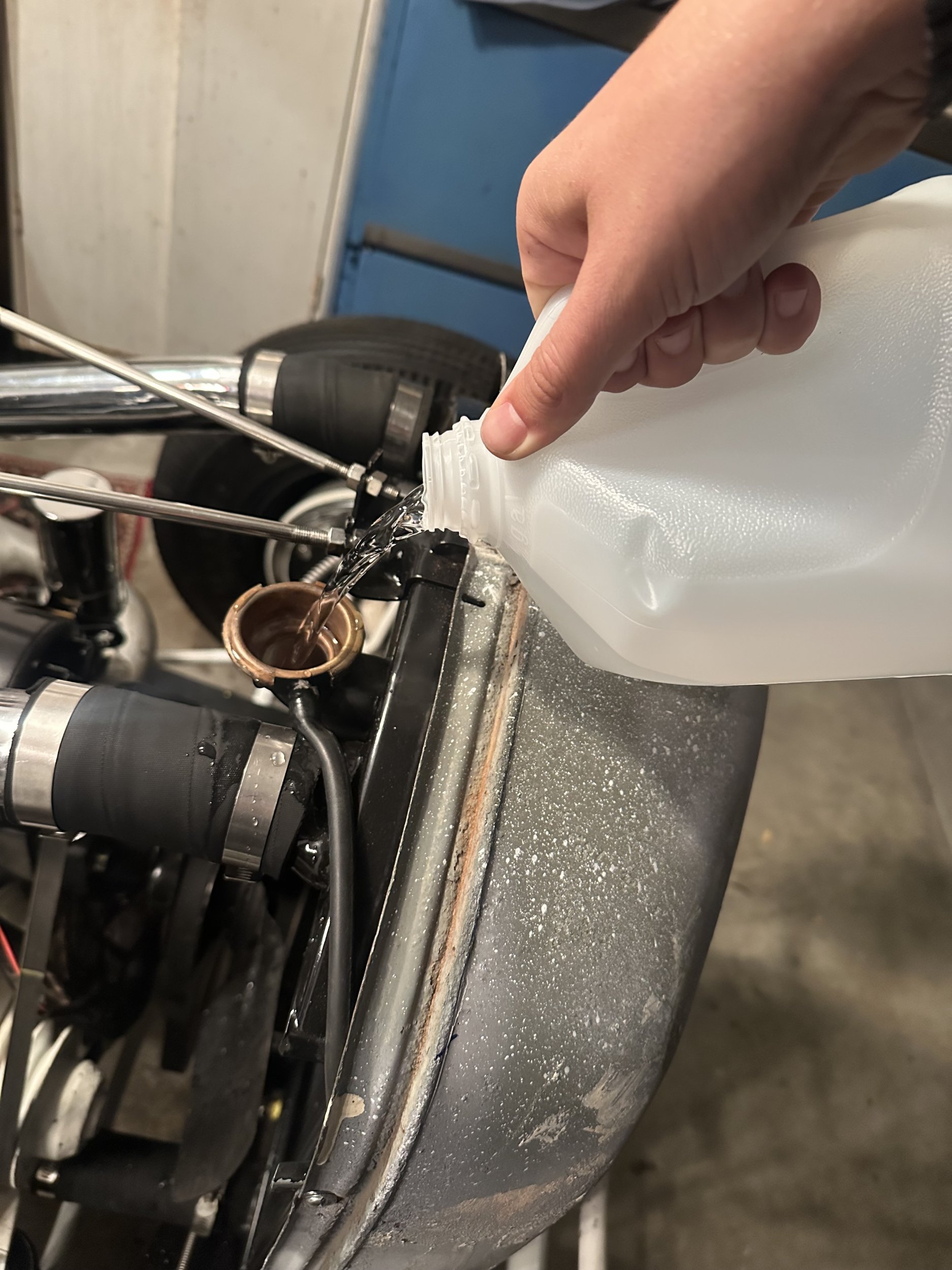

    looks good with the front wheels out on the curb! Been there recently and it got me going for sure :)
