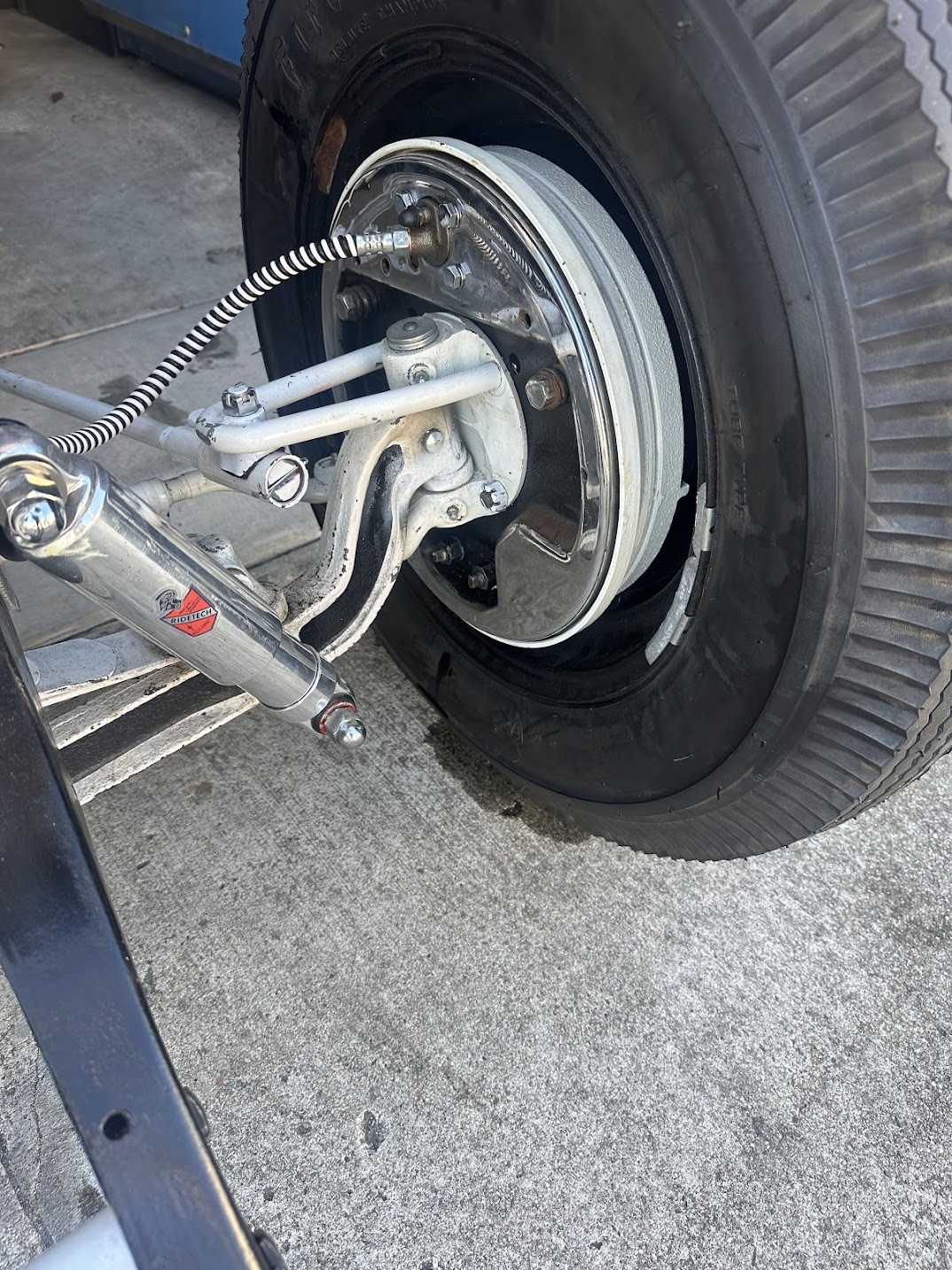

    Some of you may have seen on my Instagram, but I hit an unfortunate road block over the weekend. As I was installing my tie-rod cotter pins, I noticed some brake fluid dripping from the LF drum. Not from the hose, but from the bottom of the backing plate. My heart sank. Looks like the wheel cylinder failed—again.
    These days, I'd say I'm pretty level-headed about this project and things in general. But at that moment, I was angry. Here I have this brake system with all the best parts put together by the book and it still lets me down. I wanted to pack up the tools, close the garage door, and not think about the car for awhile. IMG_2986.jpg I wanted to, but I didn't. Instead, I just focused on other things. Like installing my auxiliary gauge cluster (compliments of @corncobcoupe). In order to do that, I had to temporarily remove my temp gauge cable, which sent water dribbling down the driveway. (Just in case you thought this was all brake fluid.)

    Sunday started with some research into wheel cylinders. I polled my friends on Instagram, and here's where they recommended I buy my new LF cylinder.
    Napa (2)
    Third Gen (2)
    CW Moss (2)
    Raybestos (2)
    Boling Bros
    Millworks
    Young’s Auto Supply
    Bob Drake
    Midwest Early Ford
    I ended up buying one from Raybestos and one from Third Gen, plus new copper crush washers. We'll see how they work.

    @J.Ukrop were they rebuilt, nos? Is brake fliud like ethanol gas and carbs these days?

    @Stogy I’ve seen wheel cylinders leak after a long time of being parked and not put threw the motions but I don’t recall seeing anything about fluid being an issue.
    Sometimes you just get skunked :(

    I had issues with a brake wheel cylinder. Felt like I couldnt get right. I pulled it apart, honed it, rebuilt it...twice....replaced it. Finally I built a whole new backing plate, and just swapped em. I just had had enough! No issues since.

    Thank you all for the words of encouragement. I'm hoping that I'll get it right on the next time around. As I type this, the front left wheel cylinder is leaking, and there's a slight weep from the right front fitting, left rear fitting, and rear of the master cylinder. Really frustrating. I read online about annealing the copper washers. I've done that for Triumph motorcycle heads and it works well. I wonder if I should do the same on my re***embly?

    Joey, the copper washers may come annealed, but easy to anneal them, anyway, to make them soft.
    I don't understand your flare connections leaking...crazy stuff...I'm sure that you are reaming the inside of the tube prior to flaring and I always use a little brake fluid for lube when flaring....

    Regarding new wheel cylinders leaking. A few years back I had a similar failure with brand new components too! Since then, I have taken apart inspected and cleaned every "New" wheel cylinder I've installed. I found machining "swarf" in that initial leaker... No problems since. Your mileage may vary?

    I had a new wheel cylinder leak, I rebuilt it, it leaked. turned out the Chinese casting was porous.

    Yeah I’d really take a good look at your flares etc. maybe take a photo? Sometimes when you’re fresh to making flares it’s easy to miss something that’s obvious to someone who’s done it a thousand times.

    Thanks, Tim! I loosened and re-tightened the left rear, but I'm not confident that it fixed the problem. It's not leaking right now, because much of the fluid has leaked out elsewhere hahah
