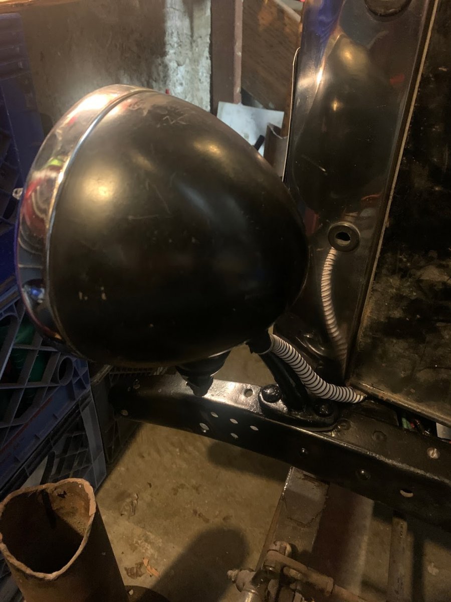

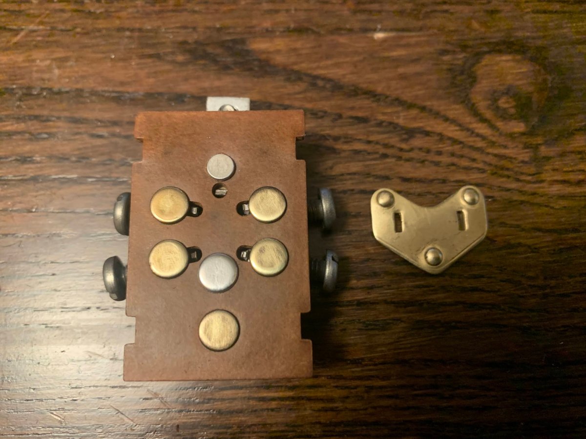

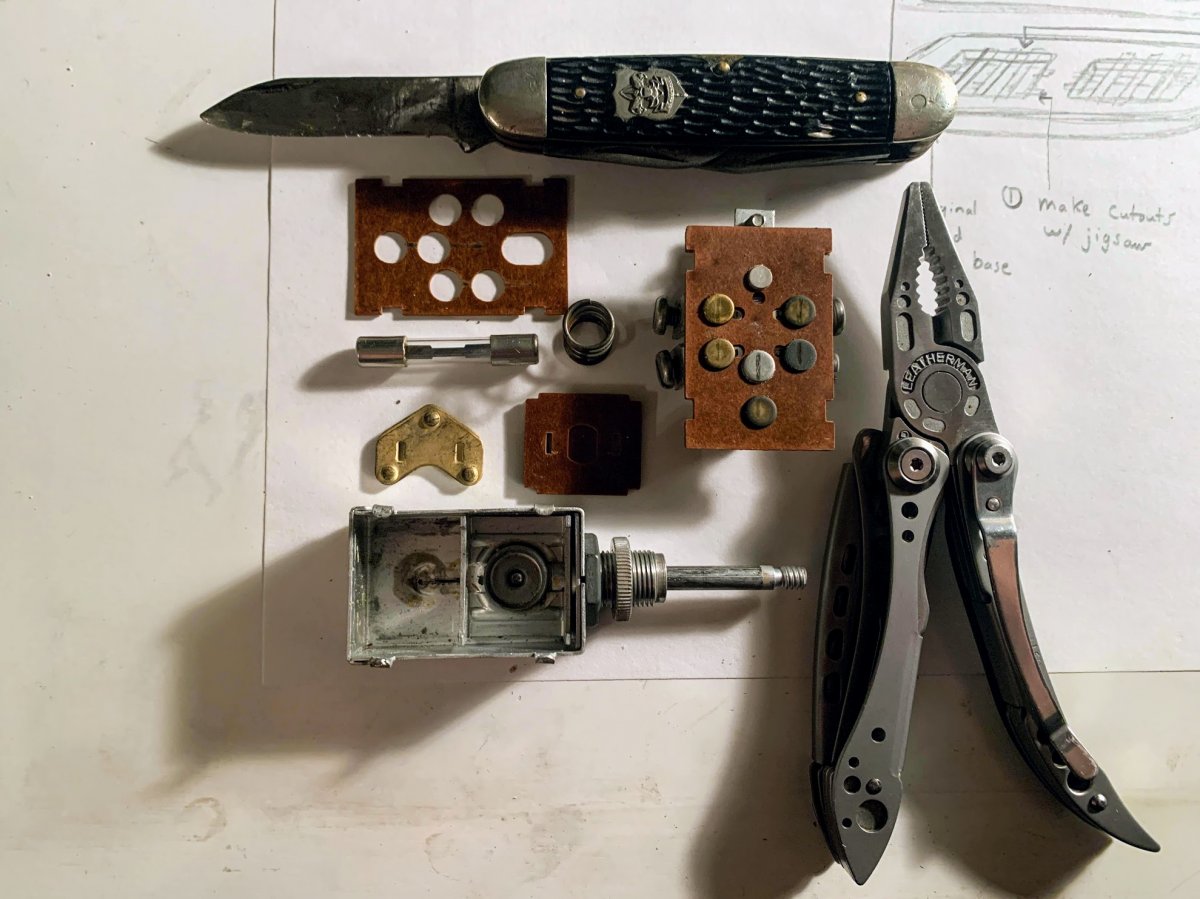

    Okay, so no driving today. I was however able to get the contact points on the light switch all cleaned up. After plugging everything back in, I ran into the same problem. Low beam generated some heat and high beams made the power inlet hot. Still no blown fuses.
    Next, I tried out my new-old relay. I had to play around with it a little bit to get the lights going, but it seemed to work. Both gates opened and closed as they should, and no fuses were blown. But within a minute of having the lights on, I discovered that the low beams got the relay warm and the high beams got it hot—just as hot as the switch. (Yet with the relay, the switch remained cold.) It's as if it just moved the problem somewhere else.
    The relay has labels for everything. Two connectors are labeled lights, two are labeled switch, and there's a single prong for battery. The whole operation is grounded. Here's a diagram of how I wired it up. IMG_2067.jpg

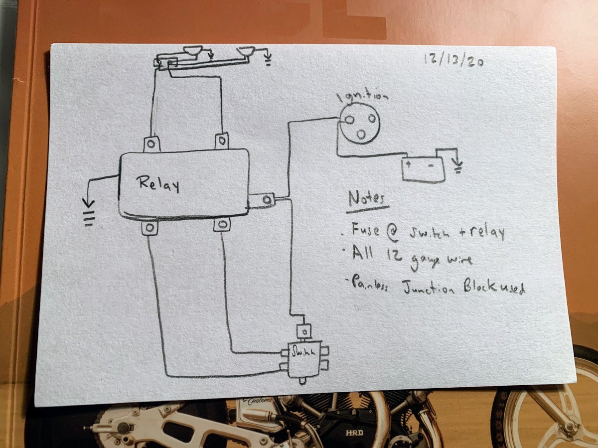

    With this configuration, the tab on the right of the relay (labeled battery) got hot, as did the relay. Also, there's a 30A fuse between the battery and the key switch that I forgot to draw.
    It seems strange to me that this relay would need multiple power sources. That just doesn't seem right. When I tried not using the battery tab on the relay, the gates would open and close but the lights would not come on. When I tried connecting the battery to the switch but not the relay, nothing happened.
    As you guys know, I'm new to all this. I have three questions.
    1) Do these old-style relays usually get hot during normal use?
    2) I don't really want to, but should I just bite the bullet and get new-style relays?
    3) Seeing that this is a vintage piece, what is the easiest way to tell if it's a 6 or 12V? It has no markings that would tell me either way. It does look exactly like the one in this diagram that I found after I drew my sketch. Maybe I should try a 10 gauge power wire.
    Seeing that much of the problem revolves around the high-beam circuit, I'm wondering if there's potentially a short somewhere in the headlight bucket? The lights are bright, so that doesn't seem like the case. I will investigate that tomorrow. Any input would be greatly appreciated.

    The power (Battery) terminal should be wired directly to the battery with a fuse/fusible link or a cutout. In my opinion it should be 8 gauge wire or bigger. It shouldn't be wired through the ignition switch or even to the hot wire as you have it.... that way all the current is going through the single wire. The relay is actually redundant.
    The whole idea of the relay is that it powers the lights without any (very little ) voltage drop.
    Have you missed a step in the circuit, ( dip switch) ? The switch you have is normally used as a park lights and headlights switch. So that the first step lights the park lights and tail lights and full out is for the headlights. The headlight wire would then go to the dip switch, and from there to either of the relay activating terminals. The dipswitch will handle much more current than the panel switch you are using.
    I think what may be happening is that you are powering both high and low beam at the same time when you have the switch full out, thereby drawing double the current!
    Also have you run earth /ground wires back from the terminals on the lamps themselves all the way to the chassis or are you relying on the ground running through the buckets,headlight bar etc? I always run a separate ground right back to a known good ground on the chassis as near as possible to the battery/frame/engine
    ground point.

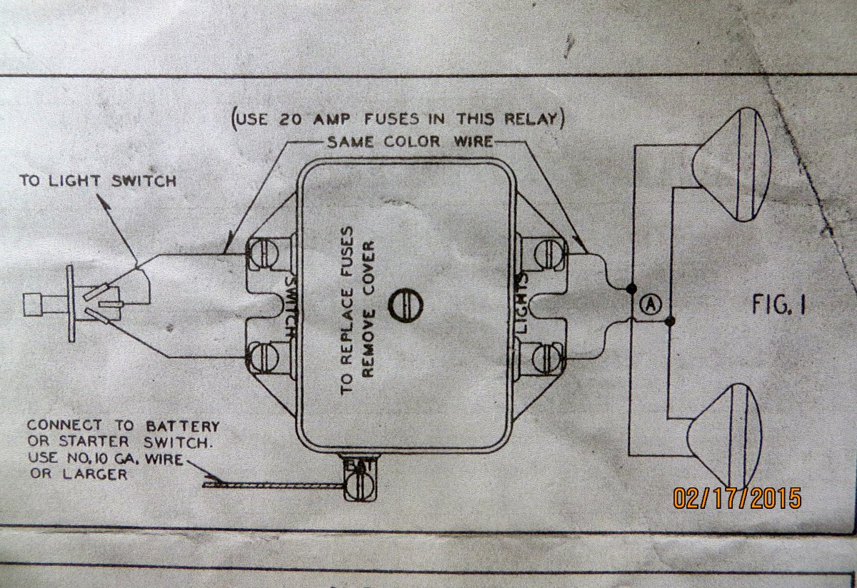

    So if you look at the original diagram for the relay, it has depicted a foot operated, Hi/Lo beam switch...
    remember when they weren't on the turn signal switch? It breaks one circuit and makes the other.
    Does your headlight switch do that?
    I'm wondering if both filaments are powered on hi beam (maybe low beam too) and that is why your switch is getting hot.
    Maybe substituting the relay in the circuit is powering the two coils (I'm guessing that is the way the relay is configured) and you substituted the current draw of the headlamps for the draw of the relay coils if both powered at the same time?
    Long distance troubleshooting is difficult.
    As for a short....a short to ground makes smoke and or sparks....tremendous, immediate voltage loss and high amperage....fuse blowing wire melting stuff.
    You are describing heat from current draw for more than the switch can handle
    Unhook the wires for the high beam and operate low beams check outcome
    Then do the same for the high beams powered with the low beam wires unhooked....evaluate

    For sure check the ground for the lights. A really bad ground is like turning off the switch. Poor grounds can have huge resistance which is how electric heaters work.

    Right on. I think you guys hit the nail on the head. That would explain the heat. Thank you so much. I'm going to be out of town for a little bit, but I'm going to order a dimmer switch and put it into play when I can get back in the garage.
    The lights are grounded directly to the frame with 12 gauge wire. I brought the area down to baremetal before bolting on the ground.
