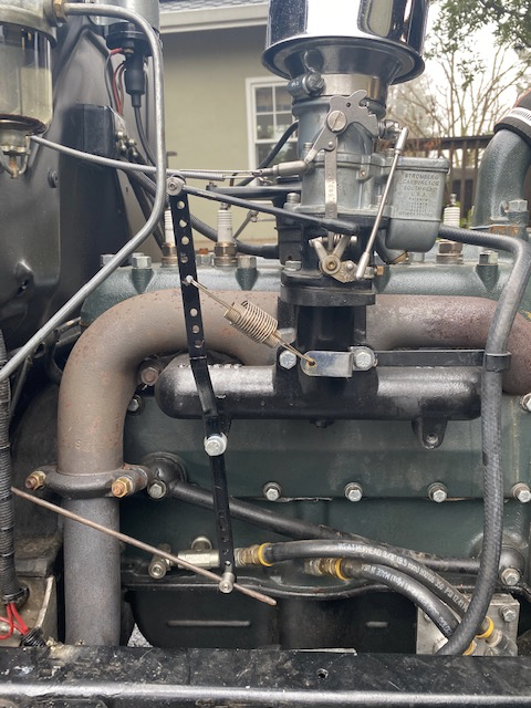

  28. Motmo
    Joined: May 9, 2013
    Posts: 23
    Motmo

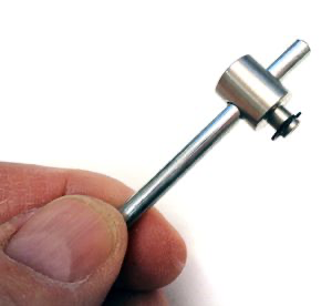

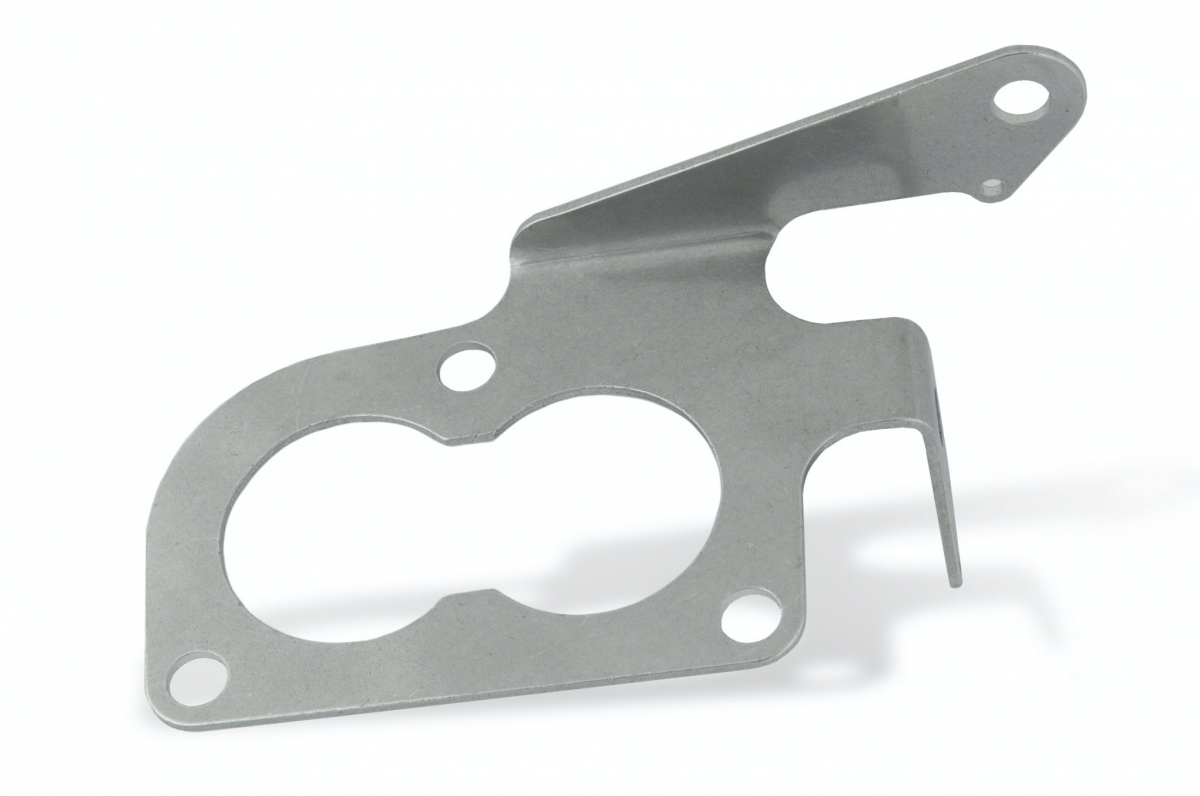

    Not sure where you'd mount our linkage with that manifold, it might be helpful to start with this part that would give you a mounting location. You can find it here-
    https://www.stromberg-97.com/product-index/parts/?cat=linkage-parts
    Then you'd have to fab a linkage arm which should be pretty easy. I'm running a scalded dog intake and they had an instruction sheet for a linkage arm. The measurements will be all wrong for your set up but it might be a helpful starting place-
    https://storage.snappages.site/0v47f38nxg/***ets/files/linkage drw.pdf
    For throttle rods I just cut and welded stock throttle rods to length and used a couple of these for the linkage arm-
    It was a little hard to adjust so I switched to these, which are more adjustable for fine tuning and can also be found on the secrets of speed website-
    https://www.secretsofspeed.com/
    Here's my current set up
