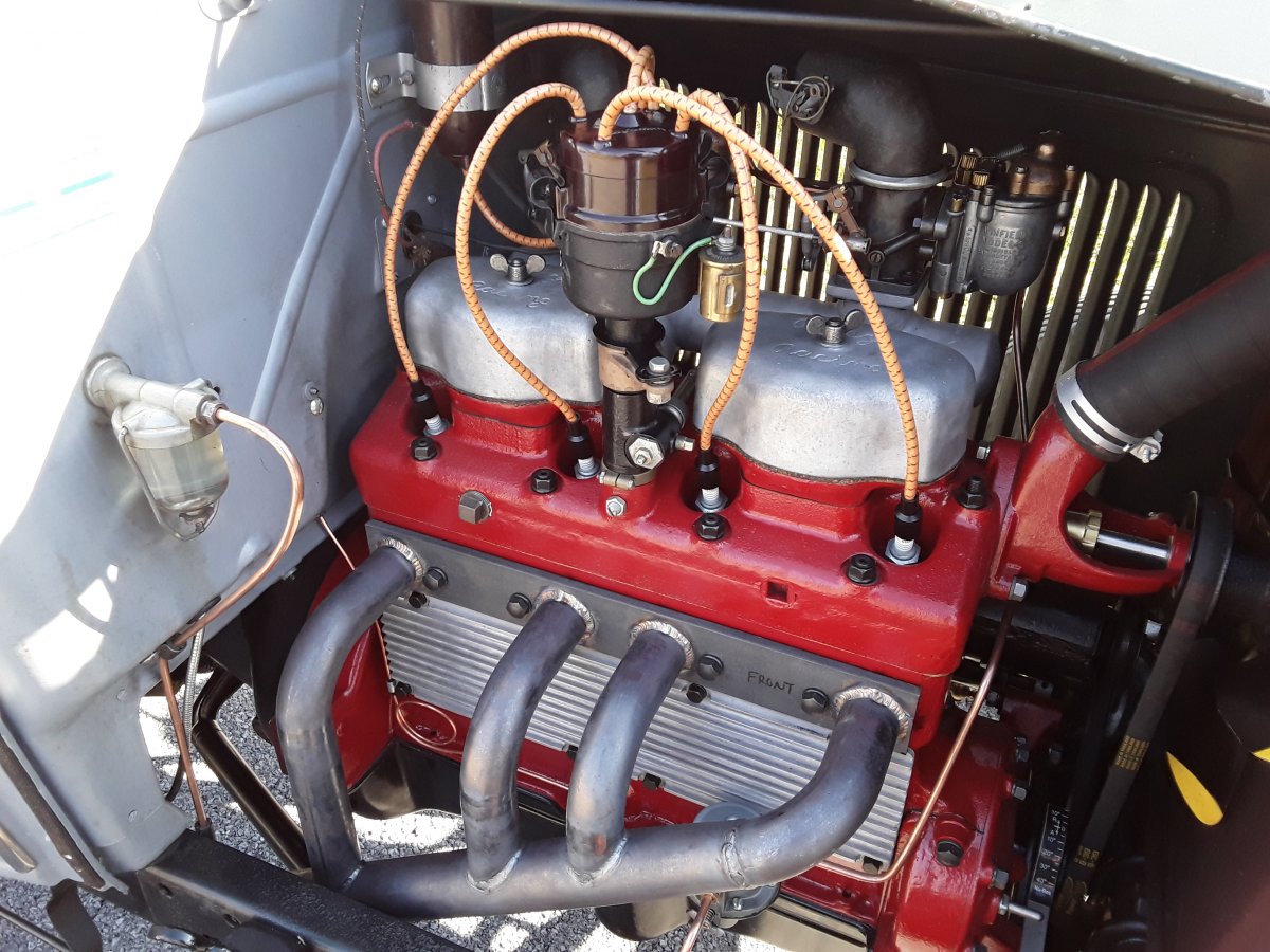

    Also please add some kind of flex hose or strain loop into the fuel line. Vibration and flexing between the engine and body will lead to cracks and potential fire.

    Good advice, but one more thing: Use a quarter turn ball valve as your shut off instead of the pet****s they sell as Model A gas shut offs. A ball valve is drip tight, and turns easily (which is a real benefit when you need to shut it off NOW).

    Times 2 on the ball valve at the tank outlet.
    I had that on my Model A. When I thought I might not be driving it for a while I would close the valve as I was backing into garage and let it run until the carb was empty.
    Never had carb problems with that quadrajet.

    I will do that. I was under the impression that the steel fuel line was far less prone to cracking as compared to the copper? (I painted my new steel line with copper paint to look more old-timey)

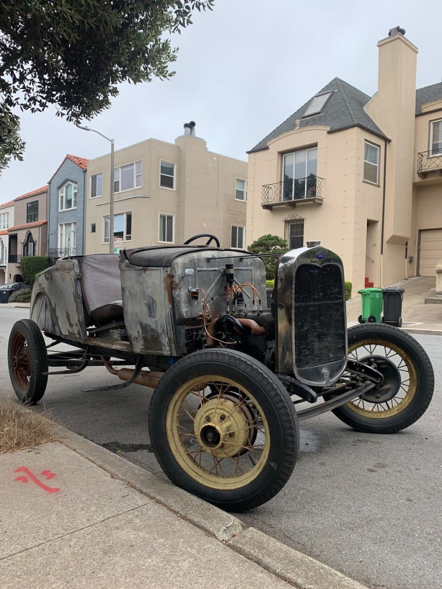

    Once I had the car running, I did indeed take it for a drive around the block. Everyone who saw me rumbling down the street looked a little confused—but they all seemed to have smiles on their faces. It was as if I had rolled out of some sort of time warp! No doors, no hood, no floor, seat not really mounted, ancient tires...I wish I could have gotten a video. It was a trip I will never forget. I did learn that the water pump was leaking a whole lot, so I ordered a replacement. Oh, and I did manage to 1) run out of gas and 2) parallel park it.
