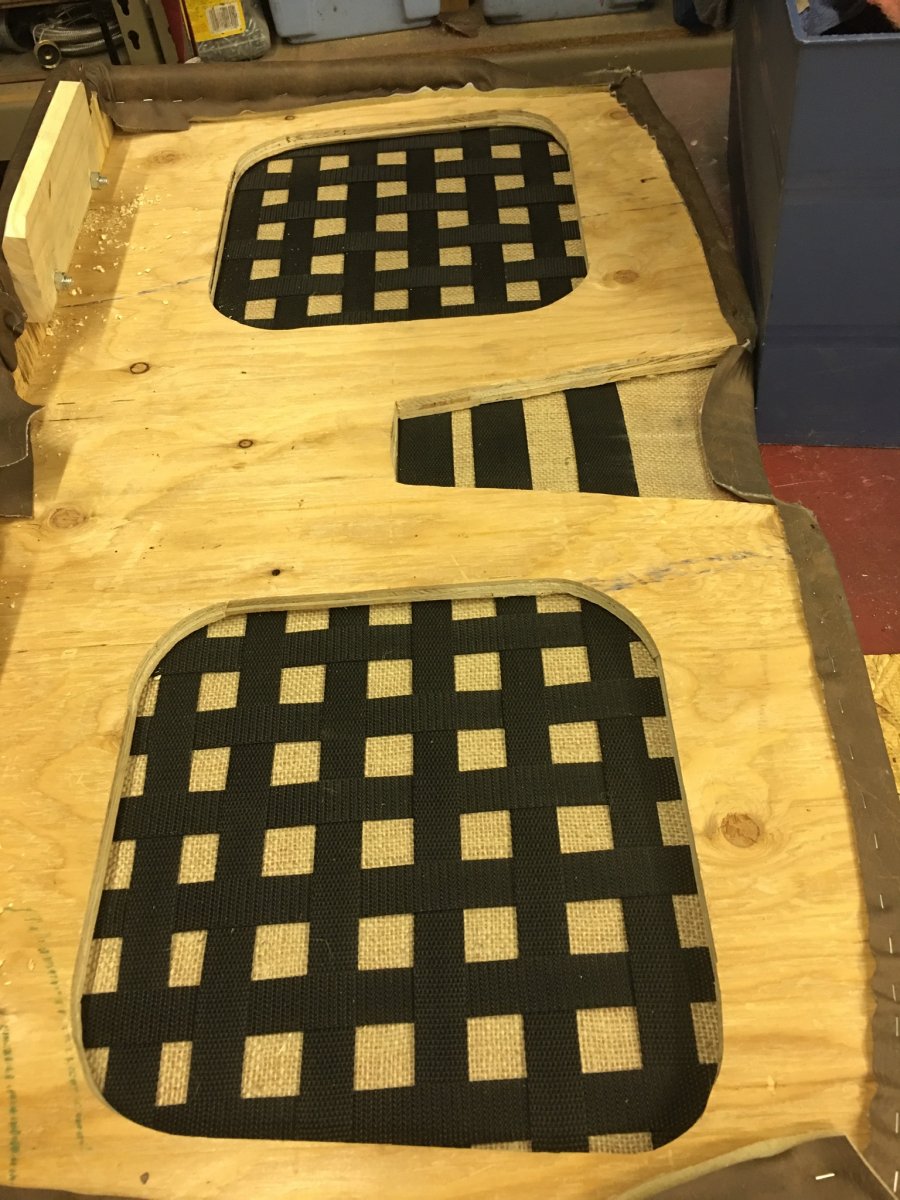

    If the boys are making their own seats use an electric turkey carving knife to cut the foam...

    Thanks for the seat pictures. They my help me build my seat.

    Very cool. I think I am going to build my next seat from scratch, so that is good information to have.

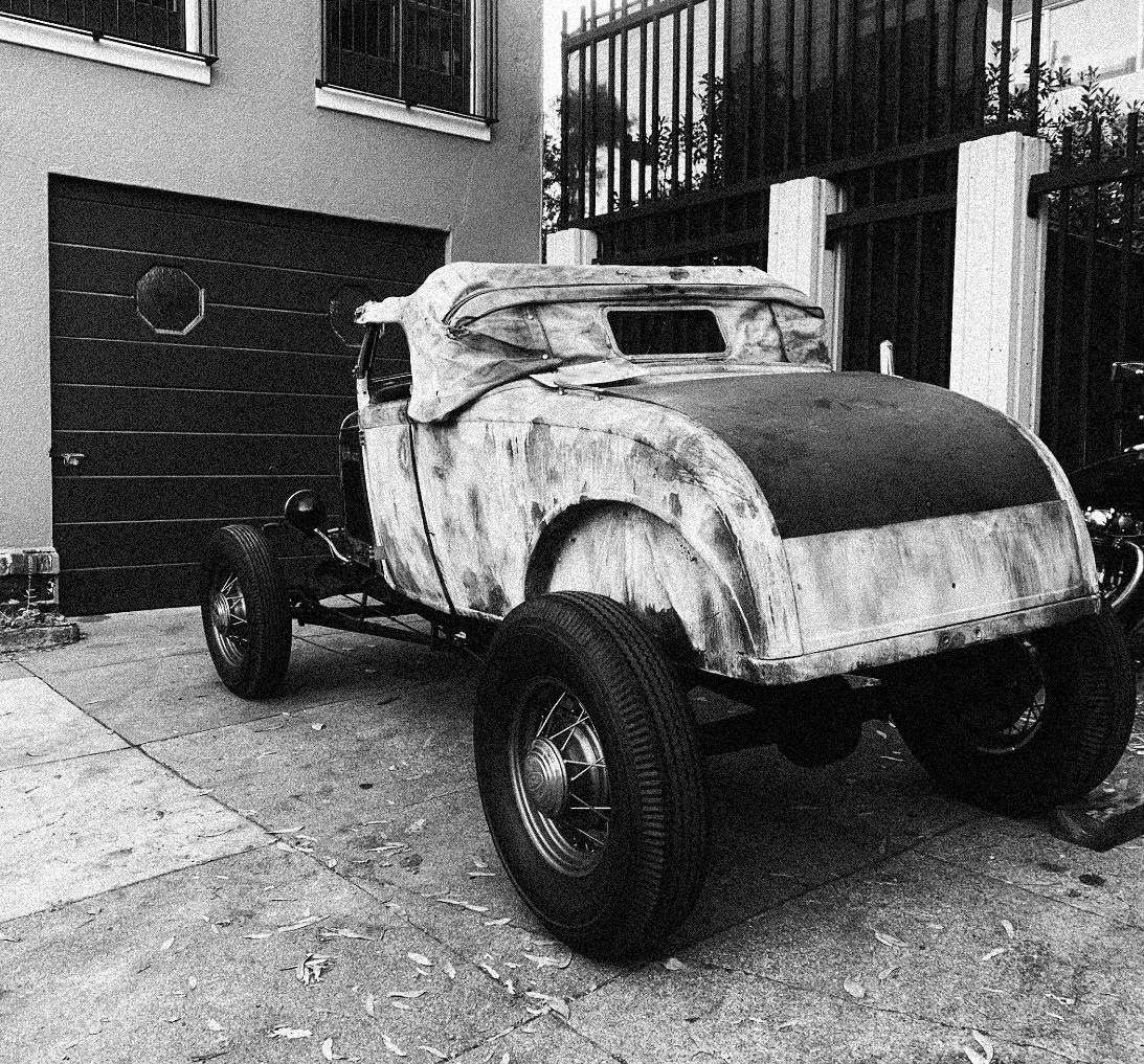

    Thanks, Tim! Haha you caught me on the job. Wish we could have connected to catch up. As much as I like the idea of lowering it, I feel like it may not be worth tearing down the suspension in the foreseeable future. Now if I had a shop to work in, that might be a different story.
    Thank you! It was a gift from my brother years ago. Still dangerously sharp and extremely useful. No earthquake retrofit at this time. We got a new garage door! You can get the full story on the Journal here.

  15. Nice job on the seat. It gets the Lindsey seal of approval, but how comfortable does it sit?

    Hahah fair questions! We both give it pretty high marks for comfort, but a longer ride will tell the tale. That being said, Lindsey and I have covered some serious miles over just about every terrain on my survivor Ironhead chopper; almost anything is more comfortable than that!

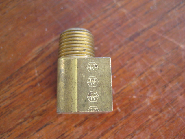

    As for fuel fittings, this manufacturer, of course:
    For hose connections, make sure to use beaded fittings as per OEM, not barbed
    fittings which are more likely to tear the hose when disconnected.
    Weatherhead is now Weatherhead / Eaton. The fittings seem to be identical, but are stamped with either name as ordered.
    Sadly, most of the parts stores seem to have gotten rid of the Weatherhead cabinets but the fittings can be ordered through industrial suppliers such as (some) hydraulics shops.

    Nice, I will look for those. Thank you for the heads up! I would have gravitated towards barbed but I am glad that I know to avoid them.
