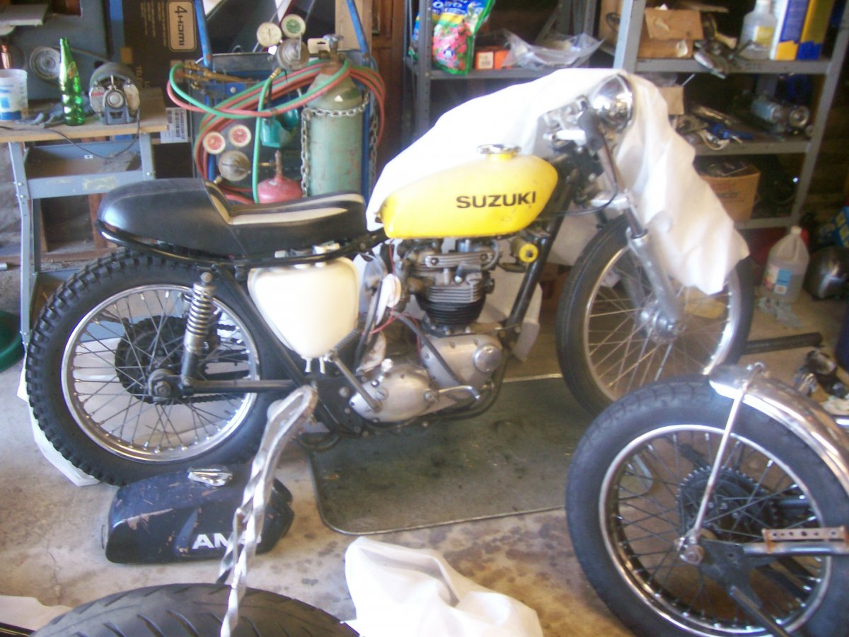

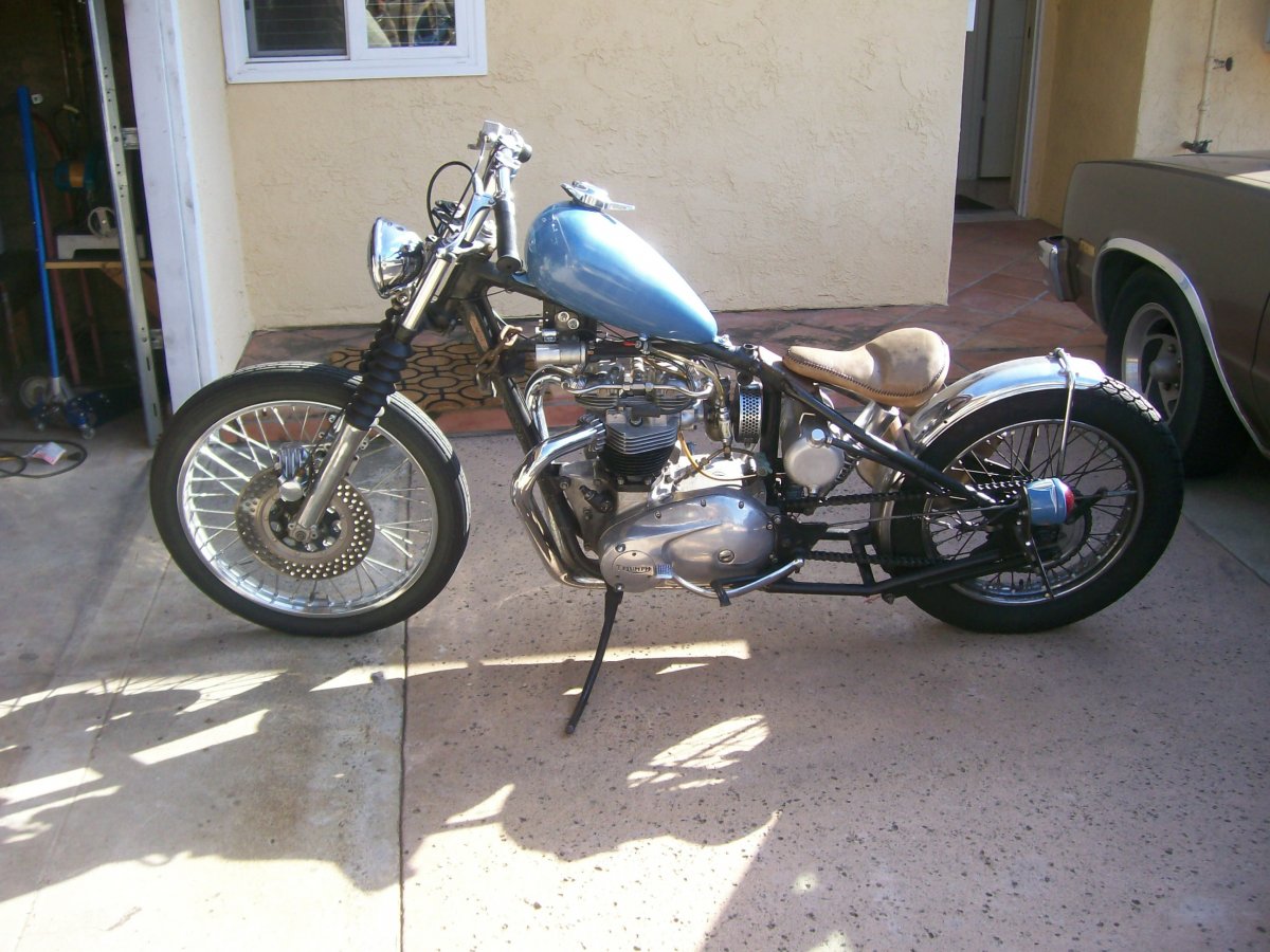

    A couple of my son's Triumphs. The one with the Suzuki tank is scary fast! He started on a '67 Honda CT90. It's still around too.

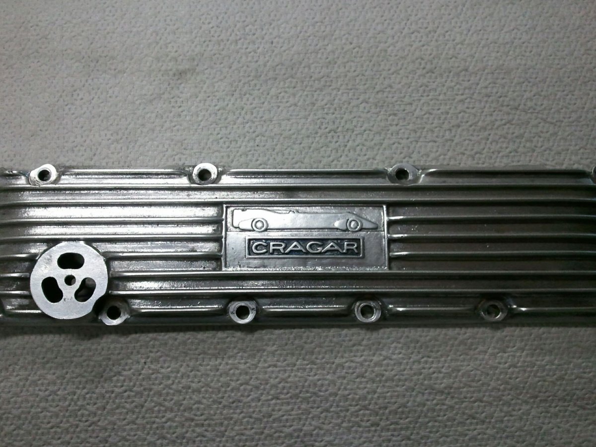

    It will take a good polisher to do your side cover justice without making all the edges round and losing the logo detail. If it was mine :rolleyes: I'd media blast it and only polish the top of the fins and the high parts of the logo. Maybe paint the valleys between the fins red, black, engine color or what ever accent color you are using under the hood. Sorta' like this SB valve cover , but it's your call and I'm sure you have a vision.

    Wow. Those are both amazing. The Suzuki-tanked beast looks like it'll take your lunch money!

  16. Could you have your Cragar cover vapor blasted? Might ensure that you don't lose any of the hard edges. I had a Triumph Daytona engine done when I had it torn down for rebuild and it turned out beautifully. The edges are just so well defined. Just a thought.

    I like that idea a lot. Interestingly enough, I had a Triumph T100SR engine with that same treatment and I agree, it looked really nice. Small world!
